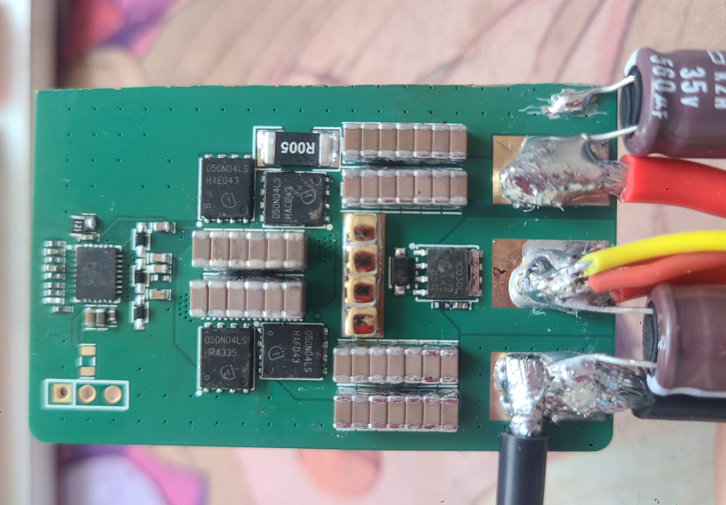

LTC7820 open source
Except for capacitors and MOSFETs, materials can be purchased directly from the BOM.
1. Maximum support is 38V input and 76V output; do not exceed the voltage limit.
2. Please use 100V withstand voltage MLCCs. Large single-cell electrolytic capacitors, solid-state capacitors, and tantalum capacitors are not allowed for 4A input and output; MLCCs are required
. 3. The project's maximum allowable output is 35V. For other voltages, high-voltage capacitors must be used.
The following are my measured data for reference only;
these are general parameters.
Switch MOSFET model: BSC050N04LS;
Input protection MOSFET model: NXP1C030L;
Capacitor: So-called X7R 50V 10UF MLCC from Taobao (capacitor temperature 98°C at 160W output).
