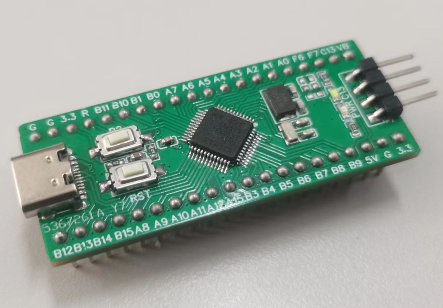

GD32F130C6T6
The GD32F130C6T6 minimum system board features an onboard CH340 serial port download circuit. It can be programmed using either GD32AllInOneProgrammer or STLink. When using GD32AllInOneProgrammer for serial programming, you need to select DTR LOW and RTS HIGH each time you open the software to enter the BootLoader.
Using salvaged chips may encounter flash protection issues preventing programming; GD32AllInOneProgrammer can remove this flash protection.
Onboard LEDs are connected to PC13 (low level lights up), and onboard buttons are connected to PB2 (pull-down, high level when pressed, do not press during startup).
The project was imported from an offline standard version, so theoretically there shouldn't be any problems; the current verification is based on a previous standard version project.

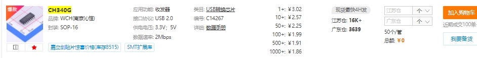

These are actually quite cheap, probably less than 3 yuan each, while a CH340G chip might cost more. Indeed, in the industrial electronics era, the cost of transporting materials is higher than the materials themselves.

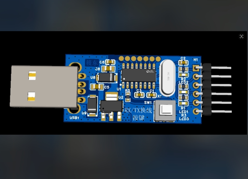

III. Design Summary:
    I wanted to improve this aspect to make the 3.3VTTL stable and avoid burning out the board's serial port.
            For easier testing, I added a one-click cable switching function, making it convenient to switch the RX and TX lines by pressing a button in case of incorrect connections.
            I don't want to be ripped off anymore. Even though it's not expensive individually, my board is expensive, and I only have one for testing. If it breaks, I have to fix it myself.

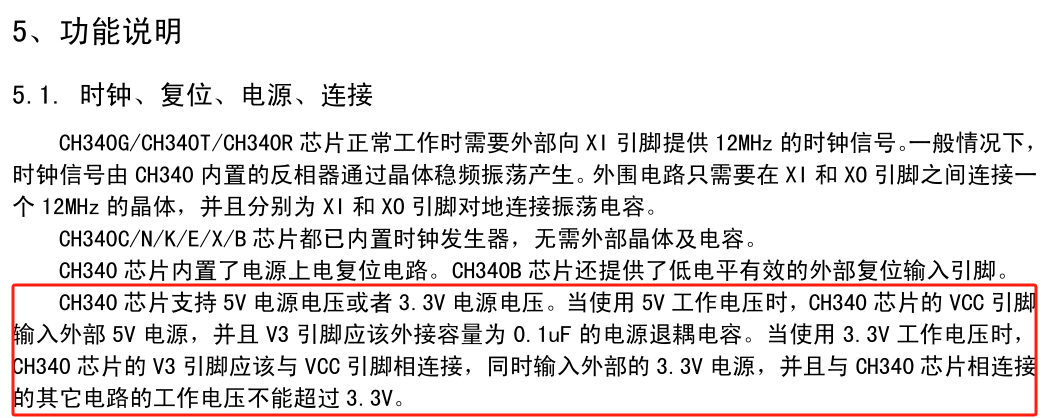

IV. Problem Analysis
             and Reference Technical Manual: I found that the V3 pin of the chip            is best used to control the TTL 3.3V input voltage; otherwise, it's prone to failure.
Other pins are rarely used, so I've designed them to be exposed for those who need them. Those who don't need them can leave them as is; they look nice.

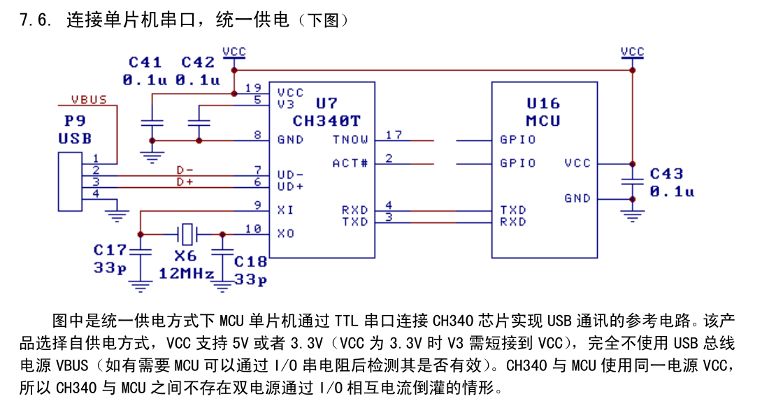

V. Overall Design Block Diagram
: Below is the schematic diagram for design reference.
When designing, pay close attention to the V3 pin.
VI. Hardware Circuit Composition:
First and foremost, modify the power supply to ensure a stable 3.3V output. 5V USB power is actually quite stable. My first design used an LDO + diode reverse current protection design, but the voltage was too low. It only reached 2.7V and couldn't pick up.
Later, I switched to a diode + LDO. Testing showed that the LDO could supply 5V in reverse without problems. I was initially worried about the LDO being sensitive to reverse power supply, so I designed it that way. Therefore, what you see here is the second, improved version.
   The LDO is powered by 5V single-phase power, and the actual measured output voltage is around 4.6V (1117-3.3). In actual use, it can output 3.3V normally, which is very stable. The power supply is solved.
The one-click cable replacement function uses a double-locking switch to achieve RX/TX switching of the output, which is perfect and has been tested.

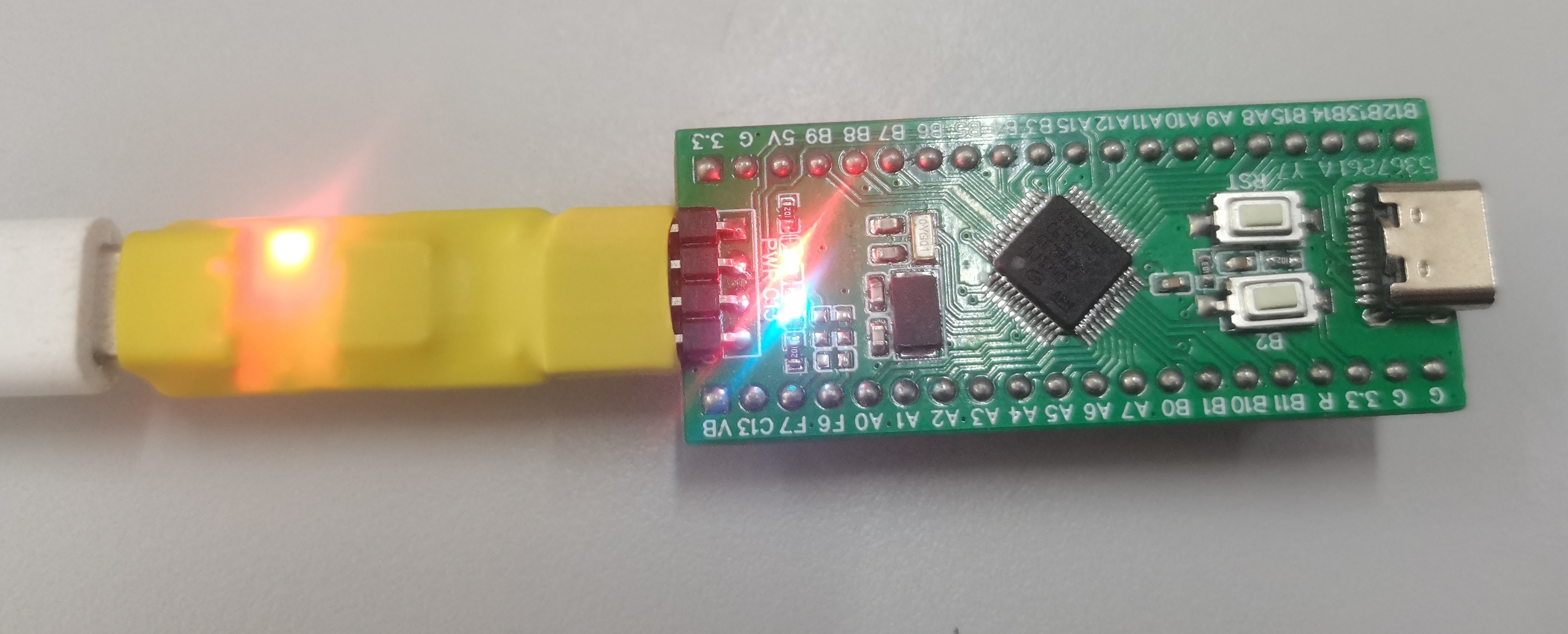

VIII. Physical Display:
The back looks a bit abrupt, but it is indeed the smoothest way, and the relationship and direction are consistent.
The physical product is still good.

3. V3 requires special attention to the pin connection method. I've seen some open-source projects neglect this. When designing for 5V and 3.3V compatibility, they need to consider reverse power supply and shared power issues, just like I have.
