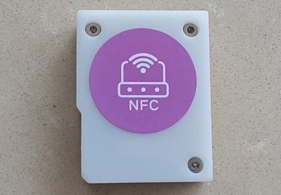

Finished product dimensions: 4x3(3.1)x1.28cm, Type-C port design, NFC quick jumper (M2-0.8cm screws are used; 0.3mm single-sided adhesive thermal paste can be applied to the ESP32 and TF card slot).

The NFC adapter is a Xiaomi Touch Sticker 215 purchased from Taobao, 25mm in diameter. Larger sizes might not fit, requiring it to be attached to the outer casing. Currently, it's built into the bottom of the casing, with the included sticker on the surface.
You need to download the attached LCSC EDA project file and open it with the standard version to place the order. Opening it with an editor will use the professional version and result in errors. Alternatively, download the attached "ESP32 Portable Cloud Drive.zip," which contains the exported Gerber file.
