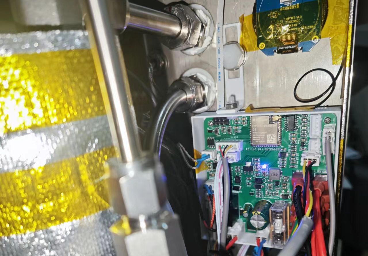

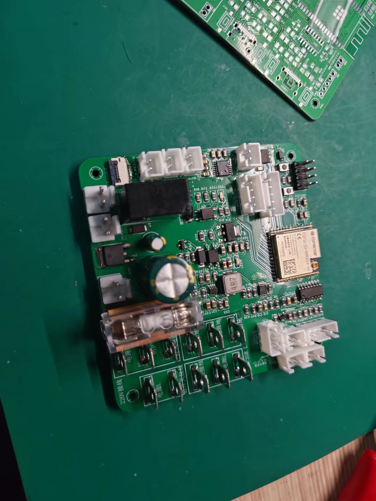

DIY Semi-Automatic Coffee Machine Mainboard - Single Extraction
Supports boiler temperature, brew head temperature, and boiler pressure monitoring; PWM control of a 24V DC gear pump; control of a 220V extraction solenoid valve; solid-state relay control of boiler heating; Wi-Fi remote control; supports
connection to one OLED screen and one TFT screen with the Adruino coffee machine motherboard;
tested for six months and working stably; requires further investigation.
Disclaimer: For personal use only, not for any other purpose. You are responsible for any
soldering failures. (Complete image shown)

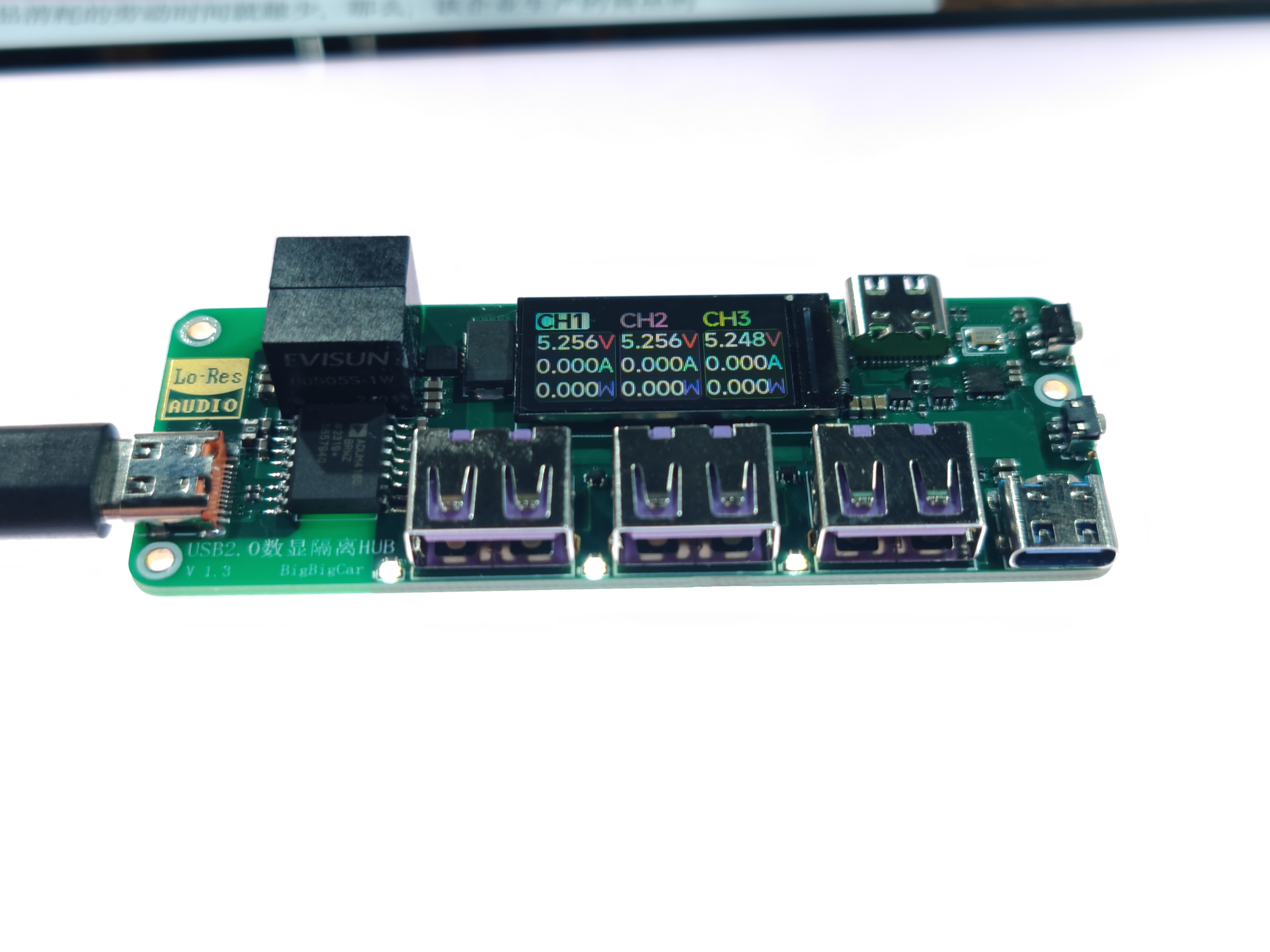

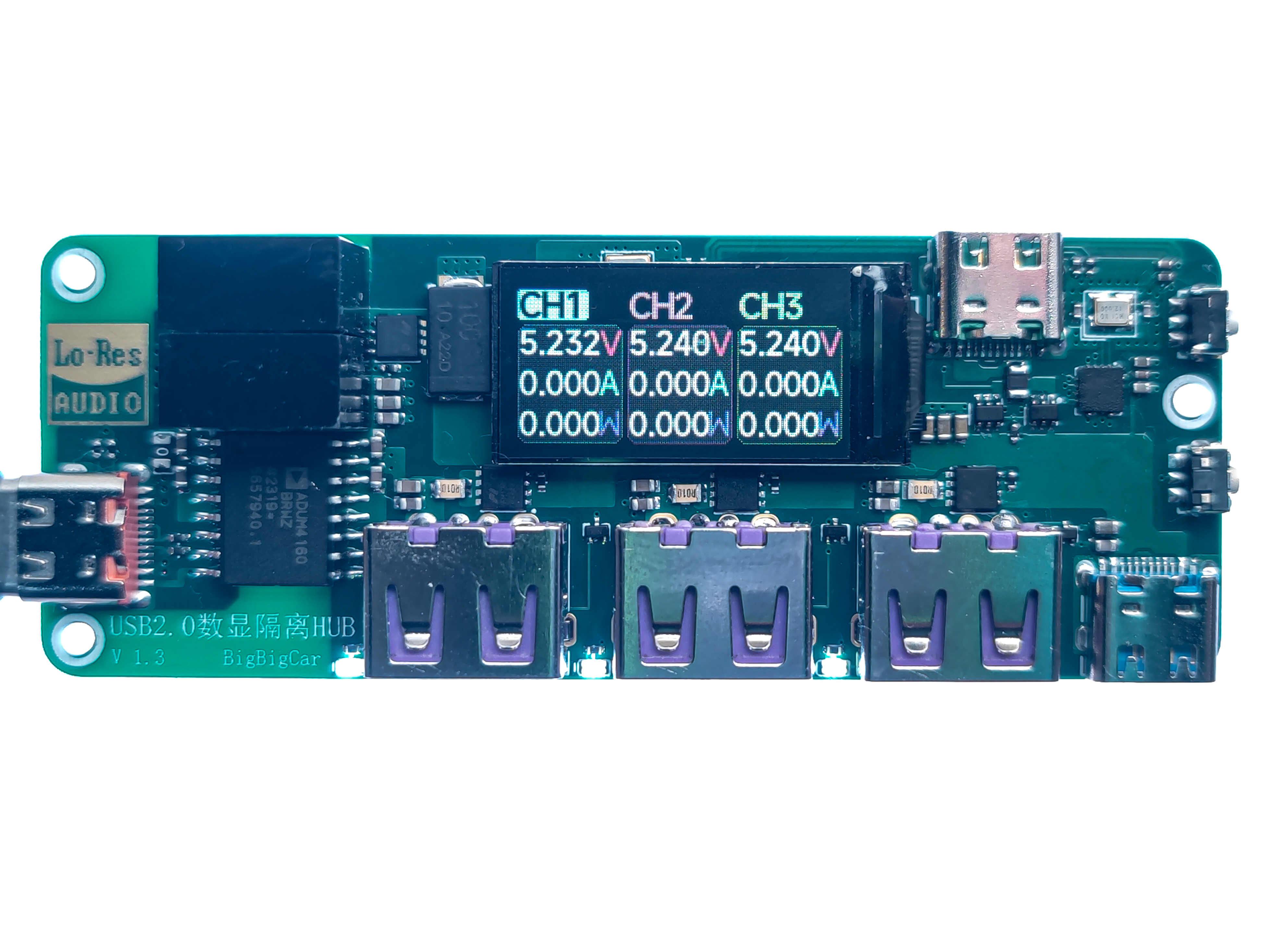

Digital display of isolated HUB
USB 2.0 Digital Display Isolated HUB
Introduction:
USB 2.0 Digital Display Isolation HUB
Application Scenarios:
Computer-side protection for debugging high-voltage equipment via USB
. I. Product Introduction:
This USB isolation HUB connects data input via Type-C and isolates and converts out three USB-A ports and one USB-C port.
Three of the A ports have independent voltage and current detection and adjustable overcurrent and overvoltage protection
. Application Scenarios:
When debugging high-voltage equipment using a computer, it can isolate the high voltage from the computer data to prevent high voltage from entering the computer through the communication interface if the high-voltage equipment fails, causing the computer to malfunction .
When debugging external devices, you can try detecting the power of the external devices to monitor their operating status
. Product Overview:
The chip uses ADUM4160BRWZ to isolate the computer's input and output signals. Four USB interfaces are output via CH334P.
Two 1W isolated power supply modules are used to power the subsequent modules. Due to the small power of the isolated power supply, it supports 5V Type-C for additional power supply.
The MCU uses ESP32 C3. INA3221 is used for independent voltage and current detection and overcurrent and overvoltage protection of the three A ports. Information is displayed on the LCD screen
. Product Parameters:
Input Isolation Voltage: 750V;
Communication and Additional Power Supply: Maximum Input Voltage: 5.2V;
10-level Screen Backlight:
0.1~3A adjustable; Current Limiting:
Maximum Transmission Speed: 12. Mbps
V. Instructions for Use:
**Caution!**
This device only protects the data input end. Other interfaces, including the external power supply interface, are not isolated. Please do not use expensive equipment to provide external power.
Due to isolation, USB 2.0 speeds will be significantly reduced. Actual testing showed that USB flash drive read/write speeds were only 1.5MB/s
. Without external power, the load capacity is very poor, with an output of only 1.7W and a large voltage drop.
For programming instructions and other information, please visit the Hardcore Innovation Community website (I'm too lazy to copy it here):
https://x.jlc.com/platform/detail/1e535482cde24b0088c3d01ec2c10da1
