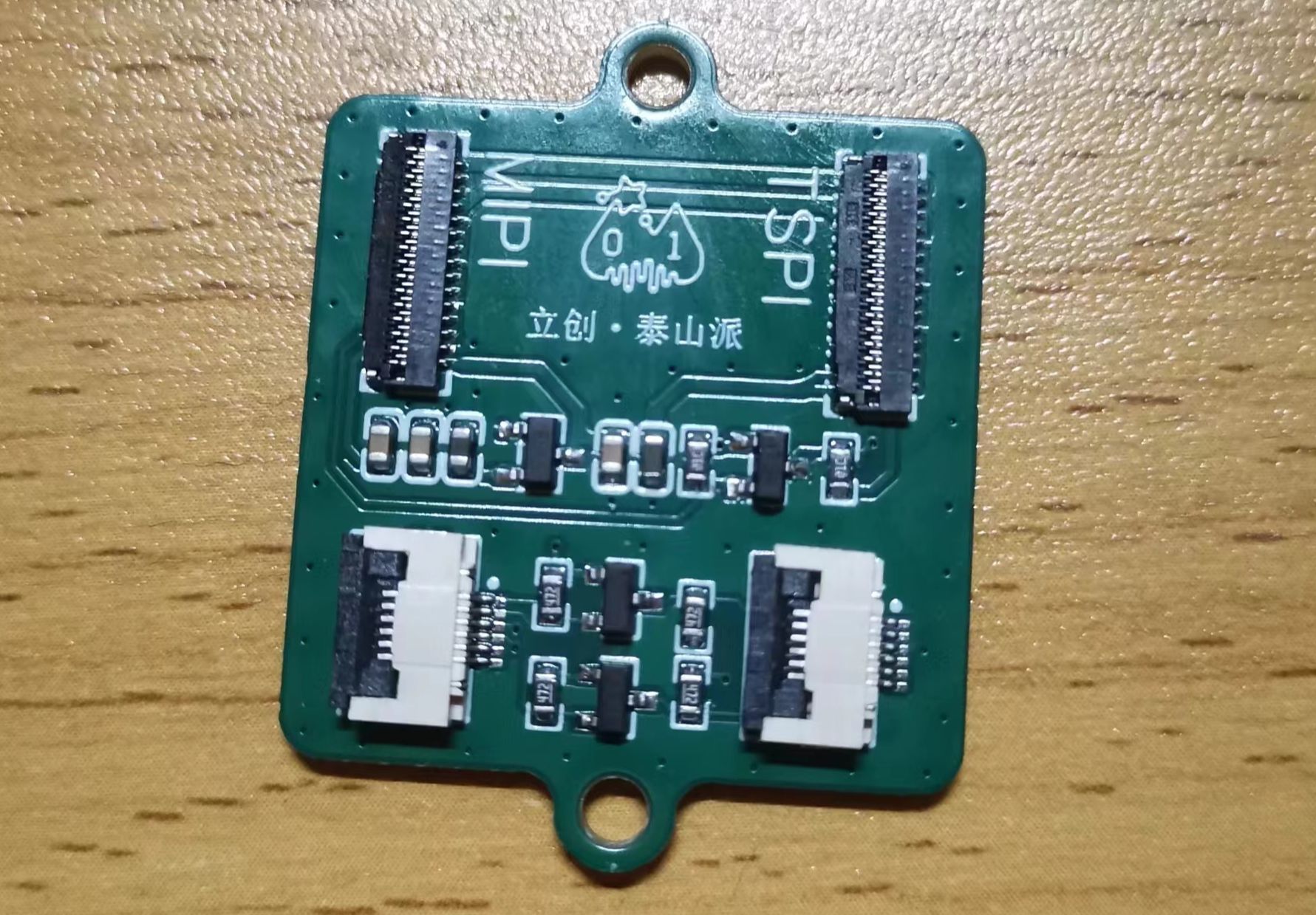

Taishanpai 7-inch MIPI screen adapter board
I. Explanation:
I have a 7-inch LicheeRV Nano MIPI screen purchased from Taobao. The seller refused to provide the datasheet, but it's not a major issue as their SDK has the screen parameters.

II. Taishan Pi Device Tree :
1. tspi_android_sdkkernelarcharm64 ootdts
ockchip spi-rk3566-user-v10.dts
Comment out #include "tspi-rk3566-hdmi-v10.dtsi" and #include "tspi-rk3566-edp-v10.dtsi"
Keep #include "tspi-rk3566-dsi-v10.dtsi"
Add a touch node: &i2c1 { status = "okay"; gt9xx: gt9xx@14 { compatible = "goodix,gt9xx"; reg = ; tp-size = ; max-x = ; max-y = ; touch-gpio = ; reset-gpio = ; status = "okay"; };};

III. Modify gt9xx driver
1. tspi_android_sdkkerneldriversinput ouchscreengt9xxgt9xx.c
Find this function goodix_ts_probe
and modify the content as follows
else if (val == 911) { m89or101 = FALSE; bgt911 = TRUE; gtp_change_x2y = FALSE;//modify gtp_x_reverse = TRUE;//modify gtp_y_reverse = TRUE;//modify }
