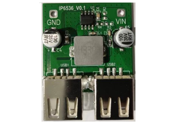

IP6536-AA-15W Car Charger/Discharger
Functional Description:
8~32V input, car charging/discharging chip, 5V 3.1A output (maximum total output current 3.1A).
Input voltage:
8~32V. 40V Max.
Output ports:
USB-A, USB-A
output power
5V 3.1A;
Switching frequency
150KHz ;
Static power consumption
5mA;
Chip over-
temperature protection built-in, 150℃. Input
voltage : 12.01V 0.459A ; Output voltage : 1.000A 5.5W 92.56%; Output current : 11.92V 0.959A 5.096V 2.000A 11.4W 89.13%; Output current: 11.90V 1.562A 5.352V 3.000A 18.6W 86.33% ; Output current: 24.01V 0.233A 5.104V 1.000A 5.60W 91.24 %; Output current : 23.97V 0.478A 5.094V 2.000A. 11.46W 88.92% 23.95V 0.775A 5.349V 3.000A 18.56W 86.46% Operating Temperature Schematic PCB Layout Diagram PCB 3D Preview PCB Physical Image Download: https://oshwhub.com/saber.lily?tab=project&page=1 Other design files can be obtained from your supplier.
