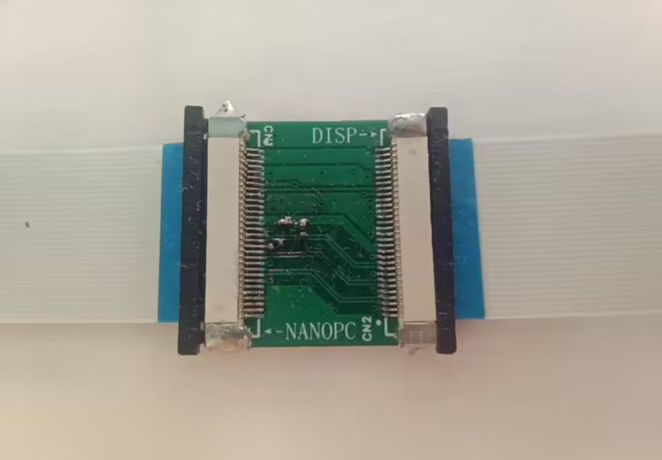

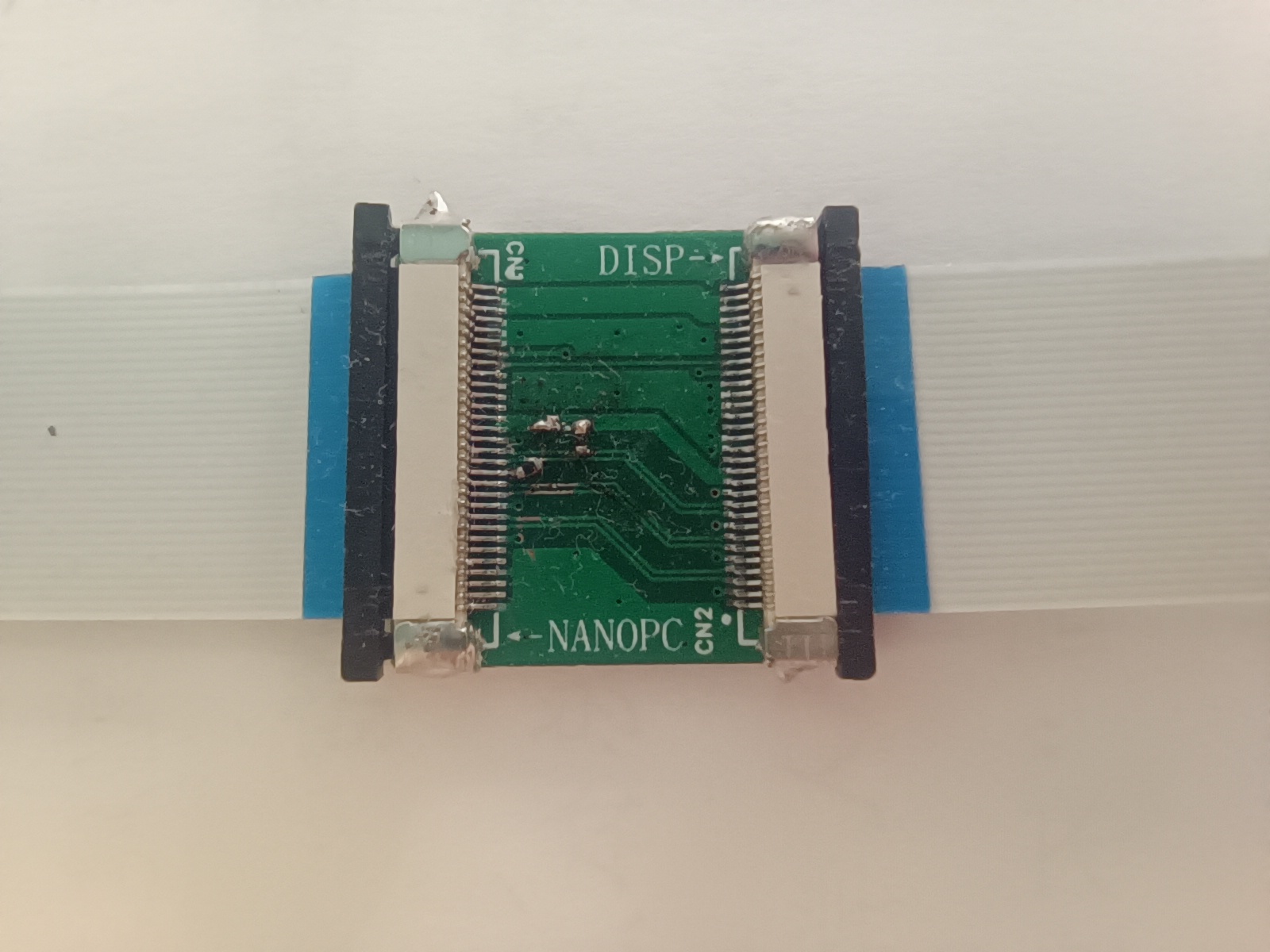

EDP ​​screen adapter board for NanoPC-T4
The project has been tested and is working properly.
The LCSC prototype is 1.2mm thick, using a JLCSC 7628 structure. The minimum line spacing is 6mil.
**Note:** Pay close attention to the orientation of the EDP ribbon cables at both ends!!!
the EDP ribbon cables at both ends!!! **Note:** Pay close attention to the orientation of the EDP ribbon cables at both ends!!!
Don't ask me how I know this…
The specific type of ribbon cable used depends on your screen; I used two correctly aligned ribbon cables this time.
The resistors soldered on the PCB are pull-up resistors for the EDP AUX channel. During debugging, because the NanoPC-T4 board had them but they weren't installed, I added them;

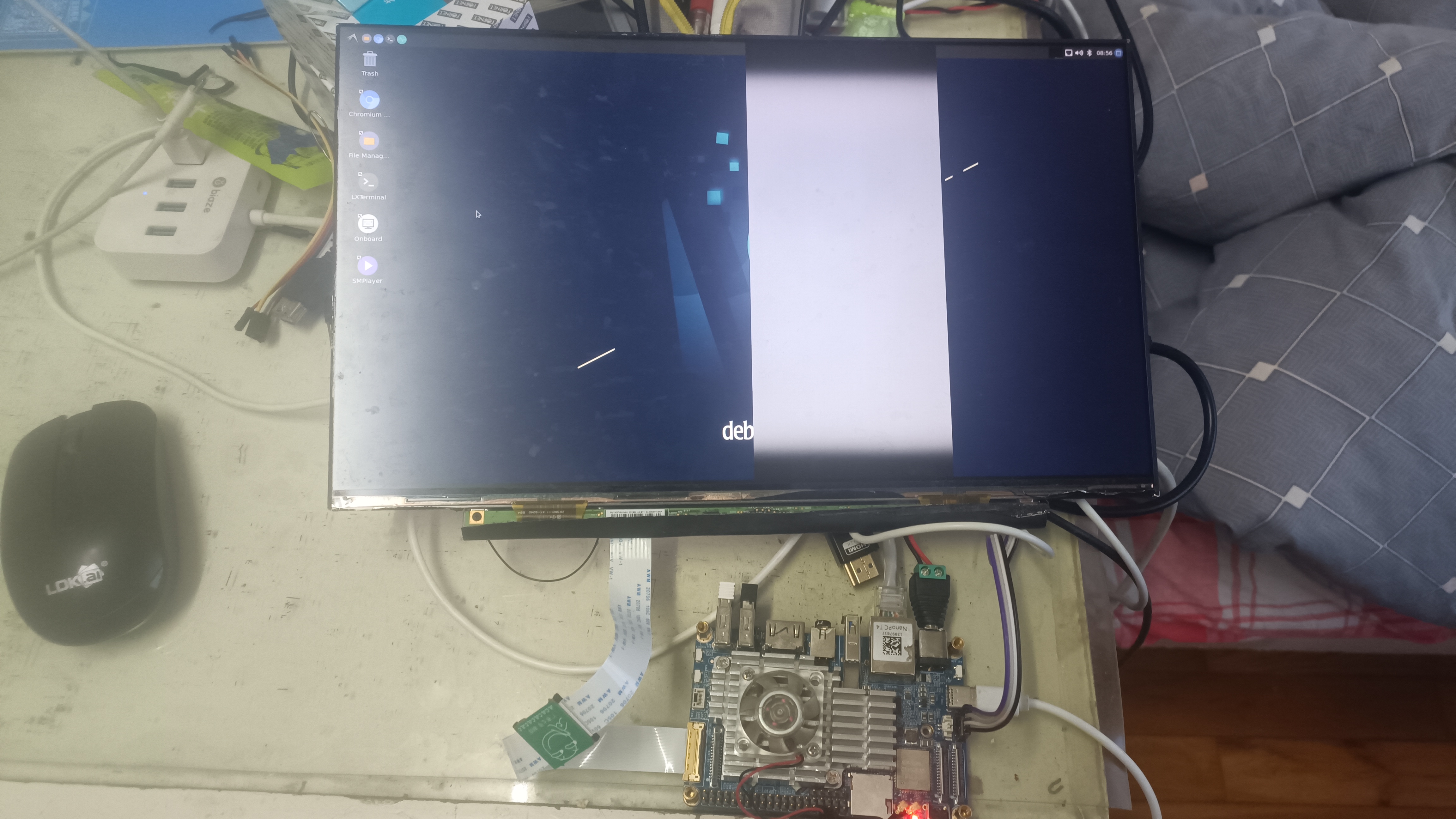

in practice, they weren't needed. There was a very frustrating experience when adapting the device tree. The FriendlyARM 4.19 kernel source code had significant compatibility issues with the T4, and there was absolutely no software support. As a beginner, I struggled for a very long time. Either the screen backlight wasn't working and the panel displayed normally, or the backlight was working but the panel wasn't. I especially want to complain about FriendlyARM's software support. I applied to four support groups and only got into two after a month, and those groups were completely inactive with no replies or daily chat.
Finally, I discovered, to my dismay, that FriendlyARM automatically turns off the backlight after recognizing the panel, requiring manual activation! No matter how absurd this is, it actually works. Finally, I wrote a shell script and placed it in the system startup directory to "manually" turn on the backlight at startup...

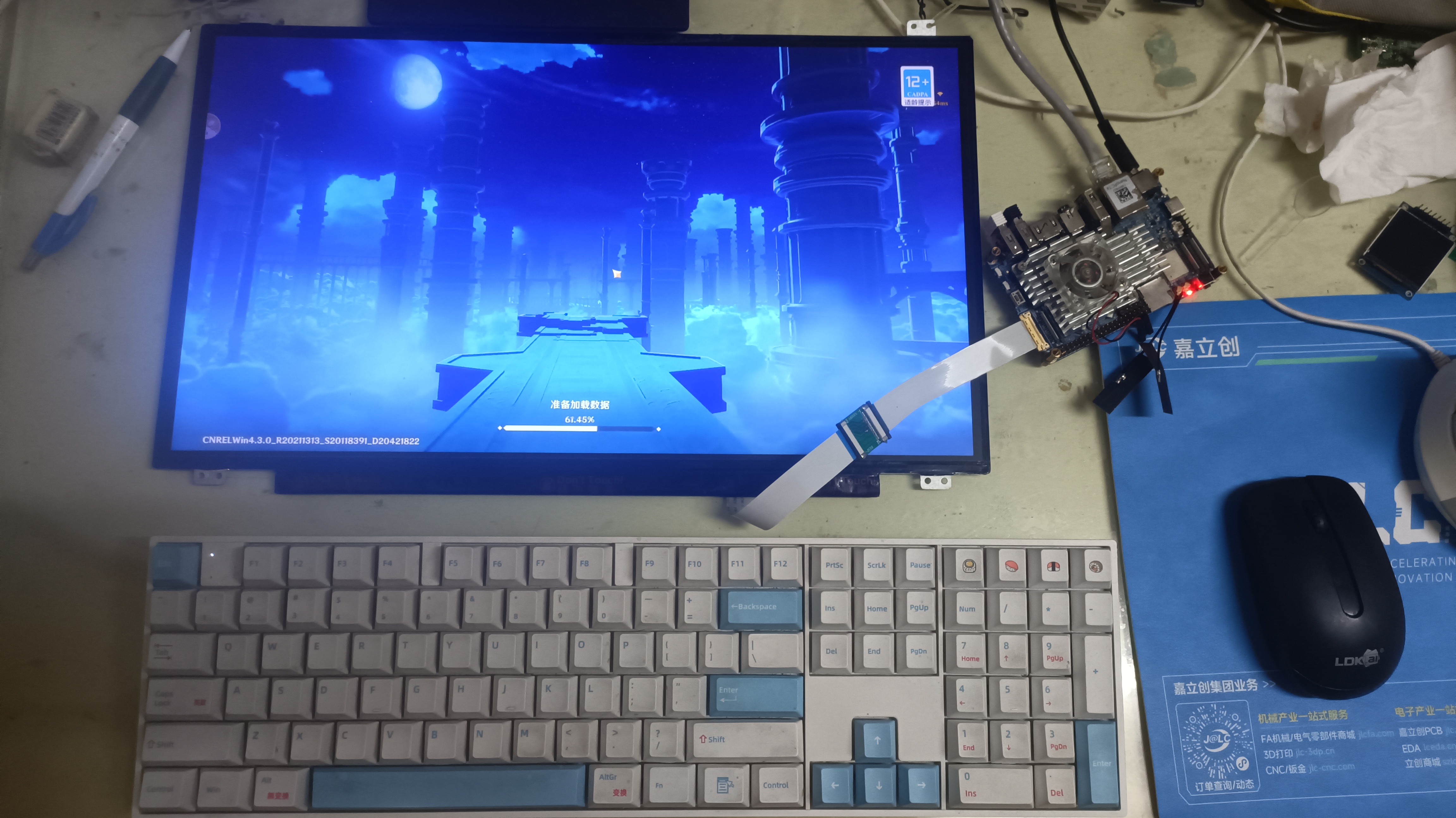

Finally, the screen lit up and I got to the desktop. The white bars were because the screen was defective; after replacing the screen, it returned to normal.
Finally, here's a picture of Genshin Impact using an adapter (doge).

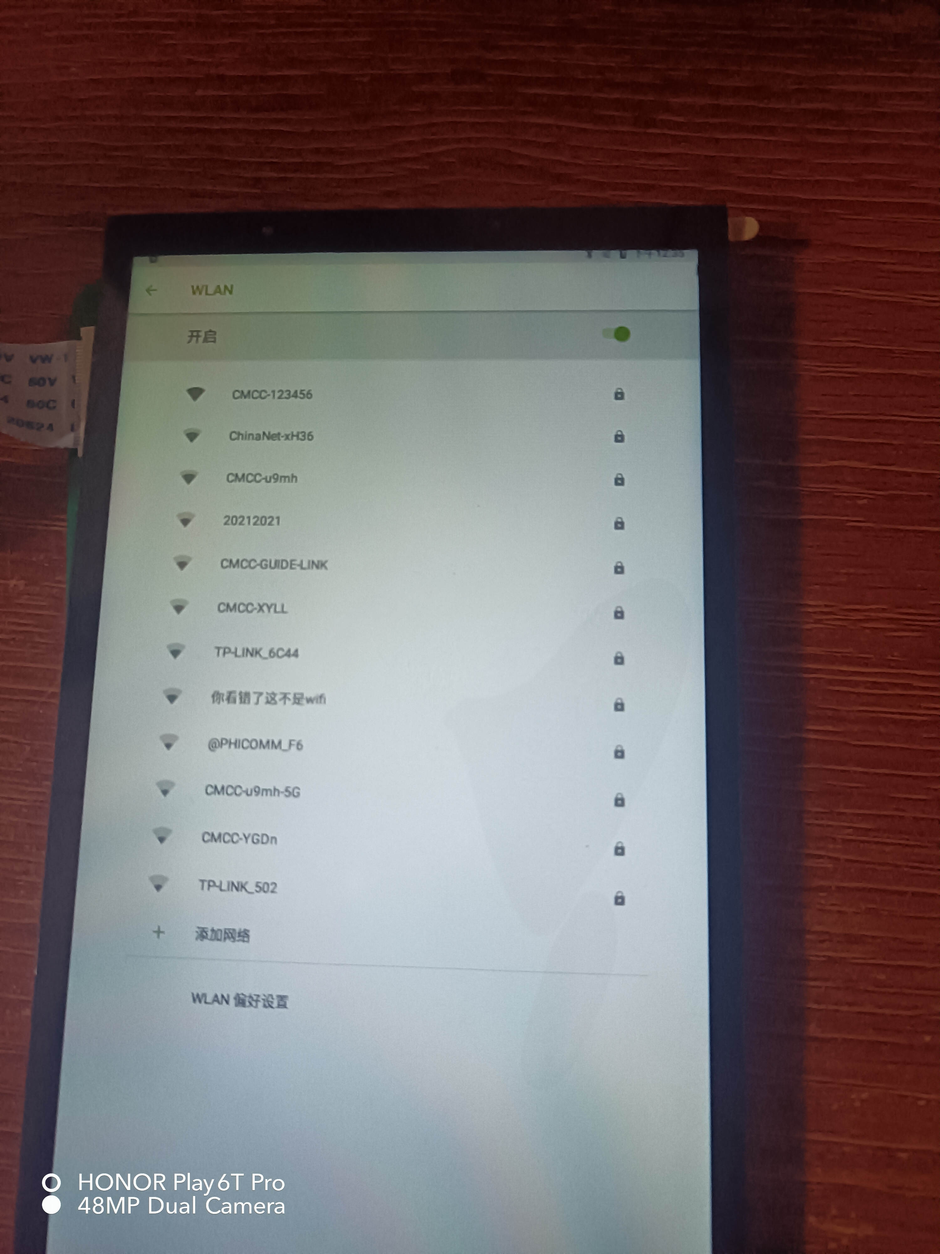

6-inch MIPI screen_King3399 driver board
A 6-inch MIPI screen driver board for the KING3399 development board, priced at 39.9 RMB on Xianyu (a Chinese online marketplace).
Please join group 290182516 to obtain the Android firmware (it's too large to upload), or compile it yourself. The DTS file has been released;
if you can't see the preview image, open it in the editor in the upper right corner.
