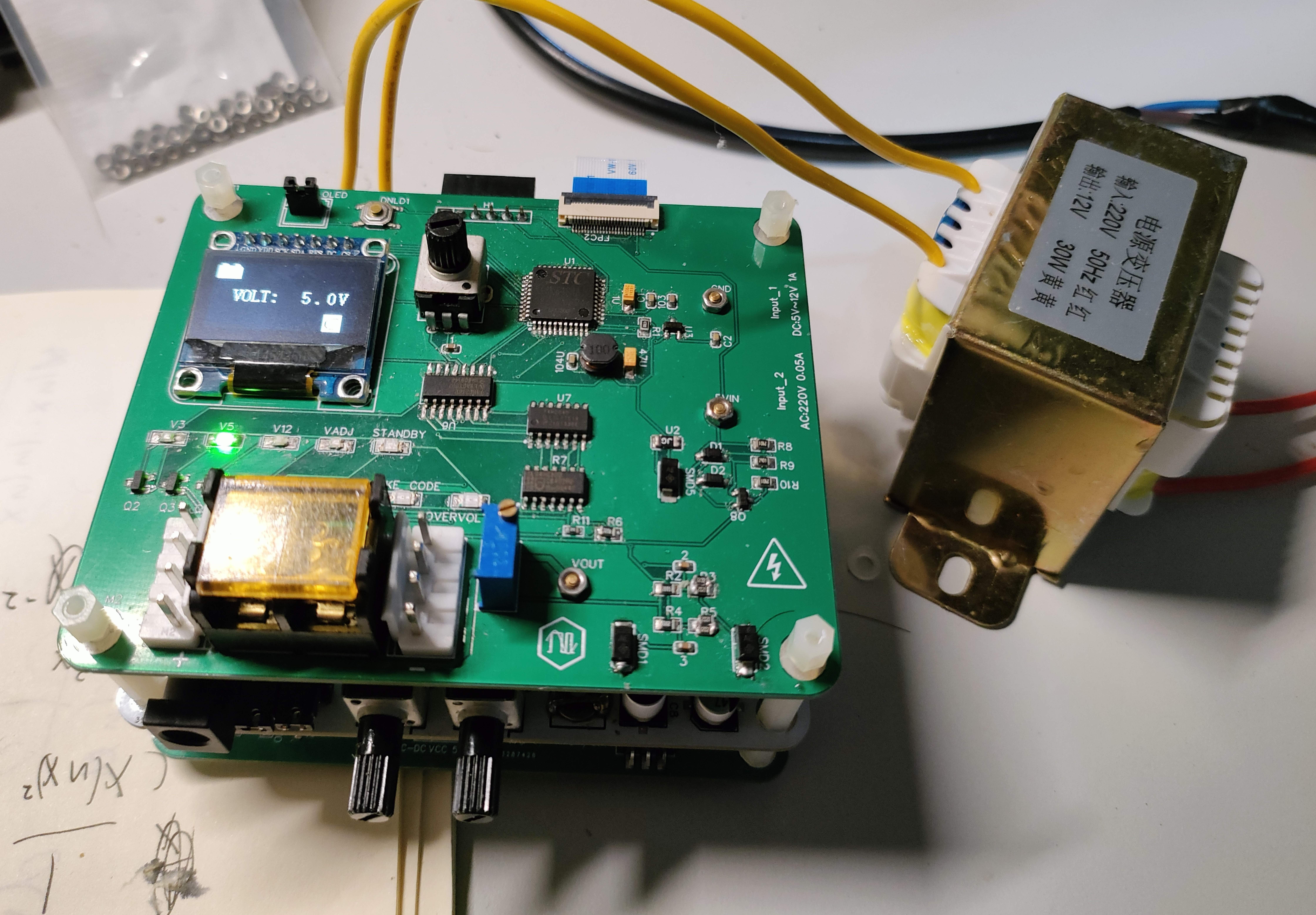

one. Function introduction
The power supply is controlled by STC8A8K64SMCU and has:
  1. Adjustable and fixed output modes;
  2. 0.96-inch OLED voltage display and Led working status indicator;
  3. Short circuit protection, output overvoltage and low voltage warning, input overvoltage protection;
  4. Hardware protection circuit during program debugging;
  5. AC 220V mains input and DC 4.5~12V wide voltage input.

(1) Fixed output power module
Fixed output modes include 3.3V, 5V, and 12V fixed voltage output modes. The corresponding model LM2596 is used as the power module. The function can be realized by connecting the enable terminal and signal line according to the correct wiring method.
(2) Output adjustable power module
         Select the LM2596-ADJ switching power supply module, use a knob potentiometer with two resistance values, one large and one small, in series as a feedback resistor. Rotate the knob to change the feedback voltage to achieve the output voltage adjustment function. A large resistance and a small resistance can achieve Coarse and fine voltage adjustment.

          Since the selected transformer has a maximum output current of 400mA (12V), and the conversion efficiency of the two-stage switching power supply is at most 80%, the output capability of this solution is very weak, with an output power of only 2.2W. Many feedback resistors have a narrow value range. Due to design negligence, incorrect values ​​may lead to the scrapping of the 5V LDO.

         Option 1 is only the first version of the prototype. Since the maximum output current of the transformer selected at that time is 400mA, and the conversion efficiency of the two-stage switching power supply is at most 80%, the output capability of the power supply is very weak, with an output power of only 2.2W. The values ​​of many feedback resistors in the lower layer are relatively precise. Due to design negligence, incorrect values ​​may lead to the scrapping of the 5V LDO;
2.Option 2:
          When the load is small and the output current is large, although the two-stage switching power supply module can barely support the output, the output voltage will decrease to varying degrees. In addition, the decrease in the output voltage of the first stage will cause the input voltage Vin of the second stage to decrease. When it is less than a certain threshold, the internally provided reference voltage V REF will also decrease, causing the voltage reduction effect of the second stage output to be superimposed, thus greatly reducing the Small output capability. The maximum output power of this solution is 15W (although the transformer is 30W, but the transformer is not fully charged, the efficiency is definitely more than 50%, but it is not much higher).
          To sum up, this plan only provides inspiration and is not suitable for reproduction;
3. Crazy rotation of the gear knob may cause false alarms, especially when turning directly from the "ADJ" gear that outputs the highest voltage (13.4V) to the "StandBy" gear. During the process of restarting the power supply and restoring it, please think about why you are turning it so crazily;
4. During operation, never directly touch the parts directly connected to the mains, such as transformer pins, fuse pins, etc. It is recommended to wrap them with insulating glue or rubber;
