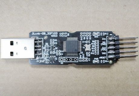

jlink-ob downloader
This is an improvement on a project on the LCSC open-source hardware platform. The original project used 0603 components, double-sided surface mount technology (SMT), which I changed to 0402 components, single-sided SMT. I don't really like double-sided SMT boards because the SMT processing cost almost doubles, and the processing time is also much longer. The firmware is the same as the original project firmware; I haven't made any changes.
