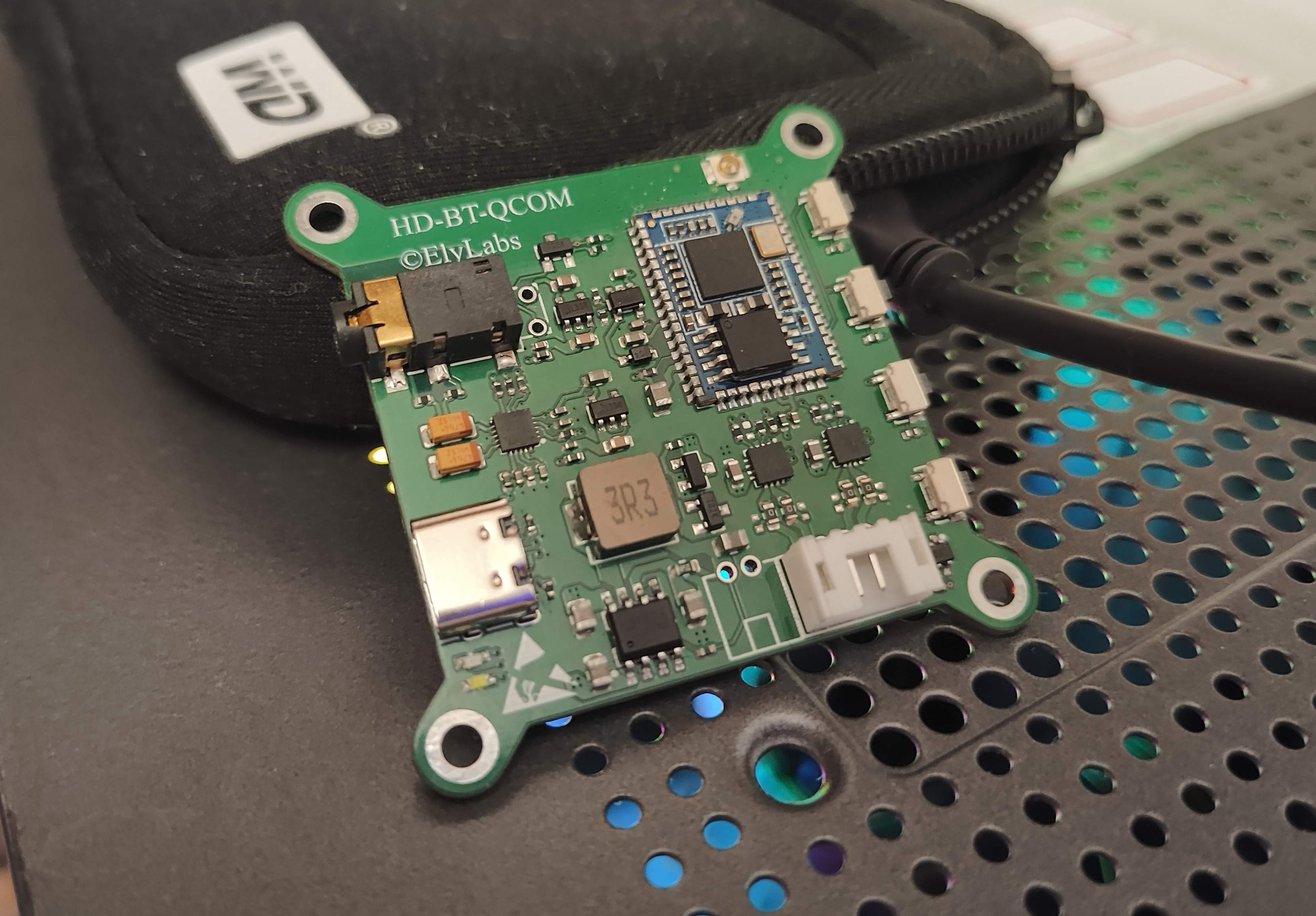

I. Project Introduction
      This project is a Bluetooth speaker solution based on the Qualcomm QCC3034 Bluetooth module. It achieves clear music playback and USB audio functionality through Bluetooth connection.

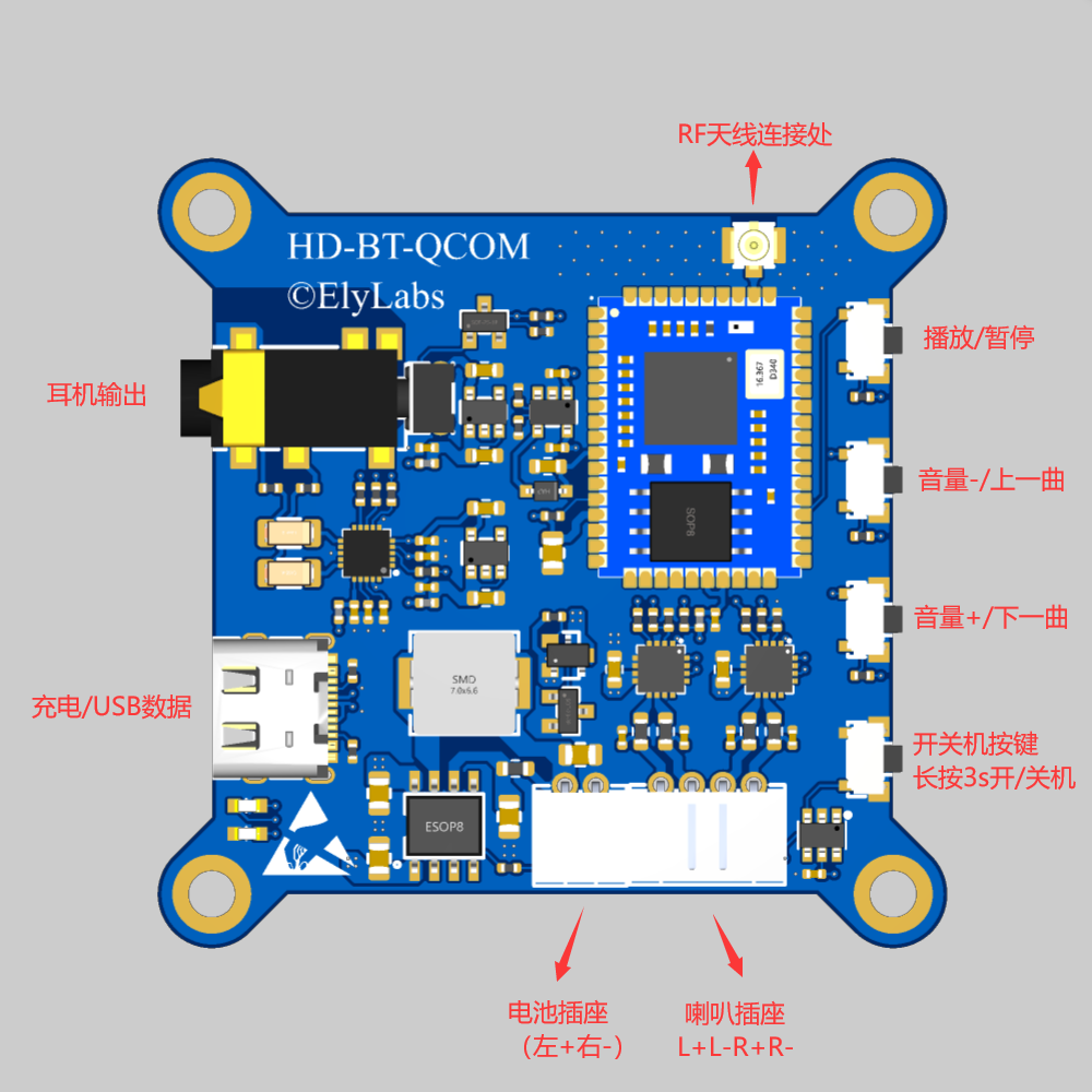

#0x04 Component Layout and Function Definition
: V. Main Function Verification

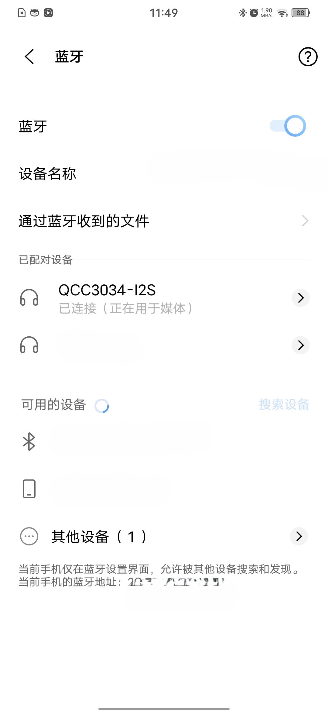

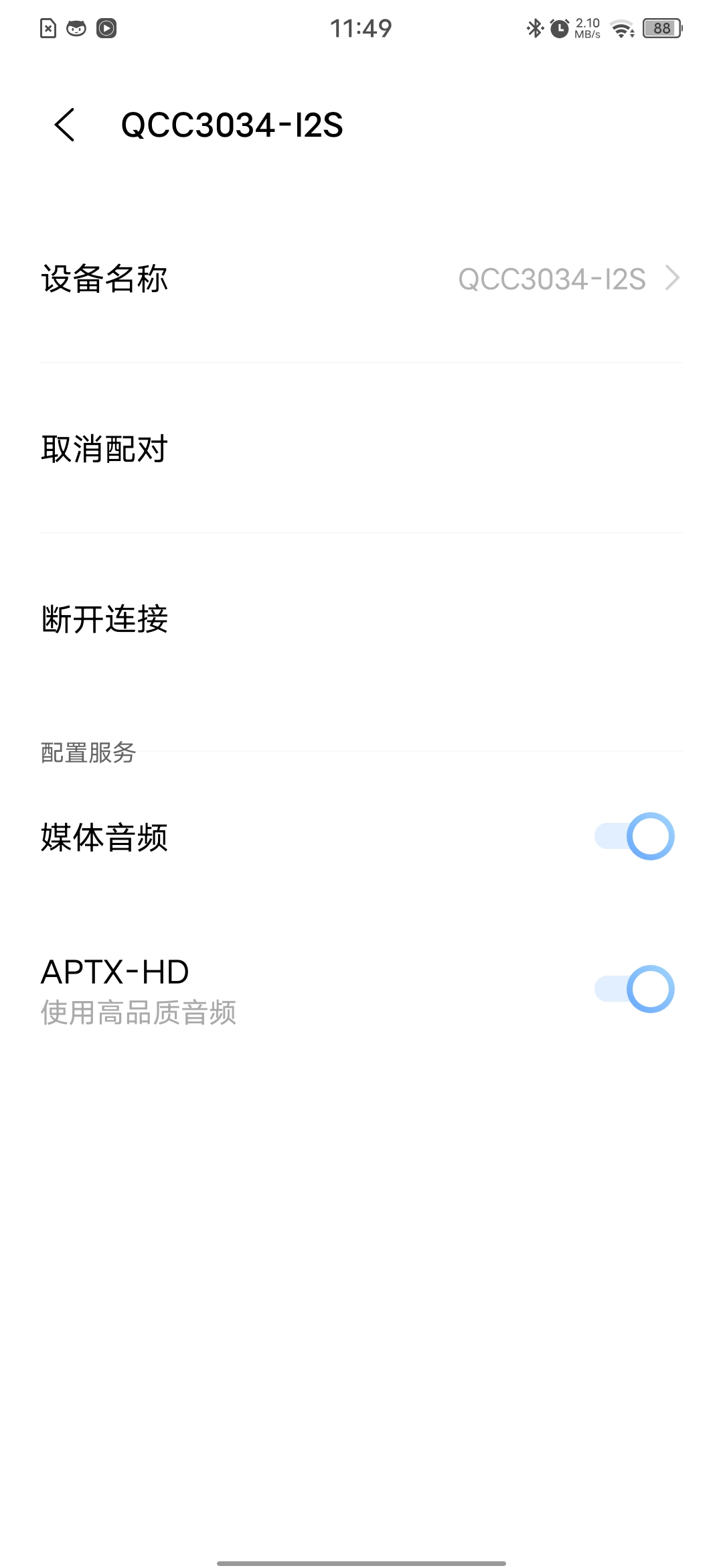

#0x01 Connecting to a Mobile Phone via Bluetooth
: Press and hold the power button on the board to power it on. It will automatically enter pairing mode. Open the Bluetooth settings on your mobile phone, and you will see the board's Bluetooth broadcast name, as shown in the figure below.
Since it has been paired before, the board will reconnect to the previously paired device upon power-on
. Mobile phones using Qualcomm chips will automatically enable aptX-HD configuration to improve the audio experience.

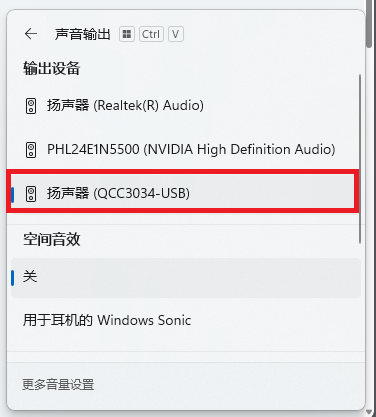

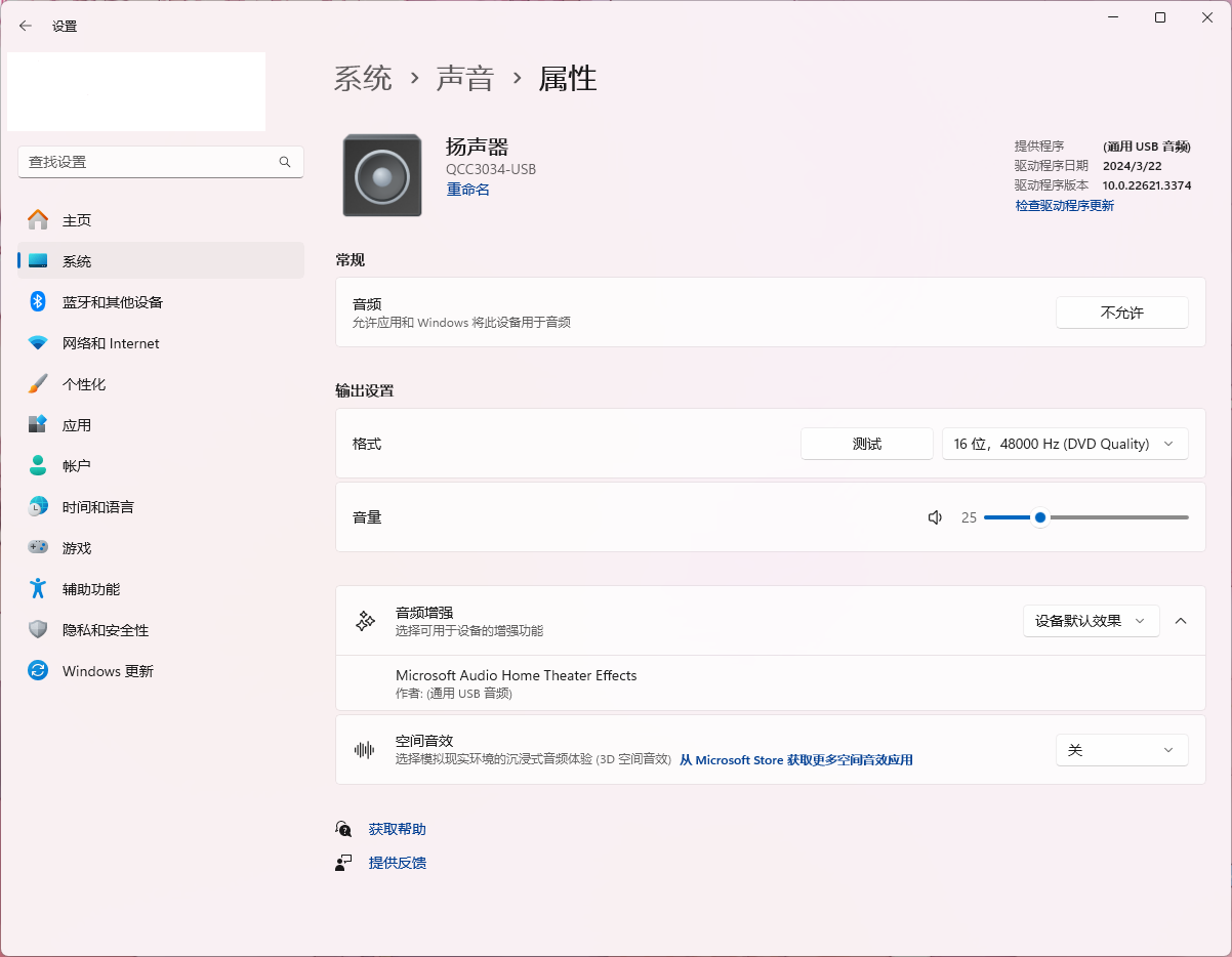

#0x02 Connecting to a Computer via USB:

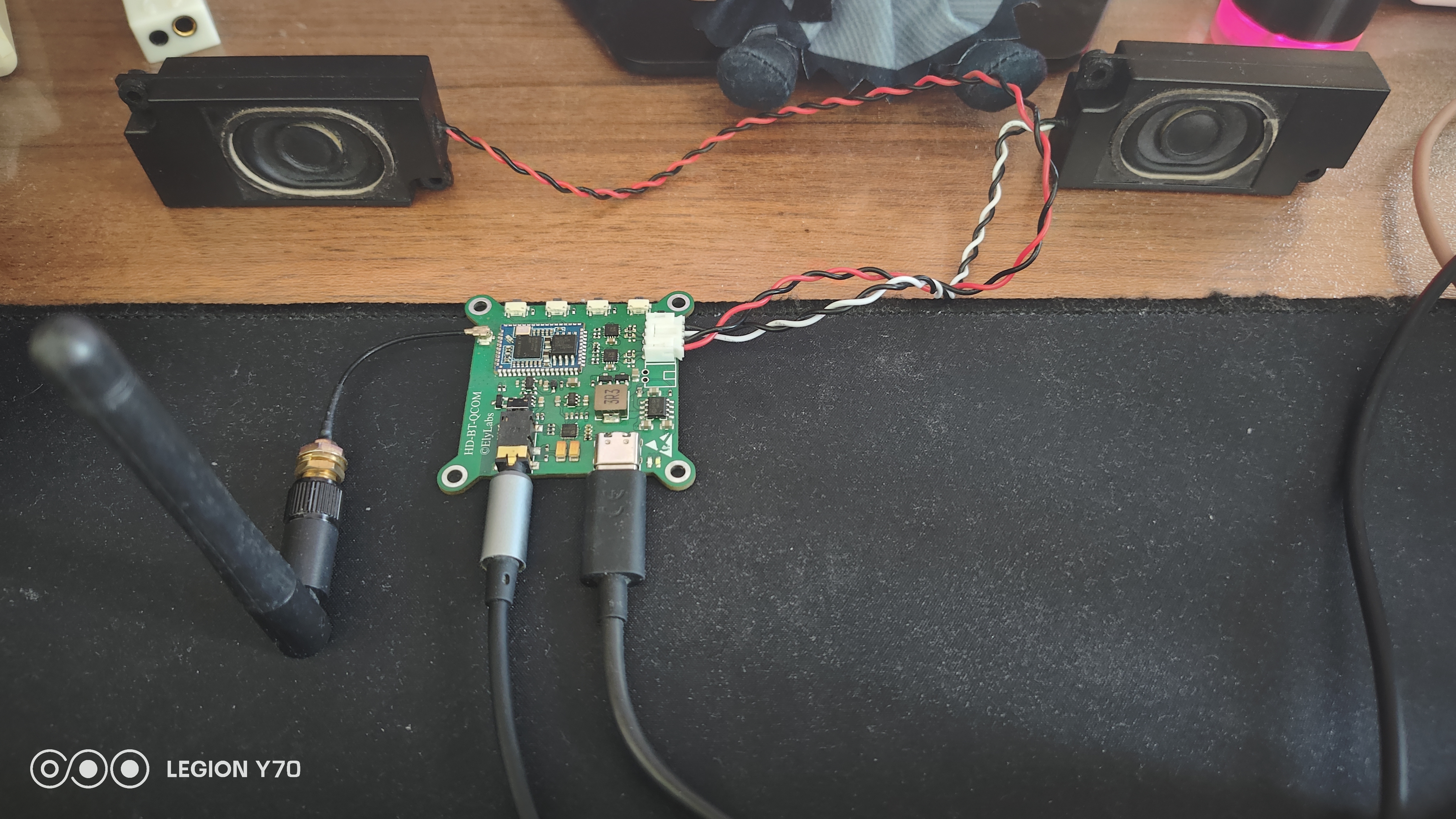

Connect the board to the computer using a USB data cable. The system will recognize it, and a new audio output device named "QCC3034-USB" will be added in the "Sound Output" option. Select this device, and the audio output by the system will be played through the board.
#0x03 Connecting Headphones
Connect wired headphones to the 3.5mm analog audio output jack on the board using an audio cable. Audio will play through the headphones, and the amplifier output will automatically turn off.
