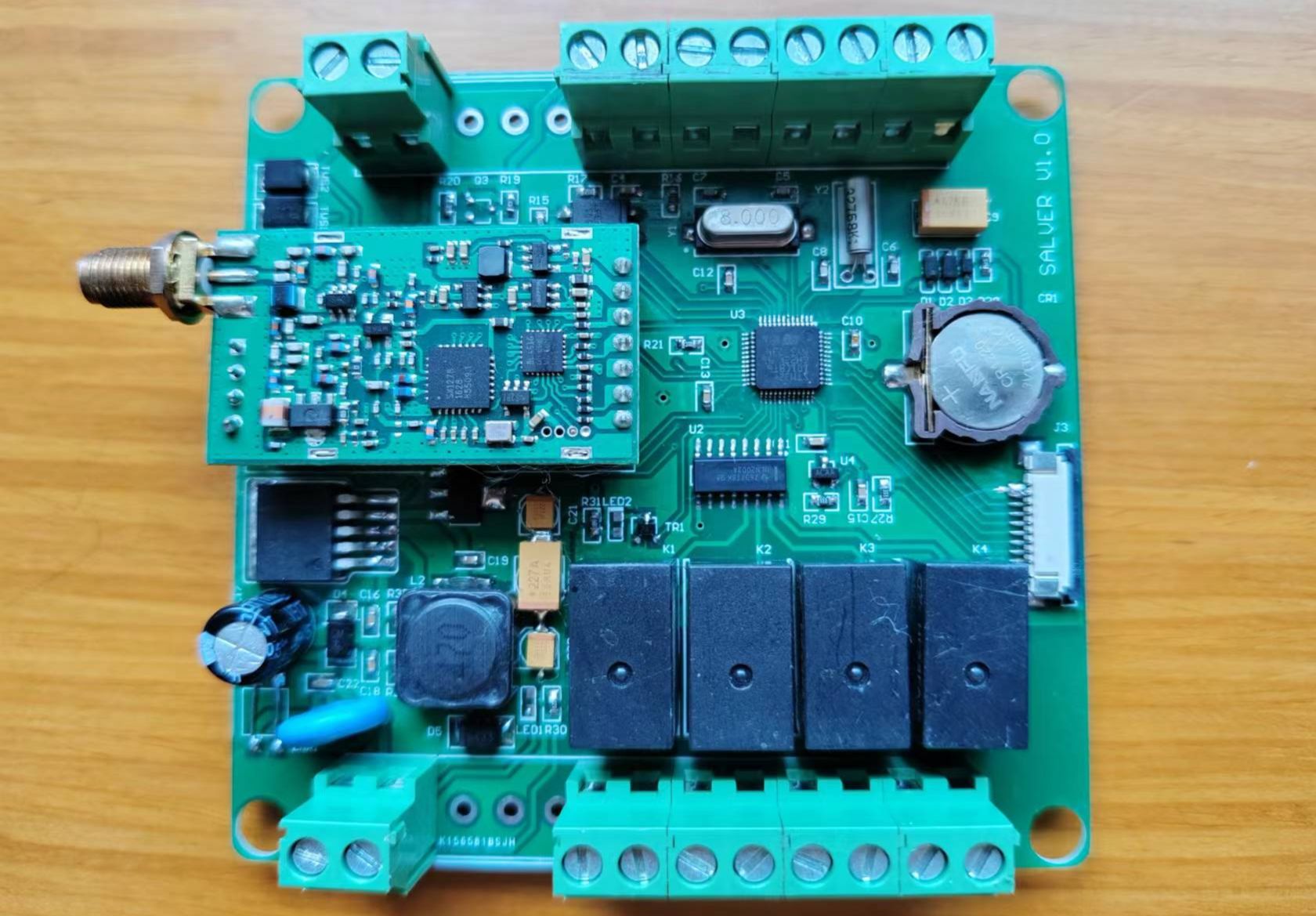

433M Wireless Controller - Slave

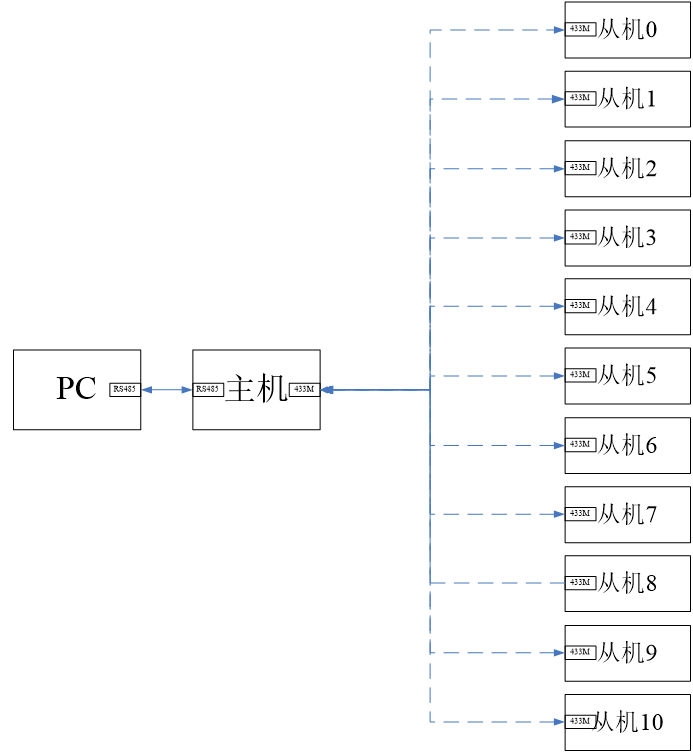

I. Wireless Controller Communication Method
The 433M wireless controller (hereinafter referred to as the wireless switch) adopts a one-to-many communication method, that is, one master communicates with multiple slaves through polling. This control system supports a maximum of 20 slaves. The PC-side host computer software can configure and acquire the status of the slaves.
II. Wiring Method
Wiring Pin Description
Terminal
Function
Master
Slave
+12V
Controller Power Supply Interface
Connect
to
GND
RA
Load Circuit Interface
Not Connected
Connect to
RA
RB
Not Connected Connect to RB RC Load Circuit Interface Not Connected Connect to RC RD Load Circuit Interface Not Connected Connect to RD B RS485 Communication Interface Connect to A NC Empty Interface Not Connected Not Connected 3V3 Photoresistor Interface Not Connected Connect to GND LIN COM Load Current Detection Not Connected Connected to CT Note: The controller electrical interface and the photoresistor interface are directional and cannot be reversed.
