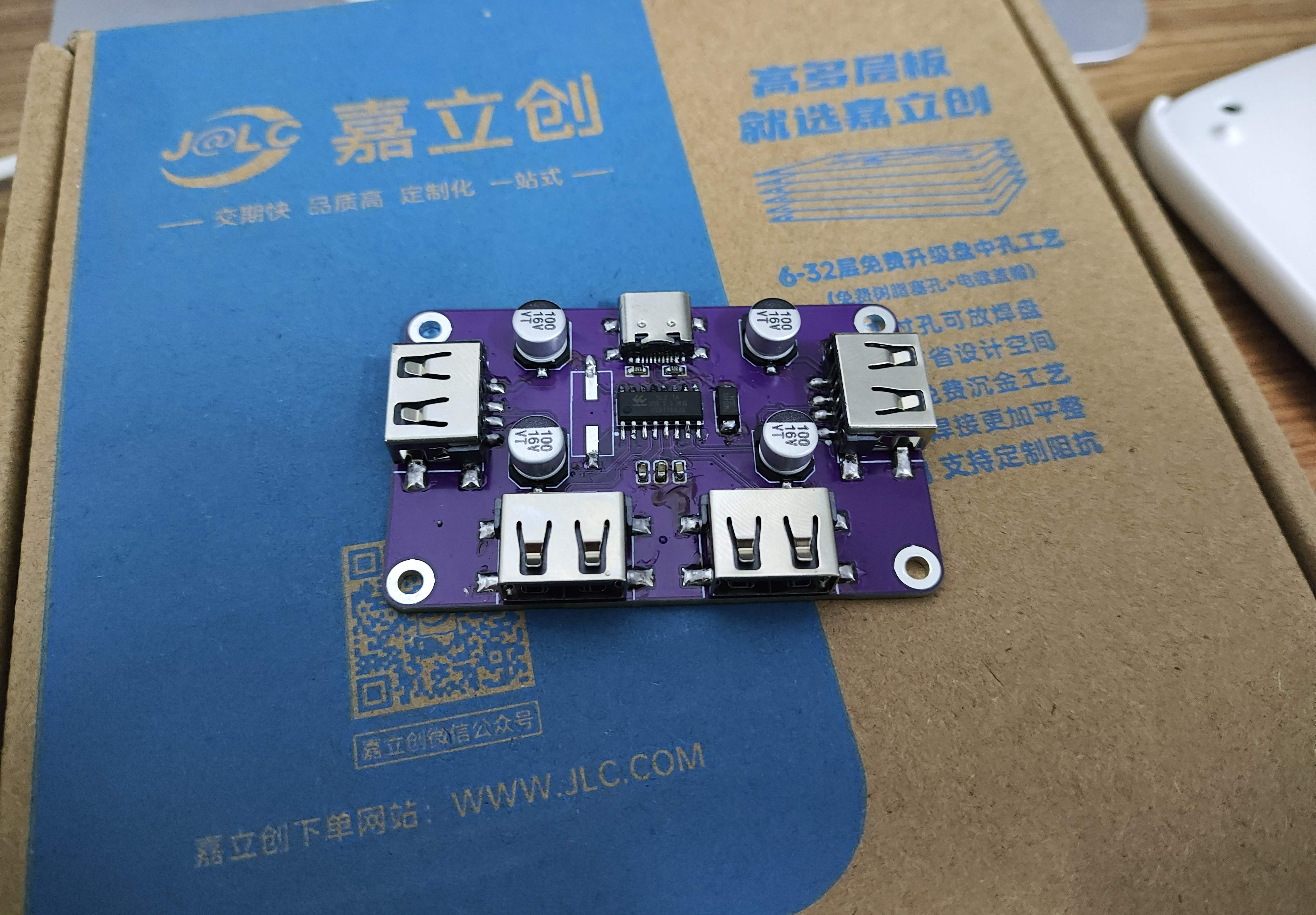

USB 2.0 HUB based on SL2.1A
Because I bought too many SL2.1A chips, I made a few HUBo boards (* ̄▽ ̄*)ブ.
I've already tested them, but I'm using them to connect a keyboard and mouse, so I didn't test the speed with a USB drive.
Regarding the crystal oscillator: In actual use, I found that if I solder an external crystal oscillator and plug it into the computer, it will repeatedly disconnect; if I remove the external crystal oscillator, it works normally. I don't know why (*Φ皿Φ*).
