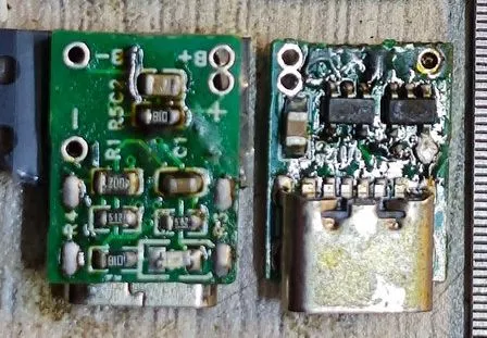

Mini Type-C lithium battery charging protection module + DC-DC step-down module
The DC-DC step-down module is a slight modification of the one described at https://oshwhub.com/jin3014/dc-dc-xiang-ya-xiao-ban-1-5v, with a more
aesthetically pleasing component arrangement. Its main feature is its small size, making it suitable for modifying lithium batteries in mice and electronic clocks. I've been using it for several months and am very satisfied. Using the DC-DC step-down module alone also provides discharge protection; the battery completely shuts off at a minimum voltage of 2.1V, whereas previously an LDO would completely discharge the battery.
