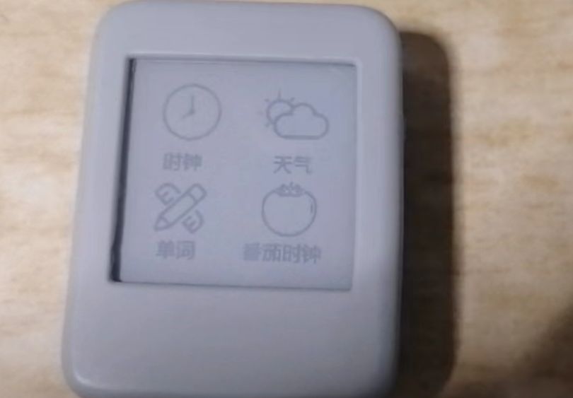

II. Actual Usage of this PCB :
I originally planned to build this a year and a half ago, but various reasons delayed it. I didn't have time to compile the code slowly; I simply used burning software to burn the bin file provided by "Xiao Zhi Xue Chang" to run it.
The hardware PCB has been running smoothly in my hands so far without any failures. The only drawback is that the corners and USB port area don't quite fit the small screen casing, possibly requiring some trimming of the casing or PCB.

VIII. Physical Display
