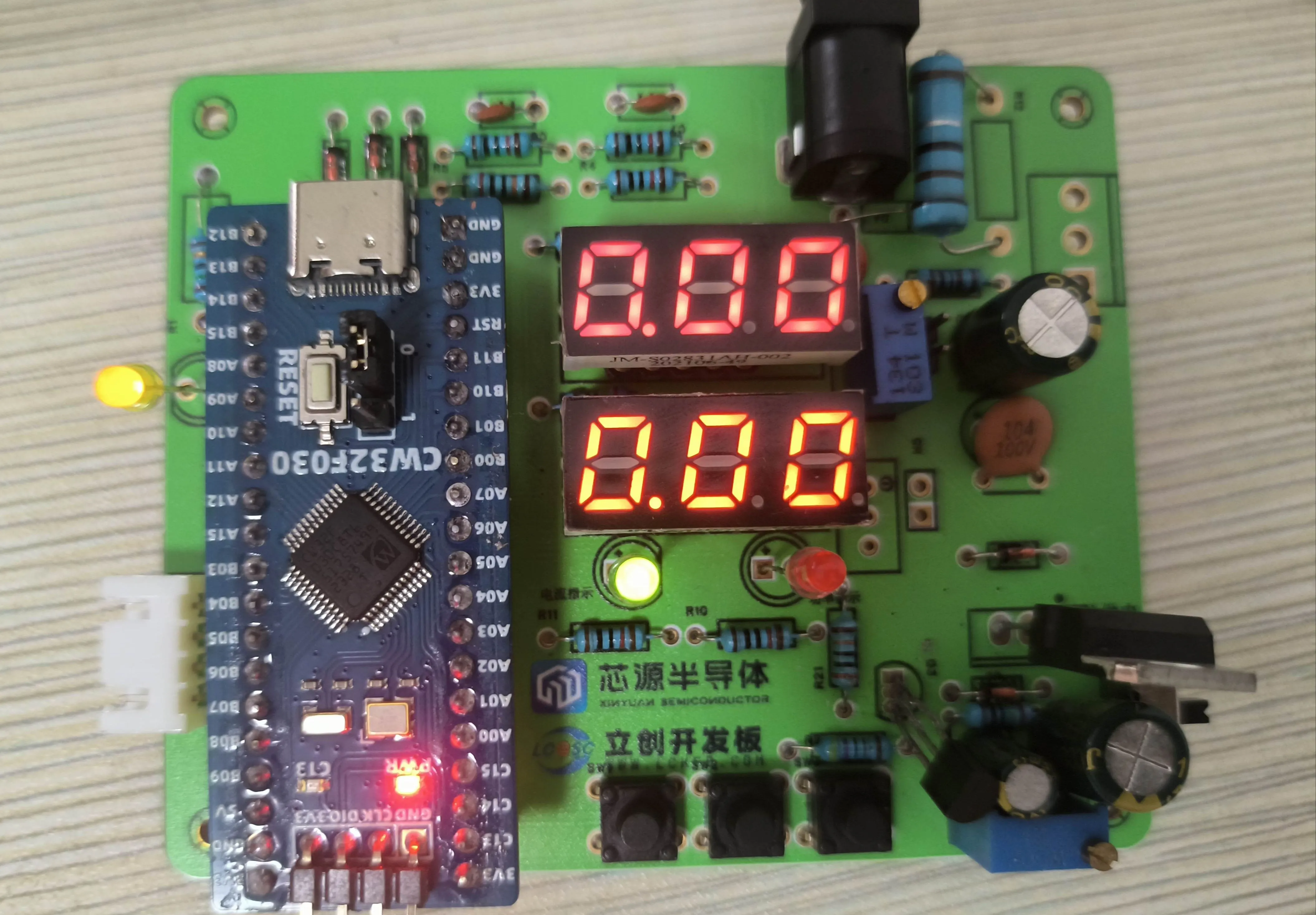

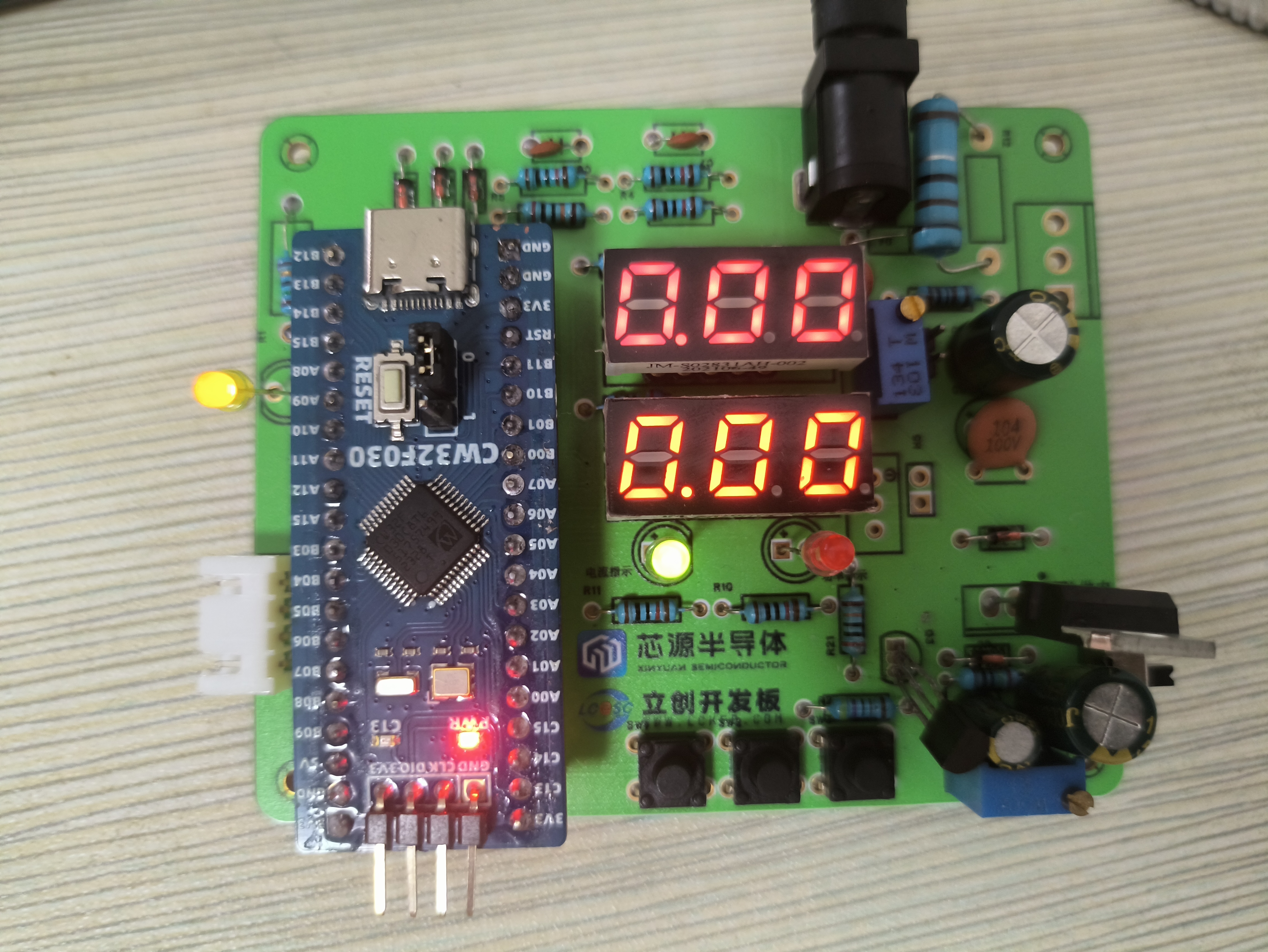

This project is a combined voltage and current meter and adjustable power supply device based on the LCSC CW32F030C8T6 development board, which can basically meet the desktop debugging needs of electronics enthusiasts. Compared with professional instruments, it has the advantages of convenient learning and low cost. It can be powered by a common DC2.1 switching power supply, with a wide voltage range, supporting up to 30V input.
Project Functions:
This design is a temperature and humidity alarm system based on the LCSC CW32F030C8T6 development board; it features voltage detection, current detection, output voltage of 1.3V-27V, and can provide a 1.2A load capacity (with good heat dissipation). Overcurrent protection thresholds can be set for the output voltage (software implementation), and it displays current or power switching. Project
Parameters
: Voltage detection range: 0-30V;
Current detection range: 0-3A.
It can detect the voltage and current values ​​of the tested circuit in real time;

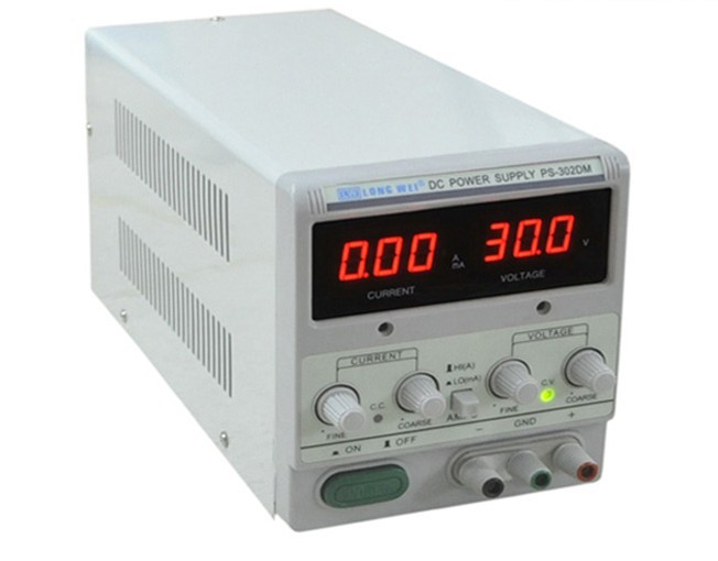

it can provide external power supply capacity, basically replacing the desktop adjustable power supply.
It displays current or power switching.

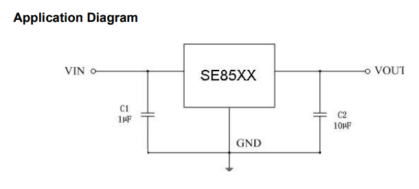

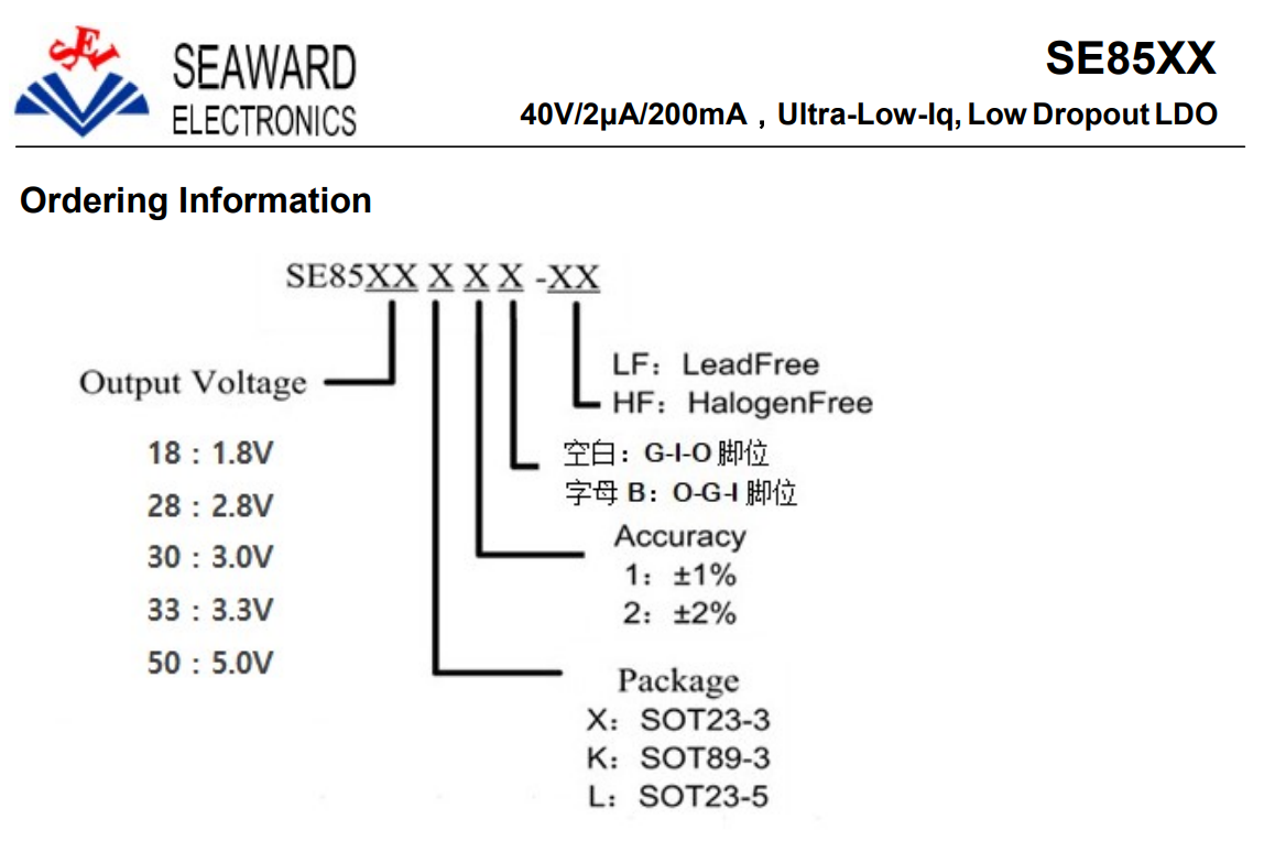

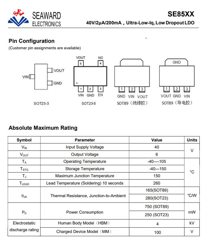

LDO (Low Dropout Linear Regulator) Selection
This project uses an LDO as the power supply. Considering that most voltmeter products are used in industrial scenarios with 24V or 36V power supplies, the SE8550K2 with a maximum input voltage of 40V was selected as the power supply. The main reason for not using a DC-DC buck converter to handle the large voltage drop is to avoid introducing DC-DC ripple interference during the design process; a secondary reason is to reduce project costs. From the table in the datasheet screenshot, it can be seen that the SOT89 package (165℃/W) offers better thermal resistance (Junction-to-Ambient) compared to the SOT23 package (280℃/W). For the LDO model selection
, since the project's main control board is powered by 5V, the SE8550K1-HF is selected based on the ordering information in the table below. It outputs 5V, and K indicates the SOT89 package, offering better ±1% accuracy. HF or LF is related to environmental requirements and needs to be considered in actual product design. This is not a concern for this project. The capacitor design manual provides an application schematic for this LDO: almost all LDO devices operate on essentially the same principle in circuit design. Therefore, this schematic is not very useful for reference. The key consideration is often how C1 and C2 should be designed. If your LDO has an EN (enable) pin, you also need to consider the design of the enable pin to ensure the chip functions properly. In addition, some LDOs have adjustable outputs, which have a dedicated pin (adj) that requires the configuration of corresponding external resistors to achieve the specified output voltage. The most crucial aspect of LDO peripheral circuit design is the capacitor design. The capacitors surrounding the LDO play a critical role in the circuit, primarily in the following ways: Filtering: The capacitors surrounding the LDO, especially the input capacitor, can effectively filter out ripple interference from the preceding power supply. Improving load transient response: The output capacitor plays a vital role in improving load transient response. When the load current changes drastically, the LDO has an adjustment time. During this time, the output capacitor acts as a temporary power supply, providing the necessary current to the circuit and preventing the output voltage from being pulled too low. A larger output capacitor value can further improve the LDO's transient response to large load current changes.

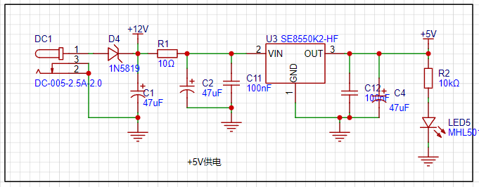

Phase Compensation: For adjustable output LDOs, the capacitor connected in parallel with the upper resistor (R1) (called the feedback capacitor CFB) provides leading phase compensation, increasing oscillation margin and improving load transient response. Zeroing both CFB and R1 contributes to loop stability.
Oscillation Prevention: Proper capacitor configuration helps prevent oscillations in the LDO circuit, ensuring stable circuit operation.
Ripple Suppression: Capacitors in LDOs also help improve the power supply rejection ratio (PSRR), reducing the impact of power supply noise on circuit performance.
Startup Inrush Current Control: The input capacitor acts as a temporary power source for startup inrush current during LDO startup, preventing the input voltage from being pulled low and affecting the stability of the preceding power supply.
Summary: The capacitors surrounding the LDO play a crucial role in filtering, improving load transient response, phase compensation, oscillation prevention, ripple suppression, and startup inrush current control. Proper configuration of these capacitors ensures the stability and performance of the LDO circuit.
If you carefully review the datasheet, you'll find detailed suggestions and references, as well as layout design recommendations. This avoids engineers performing extensive theoretical calculations.
It's worth noting that in my power supply design, I used electrolytic capacitors and ceramic capacitors connected in parallel, one after the other. When electrolytic and ceramic capacitors are connected in parallel, they complement each other, providing good filtering in both high and low frequency ranges. The electrolytic capacitors filter out low-frequency interference, while the ceramic capacitors filter out high-frequency interference; their combination achieves better filtering.
In practical electronic products, the main function of electrolytic capacitors connected in parallel with ceramic capacitors is to achieve high and low frequency filtering and coupling through their complementary characteristics, thereby improving circuit performance, stability, and anti-interference capabilities. This parallel connection method is widely used in electronic devices.
When electrolytic and ceramic capacitors are used in parallel, the electrolytic capacitors first filter out the low-frequency portion of the input voltage, providing a stable DC voltage for the circuit. This helps ensure the stability and reliability of the circuit at low frequencies.
Subsequently, the ceramic capacitors further compensate for high-frequency fluctuations, filtering out high-frequency noise and pulse hazards. This high-low pairing filtering method can more effectively filter out noise and fluctuations across the entire frequency band, improving the overall performance of the circuit.
Furthermore, ceramic capacitors can eliminate the inductive characteristics (parasitic inductance of capacitors) generated by electrolytic capacitors at high frequencies, further improving the filtering effect.
When beginners try to understand the functions of capacitors such as DC blocking, coupling, bypassing, filtering, tuning circuits, energy conversion, and control, they should first return to basics and understand the essence of capacitors: capacitors are used to store charge and electrical energy and can release these stored charges in the circuit.
To briefly explain why capacitors around the MCU should be placed nearby: distant solutions are ineffective. When MCUs and other devices are using electricity, the current value on the line may change abruptly. Sometimes, to maintain the demand for abrupt current on the MCU (i.e., the physical quantity formed by the directional movement of charge), a nearby capacitor is needed to release charge.
The magnitude of the current reflects the amount of charge passing through the cross-section of a conductor per unit time, an important physical quantity describing the state of charge movement in the circuit. To

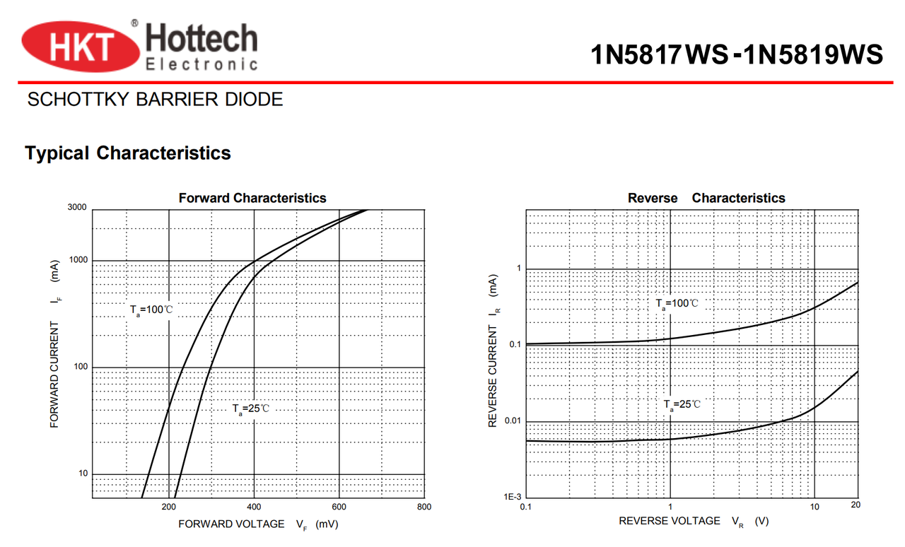

prevent reverse connection
, considering that high-voltage reverse connection can cause irreversible damage to the module, the voltmeter power supply circuit uses a series diode scheme for reverse connection protection.
Note: This project uses series diodes for reverse connection protection because the power supply voltage of this equipment is usually higher than 5V. The 0.7V voltage drop of the diode will not affect the power supply. When the power supply voltage is low, the overall power consumption of the project is low, and the measured power supply current is low (20mA). Due to the unique structure of the Schottky diode D4 (1N5819), its VF is lower than that of general switching diodes, as shown in the figure below, with a voltage drop of approximately 0.2V or less.
In conventional circuit design, the reverse connection protection and circuit protection can also be achieved by using a reverse parallel diode + series fuse.
Diode voltage-current curve
. The role of the series small resistor (10Ω):
This project additionally uses a series small resistor (10Ω) for voltage division. On the one hand, it reduces the problem of severe heat generation of the LDO due to the large voltage difference under high voltage conditions. On the other hand, it utilizes the principle that the series 10-ohm low-power resistor has low overcurrent, acting as a low-resistance fuse, providing overcurrent protection or short-circuit protection. (The point where the resistor acts as a fuse is that, because the resistor is in an overcurrent state and heating state, it is 99% open circuit, and it will basically not short circuit. Its fault analysis determines that it is basically open circuit. That is, it burns out and will not short together.)
The small series resistor (10Ω) can also reduce the peak value of the power-on surge and avoid damage to the LDO
due to excessive surge. If electrolytic capacitors are not used, the small series resistor (10Ω) can also prevent the conductor inductance and ceramic capacitor from resonating during hot plugging and unplugging. Because ceramic capacitors have very low ESR, the damping in the LC network is very small, and the gain at the resonant point will be very high. Adding an external resistor to provide damping can suppress the gain at the resonant point.

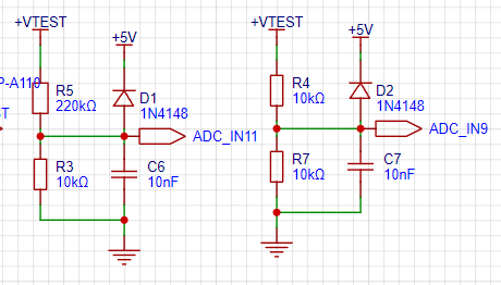

This project uses a voltage divider circuit to achieve high voltage acquisition, designed to acquire voltages up to 100V; the current configuration acquires voltages from 0-30V.
Figure 5
shows that the voltage divider resistors in this project are 200K+10K, so the voltage division ratio is 20:1 (ADC_IN11).
The voltage divider resistor selection
is based on the maximum measured voltage. For safety reasons, this project uses 30V (the actual maximum can be 99.9V or 100V).
The ADC reference voltage in this project is 1.5V, which can be configured through the program.
To reduce the power consumption of the sampling circuit, the low-side resistor (R7) is usually selected as 10K based on experience.
Then, the high-side resistance of the voltage divider resistor can be calculated using the above parameters. The
required voltage division ratio is calculated as follows: ADC reference voltage: Design input voltage, which can be calculated using known parameters as 1.5V/30V=0.05.
The high-side resistance is calculated as: Low-side resistance/voltage division ratio, which can be calculated using known parameters as 10K/0.05=200K.
A standard resistor is selected: A resistor slightly higher than the calculated value is chosen. The calculated value is 200K. We usually choose E24 series resistors, so in this project, we choose 200K, which is greater than 200K and closest to it.
If, in actual use, the voltage to be measured is lower than 2/3 of the module's design voltage (66V), the voltage divider resistor can be replaced and the program modified to improve measurement accuracy. The following example illustrates this:
Assuming the measured voltage is no higher than 24V and other parameters remain unchanged,
calculations show 1.5V/24V = 0.0625, 10K/0.0625 = 160K. 160K is a standard E24 resistor and can be directly selected, or a higher value 180K can be chosen with some redundancy.
If, in actual use, the voltage to be measured is higher than the module's 99V design voltage, a different resistor can be selected. To expand the voltage measurement range, you can choose to replace the voltage divider resistor or modify the reference voltage. Here's a case study:
Assuming the measured voltage is 160V, we can choose to increase the voltage reference to expand the range.
Given that the voltage division ratio of the selected resistor is 0.0145, we can calculate 160V * 0.0145 = 2.32V using the formula. Therefore, we can choose a 2.5V voltage reference to expand the range (increasing the range will reduce accuracy).
Considering the potential fluctuations in the measured power supply, a 10nF filter capacitor is connected in parallel with the low-side voltage divider resistor to improve measurement stability.

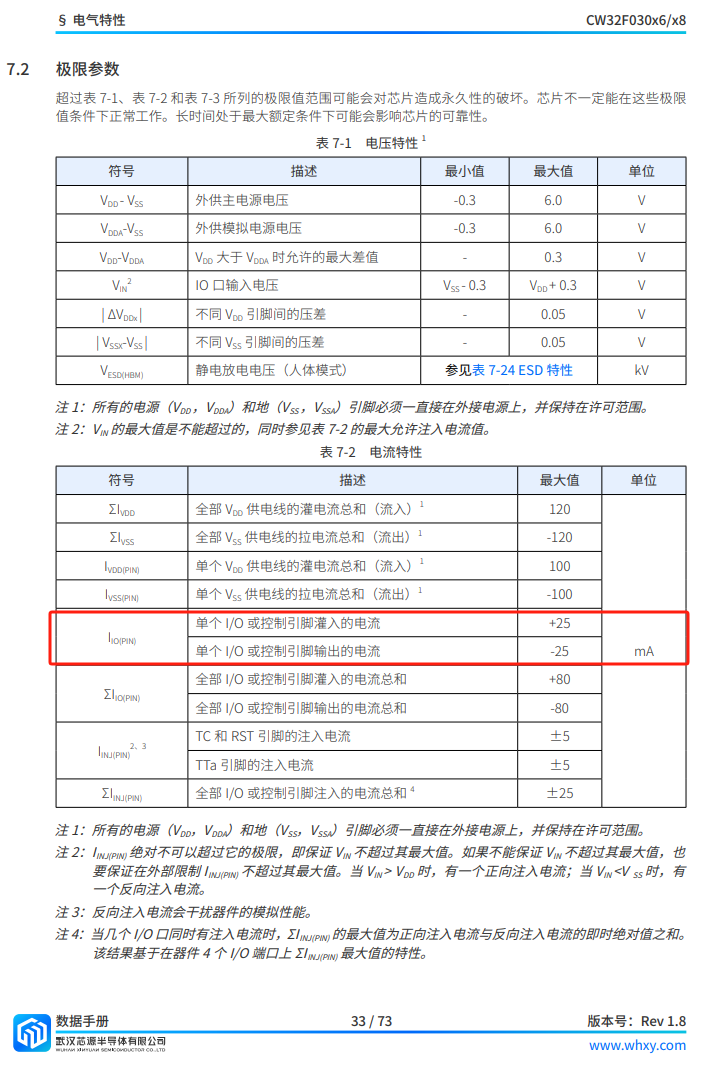

Diode clamping ensures MCU safety
. In designing this project, I added an additional 1N4148 (D1, etc.) as a clamping diode to the sampling circuit. This helps avoid damage to the chip pins due to incorrect voltage input during learning and debugging. Diode clamping is an important electronic circuit design technique; its main function is to protect the circuit by limiting the voltage amplitude, preventing damage or malfunction caused by excessively large or small signals.
In circuit design, clamping refers to limiting voltage. Diode clamping specifically refers to the technique of using a diode to limit the potential at a point in a circuit.
Diode clamping primarily utilizes the unidirectional conductivity of a diode. When the voltage across the positive terminal of the diode is greater than the voltage across the negative terminal and the diode is turned on, the voltage across the diode is limited to its voltage drop across the diode, typically around 0.7V for a silicon diode.
The clamping process involves forcibly pulling the clamped potential towards the reference terminal through the diode's clamping action, thus limiting the potential. Clamping does not change the waveform of the original signal; it only raises or lowers the reference potential.

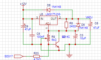

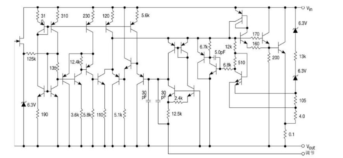

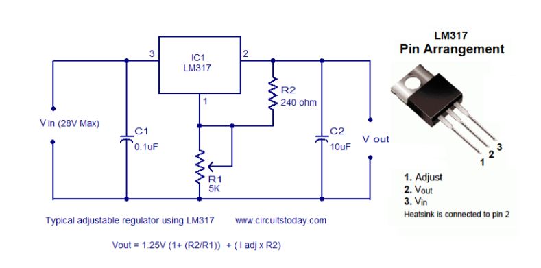

is an adjustable 3-terminal positive voltage regulator, and its working principle is based on a series voltage regulator circuit. The output voltage is adjusted by adjusting the conduction level or equivalent resistance of the internal switching transistor. The LM317 generates a lot of heat during operation because its internal switching transistor has limited output current. To output a larger current, an external power transistor is needed for expansion. The LM317 has an output voltage range of 1.25V-37V and a maximum output current of 1.5A. It incorporates overcurrent and overtemperature protection.
The LM317 is one of the most widely used power supply integrated circuits. It not only features the simplest form of a fixed three-terminal regulator but also offers adjustable output voltage. Furthermore, it boasts a wide voltage regulation range, good voltage regulation performance, low noise, and high ripple rejection ratio. The LM317 is an adjustable three-terminal positive voltage regulator that can provide over 1.5A of current from 1.2V to 37V. This regulator is very easy to use.
The LM317 is suitable for various applications, including local and card-type regulation. This device can also be used to create programmable output regulators, or, by connecting a fixed resistor between the regulation and output, the LM317 can be used as a precision current regulator. The LM317 regulator circuit operates based on the principle of feedback circuitry, controlling the input voltage by adjusting the output voltage to achieve a stable output voltage. The following is a typical positive voltage regulator circuit using the LM317:
As shown above, this is a classic regulator circuit using the LM317. The input voltage is fed into pin 3 (Vin) of the IC, and the stable output voltage can be obtained from pin 2 (Vout) of the IC. The resistor network consists of R1 and R2, connected to pin 1 (adj), used to set the output voltage. C1 is the input filter capacitor, and C2 is the output filter capacitor. The output voltage of the regulator circuit depends on the formula, Vout = 1.25V(1 + (R2/R1)) + IadjR2. The circuit principle of the LM317 mainly includes the following aspects: Basic working principle: The LM317 adjusts the output voltage by adjusting the conduction level or equivalent resistance of the internal switching transistor. This adjustment is achieved by the voltage difference formed between the output and adjustment pins. You can use two resistors connected between the output and input pins to change the output voltage. In addition, two decoupling capacitors can be connected to a circuit. This integration can eliminate unnecessary coupling and prevent noise. A 1µF capacitor connected to the output improves transient response. It can then be used as a variable regulator by clicking the potentiometer on the adjustable pin. The resistor and potentiometer work together to create a potential difference that regulates the output. Current limiting function: The LM317 regulator has an "adjustment terminal," or "ADJ terminal," which enables current limiting by connecting a resistor R1 and a potentiometer R2 in series between the regulator's output and adjustment terminal. This design allows control of the output current by adjusting the potentiometer, protecting the circuit from overcurrent damage. Application examples: The LM317 is widely used in various power supply circuits, including but not limited to adaptive adjustable power supplies, 0~±30V, 1.5A power supply circuits, and electronic transformer-regulated power supply circuits. These applications demonstrate the versatility and flexibility of the LM317 in providing stable voltage output. In summary, the LM317 circuit principle is based on a series regulator circuit, achieving stable voltage output through the adjustment of the internal switching transistor, and using external components to achieve current expansion and current limiting functions. These characteristics make the LM317 an indispensable power management component in electronic devices. The following is the schematic diagram used in this project , with the transistor base connected to a current-limiting resistor. This allows the microcontroller's I/O port to control the enable and pull-down of the output when excessive current is detected in the external power supply circuit. This LM317 circuit cannot output 0V; the minimum output voltage is 1.25V. ... Project Highlight 1. Mixed use of AH and BH digital tubes:

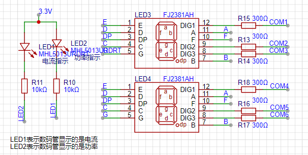

There are two types of digital tubes: common cathode and common anode. Their pin arrangements are the same, only the cathode and anode are swapped. Since I already have two digital tubes, one common cathode and one common anode, this problem arose. This is a good opportunity to verify and learn whether the two types of digital tubes can be used interchangeably. As we
learned in the previous section on digital tube display principles, only two steps are needed to display:
1. Pull high the anode of the LED inside the digital tube;
2. Pull low the cathode
. Therefore, modifying the AH and BH settings to mix them only requires reversing these two steps.

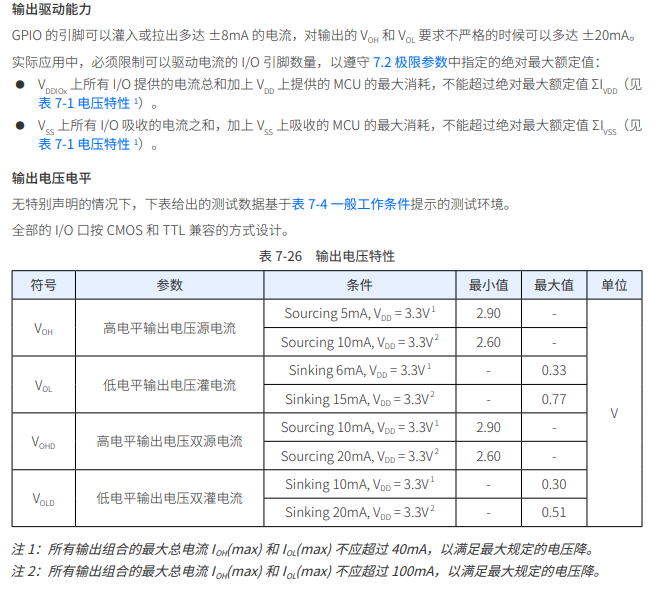

Here we use GPIO_LowByte_Write(CW_GPIOA,Dis_Value); to output the 8 IOs corresponding to the segment at once, which can complete the operation IO quickly, efficiently, and concisely.

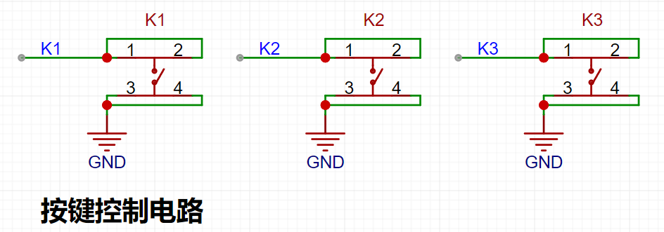

2. Key Debouncing:
`if(GPIO_ReadPin(CW_GPIOC,GPIO_PIN_15)==GPIO_Pin_RESET)
keytime++;
} else if(keytime>=100)
keytime=0; // Continuous
Mode++;
if(Mode>=7)Mode=0;
BrushFlag=1; // Continuous
else keytime=0;`
This debouncing mechanism only responds to the key when it is released. Actual testing shows good results, with almost no issues like double-clicking or failure to trigger. This design also makes it easy to add long-press functionality. Long-press functionality can be added with simple modifications.
3. Power Display:
void DisplayBuff(void)
if (DisplayCurrentFlag) {
DisplayI(I_Buffer);
GPIO_WritePin(LED_PORT, LED_PIN_C, GPIO_Pin_RESET);
GPIO_WritePin(LED_PORT, LED_PIN_P, GPIO_Pin_SET);
} else {
GPIO_WritePin(LED_PORT, LED_PIN_C, GPIO_Pin_SET);
GPIO_WritePin(LED_PORT, LED_PIN_P, GPIO_Pin_RESET);
DisplayI(I_Buffer*V_Buffer/100);
In the function that updates the display buffer, add the function to display the power. Since the power and current are in units of 10mV or 10mA, the power display directly uses the function for current display, so the unit needs to be converted to 10mW.

6. Overcurrent protection:
void Get_ADC_Value(void)
if (OCP_mode && Curr_Buffer[cnt] > OCP_Current *4069/1500 ){
GPIO_WritePin(SD317_PORT, SD317_PIN, GPIO_Pin_SET);
OCP_triged = 1;
The current protection function needs to be rapid to play a protective role, so we set the judgment condition to judge the data immediately after the ADC conversion.
If the overcurrent protection value is exceeded, the LM317 output will be immediately pulled low, and the flag bit will be set. The main program will then display a prompt based on the flag bit.

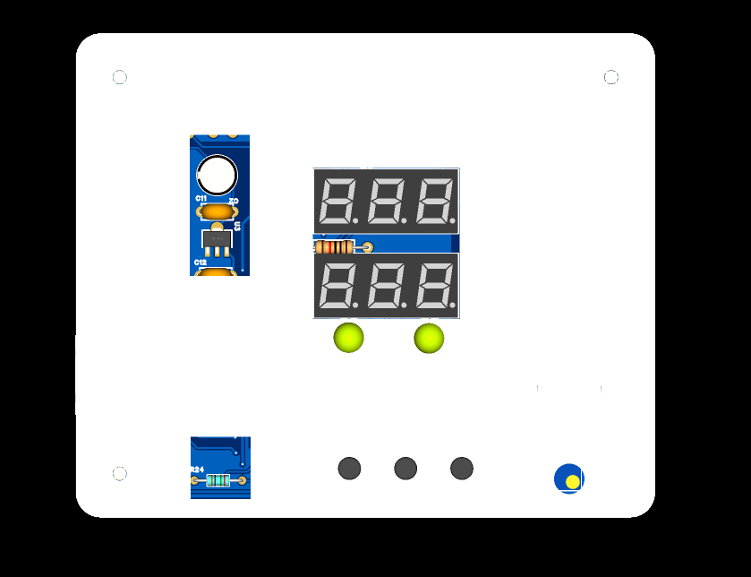

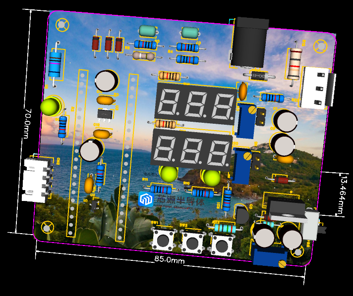

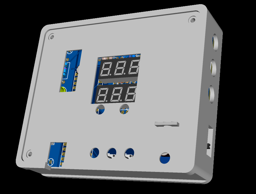

PCB layout
diagrams: 1. PCB dimensions
; 2. Right front side opening
; 3. Front view.
