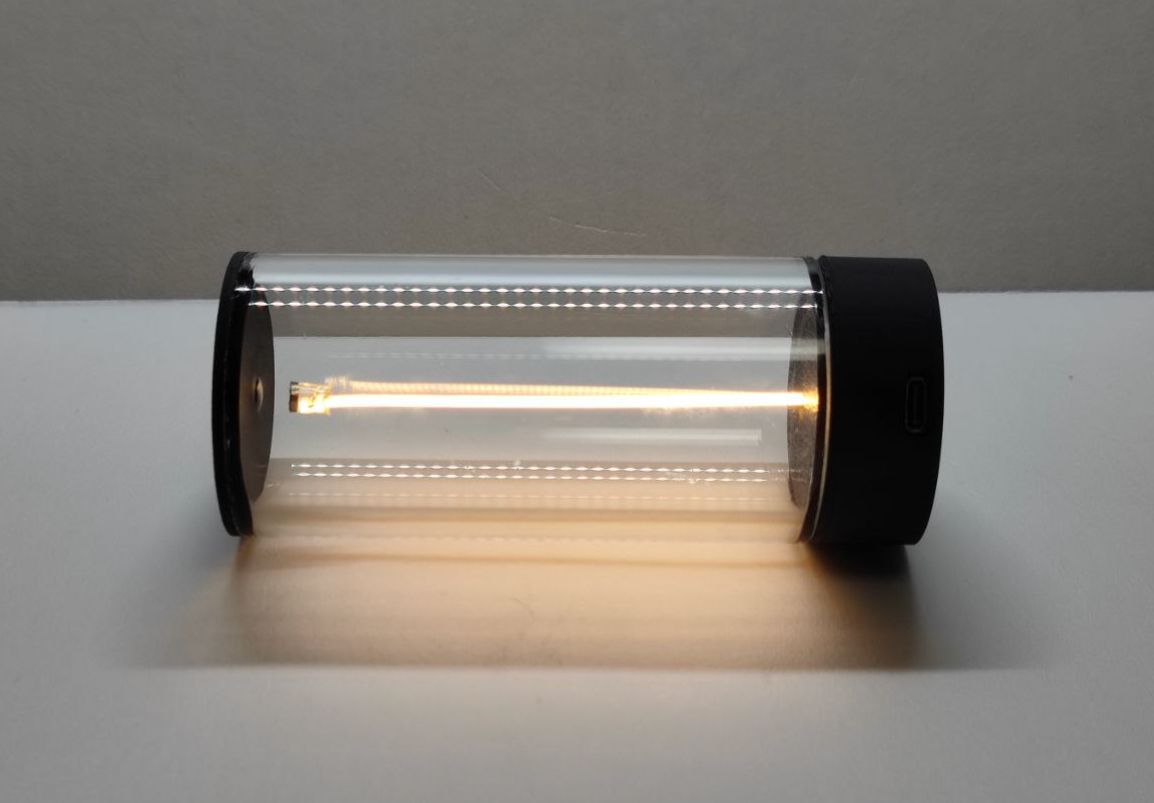

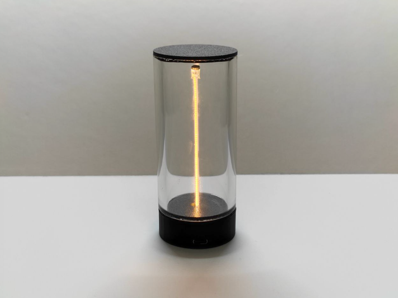

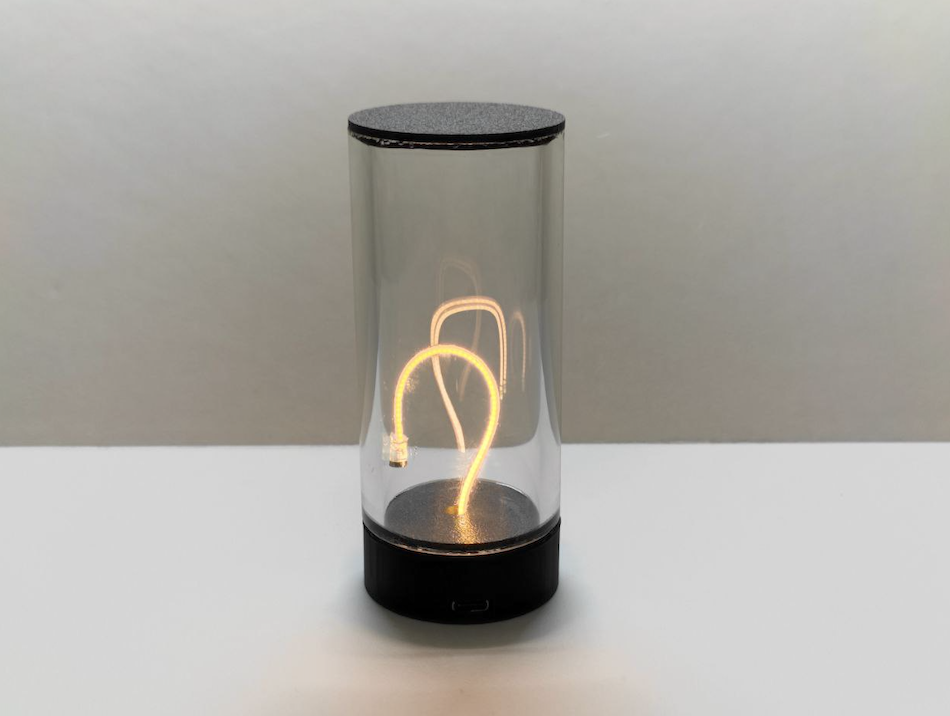

This ambient light is based on a PT8022W LED and flexible filament.
It can be turned on and off with a single touch, and the brightness can be adjusted by a long press, allowing for stepless brightening and dimming.
Materials and Costs:
Flexible LED light filament, 110mm diameter;
high borosilicate glass tube, 50x100x5mm, 8.8 yuan;
mainboard PCB, free prototyping by JLCPCB; 0 yuan
lithium battery, 802540 850mA, 12.8 yuan
charging chip GX4057; touch chip PT8022W (domestic alternatives available); capacitors, resistors, and miscellaneous components, totaling 3 yuan;
neodymium magnets, 5x2mm, 2 pieces; top and bottom covers, 0.4 yuan
; 3D printing – who doesn't have a 3D printer? That's not even a factor in the cost.
