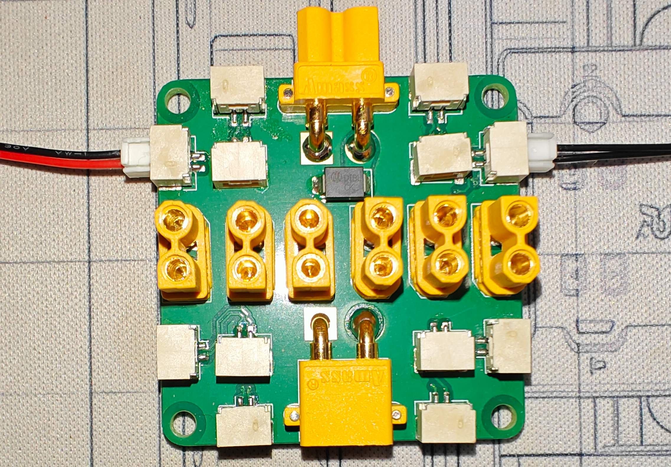

XT30 CAN splitter
Note: This is a KiCAD project! Please
ensure
it is used with the baseplate. The bottom copper layer is VCC, and exposed solder joints without covering pose a short circuit risk.
The project drawing shows the effect without a vertical mounting interface. The GH1.25 socket can be directly replaced with either a horizontal or vertical mounting. Therefore, this is for photography purposes.
Note that
the hole positions are consistent with the DJI C-board, and the dimensions are consistent with the official DJI ESC center board.
The vertical XT30 uses a wire-bonding type, and
the horizontal XT30 uses a board-bonding type.
The CAN interface is a GH1.25 2P interface
