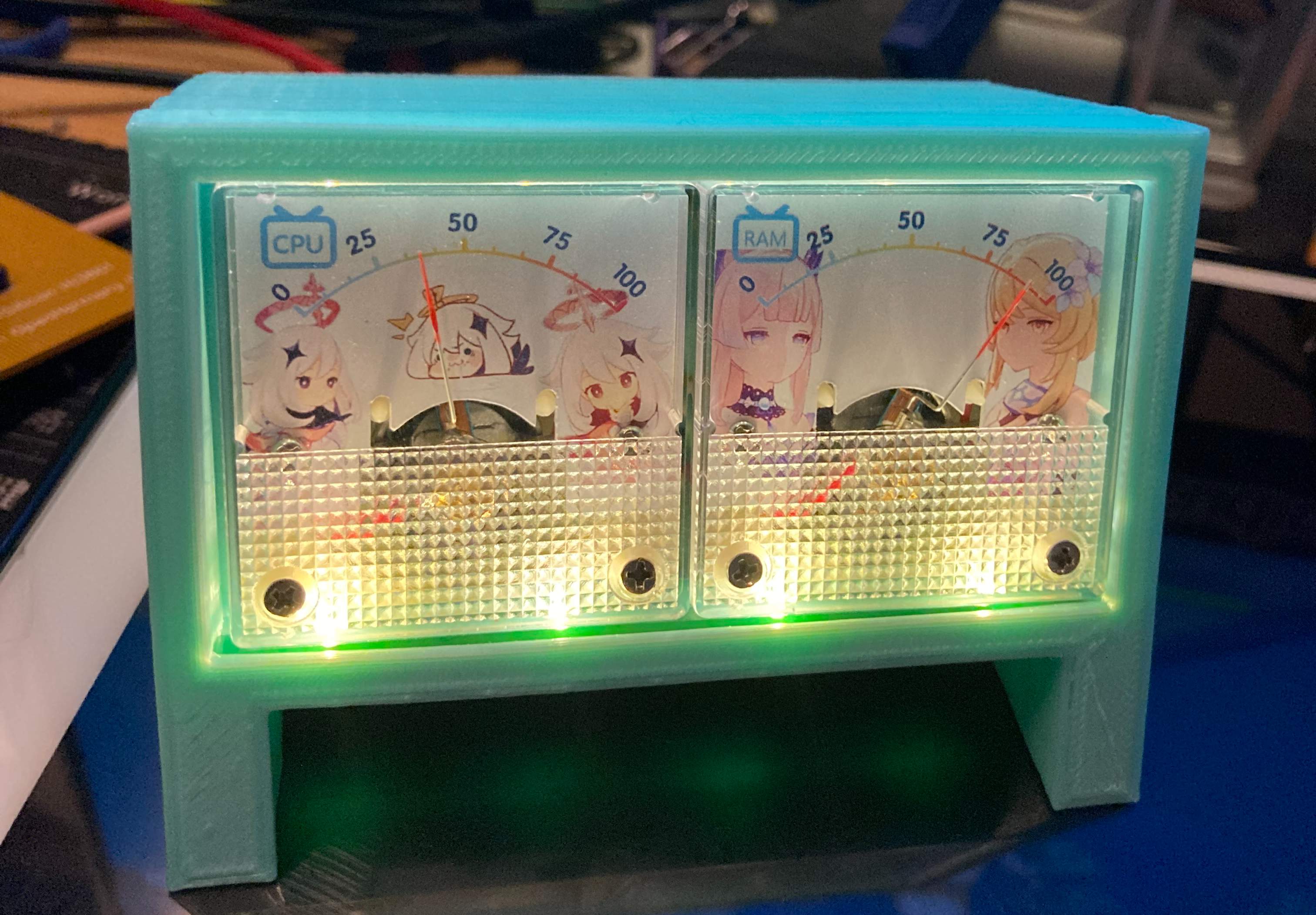

Computer status display table based on Qinheng CH571
## Declare that this project is a replica project. The original projects referenced are: [ShaderFallback/CpuRamGet: Esp32 monitor client (github.com)](https://github.com/ShaderFallback/CpuRamGet) and [Computer status based on STM32 Display - Freeak EDA open source hardware platform (oshwhub.com)](https://oshwhub.com/freeak_miku/CpuRamGet)
The inherited license is GPLv3, and the original author cannot use it for commercial use ## Existing design defects PWM output is not connected to CH571 on hardware PWM. You can use CH573 or use software to simulate PWM. This program uses simulated PWM.
The current PCB has been modified to TIM pins, but the program is still written based on the original pins. Please see the attachment for the PCB details of the two versions. ## Improvements to the original project* Use CH571 to reduce costs* Redesign the casing to increase the angle and make viewing data more comfortable* Add a light bar (although the actual effect is emmm) ## Project functions and TODO* [x] USB CDC virtual serial port* [x] Serial port parses AIDA64 string* [x] PWM output data to voltmeter* [x] LED light logic: The serial port lights up for 30s after receiving a parsable string* [ ] Bluetooth serial port* [ ] MRS support* [ ] Display pointer control algorithm (PID seems to be available) ## Mechanical part The mechanical part uses the shell drawn by SW2020, and is optimized for unsupported printing. ## The electrical part of the hardware part uses CH571 as the main control, which reduces the cost. It also has a Bluetooth that can connect devices through Bluetooth for serial data transmission. ## Program part The program is mainly divided into USB receiving and parsing strings, PWM output, light bar control, etc. Program warehouse address: [kaidegit/ComputerOccupyingMonitor: Computer information display instrument (github.com)](https://github.com/kaidegit/ComputerOccupyingMonitor)
