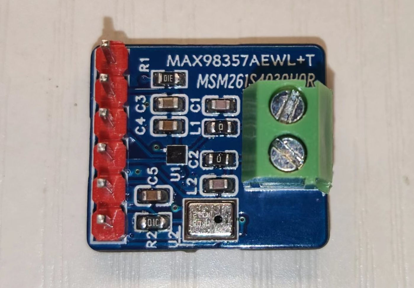

ESP32S3 Mono Speaker Microphone Test Board
The module features an onboard MSM261S4030H0R digital microphone and a MAX98357AEWL+T digital amplifier. Both use a single I2S BCLK and WS signal, requiring only four wires to add speaker and microphone functionality to the project.
Test code
IDF5.2
ESP32-S3 N16R8
Note that psram is enabled in menuconfig
