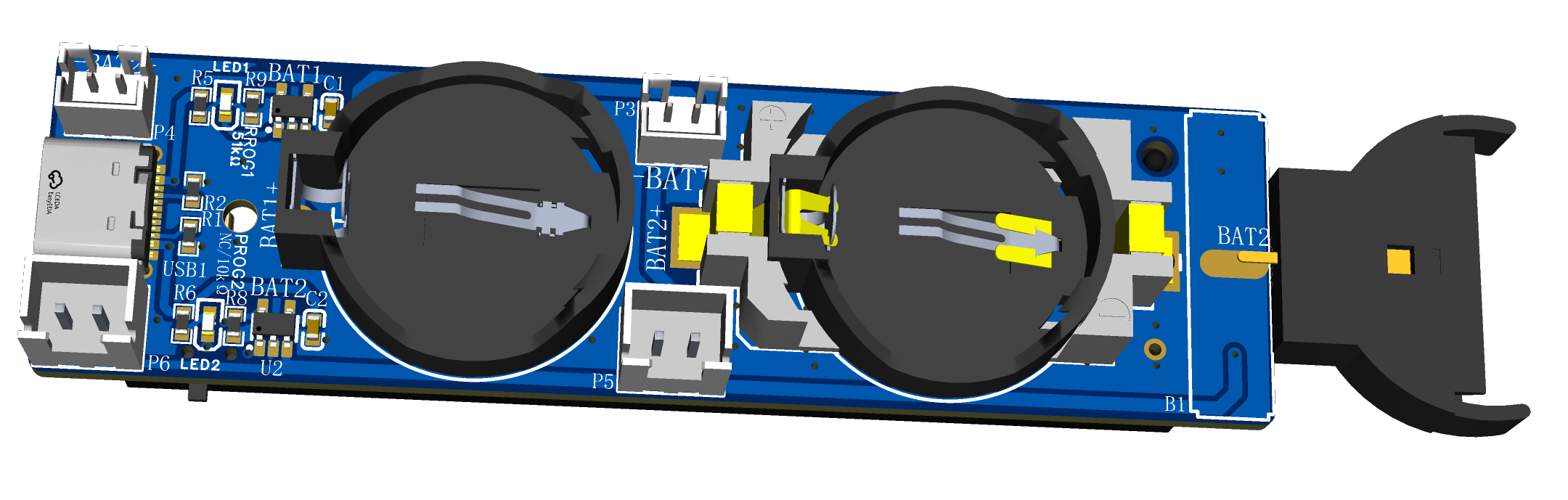

The TYPE-C dual-channel lithium battery charger supports LIR2032/LIR2450/18650 Lithium Cell-2024.

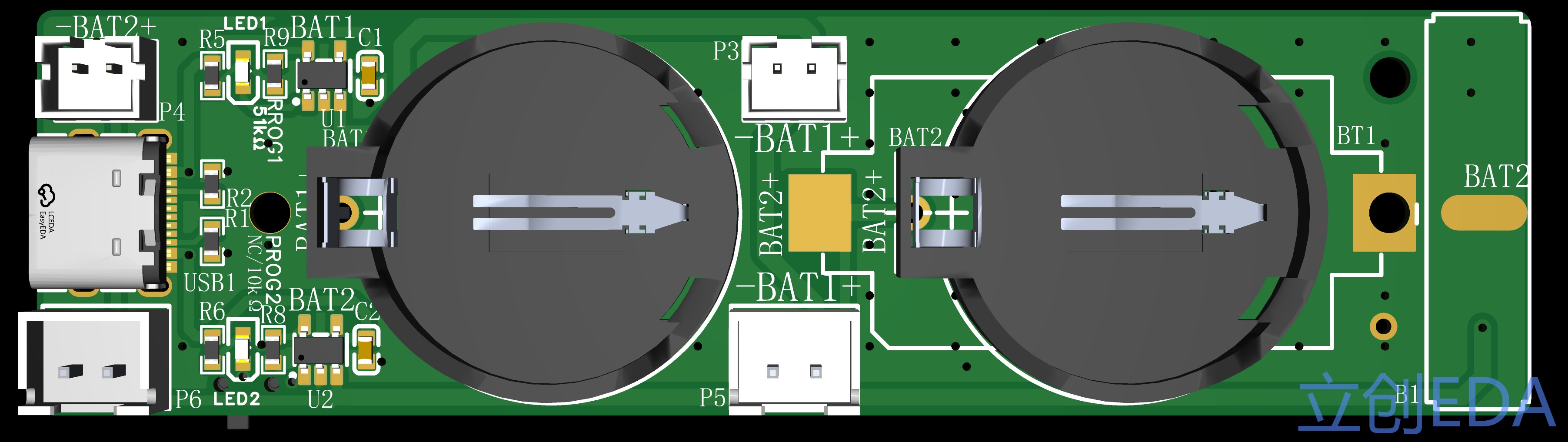

PCB Hardware Features:
Dual-channel lithium battery charging:
One BAT1 channel has a fixed current of 20mA, suitable for charging LIR2032/ML2032 lithium batteries (do not charge other ordinary batteries; consequences are your own responsibility);

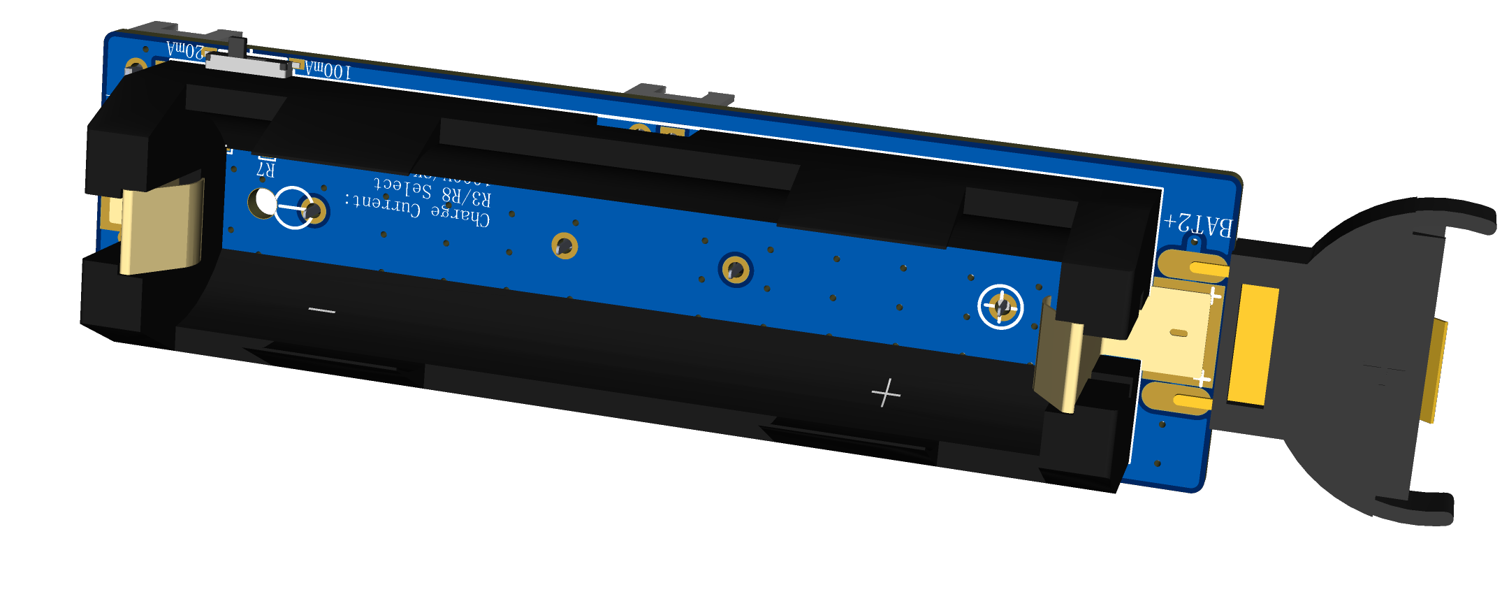

One BAT2 channel offers selectable current of 20mA/100mA, suitable for 18650 or small polymer battery packs;
3D printing of the casing is open; DIY replication or modification is welcome.

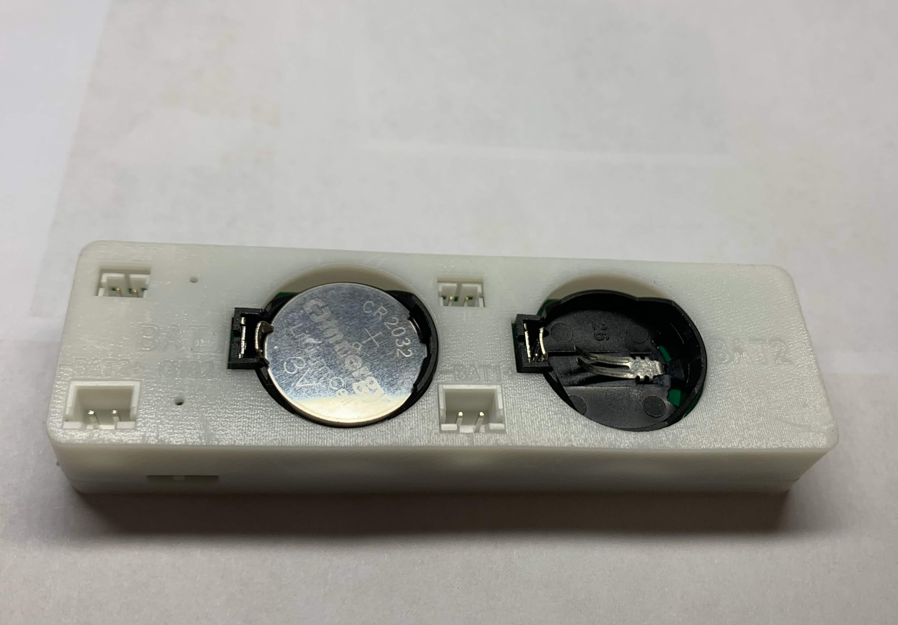

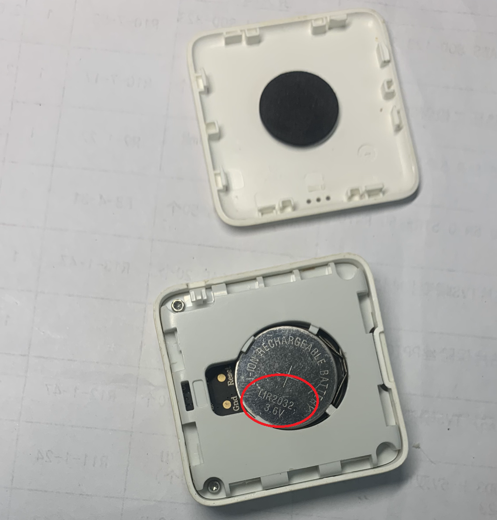

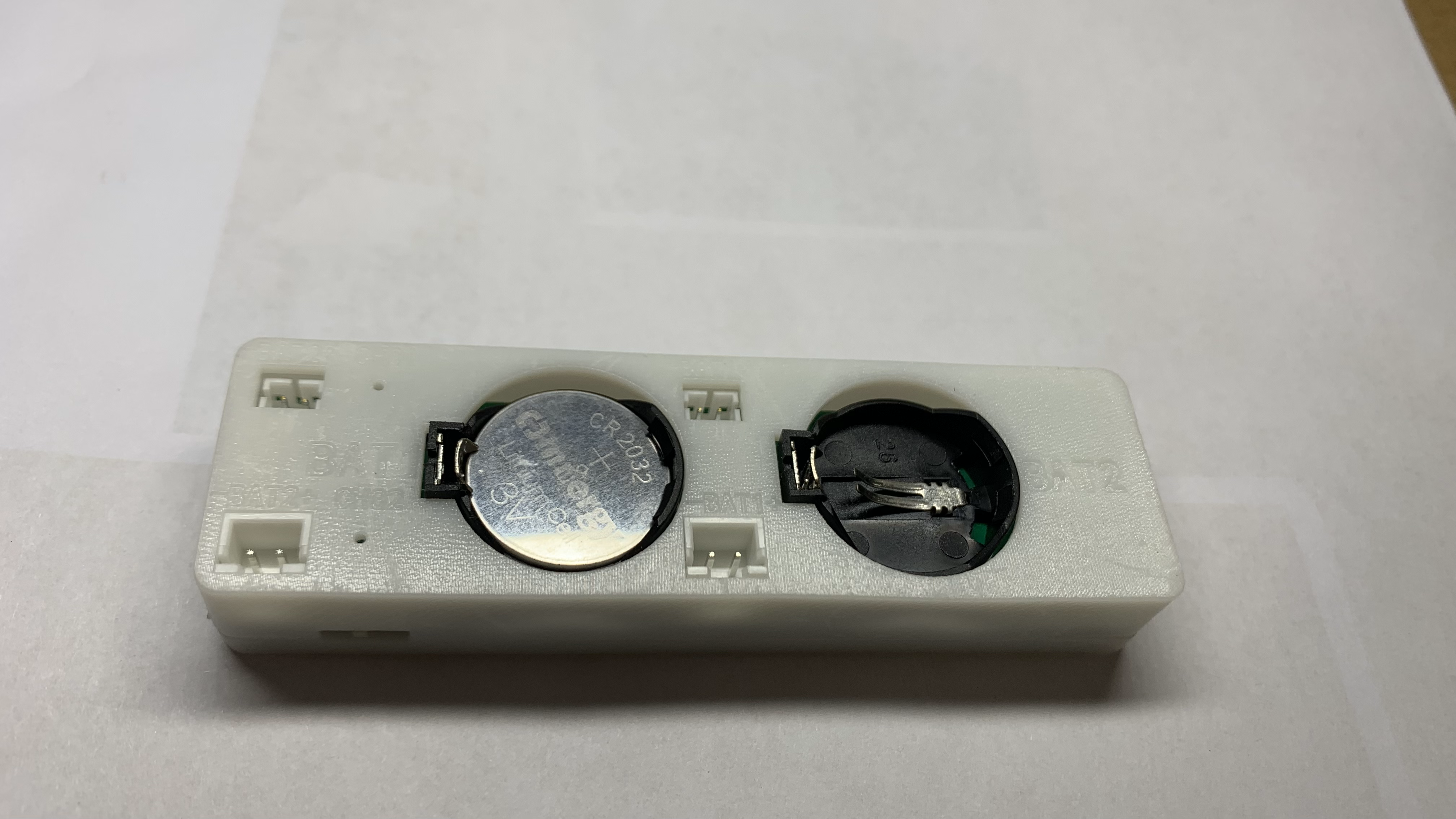

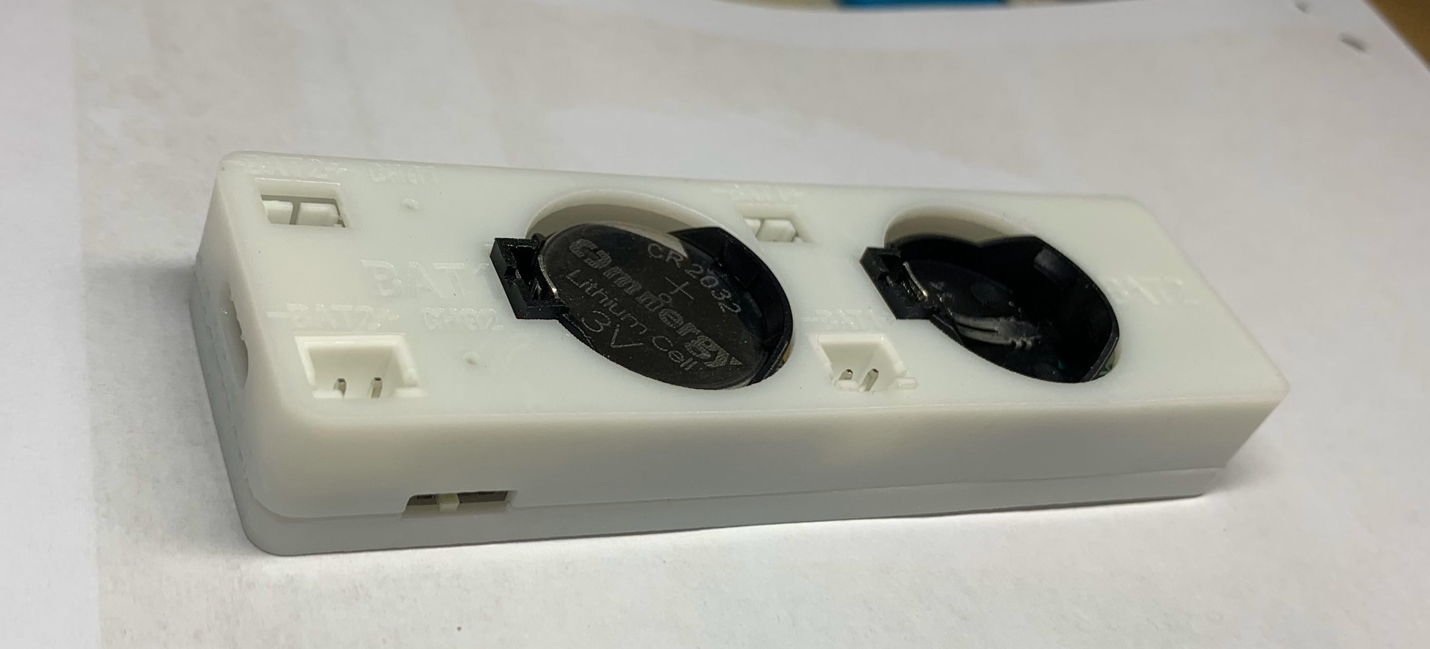

Supported 2032 battery models: LIR2032, ML2032. Actual 2032 battery photos:

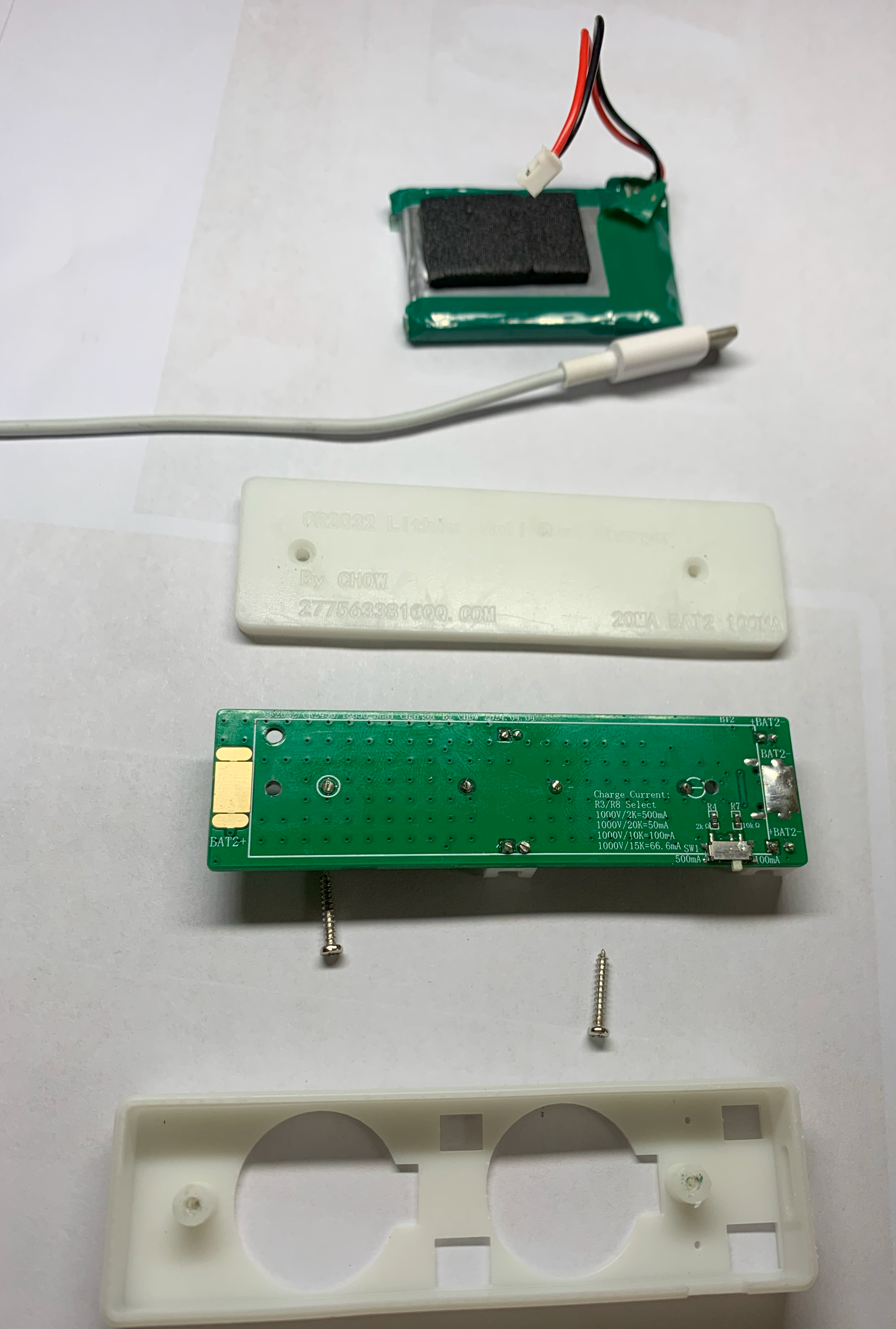

PCB 3D printing supports 18650; actual product photo
without casing.
