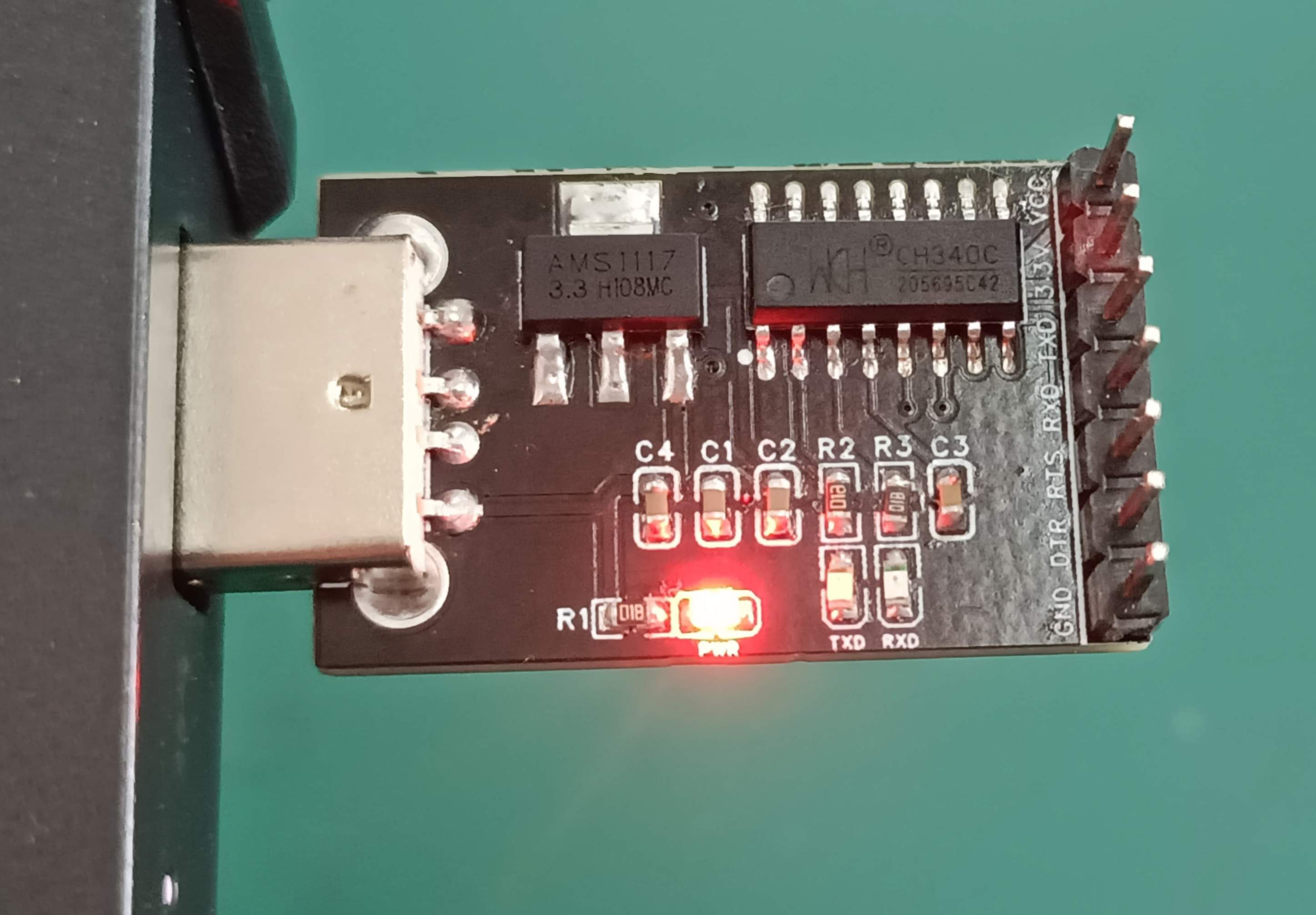

USB-TTL serial communication module based on CH340C
Project Introduction:
This project is a serial communication module based on the CH340C USB-to-serial chip. The module features a power indicator, data transmit and receive indicator lights, and exposes VCC, 3.3V, TXD, RXD, RTS, DTR, and GND pins. It supports full-duplex serial port with built-in transmit and receive buffers, supports baud rates from 50bps to 2Mbps, and has a 3.3V power output. An automatic download module can be added if needed.
Usage Notes:
The CH340C requires the CH340 driver. Download and install the driver from CH341SER.EXE - Nanjing Qinheng Microelectronics Co., Ltd. (wch.cn).
If your computer displays a message indicating that the device cannot be recognized, please check the following:
1. Whether the driver has been correctly downloaded and installed.
2. Whether the components are correctly soldered and whether there are any cold solder joints.
参考设计图片
