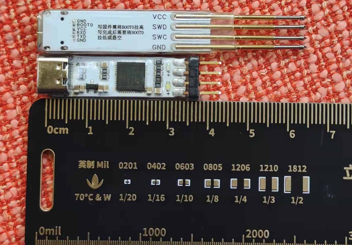

This version of JLink ARM OB is modified based on X893/CMSIS-DAP; this version of JLink ARM OB uses STM32F072CBU6 internal oscillator, eliminating the need for an external crystal oscillator, and the PCB area is smaller. This version does not have a reserved SW download interface. It can be downloaded through the serial port. Before downloading, connect BOOT0 on the back to high (see PCB diagram for details). RXD/TXD/GND is reserved on the back for easy downloading. It is recommended to use ST’s official serial port download tool Flash Loader. Demonstrator, the firmware is on GitHub - geekchun/Jlink-OB (you can also view the attachment jlink-ob-072-cortex-m.bin). After the download is completed, BOOT0 needs to be pulled low or left floating. JLink ARM OB has updated the USB Type-C interface. The advantage is that you don’t have to worry about plugging it in backwards. The tail welding probe or 2.54 pin header can be cut off appropriately as needed.
