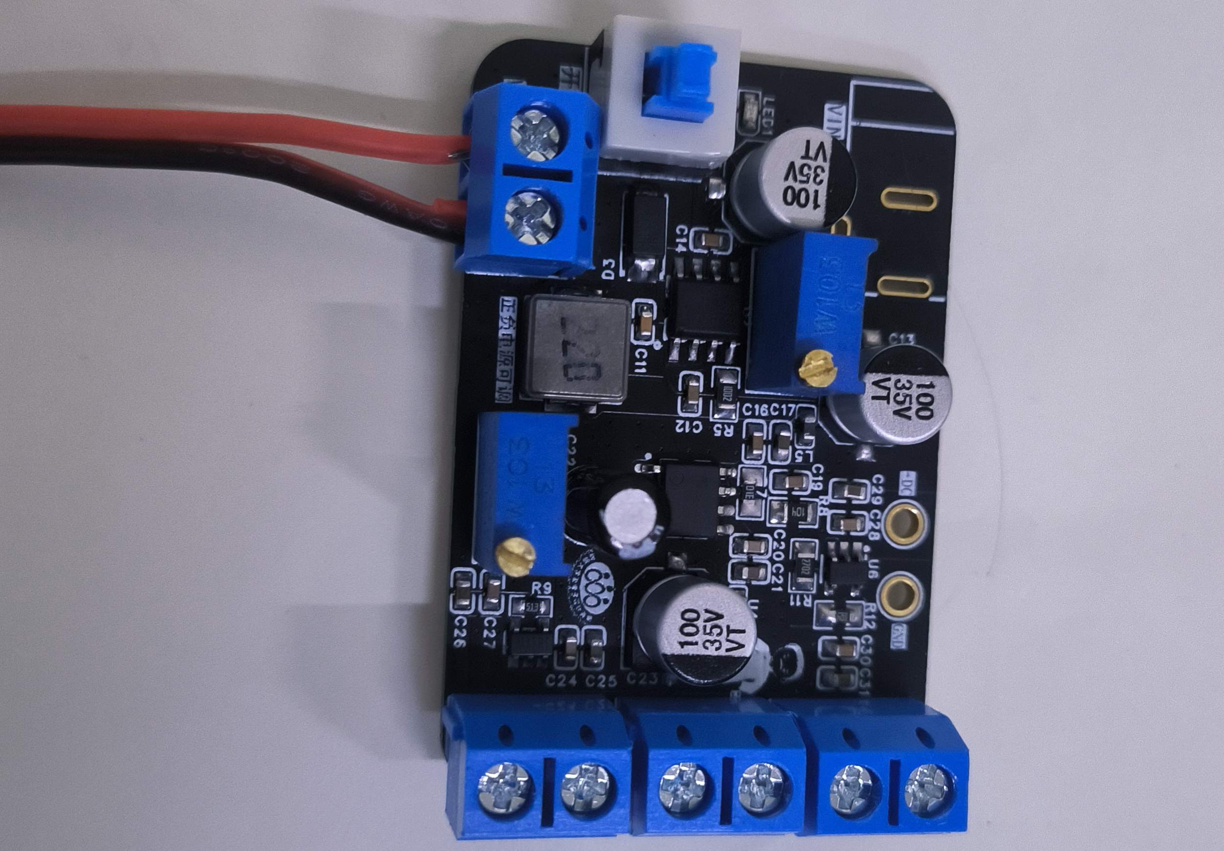

This is a low-ripple, low-noise dual-power supply module with a measured ripple of around 10mV. It uses a Buck + LDO scheme, which has the disadvantage of higher cost but the advantage of greater stability. The supply voltage can be changed by adjusting two potentiometers.
Currently, the LDO+ output voltage is around 15V, which can be changed by altering the values ​​of resistors R11 and R12. The specific calculation formula is shown in the schematic diagram.
