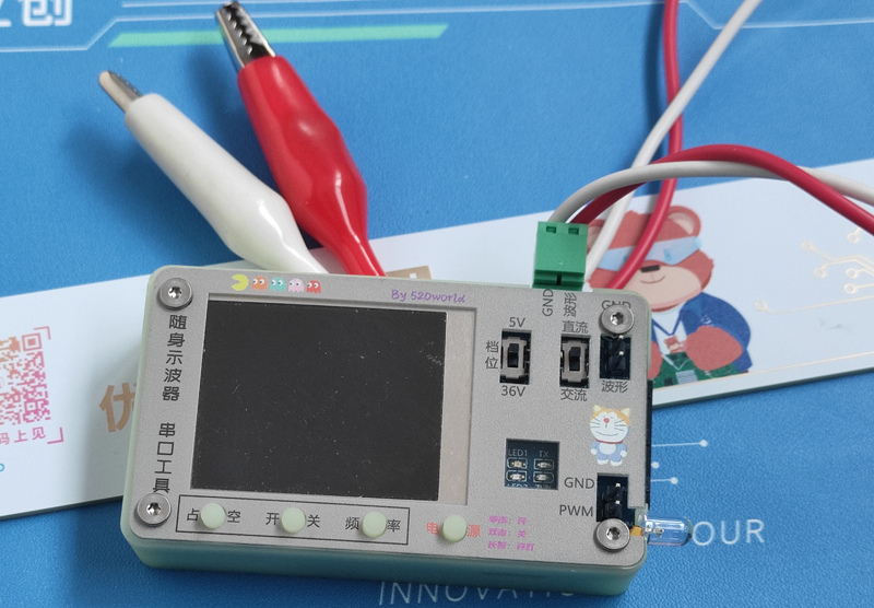

I've always wanted a portable, multi-functional tool. The one I made in the last oscilloscope training camp wasn't ideal; it was too big.
This time, the simplified oscilloscope seems to have a simpler circuit, so it should be much smaller, which is why I participated—I needed this tool! I was originally planning to replicate my oscilloscope + serial port tool project! This training camp is like a godsend! Another freebie opportunity!!
Bilibili video: https://www.bilibili.com/video/BV1sf421f7wL/
Expected Functionality: Currently implemented:
1. Portable Simple Oscilloscope (Completed)
2. CH340 Serial Port Tool (Completed)
3. Simple LED Lighting (Completed)
4. Huawei, Boda, and other Switch Console (Completed)
5. Bluetooth Console Functionality (Completed)

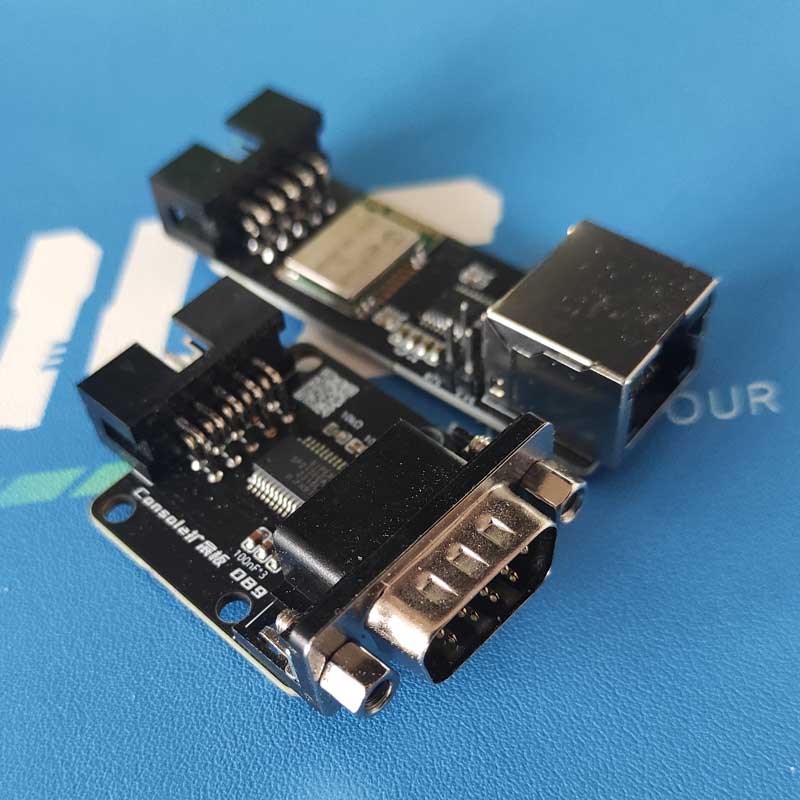

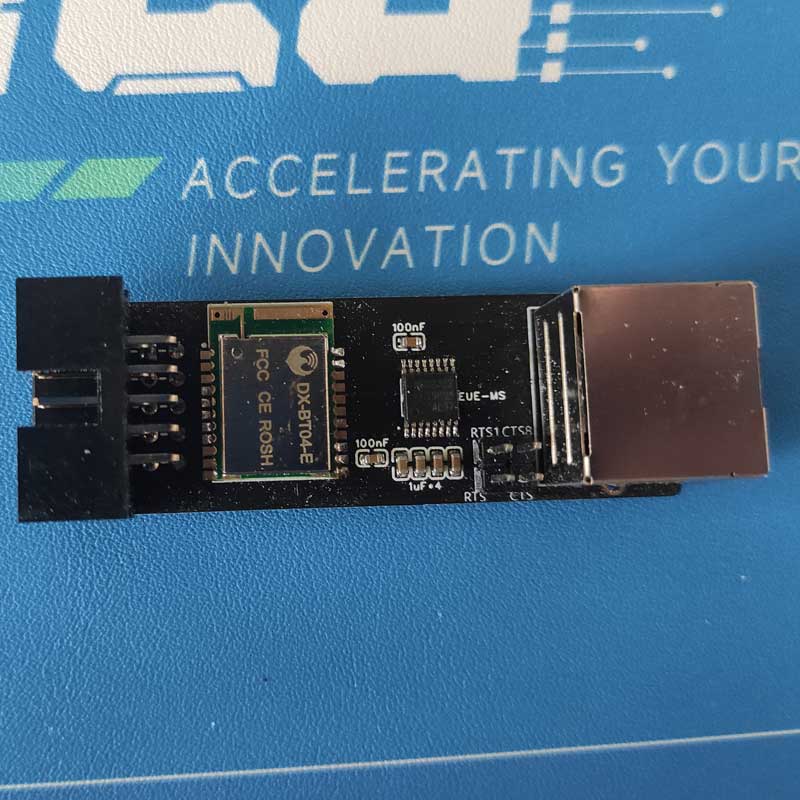

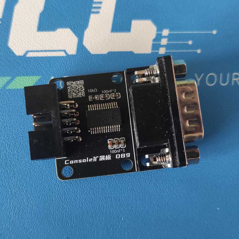

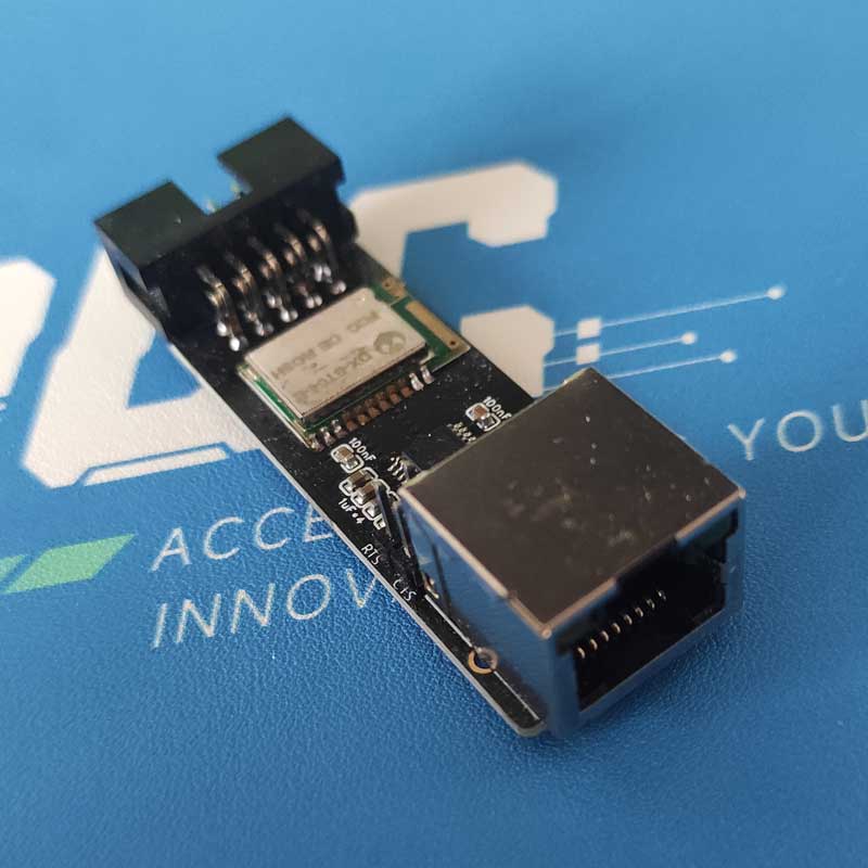

Originally, I thought since it's a full-featured serial port, I'd make a small console accessory for switches, a full-featured RS232 tool with a DB9 interface. The Bluetooth console tool only supports three-wire console ports! Please see the attached demonstration video!
PS: The console tool is not isolated or protected against electrostatic discharge (ESD). Please use it safely to avoid damaging the device!

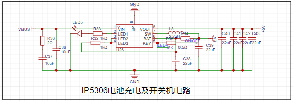

The power supply section uses IP5306 and controls the switch, battery charging, and LED lighting.

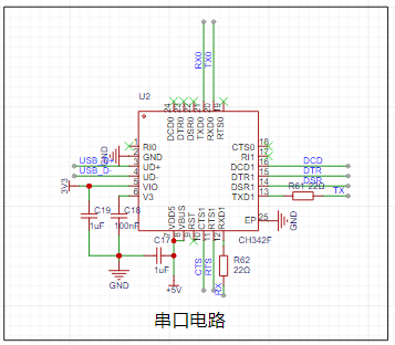

The serial chip used is CH342F, with two serial ports: one for debugging the GD32E230 and uploading firmware, and the other for connecting an external serial port tool.

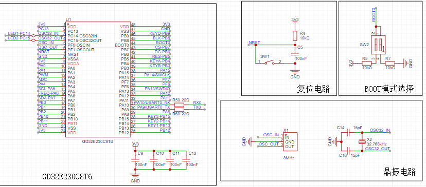

The GD32E230C8T6 circuit is simplified; the 32.768kHz crystal oscillator is not soldered as it is not needed in this project. The BOOT selection DIP switch is set to high when uploading firmware using the GD32 All In One Programmer, and low for normal use.

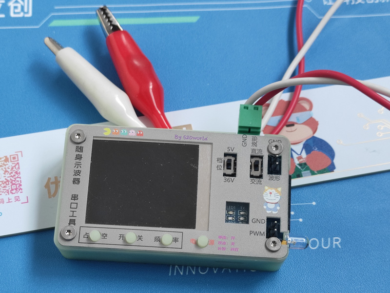

Finished product image:
The program is basically unchanged from the official version, except for the screen angle. Other aspects remain the same.
Attached images of the switch console tool:
