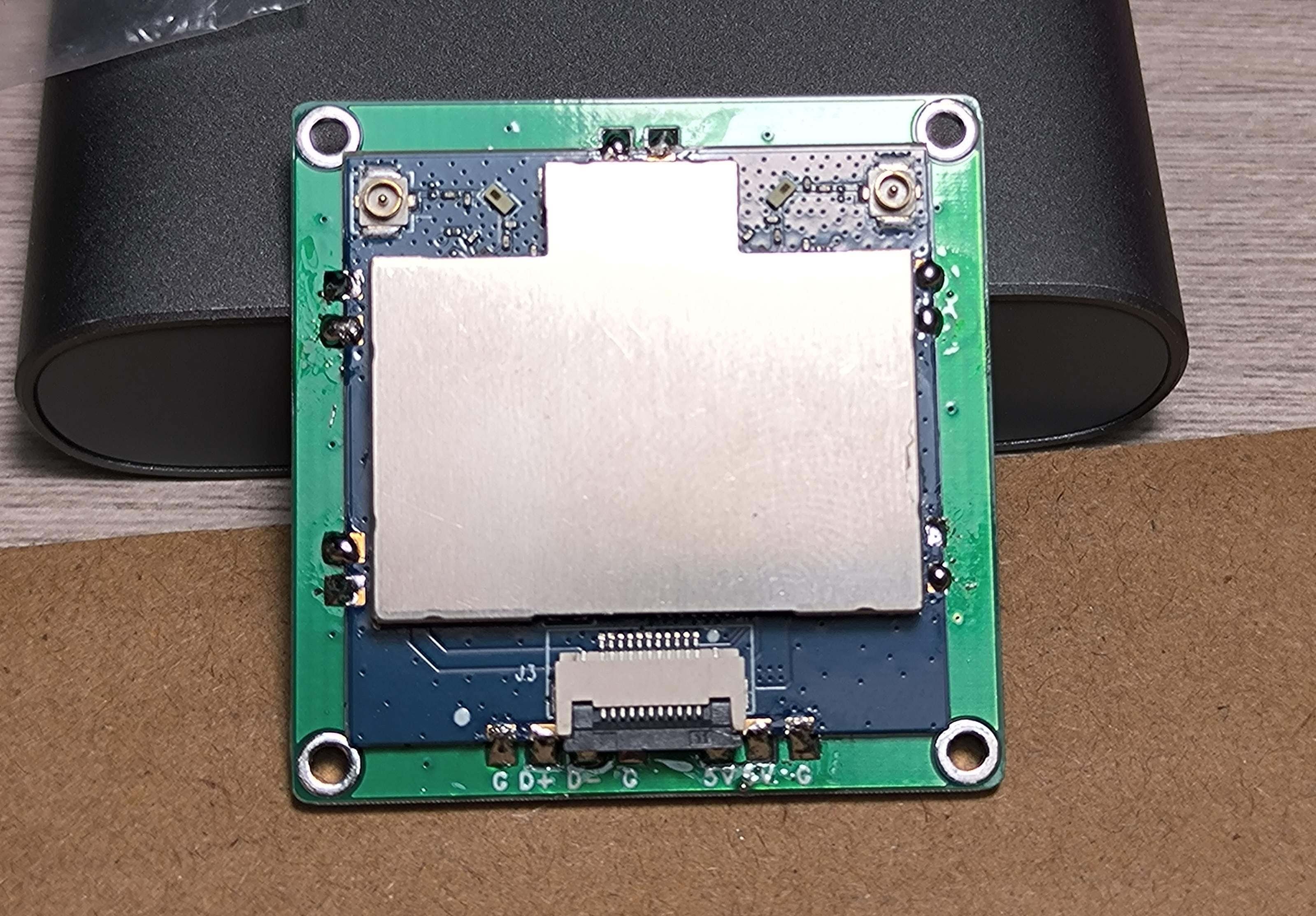

8812EU network card welding base plate
This is the soldering base plate for the Blink 8812eu network card. The original network card had a separate connector for soldering wires, so this base plate was designed instead. It measures 38*38mm and can be directly screwed onto modules such as the MC800S for use in open-source high-definition video transmission projects like OpenIPC. The central slot is recommended for installing a 20*20mm heatsink and fan, as this network card generates a lot of heat.
