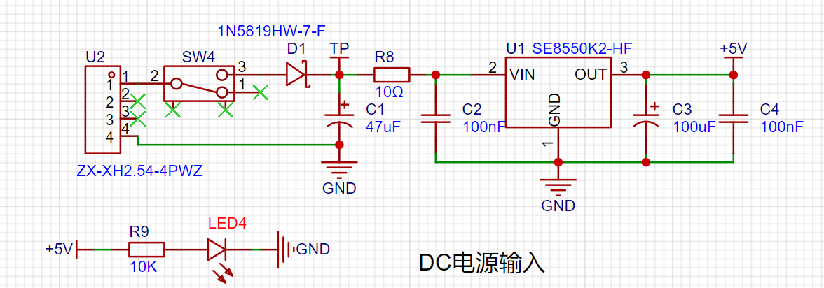

LDO (Low Dropout Linear Regulator) Selection This project uses an LDO as the power supply. Considering that most actual voltmeter products are used in industrial scenarios with 24V or 36V power supplies, this project selected the SE8550K2, which has a maximum input voltage of up to 40V, as the power supply. The main reason for not using a DC-DC buck converter to handle the large voltage drop is to avoid introducing DC-DC ripple interference during the design process; a secondary reason is to reduce project costs.

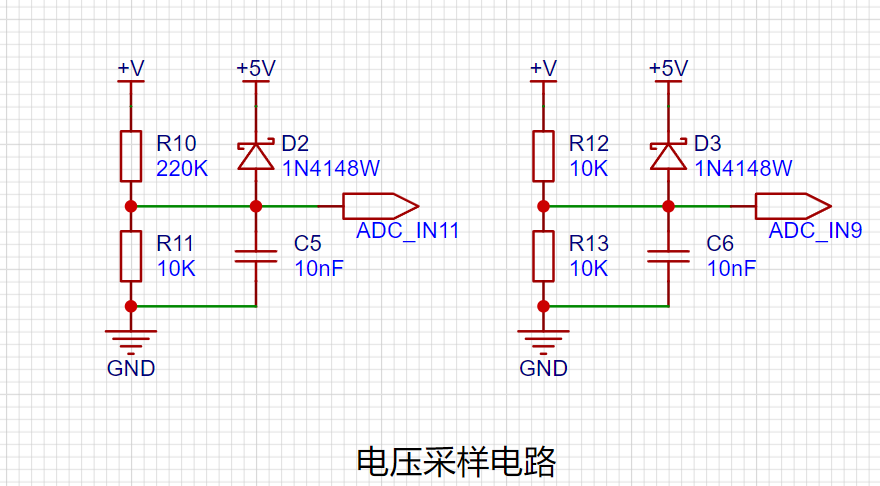

2. Voltage Sampling Circuit:
The voltage divider resistors in this project are 220K+10K, therefore the voltage division ratio is 22:1 (ADC_IN11).

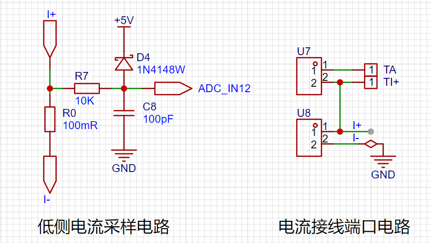

3. Current Sampling Circuit:
This project uses a low-side current sampling circuit for current detection. The low-side of the sampling circuit shares a common ground with the meter interface on the development board.

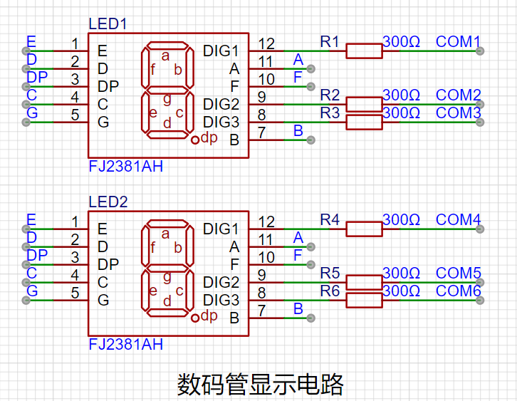

4. Digital Tube Display:
This project uses a digital tube as the display unit.

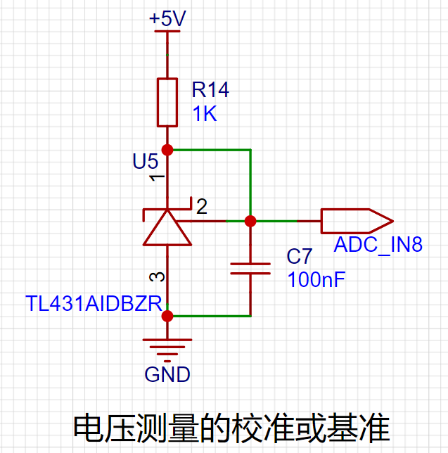

5. TL431 Circuit Design for Voltage Measurement Calibration:
This project adds an extra TL431 circuit to provide a 2.5V reference voltage, which can be used to provide an external voltage reference for calibrating the AD converter. From a product design perspective, due to the inherent ADC performance advantages of the CW32, this circuit is not necessary. This circuit is designed on the development board for learning related application principles.

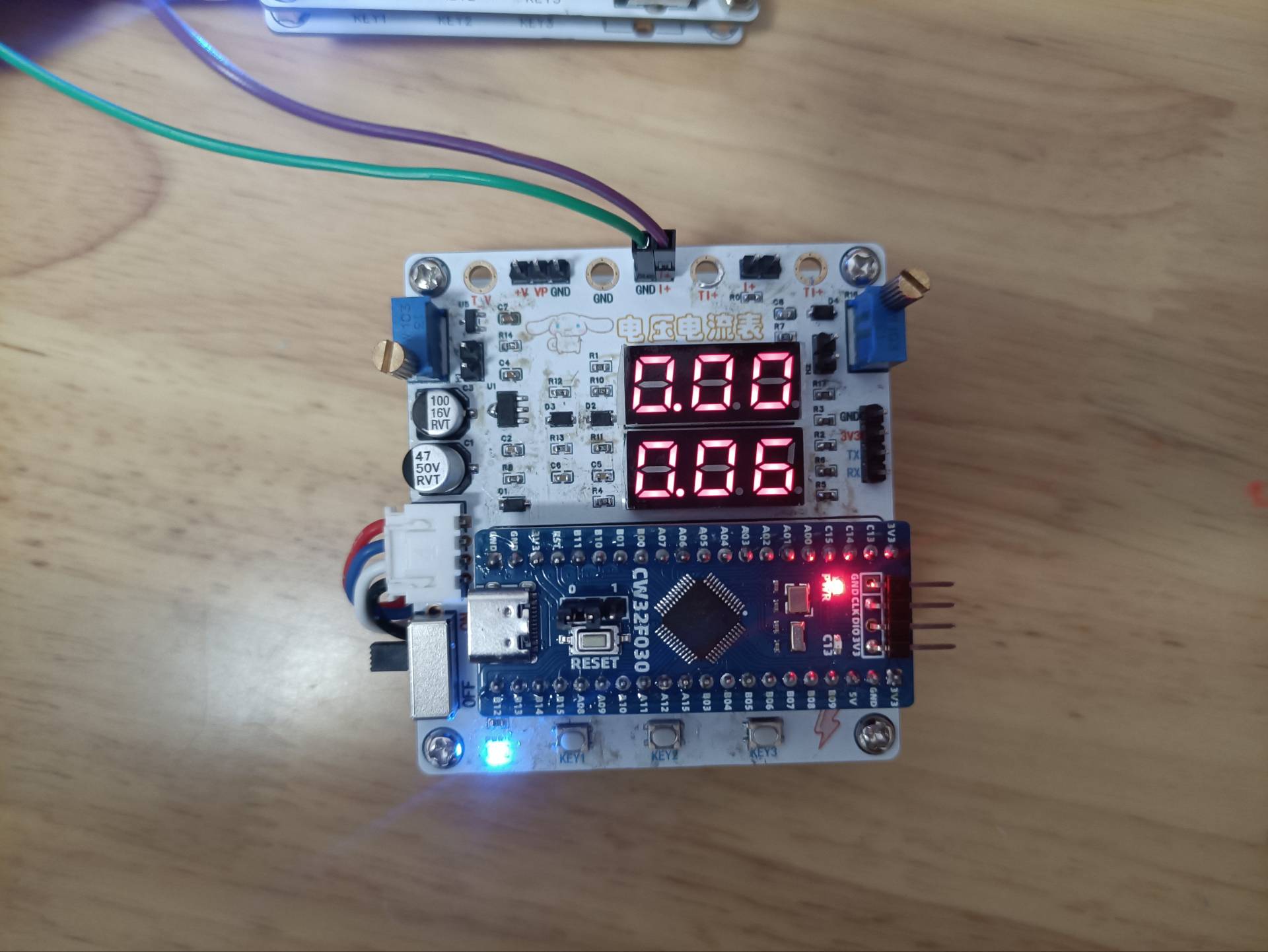

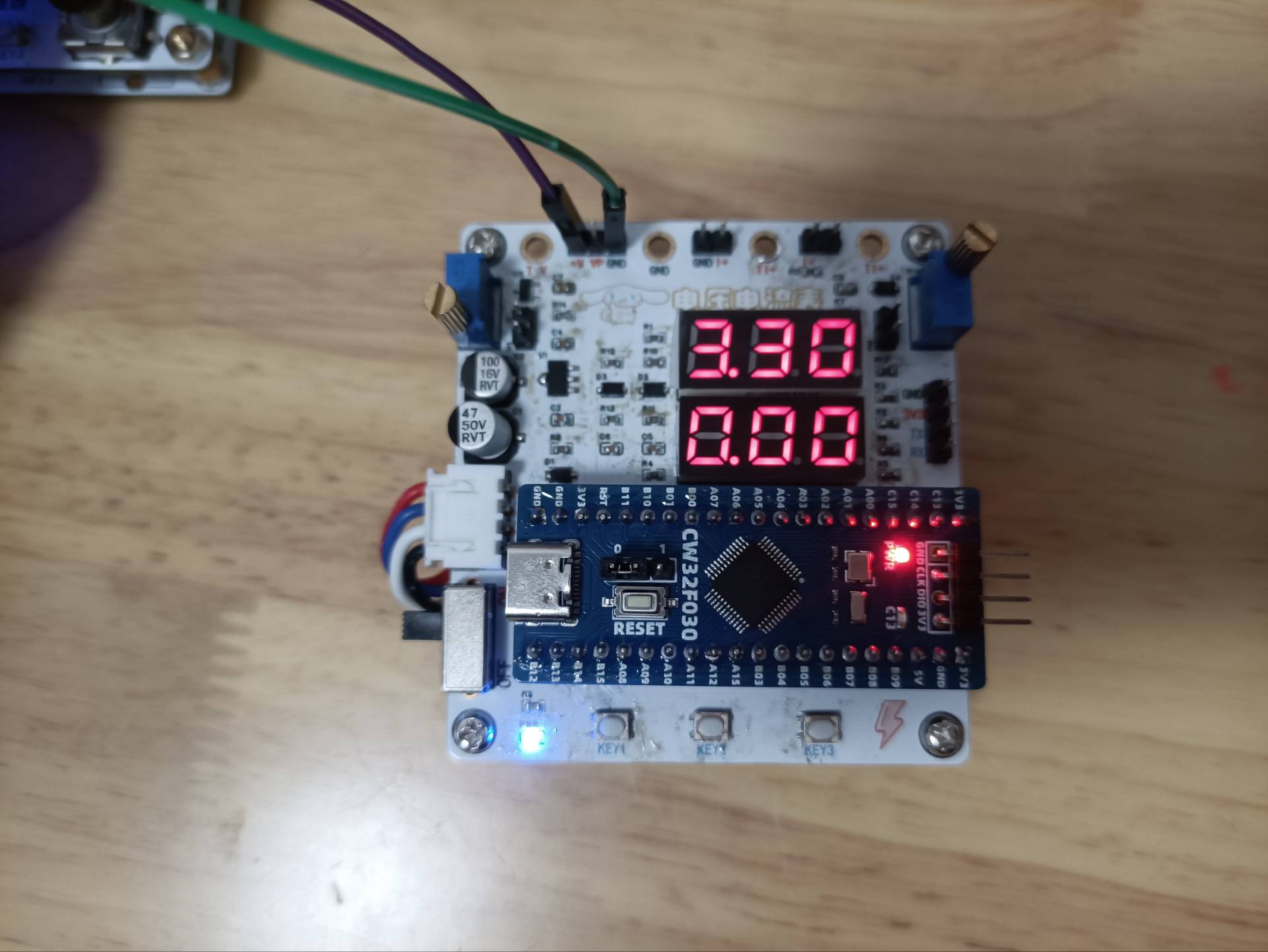

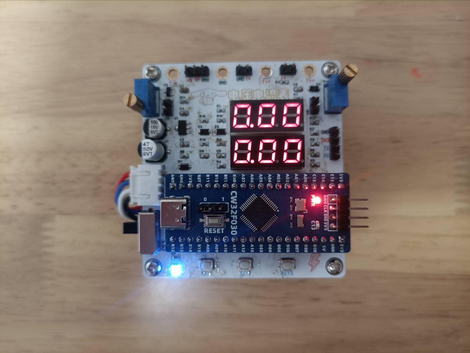

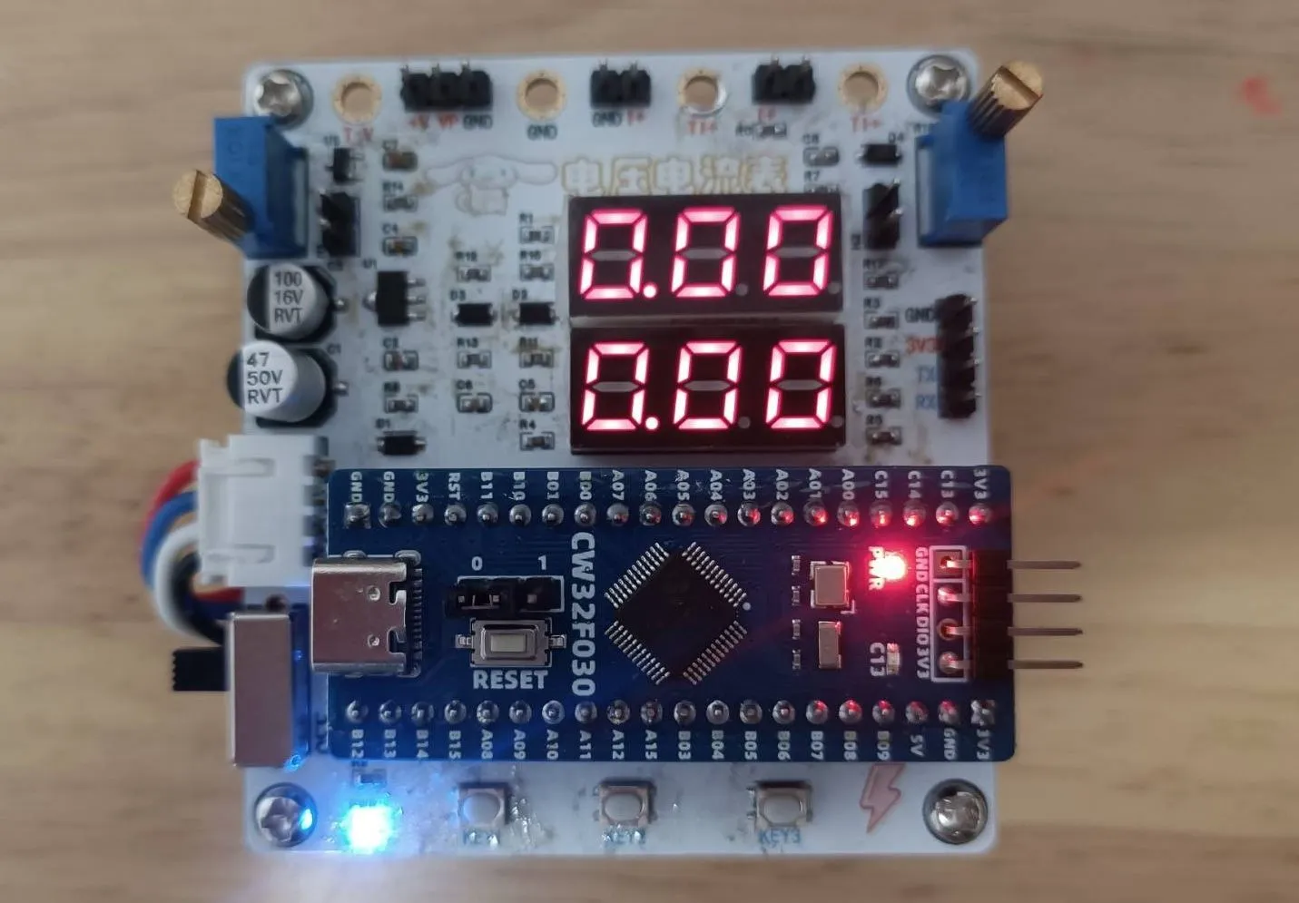

This design is a simplified voltmeter and ammeter. In actual welding, voltage and current terminals are not welded; instead, a potentiometer is used to simulate voltage and current testing. This design can measure voltages from 0-30V, with a sampling current of 3A and a sampling resistor of 100mΩ.
This CW32030-based voltmeter and ammeter
image-20240820203915852.pngdesign is a simplified version. In actual soldering, voltage and current terminals are not soldered; instead, potentiometers are used to simulate voltage and current testing. This design can measure voltages from 0-30V, with a sampling current of 3A and a sampling resistor of 100mΩ.

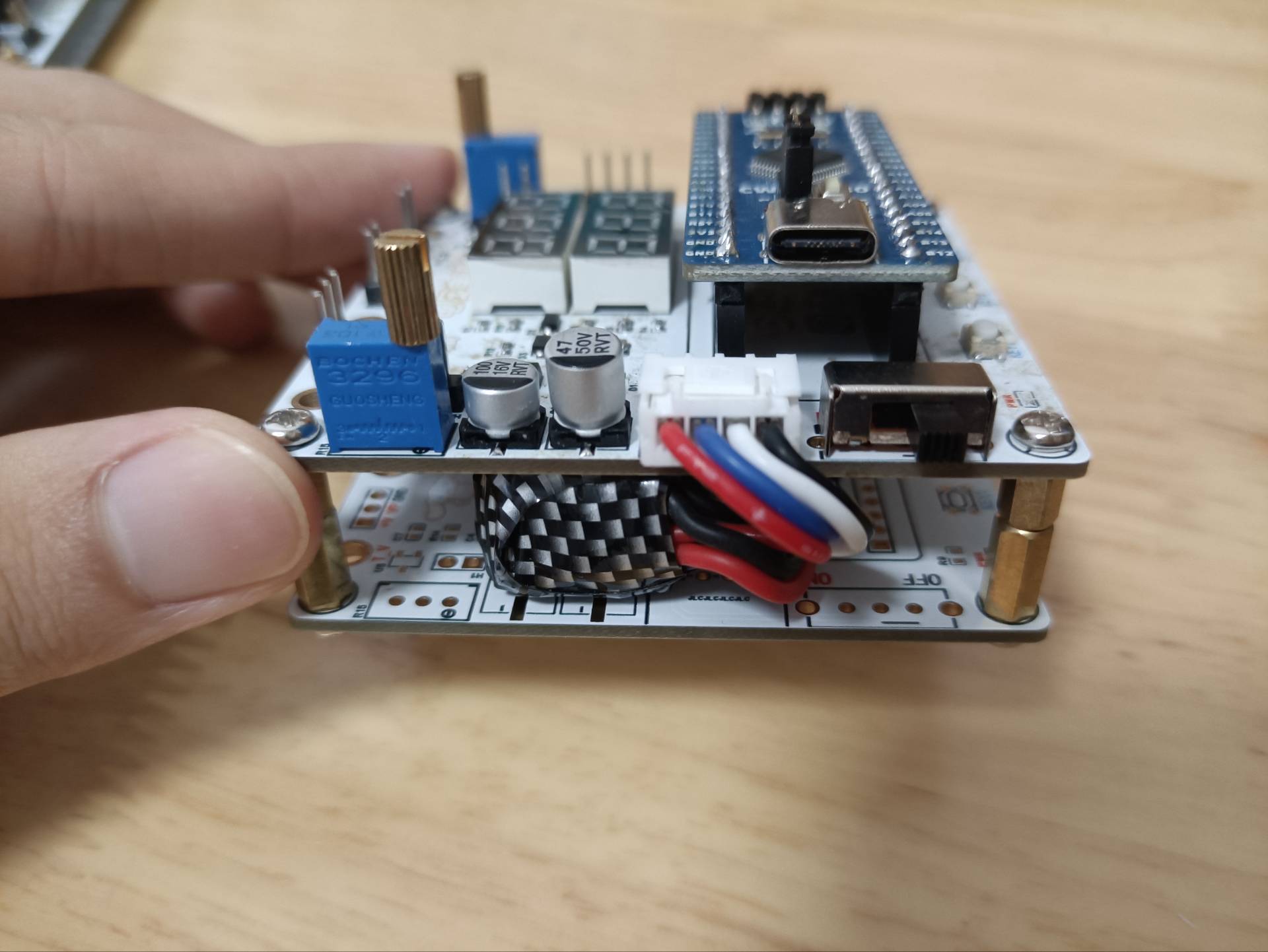

The hardware design uses a DC
input power supply circuit
image-20240820204618161.png, stabilizing the voltage to 5V using an 8550. A small resistor R14 is connected in series to serve two purposes: firstly, to divide the voltage, preventing excessive overheating of the LDO if the DC input voltage is too high; secondly, to reduce the excessive voltage difference between VIN and VOUT of the 8550; and thirdly, to act as a fuse, burning out in case of a short circuit to protect the circuit. LD_PWR is the power indicator light, illuminating when a stable 5V is generated on the development board.

The digital tube
image-20240820205600185.pngdisplay circuit uses a 0.28-inch three-digit common-cathode digital tube. In this design, LD1 displays voltage information, and LD2 displays the acquired current information. The digital tube display uses dynamic scanning, utilizing the persistence of vision effect. In reality, only one digit can be lit at a time; as long as the refresh rate is fast enough, it appears as if all digits are displayed simultaneously. The MCU's GPIO

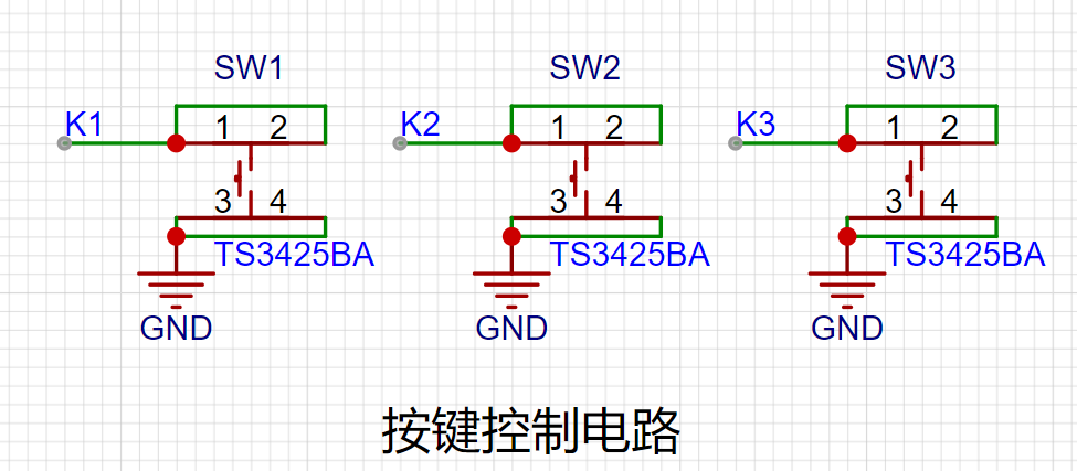

for the button circuit
image-20240820210143271.pngis configured as a pull-up input. When the button is not pressed, the GPIO exhibits a weak pull-up; when the button is pressed, the button circuit is pulled down to ground.
Voltage sampling
image-20240820210525783.pnguses two resistors to divide the +V voltage by a ratio of 22:1. The voltage is acquired by the microcontroller, and the +V voltage is calculated backwards.
+V = ADC / (R7 / (R7+R8)).
image-20240820211024825.pngA potentiometer is used to simulate voltage. A jumper cap is used to short-circuit the two pins of JP1, allowing the voltage signal from the potentiometer to be sent to +V. The voltage value is then measured again via voltage sampling.
Current sampling:
image-20240820214442463.pngThis design uses a sampling current of 3A. The selected sampling resistor R0 is 100mΩ (1W package).
R9 is connected in series in this design to provide some current, preventing high current from damaging the MCU's ADC pins. Combined with C6, it forms an RC low-pass filter, reducing the impact of high-frequency noise on ADC sampling.
image-20240820214909544.pngCurrent testing is simulated using a potentiometer. A jumper cap is used to short-circuit JP2. R17 and the voltage divider at the upper and lower ends of the potentiometer are used (R0 is not soldered when using a potentiometer to simulate voltage measurement). The voltage at the lower end of the potentiometer is measured.
