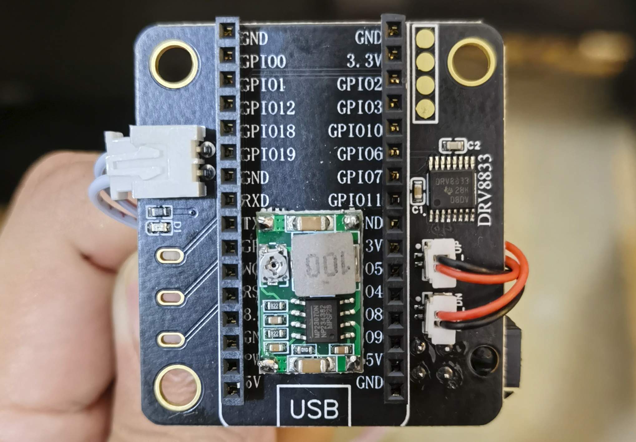

Modified from YBA-AMS
⚠ Please note that although the current version can be supplied with the AMS lite connector, its power consumption is quite high. Please consider this carefully. The next version of the PCB will be compatible with MP1584 to solve the LDO power consumption issue. You can wait for this to be resolved before manufacturing.
Recommended process
Board thickness: 1.6mm
Minimum hole diameter/outer diameter: 0.3mm (free) (outer diameter 0.4/0.45)
Add markings to the board: Add serial number QR code
QR code size: 8*8mm
QR code location: Designated location
Modified content:
Changed 4 channels to 1 channel for convenient individual control in the consumable drying box.
Changed USBC/DC power supply to AMS lite interface power supply.
DRV8833 was modified from a finished board for soldering, optimizing the PCB area.
The manual control switch has been changed from wiring to soldering, directly fixing it to the consumable drying box.
You can see both the switch board and motor board in this project; this is designed to optimize wiring within the drying box. It requires the next version of the spool holder. You can check the update status of [YBA-AMS(Remix)] on MakerWorld.
Modified note:
From 4 channels to 1 channel, to control the sole holder in one case.
From USB-C/DC power supply to AMS lite.
From finished DRV8833 board to soldered DRV8833.
From cable-connected switch to soldered switch on board.
You can find the switch board and motor board in this project; it's designed for the cable management in case. They should be used with the next version of the spool holder; you can kindly check the update status of [YBA-AMS(Remix)] on MakerWorld.
