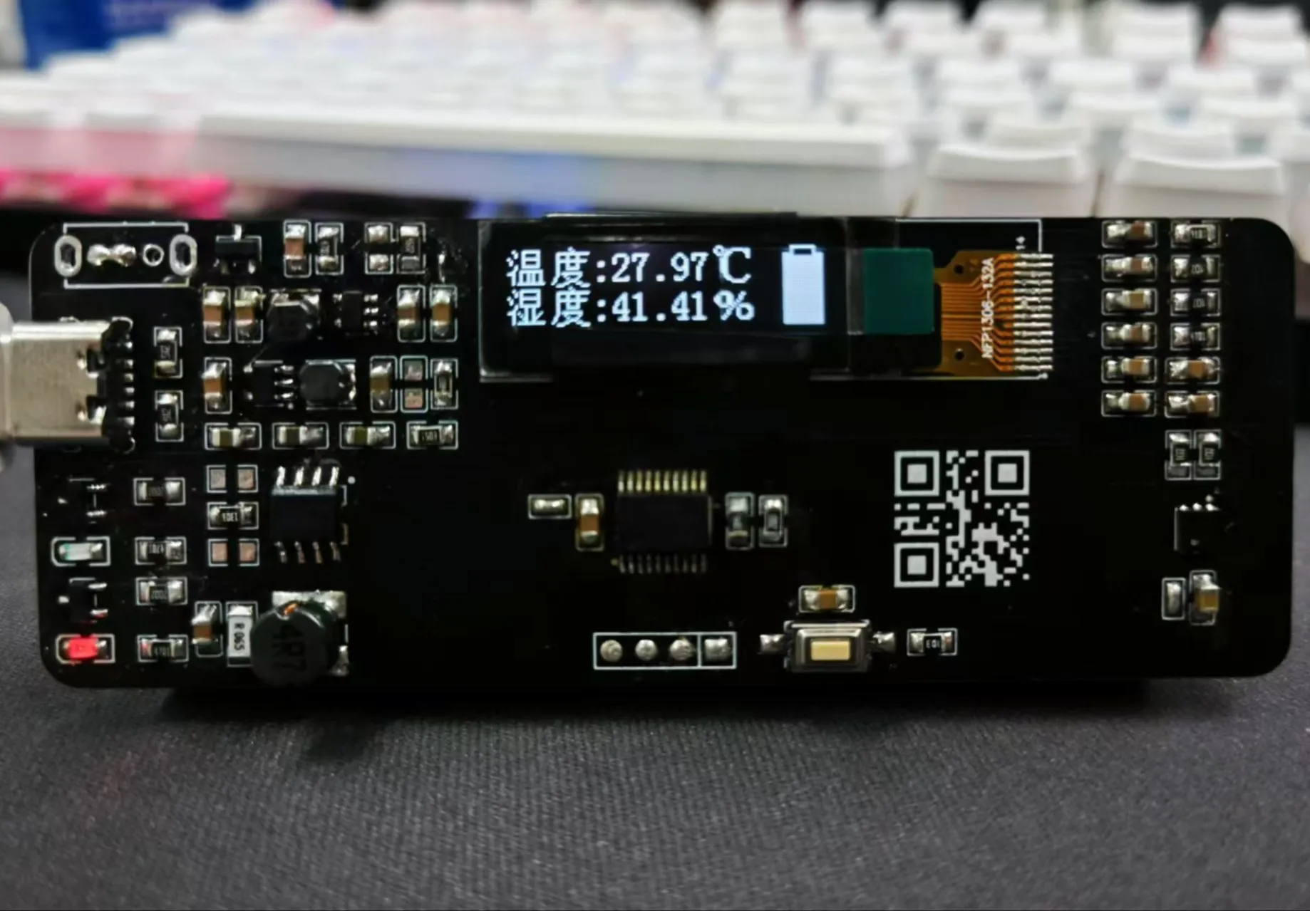

Reason for creation: I've used many DHT11 sensors, but their accuracy seems questionable. I happened to see this temperature and humidity sensor on Taobao, so I bought one to play around with, and it was also a good opportunity to try out battery power, something I hadn't done before. Long post warning!!!
All files (schematics, PCB, complete project code) are open source on the LCSC open source platform. For detailed images and text, please visit http://t.csdnimg.cn/kN38A
Objective/Requirements
: Powered by a single 18650 battery.
Continuously displays temperature, humidity, battery level, etc.
Type-C charging capability.
Uses PY32F002A as the main controller.
Minimizes power consumption to maintain long operating time. When searching

. /** * @brief Function to update the battery display array * * @param nu Battery percentage 0~30 */ uint8_t cnt = 0; void showDL(uint8_t nu) { memcpy(DL, BP, sizeof(BP)); if (nu != 0) { for (uint8_t j = 0; j 14; j++) { if (nu 7) { DL[49 + j] = (BP[49 + j] >> nu) | (0xff 8 - nu)); } if (nu 15 && nu > 7) { DL[49 + j] = (BP[49 + j]) | 0xff; DL[33 + j] = (BP[33 + j]) | (0xff 8 - (nu % 8 + 1))); } if (nu > 15 && nu 23) { DL[49 + j] = (BP[49 + j] >> nu) | 0xff; DL[33 + j] = (BP[33 + j]) | (0xff 8 - (nu % 8 + 1))); } if (nu > 15 && nu 23) { DL[49 + j] = (BP[49 + j] >> nu) | 0xff; DL[33 + j] = (BP[33 + j]) | 0xff 8 - (nu % 8 + 1))); } j]) | 0xff; DL[33 + j] = (BP[33 + j]) | 0xff; DL[17 + j] = (BP[17 + j]) | (0xff 8 - (nu % 8 + 1))); } if (nu > 23 && nu 27) { DL[49 + j] = (BP[49 + j]) | 0xff; DL[33 + j] = (BP[33 + j]) | 0xff; DL[17 + j] = (BP[17 + j]) | 0xff; DL[1 + j] = (BP[1 + j]) | (0xff 8 - (nu % 8 + 1))); } if (nu > 27) { DL[49 + j] = (BP[49 + j]) | 0xff; DL[33 + j] = (BP[33 + j]) | 0xff; DL[17 + j] = (BP[17 + j]) | 0xff; if ((j + 1) 3 || (j + 1) >= 12) { DL[1 + j] = (BP[1 + j]) | 0xf8; } else { DL[1 + j] = (BP[1 + j]) | (0xff 8 - (nu % 8 + 1))); } } } } OLED_DrawBMP(112, 0, 128, 4, 1); } Power consumption test Test location Current mA Remarks Power bus 10.2±0.2 Battery power supply current to the whole system OLED power bus 4.5±0.2 Inaccurate PY32 (mcu) 0.6±0.1 Microcontroller power supply current SHT20 The 0.000050±0.000005 value is inaccurate. The 3.3V bus current is 10.2±0.2. Why is the current of the 3.3V power  supply inaccurate? Because the IIC communication line also provides current. Observing the 3.3V bus current, it is much greater than the current of OLED+PY32+SHT20. During testing, I only disconnected its power supply line (3.3V). However, during testing, I disconnected the OLED's VCC, and PY32 and SHT20 worked normally. At this time, the OLED could still light up, although it was slightly flickering. The same was true for the tests on SHT20 and PY32! Power Consumption Analysis : Why are the input and output currents of the system power supply (battery input, boosted to 5V, then stepped down to 3.3V output) basically the same? Because PW5100 and PW2058 are both switching power devices with high conversion efficiency. Furthermore, the measurements were taken manually, which introduces a large error, so they are basically the same. (We only have one ammeter; otherwise, we could use two to observe and compare.) Let's calculate how long this battery will last.
The overall power consumption was remeasured using a 3.7V power supply. After the system stabilized, the following was recorded:
                                                             I=10.3mA                                                 P = 10.3 * 3.7 = 38.11 mWthe battery was rated at 9800mWh. Based on this, we calculated that
the total power consumption per hour                          38.11 * 1 = 38.11 mWhcould theoretically allow for                            9800/38.11 approx 257.2happroximately 10.7 days of continuous use (the calculation method may not be entirely accurate). For the temperature/humidity
demonstration , since I didn't have calibrated instruments, I could only check if the display matched my empirical values. Please see the video; after several days of use, I felt it was quite accurate (judging by experience). The refresh rate and response speed were also good. The battery icon charging animation is also shown. In conclusion, the expected functionality was achieved. However, in terms of power consumption, using one battery for about 10 days is not ideal. Due to the use of an OLED screen, even with its brightness reduced to the minimum, the power consumption is still significant. Therefore, we could forgo the OLED screen and use a lower-power digital tube or LCD segment display, which could potentially control the operating current to around 5mA, greatly extending the usage time. This design also has many drawbacks, such as the lack of an automatic low-battery shutdown function and wasted MCU resources. PS: I'm a complete novice; please feel free to correct any mistakes and discuss !
