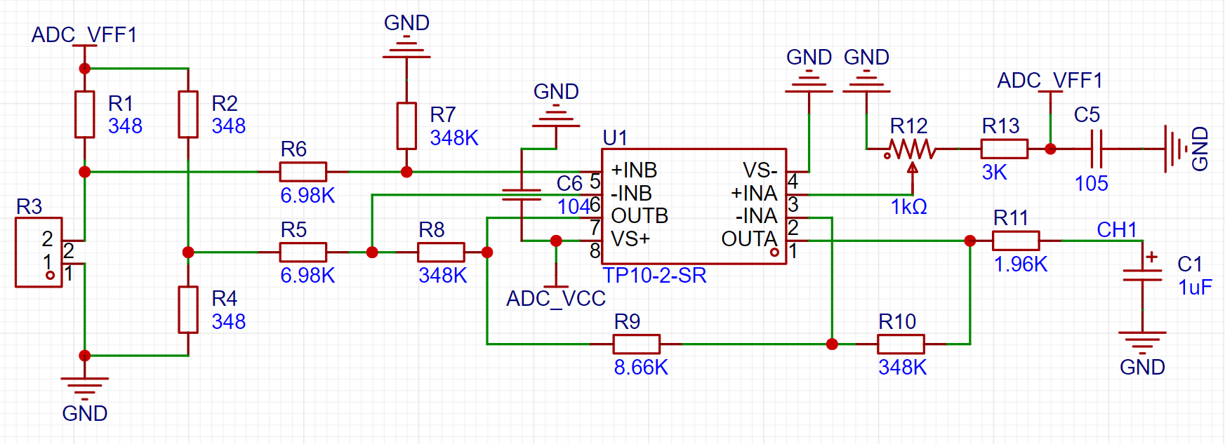

Eight-channel strain gauge acquisition card
Operating voltage: 3V~5V; Operating current: approximately 150mA at 5V; Op-amp chip: TP10-2-SR; Temperature sensor: DS18B20; can be used in TO-92 package or stainless steel waterproof package with XH2.54 connector; Measurement output range: 0V~operating voltage, median value can be zeroed by potentiometer;
Test main controller: STM32F407VET6
; Note: For modularity and flattening, this verification scheme provides a separate regulated power supply for each sampling channel. In actual use, multiple channels can share a voltage source; the potentiometer used in this verification scheme is a single-turn potentiometer. If higher zeroing accuracy is desired, it needs to be replaced with a multi-turn precision potentiometer.

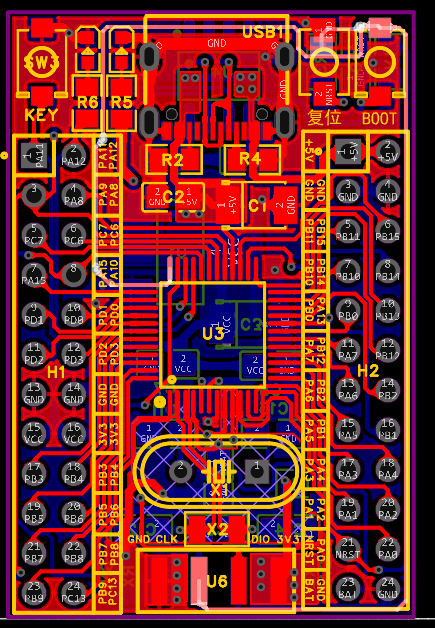

STM32G030C8T6 Minimum System Board
A minimum system board based on the STM32G030C8T6 chip, featuring an onboard CH340N chip for serial communication via Type-C. It includes a boot button, a reset button, and a user button. The bottom has a dual-row pin header for the download interface and the serial communication interface.

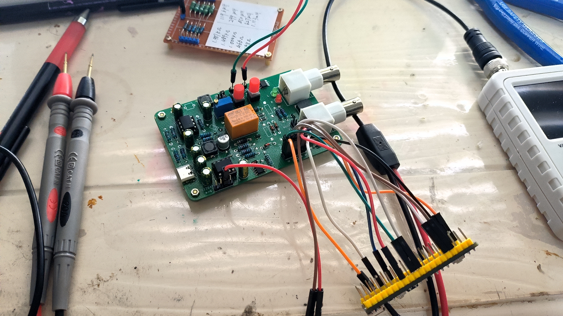

Multimeter (resistance/inductance/frequency/AC Vpp meter) (fixed waveform recognition)
Resistance, inductance, and AC voltage measurement based on Raspberry Pi, Pico, and Arduino

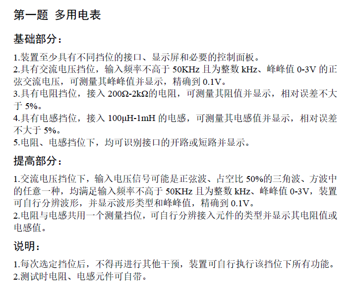

Problem
Analysis and Requirements
: • Inductance/Resistance Measurement
• Inductance: Use an LM393 voltage comparator to form an LC oscillation circuit. Measure the oscillation frequency with and without the inductor being measured. Calculate the inductance value using the LC oscillation circuit frequency formula.
• Resistance: Use a 1kΩ resistor in series to form a voltage divider circuit. Calculate the resistance value using the voltage ratio.
• Resistance/Inductance Identification Principle
• Use a double-pole double-throw switch. When not pressed, the measurement path is short-circuited to measure the inherent oscillation frequency of the LM393. When pressed, the measurement path is connected, and a "pressed" signal is output to the microcontroller.
• Initially, the measurement is performed as an inductor. If the LC oscillation circuit does not oscillate, it is an open circuit.
• If the calculated inductance value is 0, switch to resistance mode measurement via a relay (disconnect the LM393 path and connect the 1kΩ resistor).
• If the calculated resistance value is 0, it is a short circuit, but it may still be an inductance measurement. Therefore, after a short circuit alarm, switch back to inductance mode.
• Frequency Measurement
• An LM393 voltage comparator and a Zener diode are used to convert the signal under test into a 3.3V PWM signal, which is
then measured by a microcontroller. • The microcontroller uses an external interrupt, and the frequency can be calculated by measuring the time difference between two rising edges of the interrupt. However, at high frequencies (approximately above 3000Hz), the time of entering and leaving interrupt mode can cause significant errors. Considering the range of the frequency under test, the frequency is calculated by counting the number of interrupts per second, which provides higher accuracy.
• Peak-to-Peak Measurement
• A half-wave precision rectifier circuit is used to convert the signal under test into DC power. The difference between the maximum and minimum values ​​of the signal under test is then measured using the microcontroller's ADC to calculate the peak-to-peak value. (Direct half-wave rectification, diode voltage drop will cause measurement error)
• Waveform recognition
• With the help of a precision rectifier circuit, a large number of samples are taken to calculate the effective value of the signal under test. The ratio of peak value to effective value is used to determine the waveform. Hardware circuit
composition:

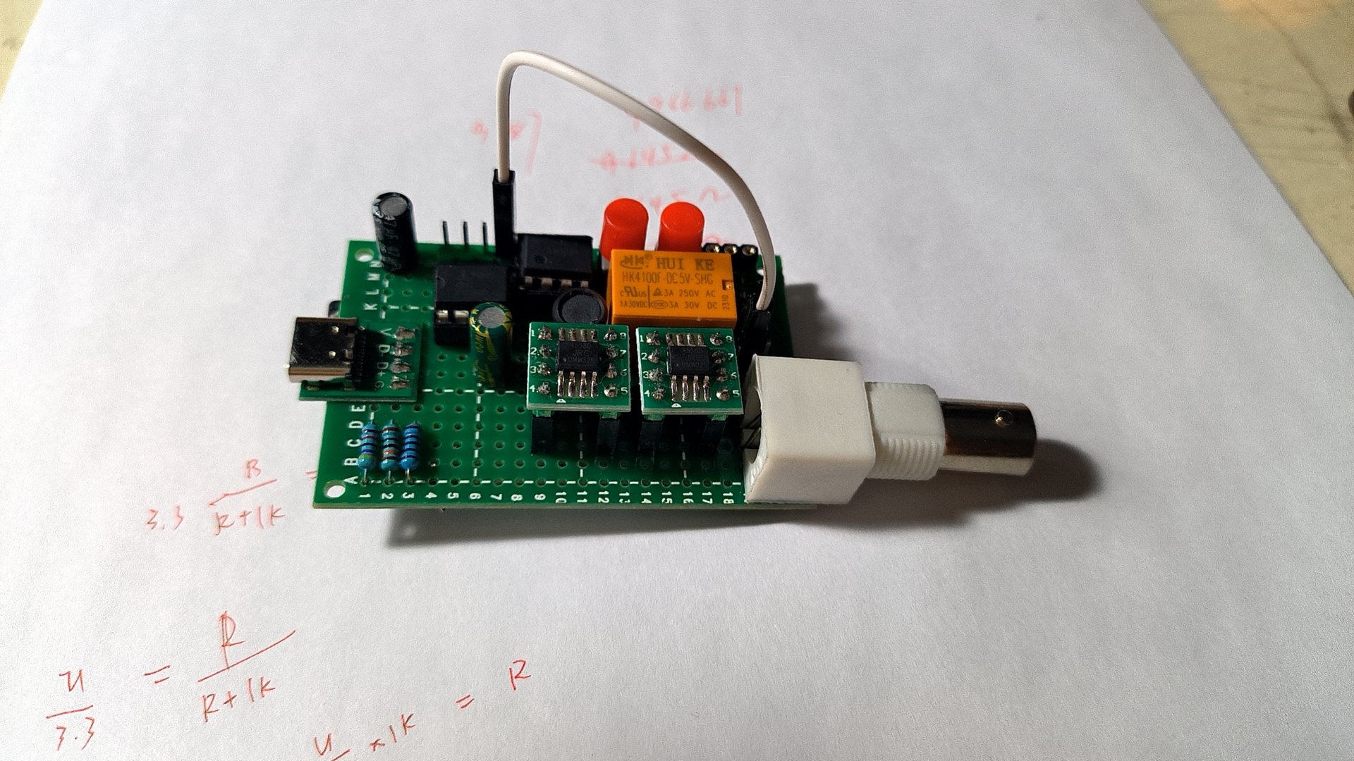

Raspberry Pi pico connected to PCB board. Wiring details are shown in the code. Note that the Raspberry Pi VUSB is connected to the PCB 5V. The Raspberry Pi is powered by USB, or it can be powered separately.

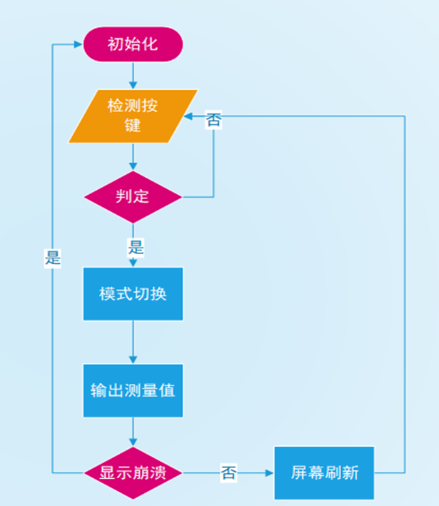

Program flowchart .
Physical display:

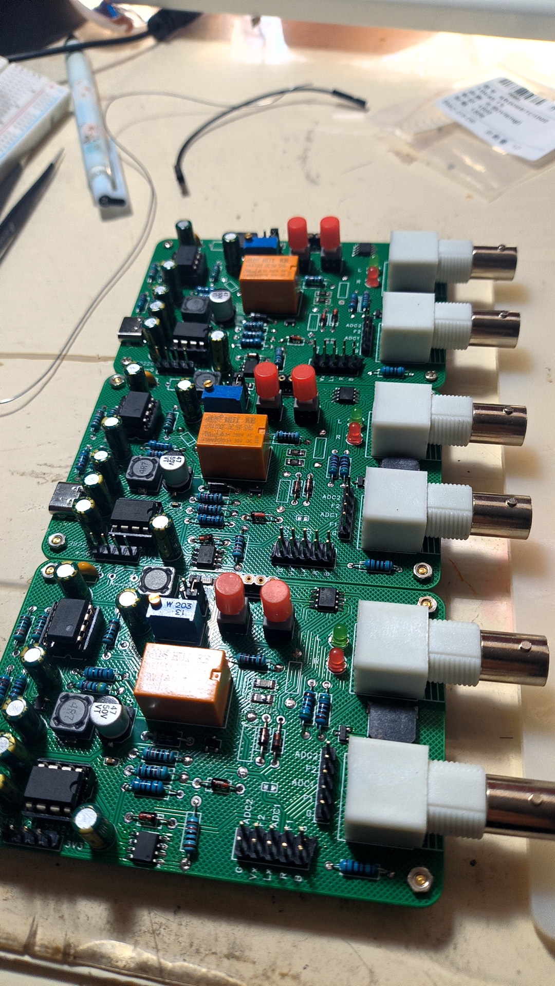

Demo board used for testing.
Demo board reverse side.

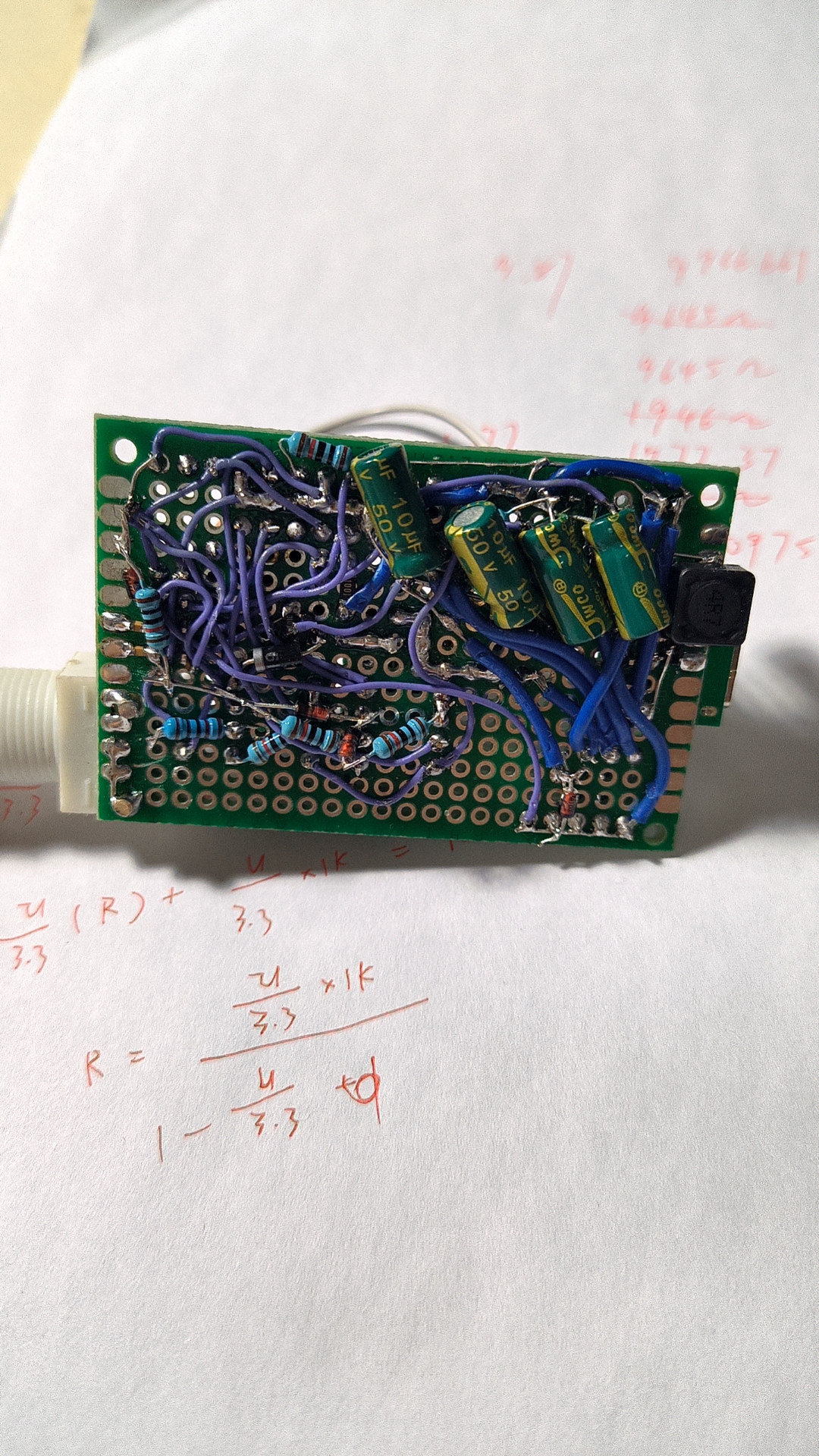

Note:
The effective value of the AC voltage of sine and triangular waves is the waveform. The measurement error is large (100mV+) at higher frequencies (10kHz+).
Physical picture: The PCB silkscreen is incorrect. The bottom of the vertical pin header is the AC voltage input instead of G (ND). It has been corrected in the file.

STM32 minimum system board (including breathing light test)
The STM32 minimum system board has external pins brought out for ease of use. It can be programmed using STlink and can realize button reset and breathing light test.

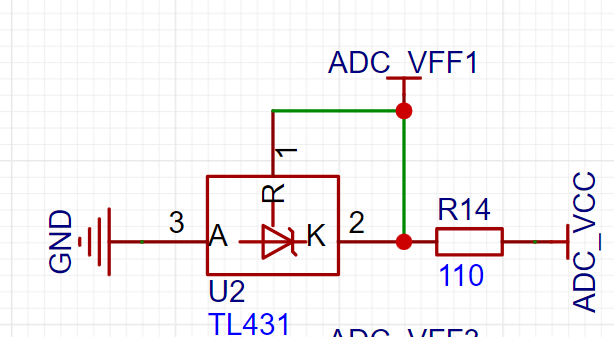

Schematic diagram:
PCB layout:
