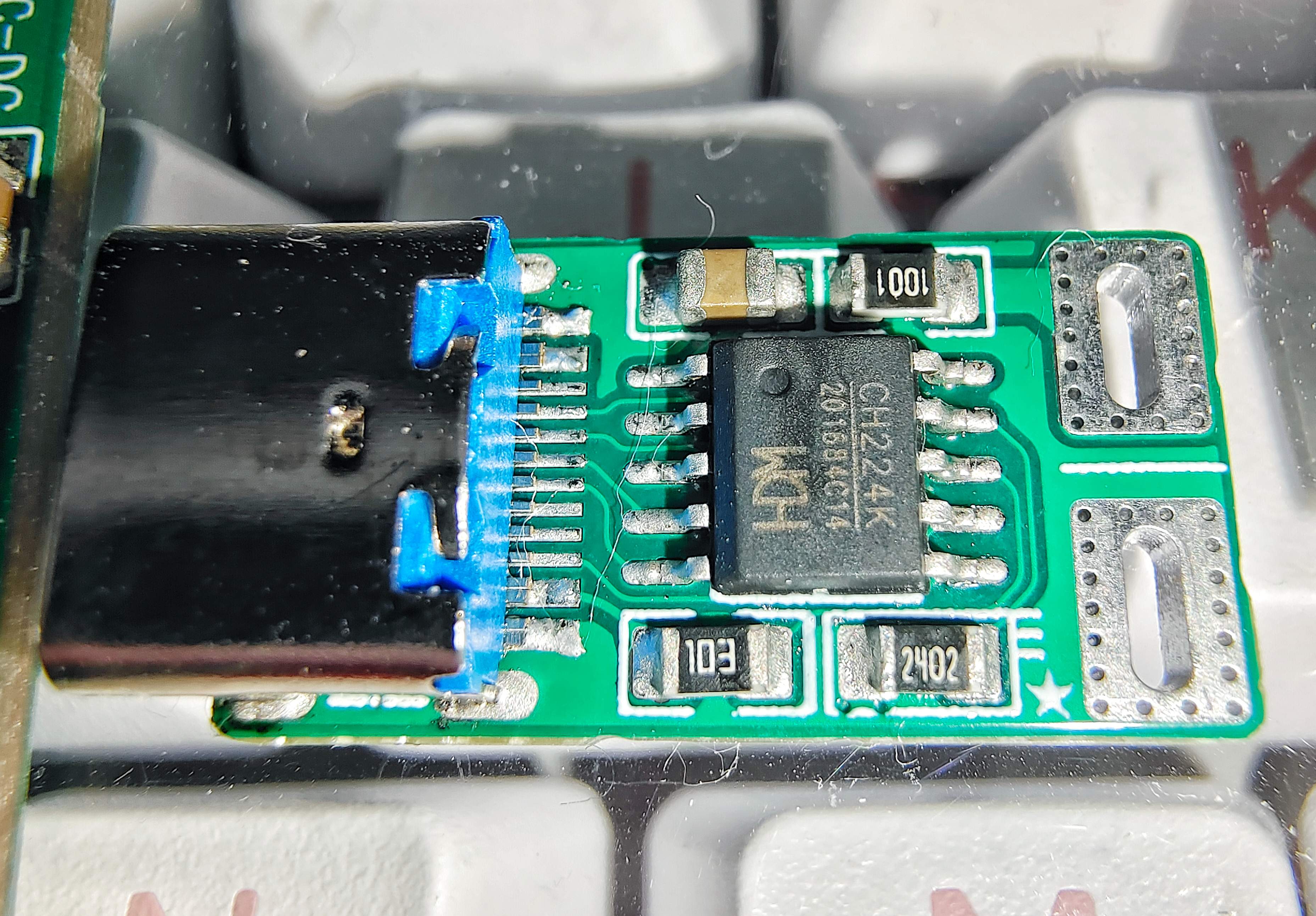

Function Introduction:
Interface: TYPE-C 16P female connector →→→ Large area soldering pads
Range: Maximum requested voltage level PD20V
Onboard Chip: CH224K
Requested Voltage Levels: Supports PD3.0/2.0, BC1.2 and other boost fast charging protocols 9V 12V 15V 20V
How to Use: You need at least one charger that supports the PD protocol. Ensure the voltage selection resistor value is correct. Plug the charger's TYPE-C data cable into the decoy board's TYPE-C female connector. Then, CH224K will communicate with the charger via protocol. After a successful handshake, the VBUS pad will have the corresponding voltage level.
Update Log:
Project successfully verified.
Open source project released on 2023/5/9.
Notes on 2024/4/19:
6.8K=9V, 24K=12V, 56K=15V, NC=20V. The voltage level selection method uses single resistor configuration.
To ensure the PCB's current carrying capacity, I flattened the positioning posts of the [Component TYPE-C Female Socket], which prevents the VBUS traces from being blocked by the slots, resulting in a larger copper foil area.
The PCB is a 4-layer board. With a 2-layer board, the GND return path is too thin; it can't pass through the top layer, and the bottom layer only has a tiny bit. Fortunately, it's a 4-layer board, with the inner 1 and inner 2 layers all used as GND to ensure sufficient GND return area.
Since I didn't adjust or modify the BOM, some components in the BOM directly generated by JLCPCB EDA may not match. It's best to carefully check the component names and values ​​on the schematic and PCB before purchasing.
The datasheet for the CH224K chip is included in the attachments on the open-source page. The image shows
               the TYPE-C female connector with its flattened positioning
posts (circled in red).
The component soldering details are also included.
