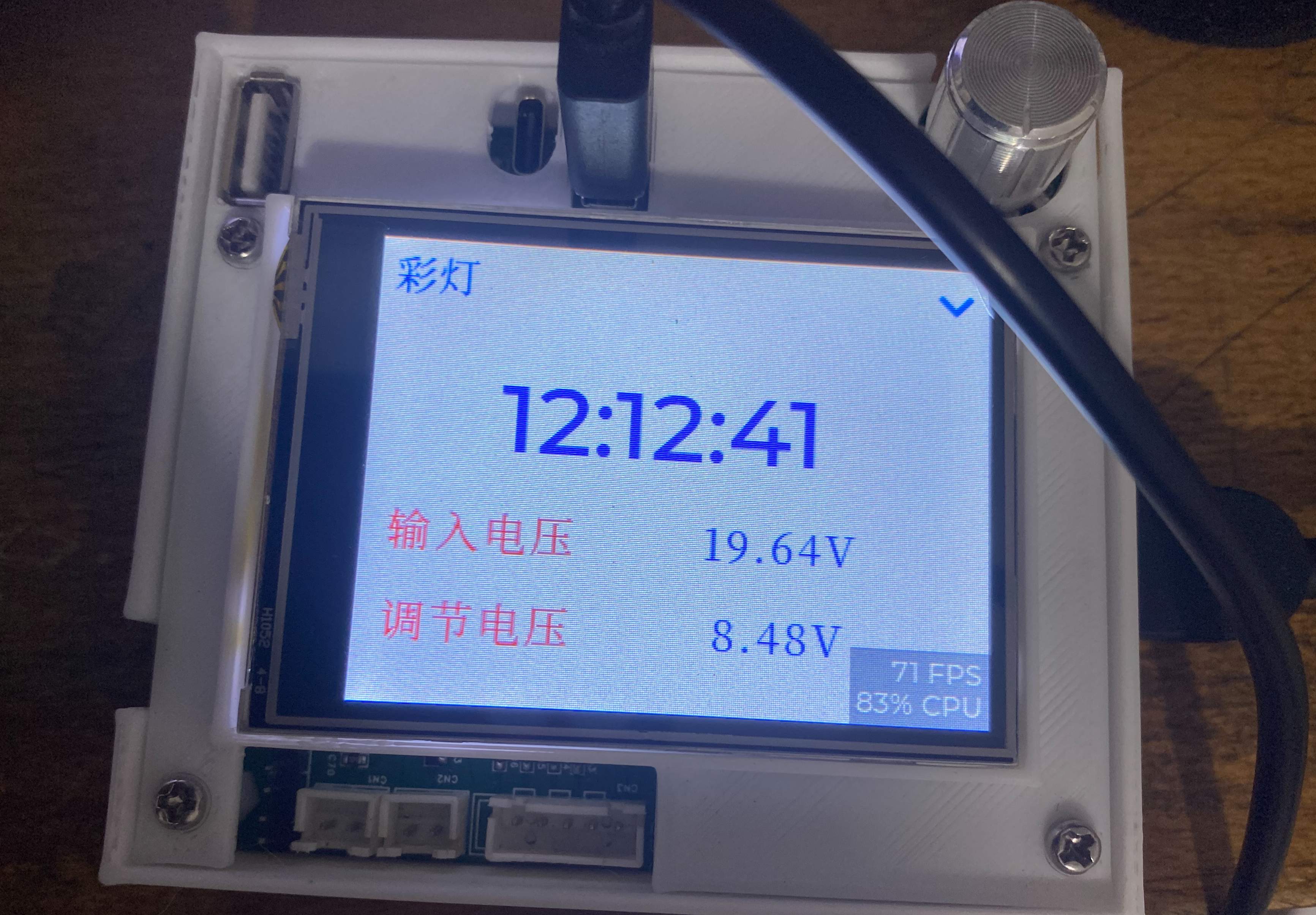

Having learned about JLCPCB hardware for so long, I'm finally contributing to JLCPCB's hardware community!
The input PD fast charging uses a 224kbps input as a decoy. The other two ports utilize a discarded computer charger, so they use the most common Lenovo square port and DC 2.5, meaning only one input port can be used at a time.
Fast charging output:
Supports PD 2.0/3.0 and PPS
, supports Quick Charge 3.0+/3.0/2.0 protocols - supports Xiaomi Charge Turbo 27W protocol, Huawei FCP/SCP/HVSCP protocols, Samsung AFC protocol, USB BC1.2 DCP, and Apple 2.4A charging specification
to adjust the maximum output current to 3A.
Each output port uses an INA226 to detect charging information.
The touchscreen is driven by an STM32 microcontroller and LVGL library.
Reserved: One PWM port, one ADC detection port, and one 7-pin 2.54 port for connecting to a DWIN serial touchscreen.
Reserved: One 4-pin 2.54J interface for 3.3V and 5V power output.
Reserved: One 4-pin 2.54 interface for microcontroller downloading and debugging.
A simple usage video is attached.
Project code upload failed; contact me if you need it.
