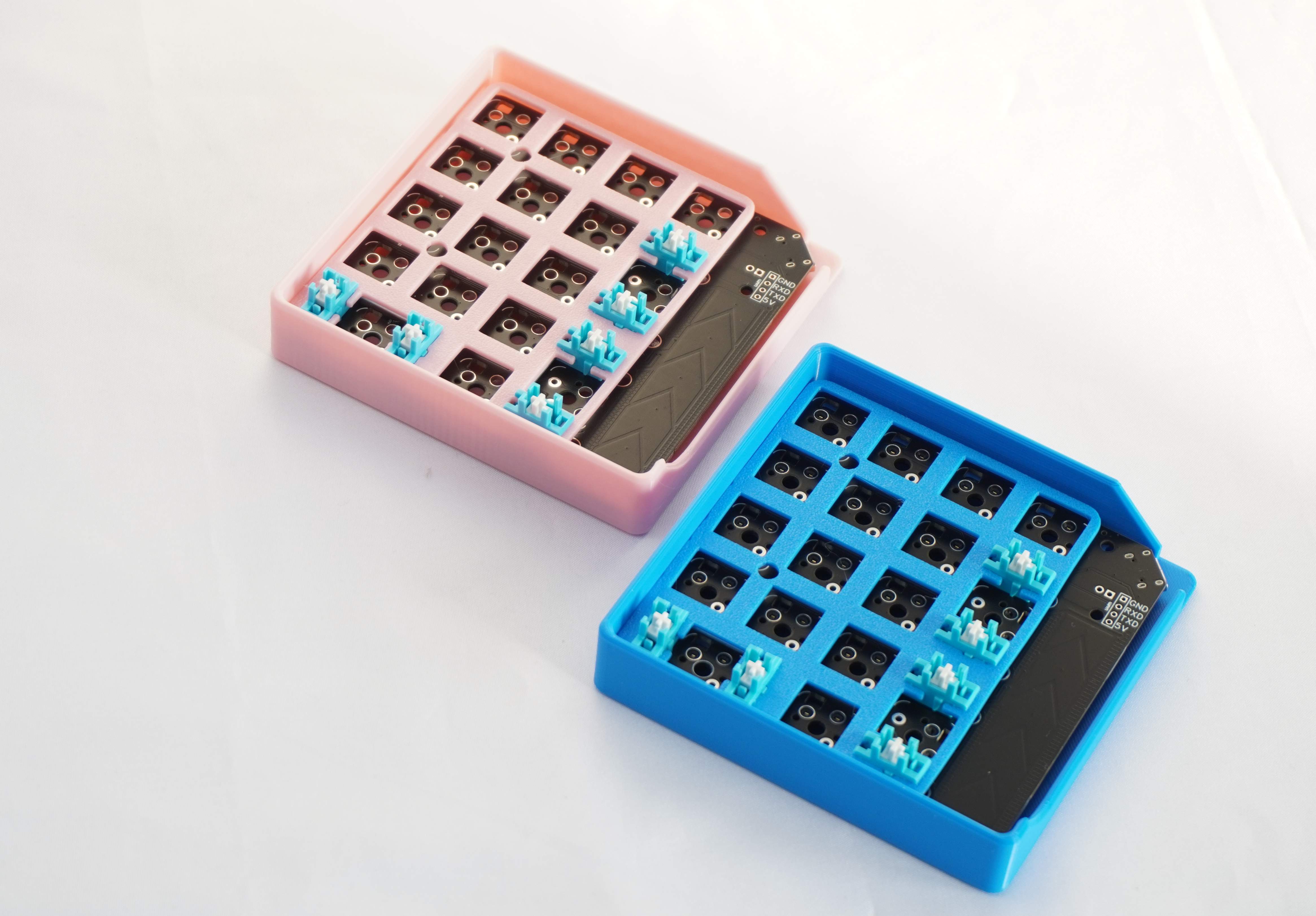

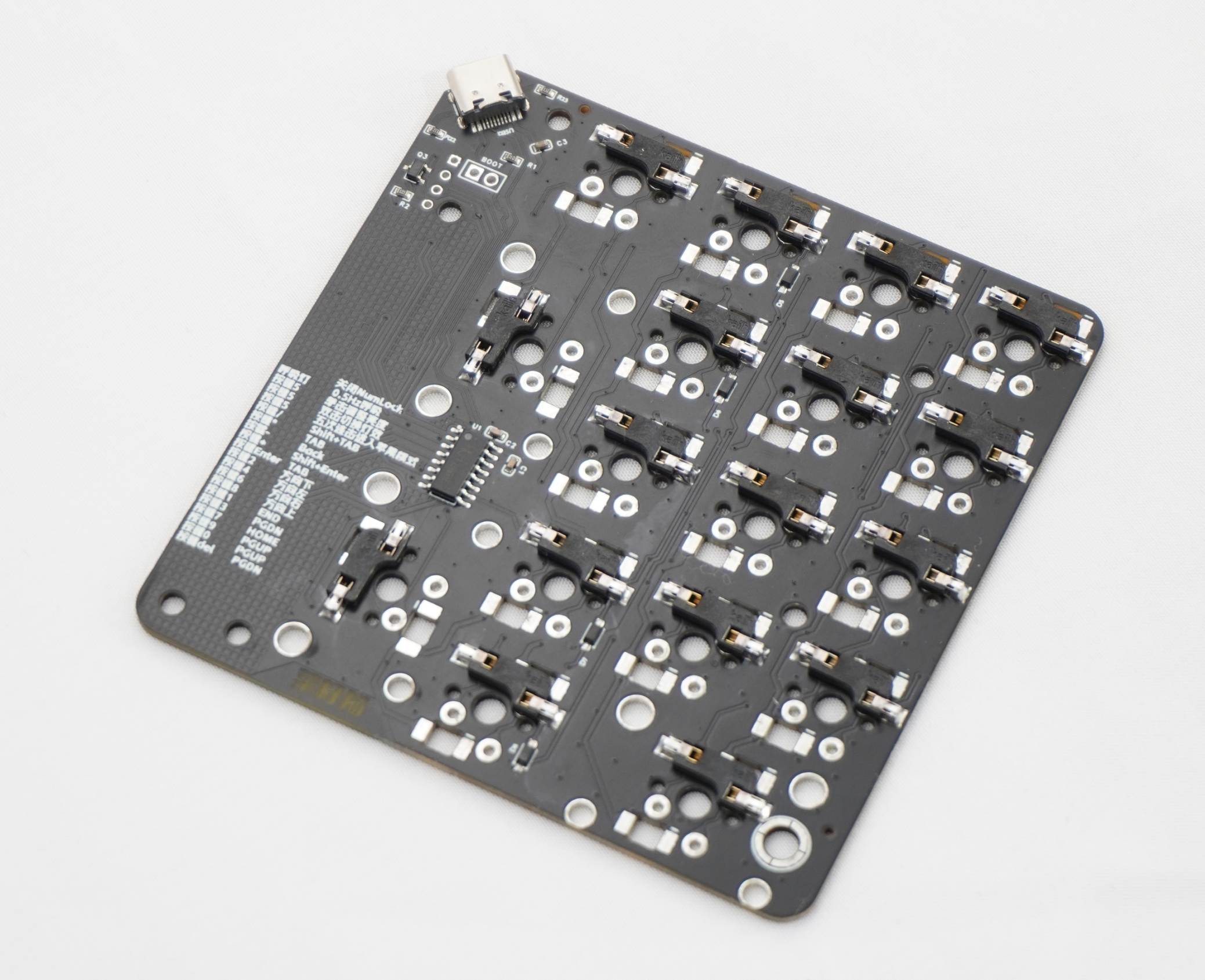

Basic 552G_17 Wired Single-Mode Numeric Keypad
Wired low-cost numeric keypad (original author link: https://oshwhub.com/yANgZEN/zui-gai-shuo-zi-jian-pan).
Made using the Qinheng CH552G chip. PCB dimensions are available for free (you know what I mean).
Two modified versions based on the original author's work :
V1
board supports soldering and hot-swapping, supports single-color lighting, uses 3528 reverse-mount LEDs
modified to Type-C connector; RESET button removed, replaced with pin header.
V2 board
modified for hot-swapping + 1206 reverse-mount single-color LEDs,
replaced with Type-C connector;
Shell file: https://makerworld.com/zh/models/236647
