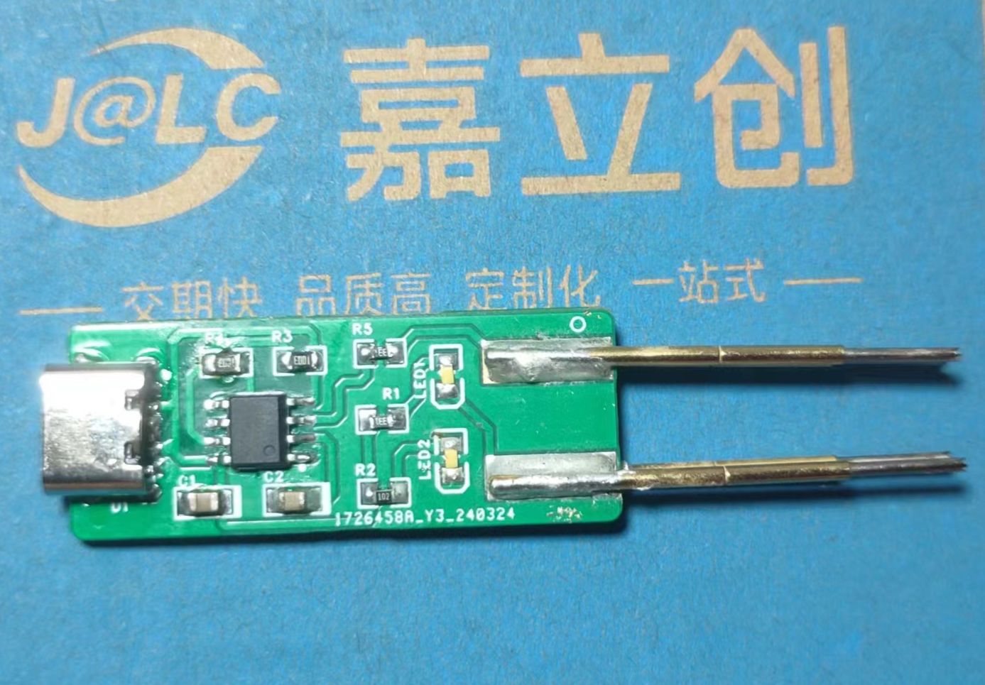

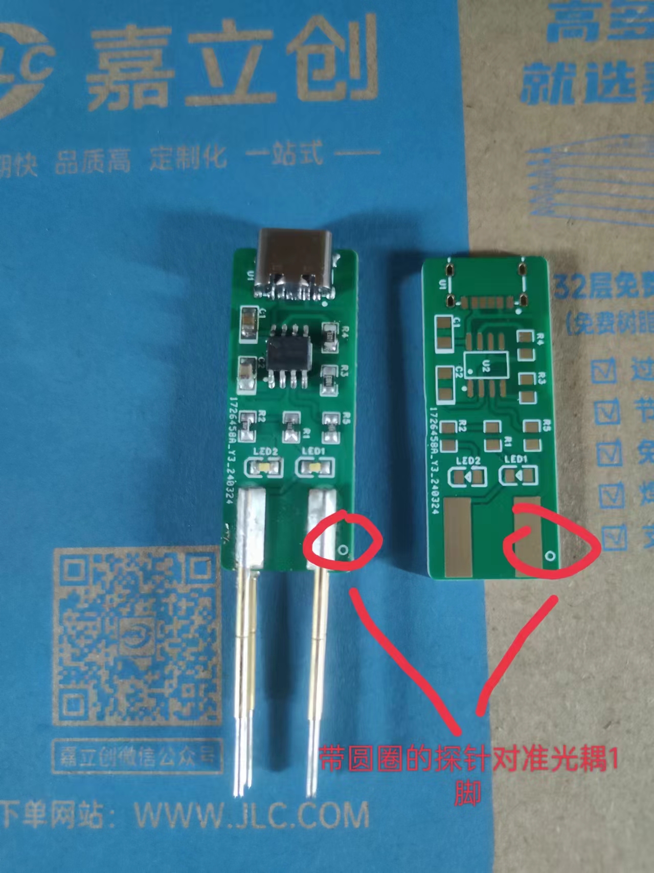

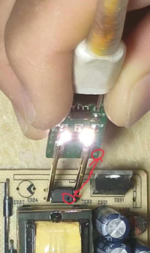

This small optocoupler testing tool uses an NE555 chip to generate a PWM signal of approximately 2-3 Hz. A probe is applied to pins 1 and 2 of the optocoupler, and pins 3 and 4 receive the signal, causing an indicator light to flash. The entire tool has a simple circuit principle, few components, and uses a 5V Type-C interface for power supply, making it convenient and quick. During testing, use the probe with the circle on the circuit board to press against one pin of the optocoupler. A flashing indicator light indicates the optocoupler is good; no light or a constantly lit indicator light indicates a problem.
