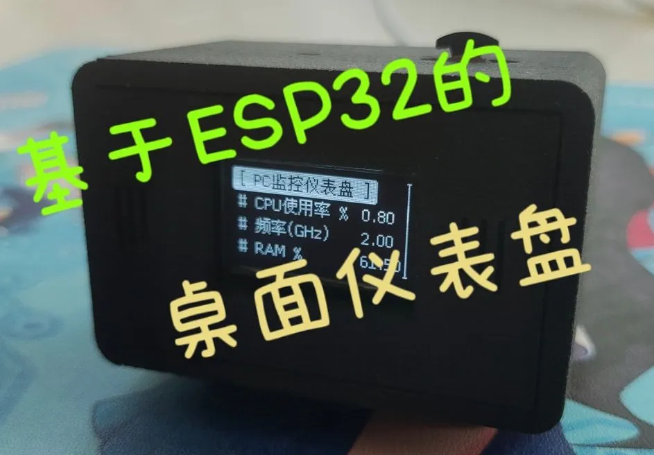

This is a desktop dashboard based on ESP32
. The project is available at:
https://github.com/vrxiaojie/ESP32-desktop-dashboard
and https://oshwhub.com/vrxiaojie/esp32-based-desktop-dashboard . It uses the
LCSC
ESP32S3R8N8 development board.
It can display various computer performance indicators in real time, and also features temperature and humidity detection, low-power sleep mode, automatic brightness, and OTA upgrades. The menu is based on WouoUI and is smooth and fluid.

4 3D shell
The 3D shell was drawn using LCSC EDA. Please open and view the open-source link with an editor.
Nylon material is recommended; it's a bit pricey, but the appearance and texture are excellent.
5. Appearance Showcase
