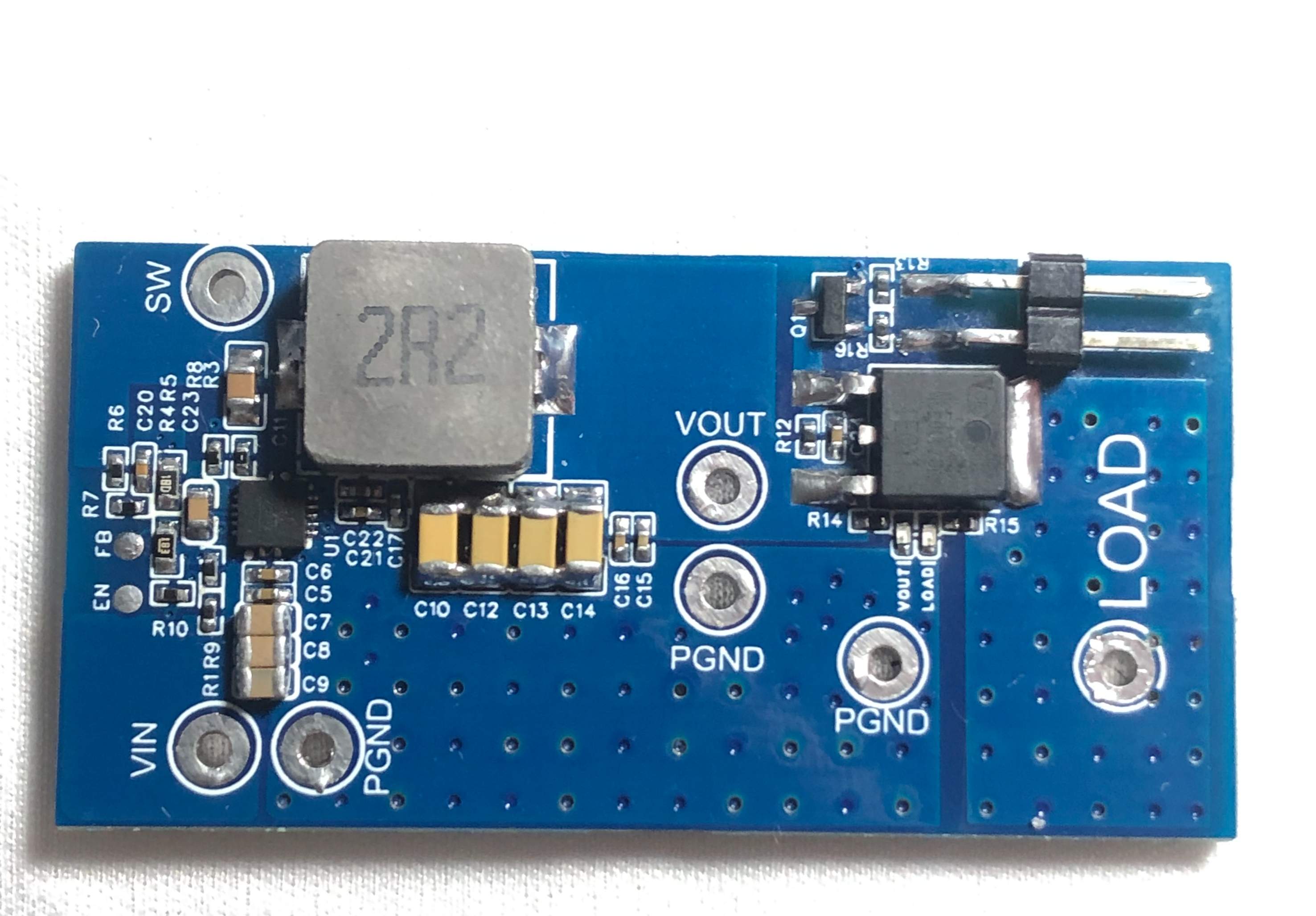

MP8765-Eval
This is a design verification of the MP8765 IC from Monolithic Power Systems. ( This Evaluation Module has been verified by our team of professionals)
PCB layout is mostly according to the layout recommendation section of the datasheet of MP8765.
At the right side of the board, connect a load/shunt resistor between the LOAD and PGND pad, then use a GPIO from the microcontroller to control the load switch at whatever speed (di/dt) or duty cycle you want. Then you can watch the output voltage ripple or transient performance on your scope with this officially recommended layout.
Operate with your own design considerations/risks.
