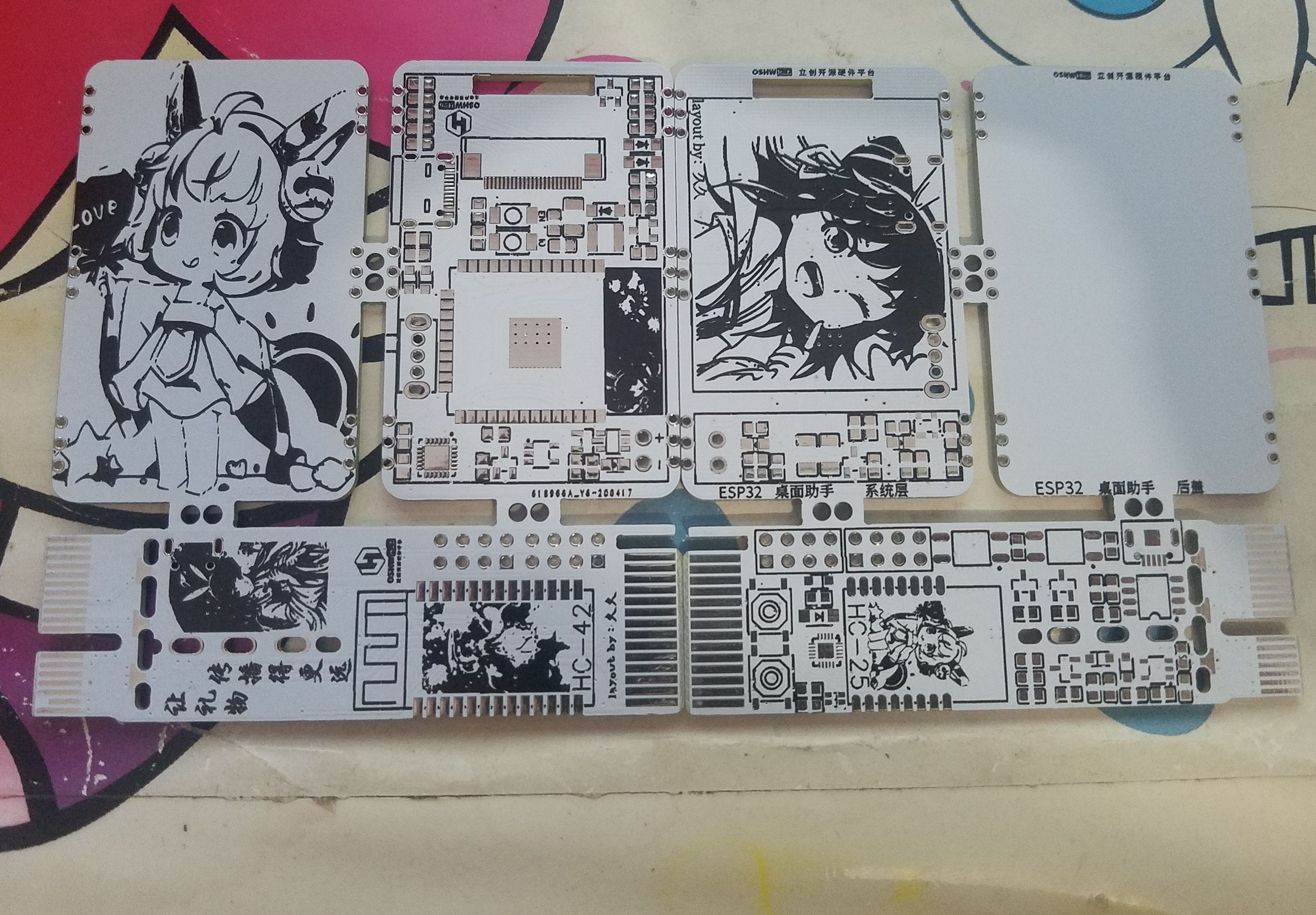

finally! ! finally! ! Jiujiu Boot Stick 2.0 will be released soon, and the PCB has already been designed! Let’s take a look at the preview!
The main functions continue from the previous version: 1. We need to be able to remotely control the power on and off and reset; 2. We also need to be able to control it manually; 3. We need it to be small enough to be placed between the PCIE x1 and PCI interface; 4. We need to Multiple power supply methods. Now, it is here, coming towards us with its small size and rich connotation. It carries three power supply interfaces, and it is willing to break its body in order to meet our excessive demands of having it lie horizontally on the motherboard. In this way, it meets all our requirements with its exquisite body. Shouldn't we give it a thumbs up? ! ! ! (Like, collect and leave [dog head saves life])
I have uploaded the program and the production video. Because it was a cloudy and rainy day, I used a flashlight, and when I took the photo, the surroundings were very dark. Jiujiu Boot Stick 2.0 is already available. I will install it and use it after the DuPont cable arrives, and then take a video of its use. The Bluetooth version of the program has been re-uploaded and the serious problem of being unable to disconnect the Bluetooth connection has been corrected. I re-uploaded the Bluetooth version of the program and corrected the problem of garbled Chinese characters on the mobile phone interface, but it is inevitable that one or two characters will be garbled on the computer interface and the mobile phone interface. Although the Bluetooth connection can be disconnected, the Bluetooth module parameters cannot be modified on the mobile phone.
Let me upload a few pictures of the real thing. I have already used it on my computer. I originally wanted to use WIFI, but there is only one WIFI module and I can't adjust it. It can't be used at all. I can only use Bluetooth. Use the demo video and watch the video directly below!
