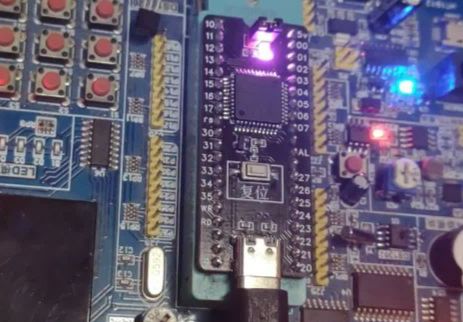

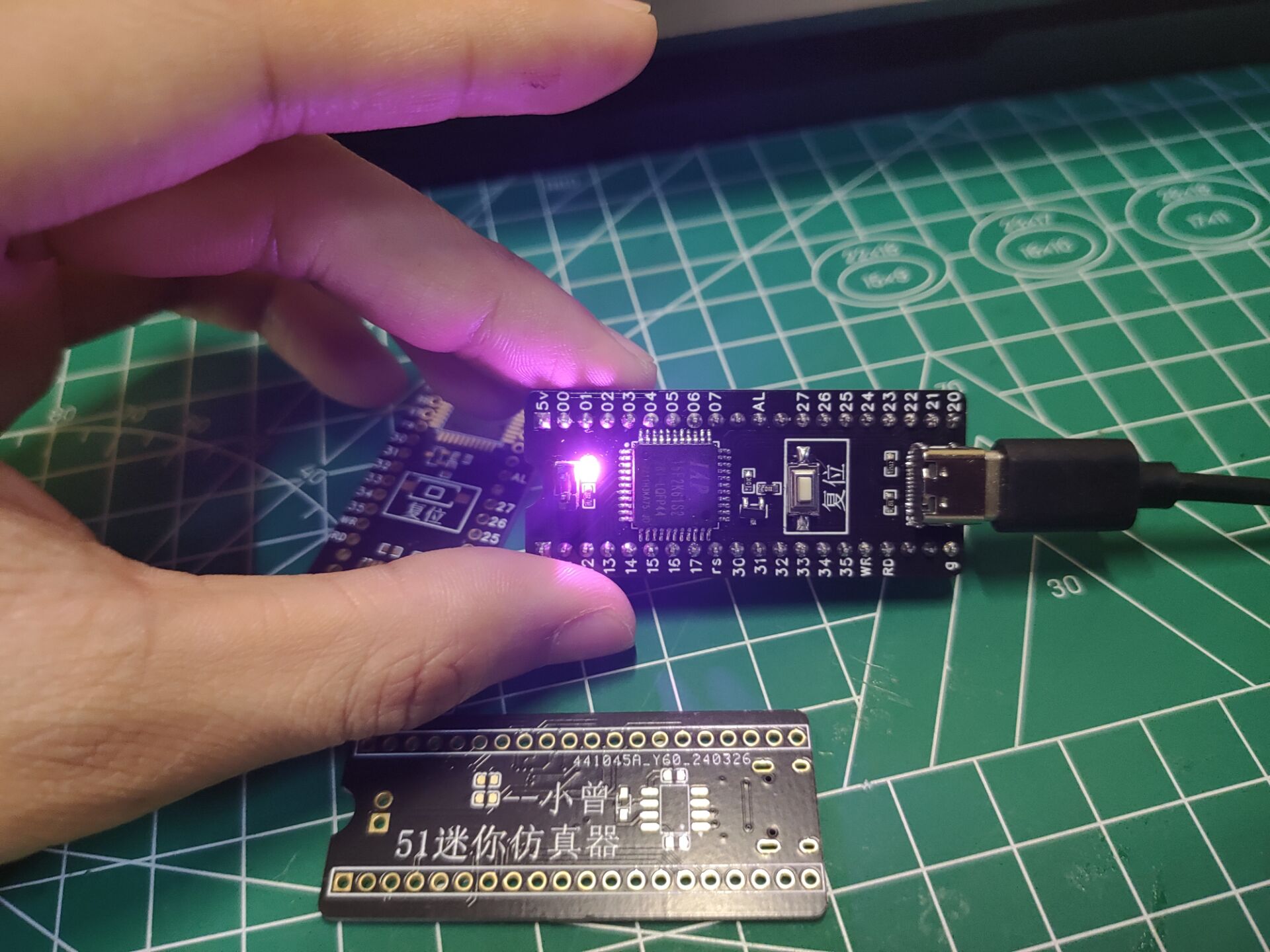

2.1 Overall Circuit Board

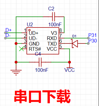

1. To reduce size, the serial port download circuit uses a CH340N

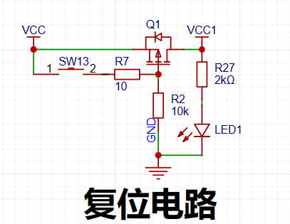

. 2. The reset circuit is shown in the diagram below. It uses a PMOS transistor for control. When the button is not pressed, R2 pulls down the gate by default, turning on the MOSFET and powering on the microcontroller. When SW13 is pressed, the MOSFET gate goes high, turning off the microcontroller's power, completing the cold start and resetting the microcontroller.

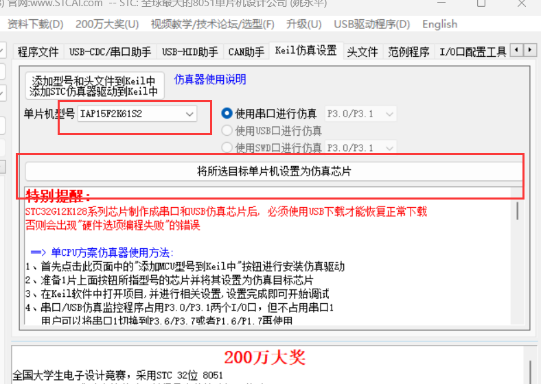

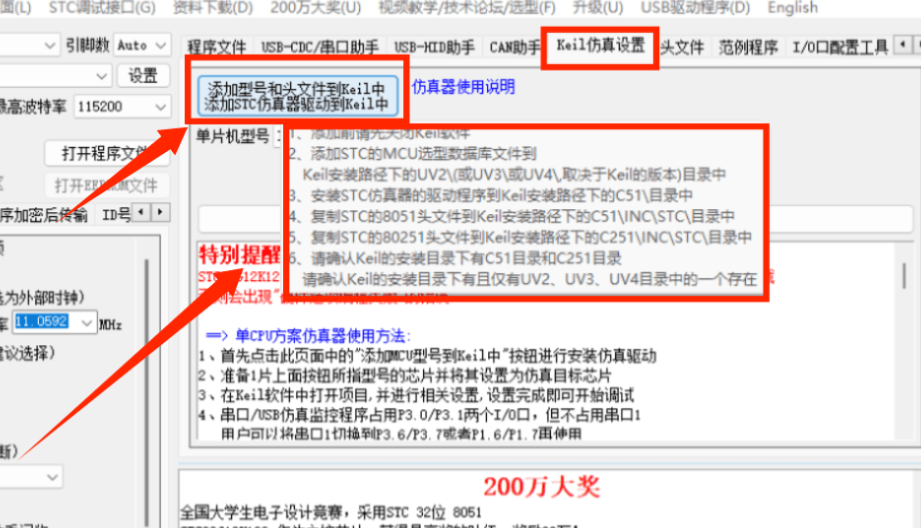

3.2 Simulation File Settings:
Use the attached STC-ISP software for related settings. First, add the simulation driver to the Keil file, then create the simulation chip.

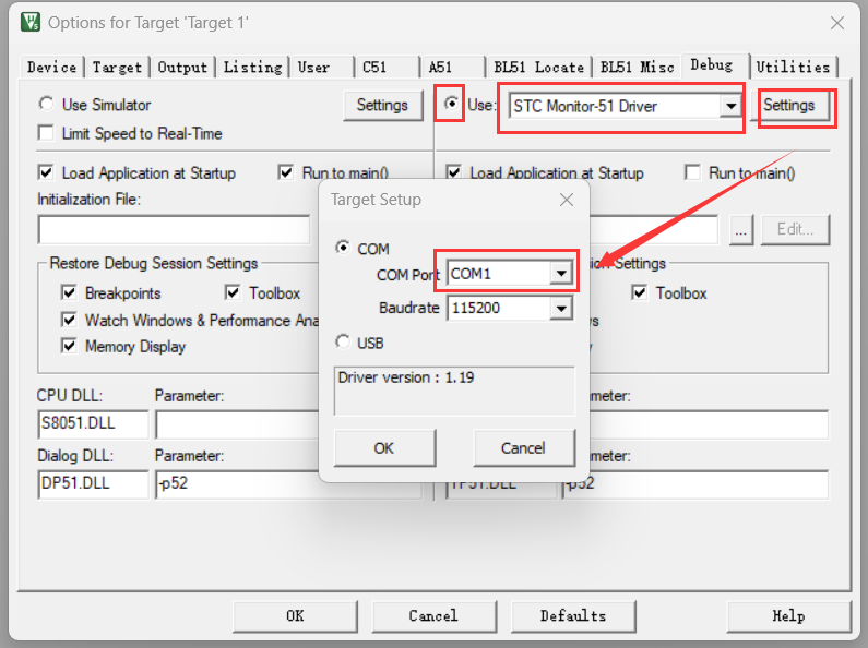

3.3 Debug Settings
: Note that these settings must be configured for each new project; otherwise, the simulation will not run correctly. Select the correct serial port number (if you don't know it, check the "Automatic Serial Port Number Detection" function in the STC-ISP software). The default speed remains unchanged.
