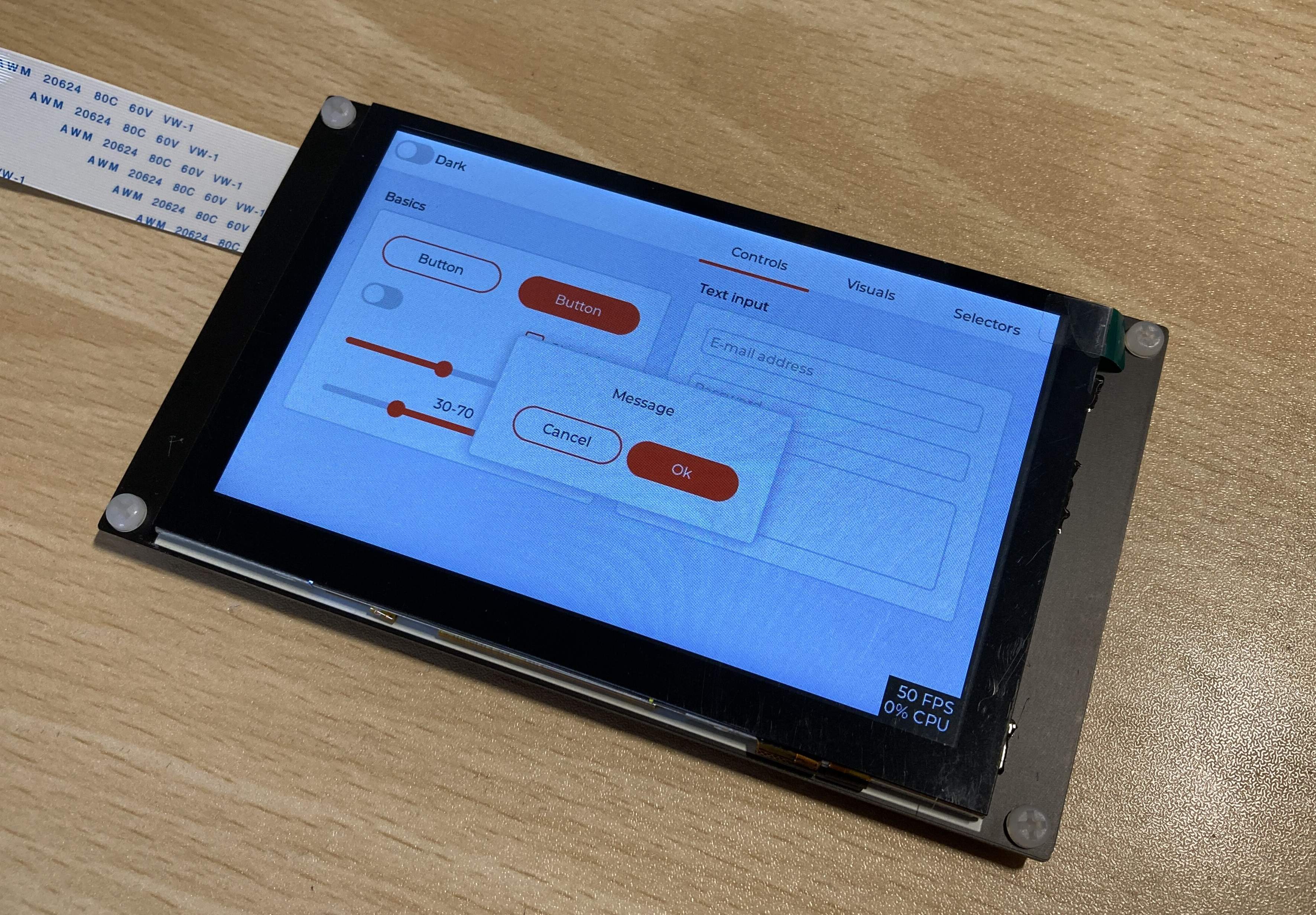

5-inch universal RGB screen module, compatible with Atomic, Wildfire, and Anti-Customer
Introduction
5-inch universal RGB screen module, compatible with Atom, Wildfire, and Anti-Keeper. With capacitive touch. Use constant current backlight with overvoltage protection to ensure the life of the LCD screen.
Precautions
  • There are three FPC sockets on the back, corresponding to the screen interfaces of Zhengdian Atom, Wildfire and Anti-Kick respectively. You need to check the line sequence carefully before connecting, otherwise there is a possibility of burning the screen (especially for boards like Wild Fire and Anti-Kick without over-current protection. ).
  • Which of the three seats should be welded to which one? Welding the three seats together will cause wildfire and atoms to be blocked and cannot be used because the distance is too close.
  • The screen can use the 5-inch 40Pin capacitive touch panel commonly used on Taobao.
  • In order to protect the screen backlight, the default backlight drive current is 10mA (the standard is 20mA). The brightness is acceptable when using a TN screen, but it will appear dim when using an IPS screen. If you feel it is not bright enough, you can modify the output current of the backlight driver by adjusting the value of R14. Please refer to the data sheet of PT4103 for details.
Front view one
Front view 2
Rear view
