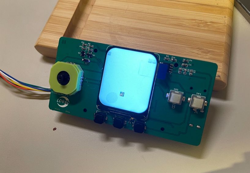

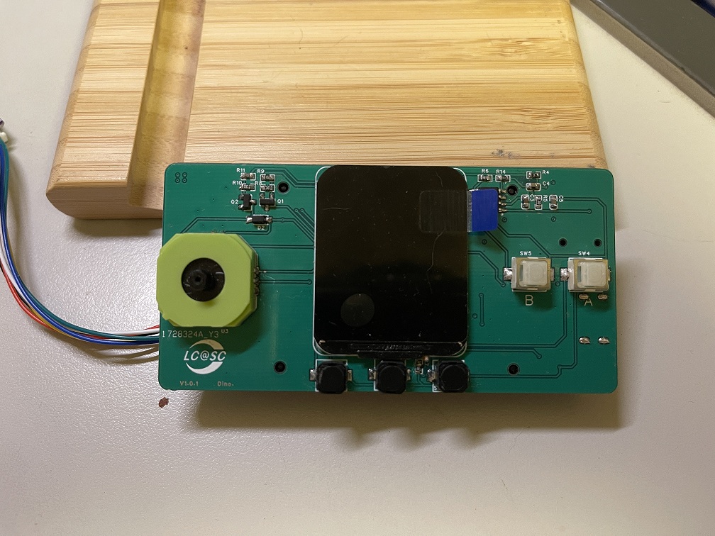

This project is a NES game console built using the LCSC Liangshanpai GD32F470 domestic development board.
1. Hardware Design:
Most I/O pins are referenced from the official game expansion board circuitry, facilitating quick verification of hardware circuitry functionality through example programs. 2.

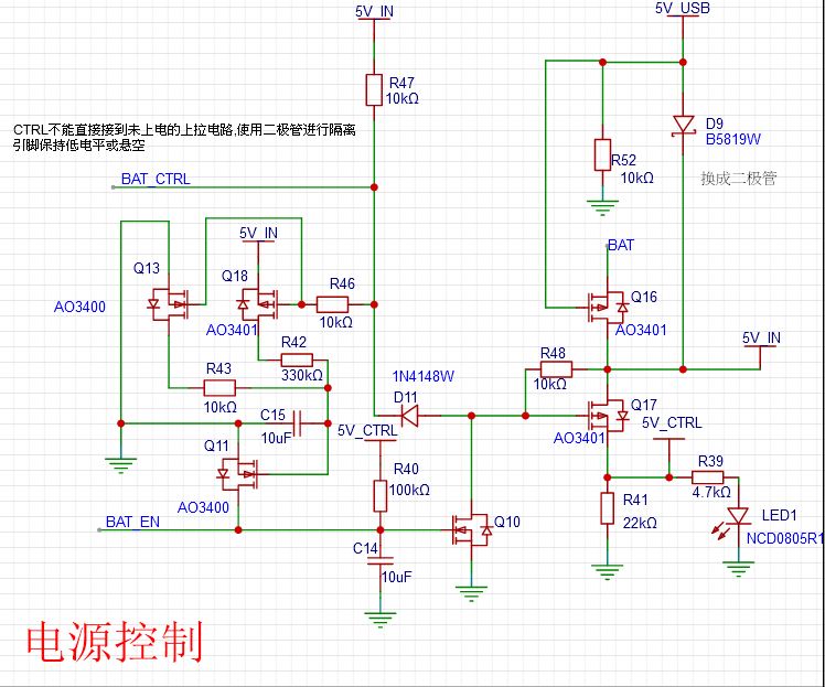

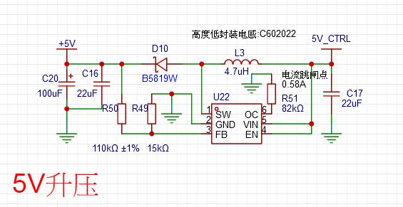

Power Management Module Design: This module requires either custom-designing a charging module board or incorporating the charging module into the schematic. 3.

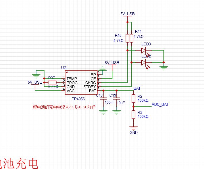

Lithium-ion Battery Charging Chip and
Lithium-ion Battery Boost Circuit :

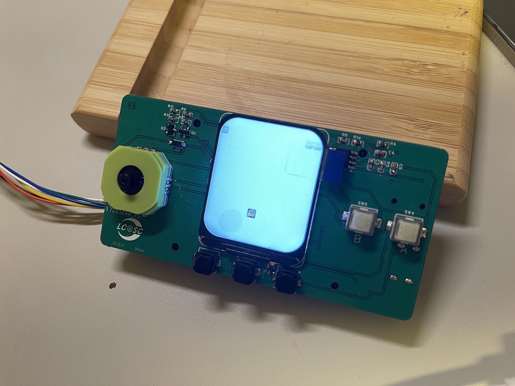

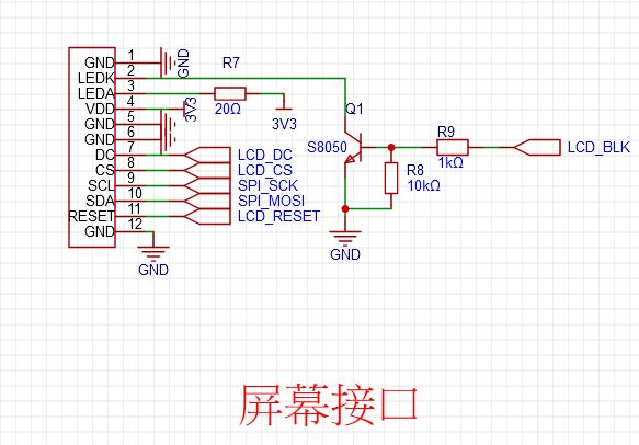

The display driver circuit
uses a 1.69-inch SPI-driven IPS high-definition rounded corner display with a resolution of 240*280 pixels. It offers good display quality and detailed image quality, with relatively simple peripheral circuitry and few control I/O pins.

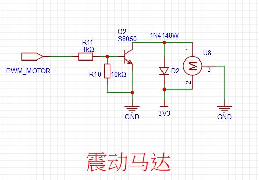

4. Motor Drive Circuit:
Enhances the gaming experience.

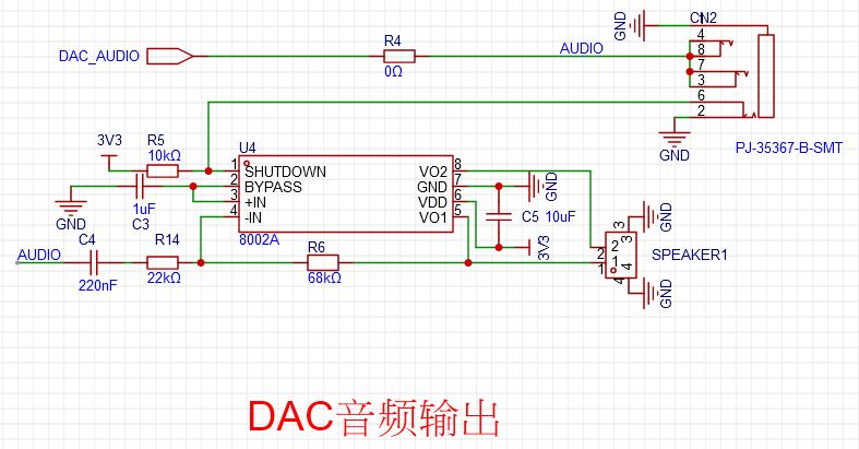

5. Audio Output Circuit:
Supports external speakers and 3.5mm headphones.

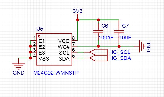

Extract -DAC.JPG5. EEPROM Circuit

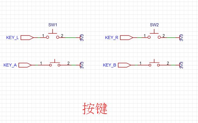

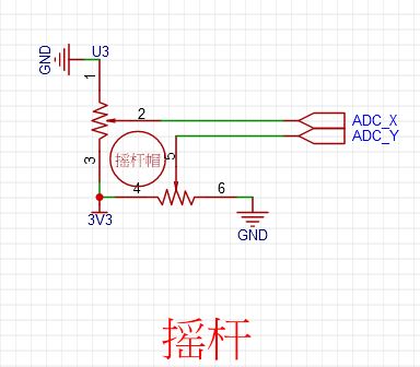

: Basic parameters are stored via EEPROM. 6. Practical Demonstration of
the Remote and Button Circuit. Summary: This training camp on designing a game console using the Liangshanpai development board has given me a better understanding of the functions of each pin and their applications in circuits. Secondly, when drawing a PCB, pay close attention to the reasonable placement of components to make soldering easier. Avoid short circuits and cold solder joints during soldering. Through this learning experience, I have gained a better understanding of schematic diagrams, become more proficient in selecting various components, significantly improved my soldering skills, and greatly enhanced my understanding of code. Finally, I am very grateful to JLCPCB for this training camp. [Liangshanpai Development Board: Game Console - Bilibili] https://b23.tv/TOAjKfi
