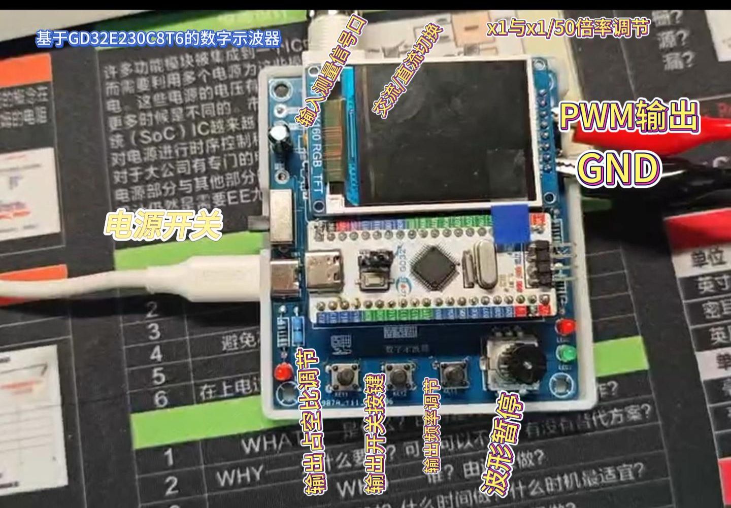

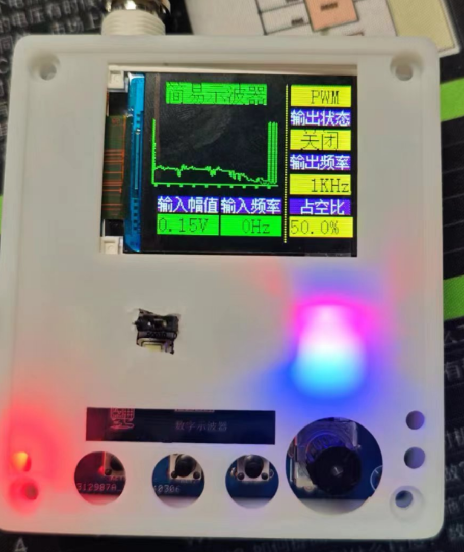

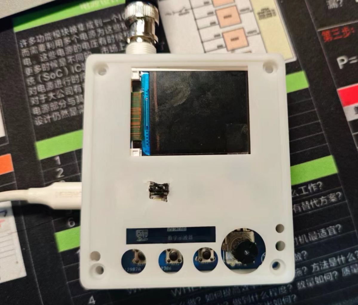

Digital Oscilloscope based on GD32E230C8T6
A Bilibili video
demonstrating a digital oscilloscope based on the GD32E230C8T6 (the video is too large and has been compressed; please extract video resources 1, 2, 3, 4, and 5 simultaneously if you need to download and extract it) . 【Digital Oscilloscope Based on GD32E230C8T6】 https://www.bilibili.com/video/BV1qJ4m177jP/?share_source=copy_web&vd_source=b56038c6fc5a32b35a0c1a44d8c245fc Circuit Principle : The analog front-end processing circuit is the most important part of the entire oscilloscope circuit design process. It extensively utilizes analog circuit knowledge, including input AC/DC coupling switching circuits, input signal attenuation circuits, and signal conditioning circuits. AC/DC coupling circuits can classify signal types into DC signals and AC signals. Real-world signals are often not ideal waveforms. For example, a DC power supply signal should be a horizontal DC signal, but it will always contain power supply ripple (AC signal). When acquiring AC signals, DC signals may also be mixed in, affecting the peak-to-peak value of the waveform. To ensure accurate measurement of the input AC signal, the characteristic of a capacitor to pass AC and block DC is utilized. By connecting a capacitor in series in the circuit, the DC component in the signal can be filtered out; this is the concept of AC coupling. DC coupling, on the other hand, does not perform any processing on the input signal. A toggle switch SW2 switches the input AC/DC coupling signal. When switch 2 is connected to 1, it is DC coupling; when switch 2 is connected to 3, it is AC coupling. How should the capacitor size be chosen? To solve this problem, it is necessary to understand the frequency characteristics of the capacitor. Ideally, the larger the DC blocking capacitor, the better. However, because different capacitance values ​​have different self-resonant frequencies, below the self-resonant frequency, the capacitor exhibits capacitive behavior, and above that frequency, it exhibits inductive behavior. The larger the capacitor, the lower its self-resonant frequency; simply put, a large capacitor passes low frequencies, and a small capacitor passes high frequencies. As shown in the diagram, when the ceramic capacitor is 0.1uF (100nF), its self-resonant frequency is 4MHz. Generally, the cutoff frequency of the capacitor is required to be fc = 1/5 * fo, where fo is the operating frequency in the circuit. Therefore, 100nF is sufficient for this project. However, if the input signal frequency is higher, a smaller capacitor should be selected. After the signal passes through the AC/DC coupling selection circuit, switch SW3 selects two channels. When switches 2 and 3 are connected together, the input signal flows directly into the subsequent voltage follower circuit. When switches 2 and 1 are connected together, the input signal is attenuated to 1/50th of its original value after passing through a resistor divider network composed of resistors R7, R11, and R14. This indicates that when the input signal amplitude is small, the lower voltage range should be selected first. If the input signal amplitude is uncertain during measurement, the higher voltage range can be used first. If the measurement falls within the lower voltage range, the lower voltage range can be used to obtain a more accurate measurement result, while simultaneously protecting the circuit. The input signal attenuation circuit uses a BNC-to-alligator clip probe, a non-professional oscilloscope probe. Only a simple circuit analysis is provided; further details regarding probe selection and impedance are omitted. If using a passive probe from a professional oscilloscope, since the probe has a ×1 and ×10 range selection, accurate measurement results can be obtained by adjusting the compensation capacitor on the probe or C10 in the circuit when the range is ×10. C10 is generally an adjustable capacitor, and its actual size depends on the capacitance characteristics between different boards. The signal conditioning circuit includes a voltage follower and a signal amplification circuit composed of operational amplifiers. When analyzing this part of the circuit, it is necessary to understand the principles of virtual open and virtual short of operational amplifiers. Virtual open: The input impedance of an ideal operational amplifier is infinite, but the input impedance of a real operational amplifier is finite. If a voltage is applied to the input terminal of the operational amplifier and the current is measured, the current reading will be close to 0, giving the impression that the operational amplifier is internally disconnected and no current is flowing in. However, it is actually connected; this phenomenon is called virtual open. This can also be understood using Ohm's Law, U=I*R. When the voltage is constant, the current is inversely proportional to the resistance; if the resistance is infinitely large, the current becomes infinitely small, approaching zero. Virtual Short: A virtual short phenomenon occurs when an op-amp is in deep negative feedback, making the potentials at the two input terminals equal, as if the two input terminals were shorted together. This can be approximated as v+=v-. In negative feedback, a portion of the op-amp's output signal is extracted and fed back to the input terminals. This feedback makes the voltage difference between the two input terminals (positive and negative) approach zero; the voltages at the two input terminals are almost equal. Although the two input terminals of the op-amp are not electrically directly short-circuited, due to the negative feedback, the voltages at the two input terminals are almost equal, as if they were short-circuited, hence the term virtual short. Voltage Follower : A voltage follower is characterized by its output voltage amplitude and polarity being the same as the input voltage. It also has high input impedance and low output impedance, and is often used as a buffer stage and isolation stage. Due to the virtual short characteristic of the operational amplifier, V+=v-. Since Vin=V+ and Vout=V-, Vin=Vout, meaning the voltage at test point TP6 is the same as the voltage at TP7. The input signal to the inverting amplifier is input from the inverting input terminal of the operational amplifier, giving it the function of outputting signals with opposite polarity and amplifying the input signal. When the non-inverting input terminal of the operational amplifier is grounded, IJ+=OO, thus forming an inverting amplifier circuit. Due to the virtual short characteristic of the operational amplifier, the current flowing into the operational amplifier from the inverting input pin is 0. R13 and R15 can be considered as connected in series, so the current flowing through them is the same. Due to the virtual short characteristic, v+=v-=0 and i+=i-=0. Therefore, the formula for calculating the inverting amplifier is: Substituting Vi=1V, R13=20K, and R15=10K into the series circuit, we get Vo=-0.5V . Since the currents in the series circuit are equal, the output voltage is -0.5 volts. The input signal of the non-inverting proportional amplifier is input from the non-inverting input terminal of the operational amplifier, and it has the function of outputting the same polarity and amplifying the input signal. When the inverting input terminal of the operational amplifier is grounded, U-=0. At this time, a non-inverting proportional amplifier circuit is formed. Due to the virtual open characteristic of the operational amplifier, the current flowing through the two input pins of the operational amplifier is 0, that is, the current flowing through R4 is 0, Vin=V+. It can be regarded as R13 and R15 connected in series, so the current flowing through them is also the same. Due to the virtual short characteristic, the voltages of the two input pins are the same, that is, V+=V-, so Vin=V+=V-. Vo forms a loop with R13 and R15, so the current flowing through it is... Considering R13 alone, the current flowing through it is also equal to the voltage across it divided by its resistance value. Substituting into Vin=V+=V-, we get the following formula: From this, we can derive that substituting Vin=5/3V, R3=20K, and R5=10K, we get Vo=2.5V. The non-inverting proportional amplifier circuit is verified to be correct, and the output voltage is 2.5 volts. Synthetic Circuit: The inverting and non-inverting proportional amplifier circuits are analyzed together: When the non-inverting input of the op-amp is grounded, U+=0, substituting R15=10K, R13=20K, V1=-0.5Vi. When the inverting input of the op-amp is grounded, U-=0,

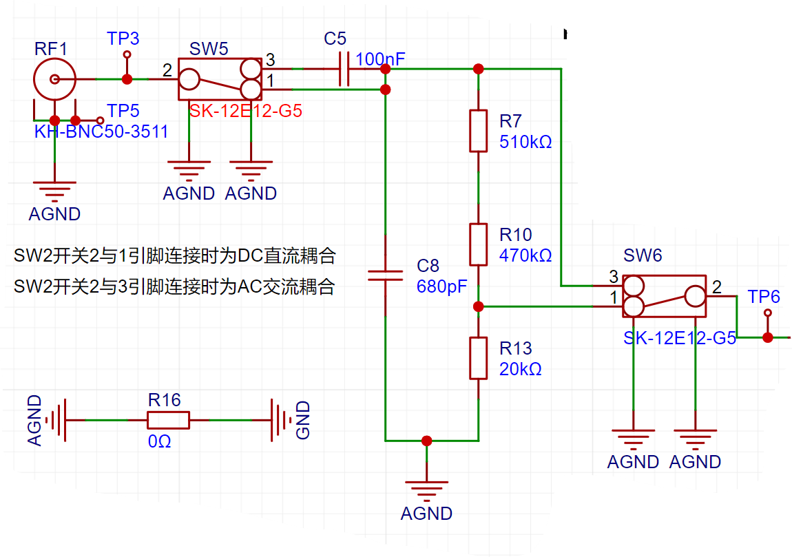

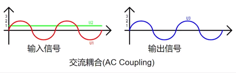

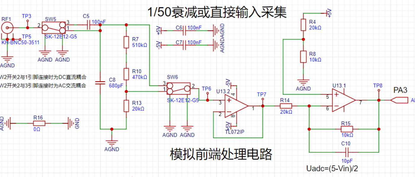

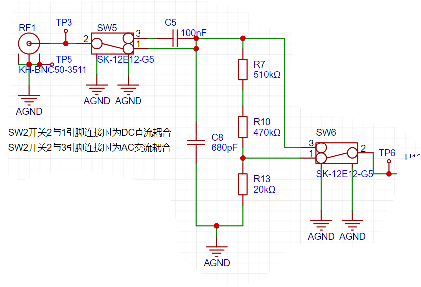

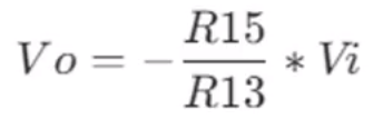

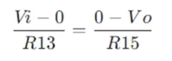

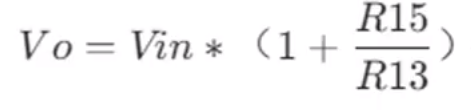

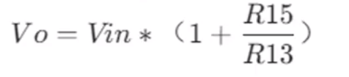

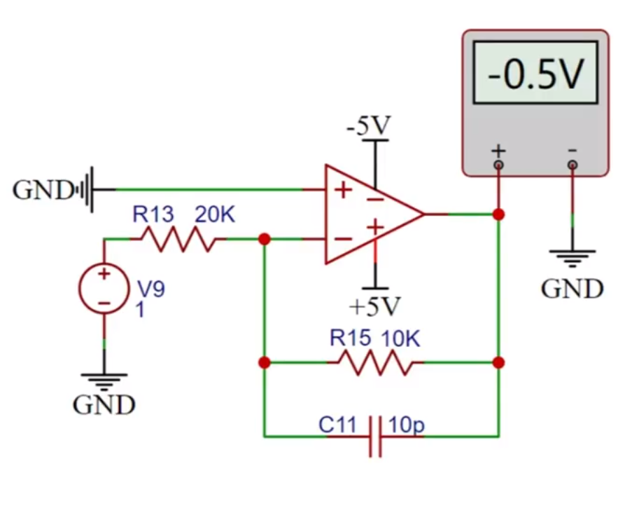

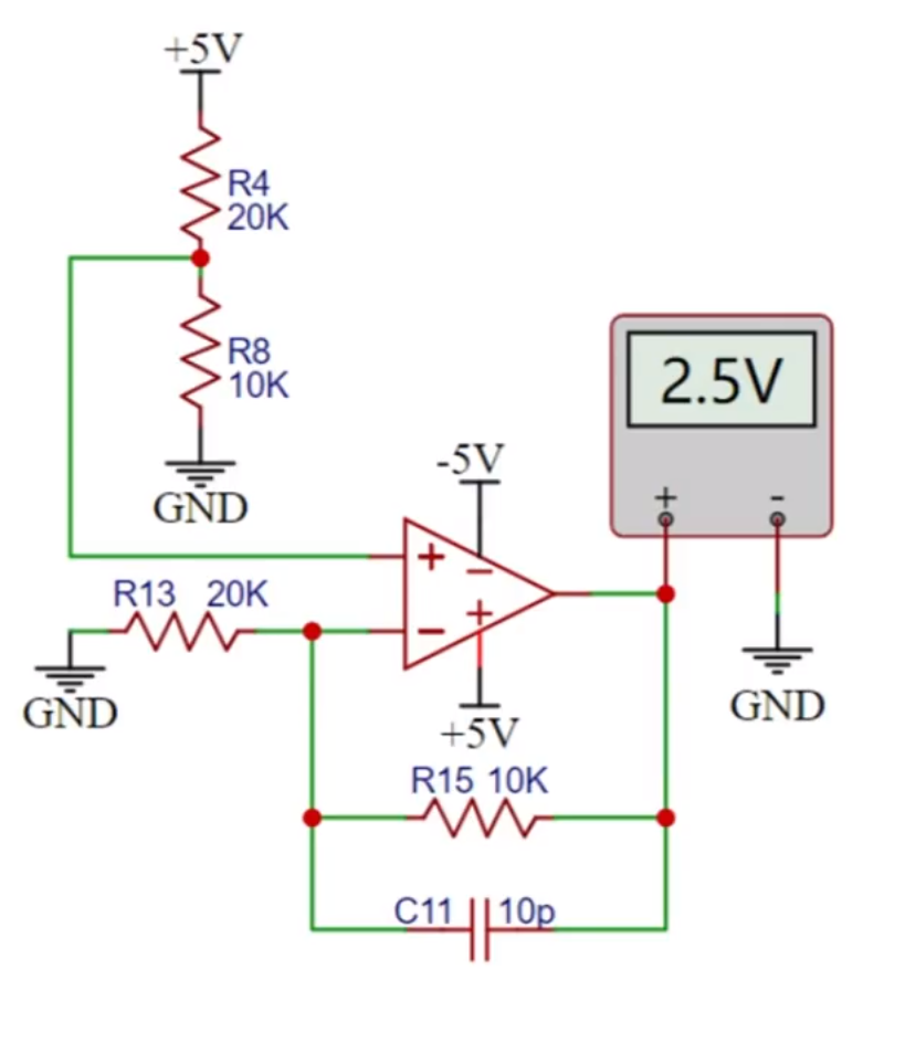

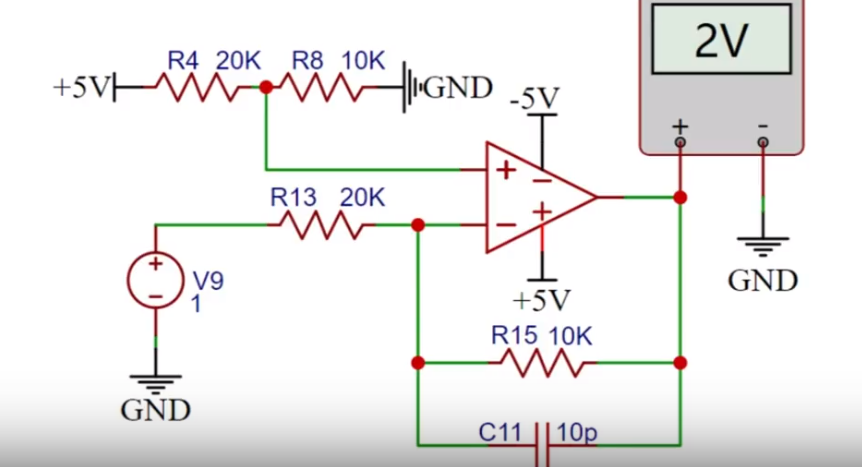

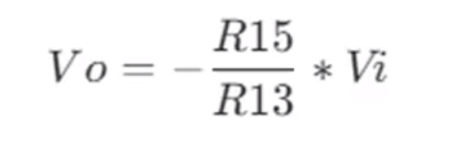

Substituting R15=10K, R13=20K, Vin=5/3V, V2=2.5V.
When both circuits work together, vout=V2+V1=2.5+0.5Vin. Simplifying, we get:

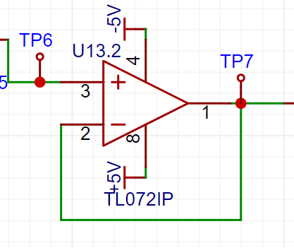

The Vo signal will be directly connected to the microcontroller's ADC pin. Since the microcontroller acquires the ADC voltage range of 0, 3, and 3V, the oscilloscope's input voltage range can be calculated.

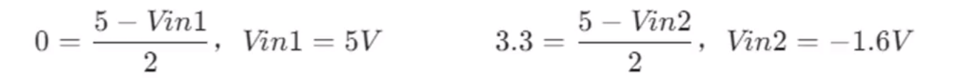

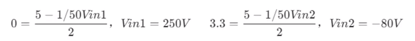

When the input signal Vin does not attenuate, substituting Vo=0 and vo=3.3V into the formula yields:
When the input signal Vin attenuates by 1/50, substituting Vo=0 and Vo=3.3V into the formula yields:
We obtain the following conclusion

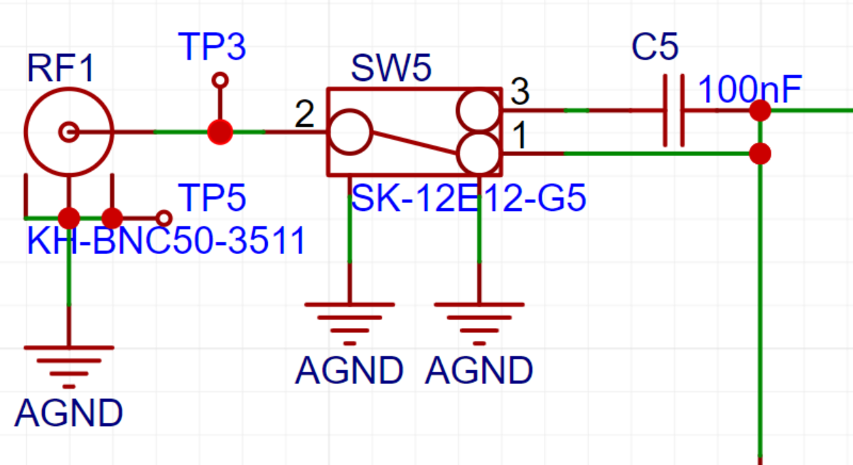

: When switches 5 and 3 are connected together, the measurable input signal amplitude is -1.6 to 5V
. When switches 2 and 1 of SW5 are connected together, the measurable input signal amplitude is 80V-250V.

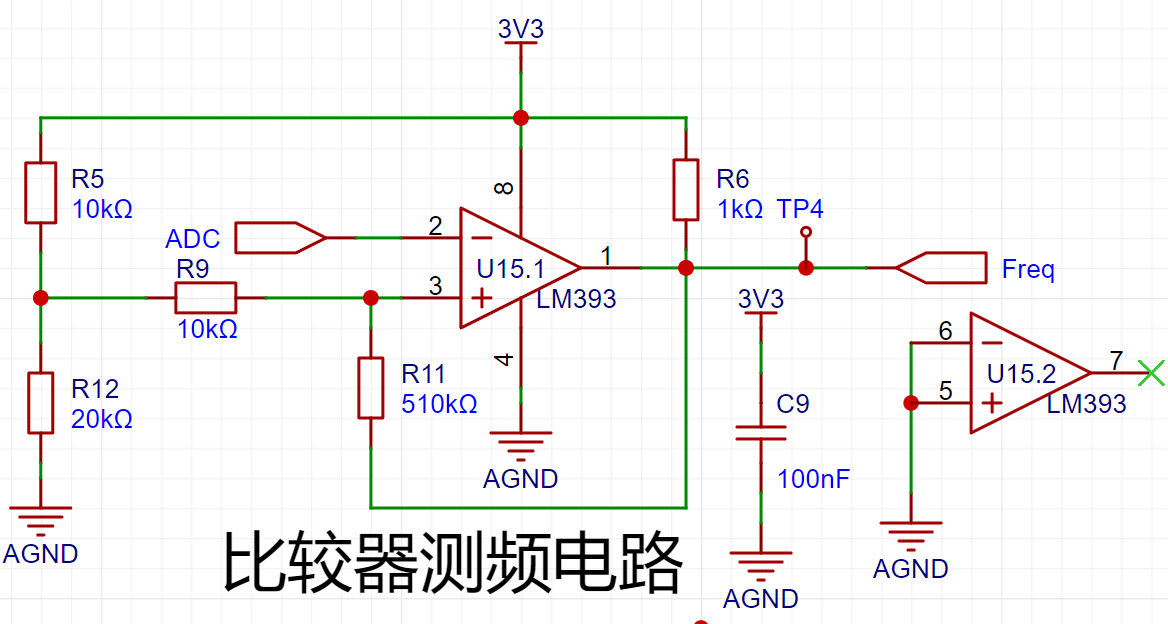

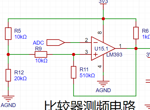

The comparator frequency measurement circuit,
to achieve frequency detection, compares the ADc input signal with a hysteresis comparator to realize the frequency measurement function. The hysteresis comparator is a type of voltage comparator. A conventional voltage comparator is a single-threshold comparator, with only one threshold voltage in the circuit. However, even a small change in the input voltage near the threshold will cause a significant change in the output voltage.
To enhance the circuit's anti-interference capability, positive feedback is introduced on the basis of the single-threshold comparator, ensuring signal stability within a certain range. After passing through the hysteresis comparator circuit, a square wave signal is output. The period of the input waveform is calculated using the microcontroller's timer capture function.

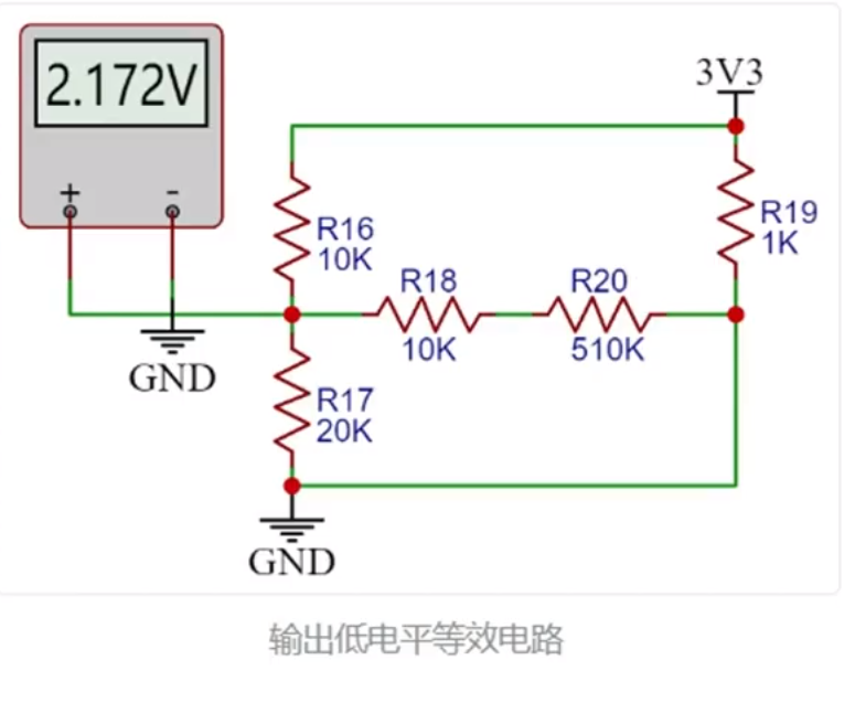

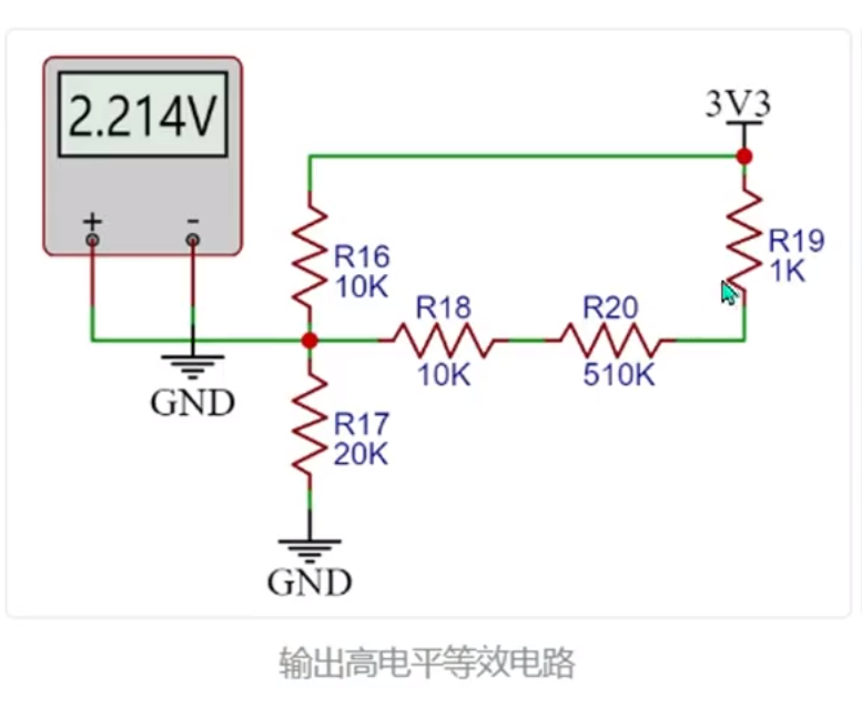

The threshold voltage of the hysteresis comparator circuit needs to be analyzed separately based on the op-amp output result. The original circuit is shown in the figure below:
When the output is high, the output terminal is pulled up to a high level. The equivalent circuit is shown in the middle figure below, and Uth = U+ = 2.214V is calculated.
When the op-amp output is low, the output terminal is grounded. The equivalent circuit is shown in the diagram on the right below, and we can calculate Utl = U- = 2.172V.

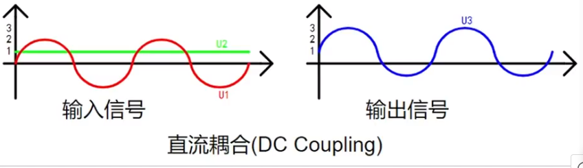

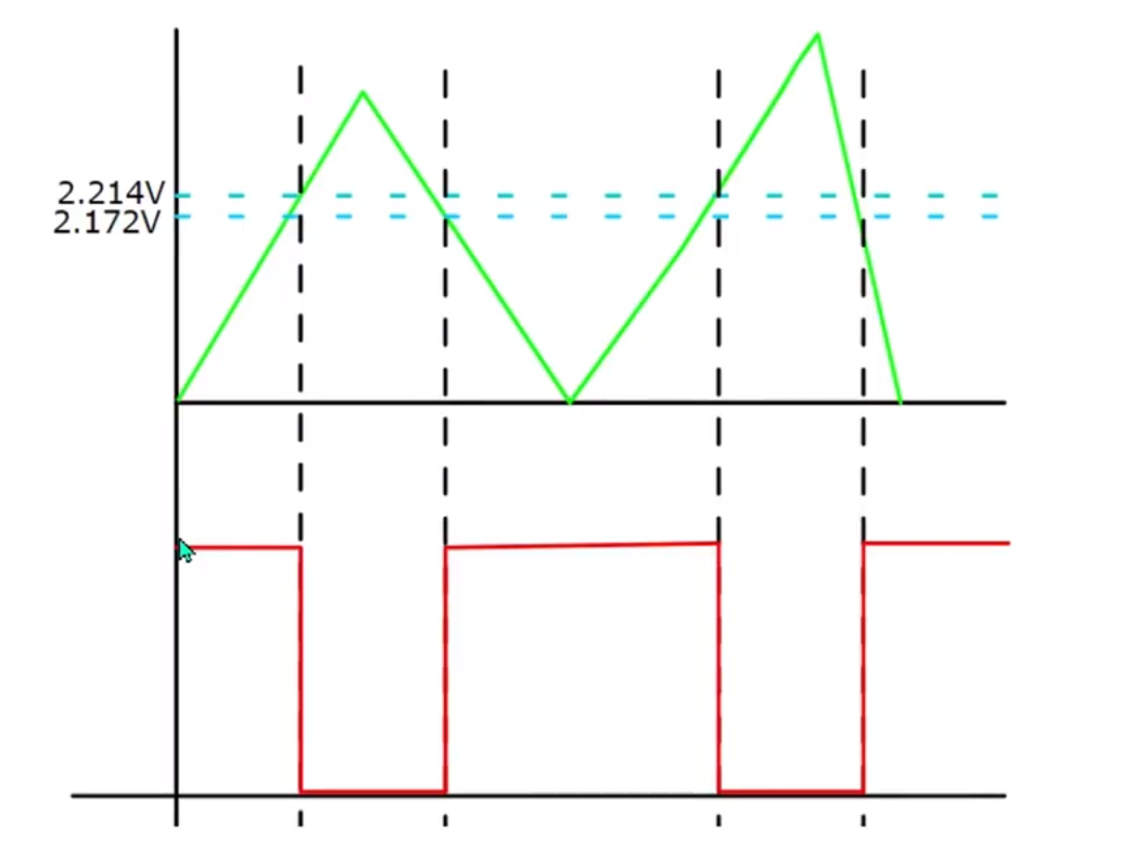

The green line in the diagram below represents the signal input voltage change. Starting from 0 potential, the initial output state is high. When the input voltage reaches 2,214V,
the output signal becomes low, until the input signal falls below the lower threshold of 2,172V, at which point the output becomes high again. The threshold for the next change level can be determined based on the current output
state . When the output is high, the high threshold Uth is used; when the output is low, the low threshold Tt is used.
The reason for setting the thresholds close together is to avoid misinterpretation caused by signal interference.
The green line in the diagram below represents the signal input voltage change. Starting from 0 potential, the initial output state is high. When the input voltage reaches 2,214V, the output signal becomes low, until the input signal falls below the lower threshold of 2.172V, at which point the output becomes high again. The threshold for the next level change can be determined based on the current output state of the comparator. A high threshold (Uth) is used when the output is high, and a low threshold (Ttl) is used when the output is low. The thresholds are set close to each other to avoid misidentification caused by signal interference.
Note:
The positive input signal of the threshold comparator op-amp is a fixed level. If using a microcontroller with a DAC output, the potential at this point can be freely configured to change the DC voltage and set the trigger mode.

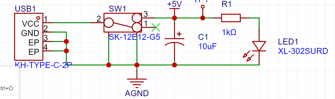

Power Circuit
USB Power Input:

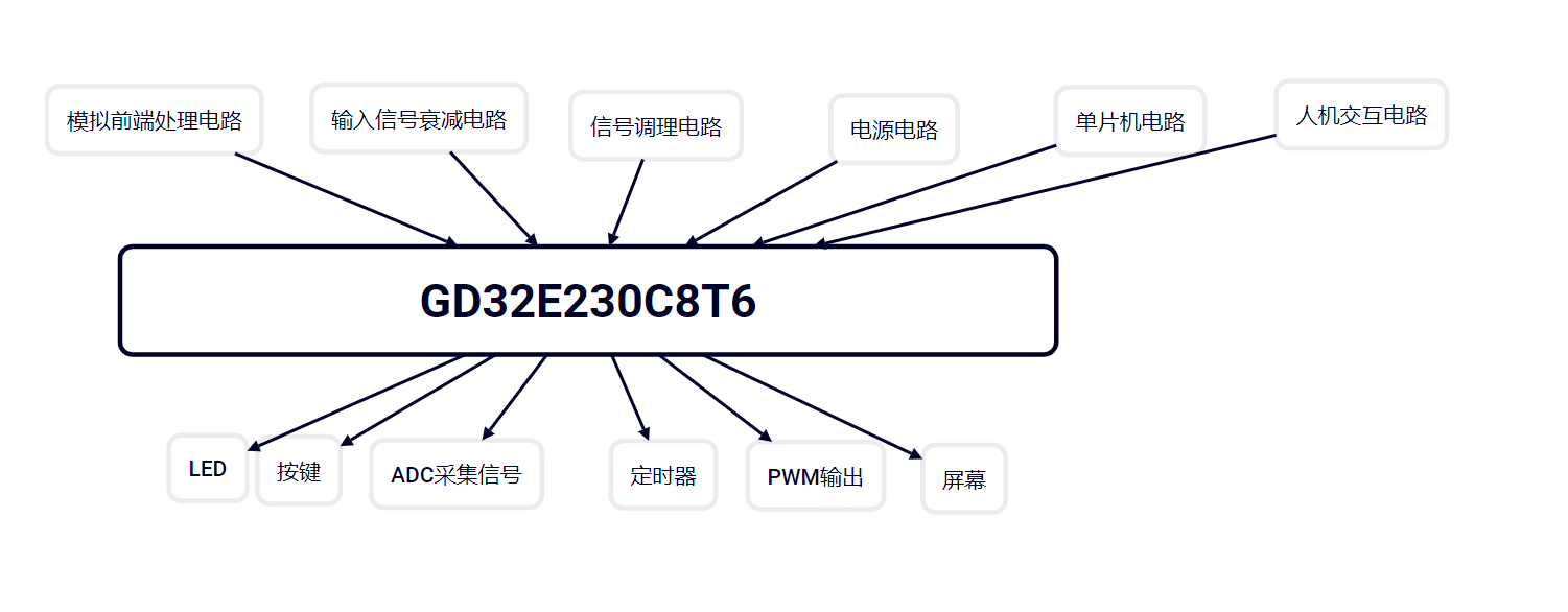

This project uses the GD32 minimum system board as its core, with an onboard 5V to 33V step-down circuit. Therefore, only a 5V power input circuit needs to be designed when designing the expansion board. The mainstream Type-C interface is chosen here. This interface has only two wires and is plug-in packaged, making it convenient for beginners to learn soldering. However, it should be noted that this Type-C interface is only for power supply and cannot transmit data. If data transmission is required, the Type-C interface on the core board can be used. SW1 is the main power switch, C1 is the input filter capacitor, and RI is the current-limiting resistor for LED1. In addition to the power input circuit,

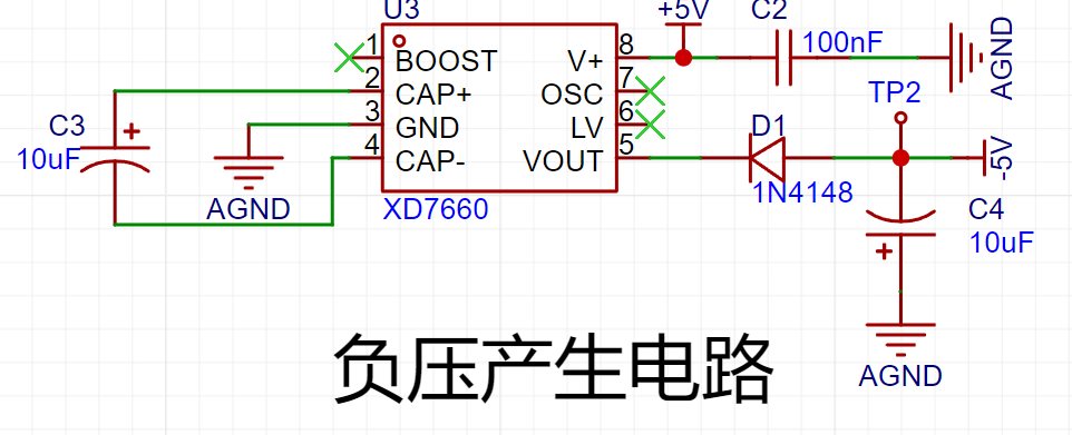

the negative voltage
generation circuit uses an XD7660 negative voltage generator to ensure the operational amplifier's performance in measuring negative voltages. This chip has a simple external circuit, requiring only two capacitors and a diode to operate. Theoretically, it can output a 5V voltage when the input voltage is +5V. However, due to the chip's internal voltage drop and conversion efficiency, the actual measured negative voltage is around 3V, which still meets the operational amplifier's requirements.

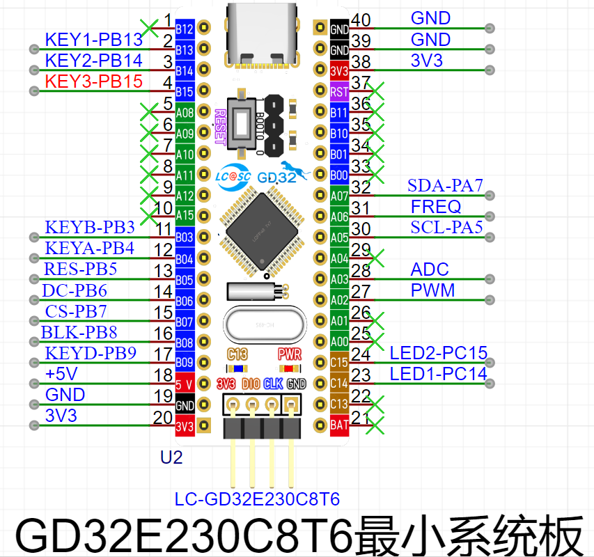

For the microcontroller circuit
, this project uses the GD32 minimum system board from the LCSC development board team as the main controller. This development board is a domestically produced board jointly developed by the LCSC team and GigaDevice. It features an onboard CH340 download chip, requiring only one data cable for programming and serial port debugging. It is also compatible with the size and pin configuration of the STM32 minimum system board and can be directly replaced.

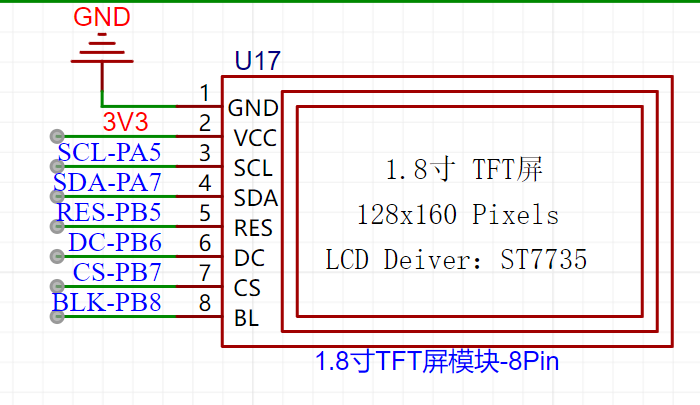

LCD display circuit

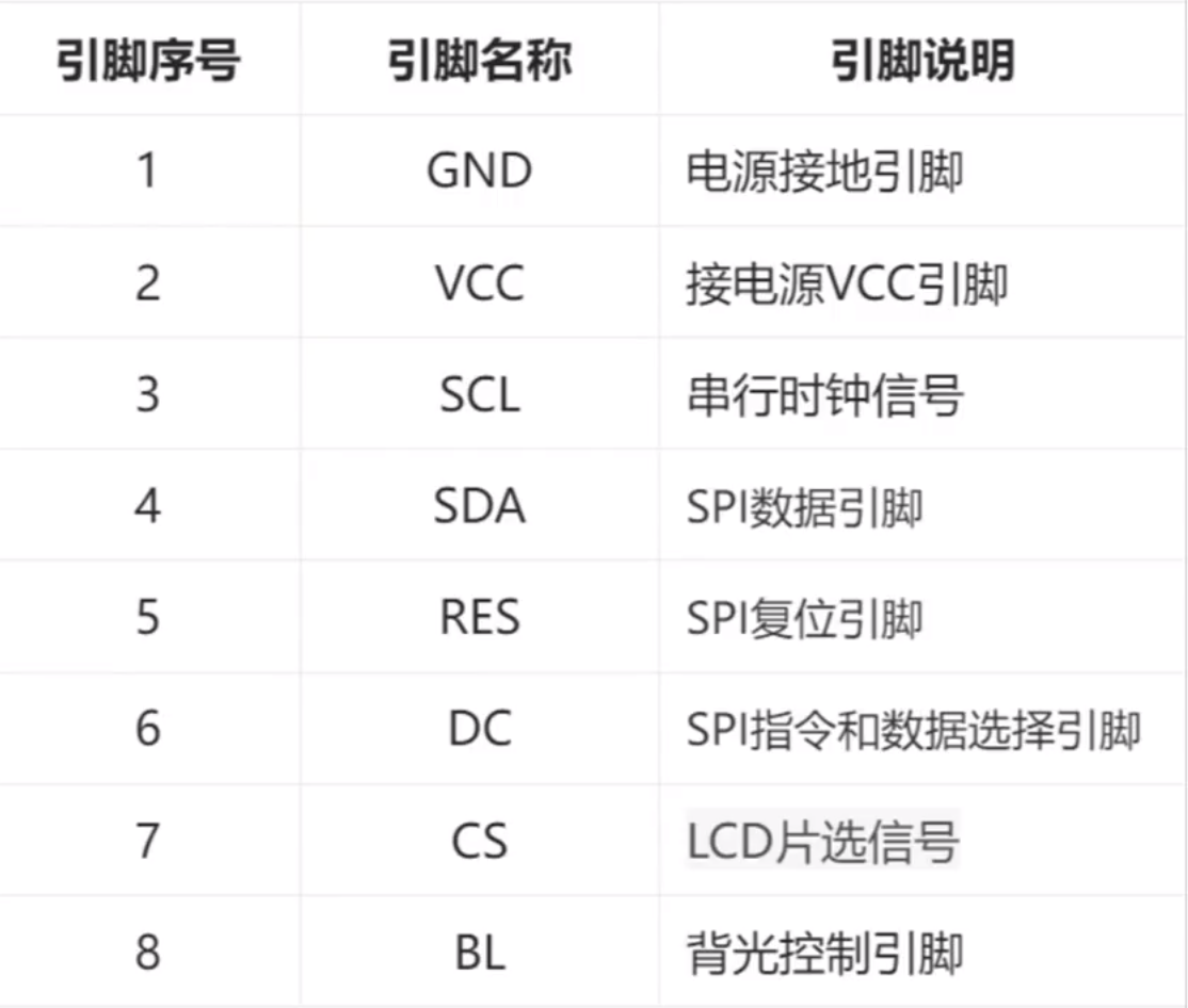

1.8TFT is a color display screen with 128×160 color pixels. It uses a four-wire SPI communication method to connect with the microcontroller. It has a total of eight pins. The module pin description and connection with the microcontroller are as follows:
Screen purchase link:
https://item.taobao.com/item.htm?_u=n34jmok8fa2c&id=709270273013&spm=a1z09.2.0.0.67002e8dxYMtHQ
High-definition SPI TFT color display screen 0.96-inch 1.3-inch 1.44-inch 1.8-inch OLED LCD screen st7735 - Taobao (taobao.com)

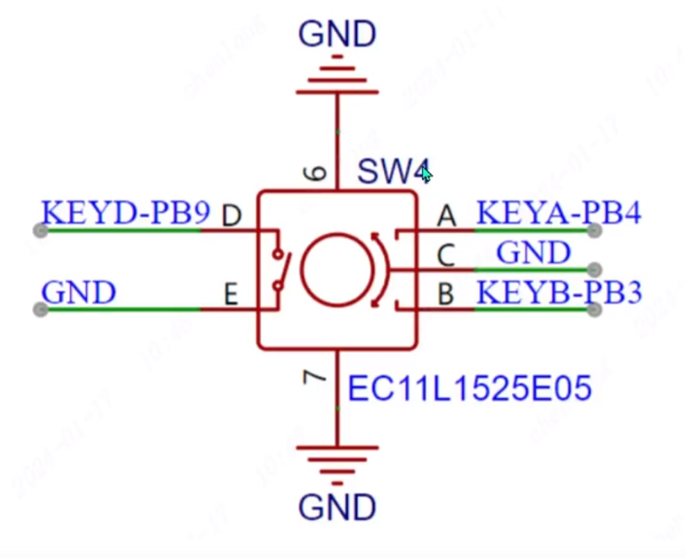

Rotary encoder circuit The rotary encoder
is a special kind of button. The ECII rotary encoder used in this project has five pins. Among them, the DE pins are similar to ordinary button pins. They are connected when pressed and disconnected when released. The remaining ABC pins are used to detect the rotation direction of the knob. The C pin is the common terminal and can be directly grounded.
In the rotary encoder, there is a phase difference between signal pins A and B. This means that a change in the signal on one pin precedes a change on the other, meaning the two pins do not change simultaneously. By detecting which pin changes first, the system can determine whether it's rotating in the forward or reverse direction.

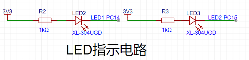

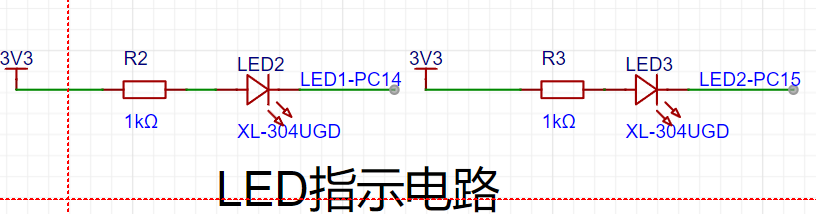

The LED indicator
circuit is relatively simple, using a low-level drive. When the microcontroller pin outputs a low level, a potential difference exists across the LED, and the LED lights up; when the microcontroller pin outputs a high level, the LED turns off. In addition to the rotary
encoder

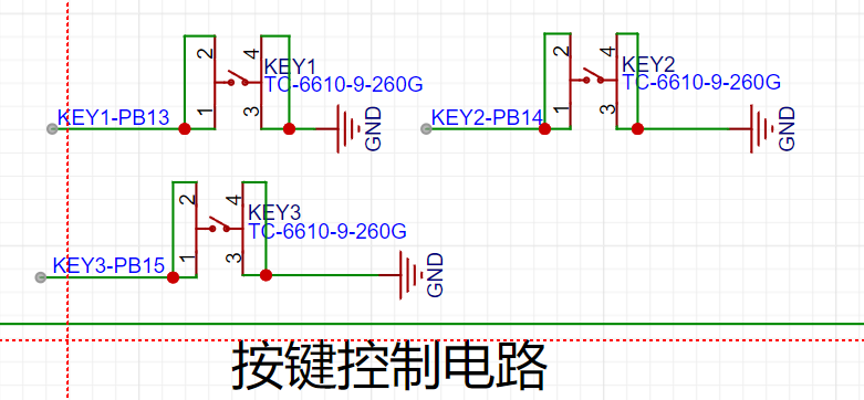

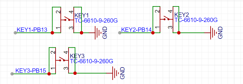

, the project uses three independent buttons to control the system. One side of each button is directly grounded, and the other side is connected to a microcontroller pin. When the microcontroller pin detects a button press, it connects directly to GND (Ground). The microcontroller receives this grounding signal and then executes the corresponding function. To save hardware costs, debouncing can be incorporated into the software design to prevent accidental triggering due to mechanical button vibration. In addition to the oscilloscope detection function,

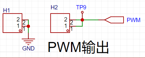

the waveform output interface
also features a dedicated PWM signal for simulating a simple function generator. This allows for the output of a simple square wave signal by changing the PWM frequency and duty cycle.

The key handling function
`Key_Handle` adjusts the `pwmOut` member of the `Oscilloscope_Value` structure based on the key press value.
A `switch` statement performs different operations based on the key press value.
`KEY1` and `KEY2` increment and decrement the value of `pwmOut` respectively, checking if it is out of range.
`KEY3` and `KEY4` appear to perform a delay operation, but they do not actually change the value of `pwmOut`. This could be an error or an incomplete part of the code. The
interrupt service routine
`EXTI4_15_IRQHandler` is an interrupt handler that is automatically called when any of the external interrupt lines 4 through 15 triggers an interrupt.
The function first checks which interrupt line triggered the interrupt using the `exti_interrupt_flag_get` function. This is done by checking the interrupt flags of `EXTI_9`, `EXTI_13`, `EXTI_14`, `EXTI_15`, and `EXTI_4`.
If an interrupt is detected, it clears the corresponding interrupt flag to avoid handling the same interrupt repeatedly.
Based on the pin that triggered the interrupt, the function sets `keyValue` to the corresponding button value (such as KEY1, KEY2, KEY3, KEY4, or EC11_KEY).
If `keyValue` is not 0, it means a button was indeed pressed, so the `keyValue` member of the `Oscilloscope_Value` structure is set to this button value, and the `Key_Handle` function is called to handle the button event.
The `Key_Handle`
function adjusts the `pwmOut` member of the `Oscilloscope_Value` structure according to the button value. This is typically used to control the duty cycle of the PWM (Pulse Width Modulation) signal.
For KEY1, it increases the value of `pwmOut`, but not exceeding `timerPeriod`. This is likely used to increase the duty cycle of the PWM signal, thereby increasing the strength or duration of the output signal.
For KEY2, it decreases the value of `pwmOut`, but not less than 0. This is used to decrease the duty cycle of the PWM signal.
The processing logic for KEY3 and KEY4 looks somewhat strange because they perform a delay operation but do not change the value of `pwmOut`. This could be a code error, or these buttons were originally intended for other functions that have not yet been implemented. The `Init_USART` function initializes the USART (Universal Synchronous Asynchronous Receiver/Transmitter)

Screens are ubiquitous in daily life as display devices. In embedded systems, display screens are mainly of two types: LCD and OLED. Depending on size and manufacturing materials, there are many subdivisions, such as LCD1602, 96-inch OLED, and 1.8-inch LCD screens. Screen Applications Screens in embedded systems are commonly used for: displaying device parameters; displaying environmental parameters; and human-computer interaction displays. LCD Screen Driving Methods Introduction: To reduce development complexity, LCD screen manufacturers typically integrate a driver chip into the screen and expose pins for communication with the outside world. Common driver chips include ST7735S, ILI9163, ST7789, etc. LCD screens also offer pinout options such as SPI serial communication (4-wire) and 8080 parallel communication (8-wire). The SPI bus consists of four logic lines, defined as follows: MISO: MasterInputSlaveOutput - Master input, slave output (data from slave); MOSI: MasterOutputSlaveInput - Master output, slave input (data from master); SCLK: SerialClock - Serial clock signal generated by the master and sent to the slave; NSS: SalveSelect - Chip select signal sent by the master to control which slave to communicate , usually a low-level active signal. Screen manufacturers usually provide driver examples based on their driver chips. When purchasing a screen, you can find the corresponding documentation from the screen manufacturer and modify it according to the board's pinout and timing. GD32-SPI Communication Introduction: SPI: Short for Serial Peripheral Interface. The method we introduced earlier is serial communication, but it's asynchronous. SPI, however, has a clock line and is a high-speed, full-duplex synchronous serial communication bus. The GD32E230 supports both SPI0 and SPI1 communication interfaces. When using it, the corresponding peripheral's SPI pin needs to be connected to the GD32-SPI pin to use hardware SPI. Otherwise, you can only simulate SPI communication timing by changing the pin's high and low levels. SPI Communication Introduction: 1. SPI Data Exchange Process : SPI is a ring bus structure consisting of four lines. SSPSR is the internal shift register of the SPI device. Data is shifted into or out of SSPBUF according to the SPI clock signal state. Note the ring designation: when MOSI sends a bit of data to the slave, the slave's MOSO also shifts data back to the master. However, the master can choose whether to place this data in the receive buffer as needed. For example, if the master sends 0x80, the slave might shift back a bit of meaningless data, which the master will discard. If the master needs to receive data, it sends meaningless data to the slave to exchange for valid data stored in the receive buffer. 2. SPI Bus Polarity and Phase: Polarity directly affects whether the SPI bus clock signal is high or low when idle. Phase directly determines from which edge the SPI bus starts sampling data. CPOL configures the SPI bus polarity, and CPHA configures the SPI bus phase. CPOL=1: indicates high level when idle; CPOL=0: indicates low level when idle. Since data transmission starts from a transition edge, if the idle state is high, then data transmission occurs on a falling edge; conversely, it occurs on a rising edge. As can be seen from the schematic, this screen uses the ST7735 driver chip, with a four-wire SPI communication pin interface. SCL(PA5) --> SCLK, SDA(PA7) --> MOS1; CS(PB7) --> NSS, DC(PB6) --> Chip command/data control pin, RES(PB5) --> Chip reset pin, BLK(PB8) --> Backlight control pin. MISO is not included here because the internal chip does not need to send data to the external host, so the MISO data line is not brought out. A 1.8-inch screen is 128160 pixels in size, meaning it has 128160 = 20480 pixels. If the entire screen is refreshed once, 20480*2 bytes need to be defined because color display is uint16_t; the microcontroller only has 8K RAM, which is clearly impractical. Here are two approaches (displaying a waveform is essentially displaying a line). First, establish a Cartesian coordinate system with time as the x-axis and voltage as the y-axis. Convert the voltage value into a point on this coordinate system, draw a point, and connect it to the previous point to form a line. Then, move the time axis one position forward, draw another point, and connect the lines, repeating this process. This forms the final waveform. To prevent interference from the first waveform display, clear the next line of the screen after drawing the points and connecting the lines to ensure smooth waveform display. Second, similar to a small window display on a mobile phone, reduce the overall waveform display area. Define a large array, also in a Cartesian coordinate system, convert the voltage and time data, fill the corresponding points with the waveform color, and fill the unused points with the background color. The final display effect is also a waveform. `tft_init.c` initializes the SPI0 pins: This code mainly configures the clocks for GPIOA and GPIOB, sets the multiplexing function, sets the output mode and speed, and initializes SPI0. The Init_SPI0_GPIO() function is used to initialize the 8-bit data width of SPI0, and the Init_SPI0_GPIO16() function is used to initialize the 16-bit data width of SPI0.
SPI0 Data Transmission: This code section mainly defines two functions for transmitting data: SPI0_Write() and SPI0_Write16(). Both functions check if the SPI transmit buffer is empty before transmitting data. SPI0_Write() transmits 8-bit data, and SPI0_Write16() transmits 16-bit data.
TFT Screen Pin Initialization: This code section mainly configures the GPIOB clock, sets the output mode and speed, and initializes the TFT screen's GPIO. The TFT_GPIO_Init() function initializes the TFT screen's GPIO.
TFT Screen Data Transmission: This code section mainly defines four functions for transmitting data: TFT_WR_DATA8(), TFT_WR_DATA(), TFT_WR_DATA16(), and TFT_WR_REG(). All four functions pull the chip select signal low, transmit data, and then pull the chip select signal high again. The `TFT_WR_DATA8()` function sends a single byte of data, `TFT_WR_DATA()` sends two bytes of data, `TFT_WR_DATA16()` sends 16 bits of data, and `TFT_WR_REG()` sends command data.
Setting the display address: This part of the code mainly defines two functions for setting the display address: `TFT_Address_Set()` and `TFT_Address_Set16()`. Both functions set the display address by sending the column address and row address. `TFT_Address_Set()` sends 8 bits of data, and `TFT_Address_Set16()` sends 16 bits of data.
Initializing the TFT screen: First, it calls `TFT_GPIO_Init()` and `Init_SPI0_GPIO()` to initialize the GPIO and SPI interfaces of the TFT screen. Next, it resets the TFT screen by setting bit 5 of GPIOB to low, then delays for 100 milliseconds. Afterward, it turns on the TFT screen backlight by setting bit 8 of GPIOB to high, then delays for another 100 milliseconds. Next, it sets the parameters of the TFT screen by sending a series of commands and data, including setting the frame rate, power sequence, VCOM voltage, RGB mode, gamma sequence, etc. Finally, it turns on the TFT screen display by sending the 0x29 command. After completing these operations, it calls the Init_SPI0_GPIO16() function to initialize the 16-bit data width of SPI0.
TFT_Fill(uint16_t xsta, uint16_t ysta, uint16_t xend, uint16_t yend, uint16_t color): This function is used to fill a specified area with color. It receives the start coordinates (xsta, ysta) and end coordinates (xend, yend), as well as the color to be filled, as parameters. Internally, the function sets the display range, then uses a loop to traverse each point within the area, and calls the TFT_WR_DATA16 function to write the color value to the corresponding point.
`TFT_DrawPoint(uint16_t x, uint16_t y, uint16_t color)`: This function draws a point at specified coordinates. It takes the point's coordinates (x, y) and the fill color `color` as parameters. Internally, the function sets the display range and then calls the `TFT_WR_DATA16` function to write the color value to the specified point.
`TFT_DrawLine(uint16_t x1, uint16_t y1, uint16_t x2, uint16_t y2, uint16_t color)`: This function draws a line. It takes the starting coordinates (x1, y1) and ending coordinates (x2, y2), and the fill color `color` as parameters. Internally, the function calculates the coordinate increments, then iterates through each point on the line using a loop and calls the `TFT_DrawPoint` function to draw the point.
`TFT_DrawRectangle(uint16_t x1, uint16_t y1, uint16_t x2, uint16_t y2, uint16_t color)`: This function draws a rectangle. It takes the starting coordinates (x1, y1) and ending coordinates (x2, y2), and the fill color `color` as parameters. Internally, the function calls the `TFT_DrawLine` function to draw the four sides of the rectangle.
`Draw_Circle(uint16_t x0, uint16_t y0, uint8_t r, uint16_t color)`: This function draws a circle. It takes the center coordinates (x0, y0), radius `r`, and the fill color `color` as parameters. Internally, the function calculates the coordinates of each point on the circle and calls the `TFT_DrawPoint` function to draw the point.
`drawCurve(uint8_t yOffset, short int rawValue)`: This function draws a polyline. It accepts the Y-axis parameter value yOffset and the raw value rawValue as parameters. Internally, the function processes the raw value within its range, calculates the Y-axis coordinates of the polyline, and calls the TFT_DrawPoint function to draw the point.
TFT_ShowChar(uint16_t x, uint16_t y, uint8_t num, uint16_t fc, uint16_t bc, uint8_t sizey, uint8_t mode): This function is used to display a character. It accepts the starting coordinates (x, y), the character to be displayed num, the character color fc, the background color bc, the font size sizey, and the mode mode as parameters. Internally, the function selects the corresponding font data based on the font size, and then calls the TFT_DrawPoint or TFT_DrawLine function to draw the character based on the character's dot matrix information.
`TFT_ShowString(uint16_t x, uint16_t y, const uint8_t *p, uint16_t fc, uint16_t bc, uint8_t sizey, uint8_t mode)`: This function displays a string. It takes the starting coordinates (x, y), the pointer to the string to be displayed (p), the character color (fc), the background color (bc), the character size (sizey), and the mode (mode) as parameters. Internally, the function iterates through each character in the string and calls the `TFT_ShowChar` function to display the character.
`TFT_ShowChinese(uint16_t x, uint16_t y, uint8_t *s, uint16_t fc, uint16_t bc, uint8_t sizey, uint8_t mode)`: This function displays a Chinese character string. It takes the starting coordinates (x, y), the pointer s of the Chinese character string to be displayed, the character color fc, the background color bc, the font size sizey, and the mode as parameters. Inside the function, it iterates through each Chinese character in the string and calls the corresponding Chinese character display function (such as TFT_ShowChinese12x12, TFT_ShowChinese16x16, TFT_ShowChinese24x24) to display the Chinese character.
The `TFT_ShowChinese` function takes the following input parameters: x and y coordinates, the Chinese character to be displayed, the character's color, background color, font size, and mode (non-overlay or overlay). Internally, the function displays the corresponding Chinese character by searching a dot-matrix font library. First, it defines variables such as `i`, `j`, `m`, and `k` for looping and counting. Then, it calculates the size of a character in bytes, `TypefaceNum`, based on the font size. Next, it counts the number of Chinese characters, `HZnum`. Then, it uses a `for` loop to iterate through the dot-matrix font library, searching for a matching font. If a match is found, the function sets the display area by calling the `TFT_Address_Set16` function. Then, it uses nested `for` loops to iterate through the dot-matrix information of each character, selecting either non-overlay or overlay mode for display. In non-overlay mode, the function draws each pixel based on the dot-matrix information; in overlay mode, it draws new pixels on top of existing pixels. `
TFT_ShowUI`. The function takes a pointer to an `Oscilloscope` structure as an argument, which contains information such as peak-to-peak value, frequency, and DC bias signal. First, it defines a character array `showData` to store the data to be displayed. Then, it uses the `sprintf` function to format the peak-to-peak value information into a string and calls the `TFT_ShowString` function to display it on the screen. Next, it selects whether to display in kilohertz or hertz based on whether the frequency is greater than or equal to 1000 Hz, and calls the `TFT_ShowString` function to display the corresponding data. Next, it selects whether to display "on" or "off" based on the output status (`outputbit`) value and calls the `TFT_ShowChinese` function to display it. Similarly, it selects the display unit based on whether the output frequency is greater than or equal to 1000 Hz and calls the `TFT_ShowString` function to display the corresponding data. Finally, it calculates the duty cycle, formats the result into a string, and calls the `TFT_ShowString` function to display it. The entire function displays relevant information on the screen based on the input oscilloscope parameters, including peak-to-peak value, frequency, DC bias signal, output status, output frequency, and duty cycle.
