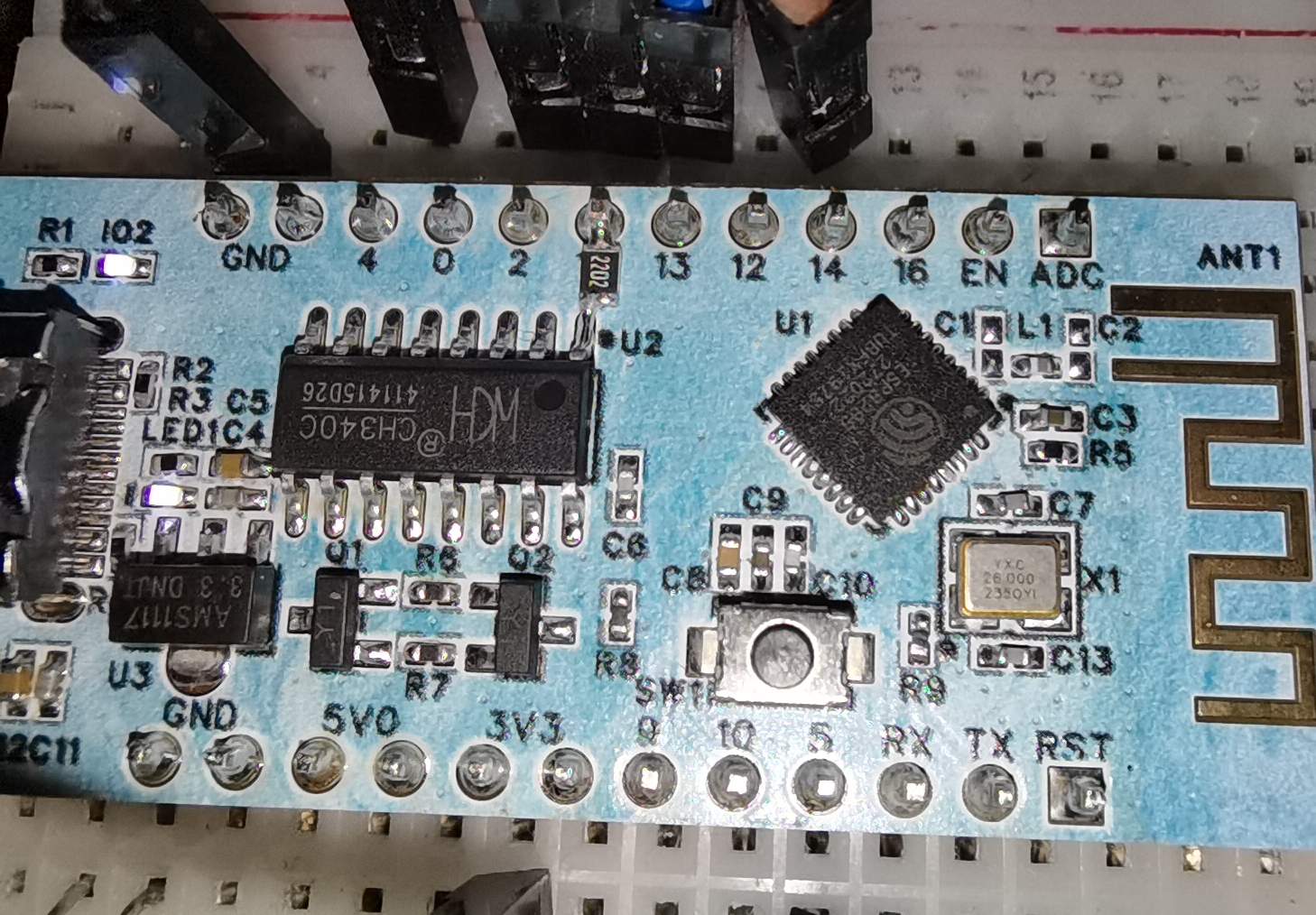

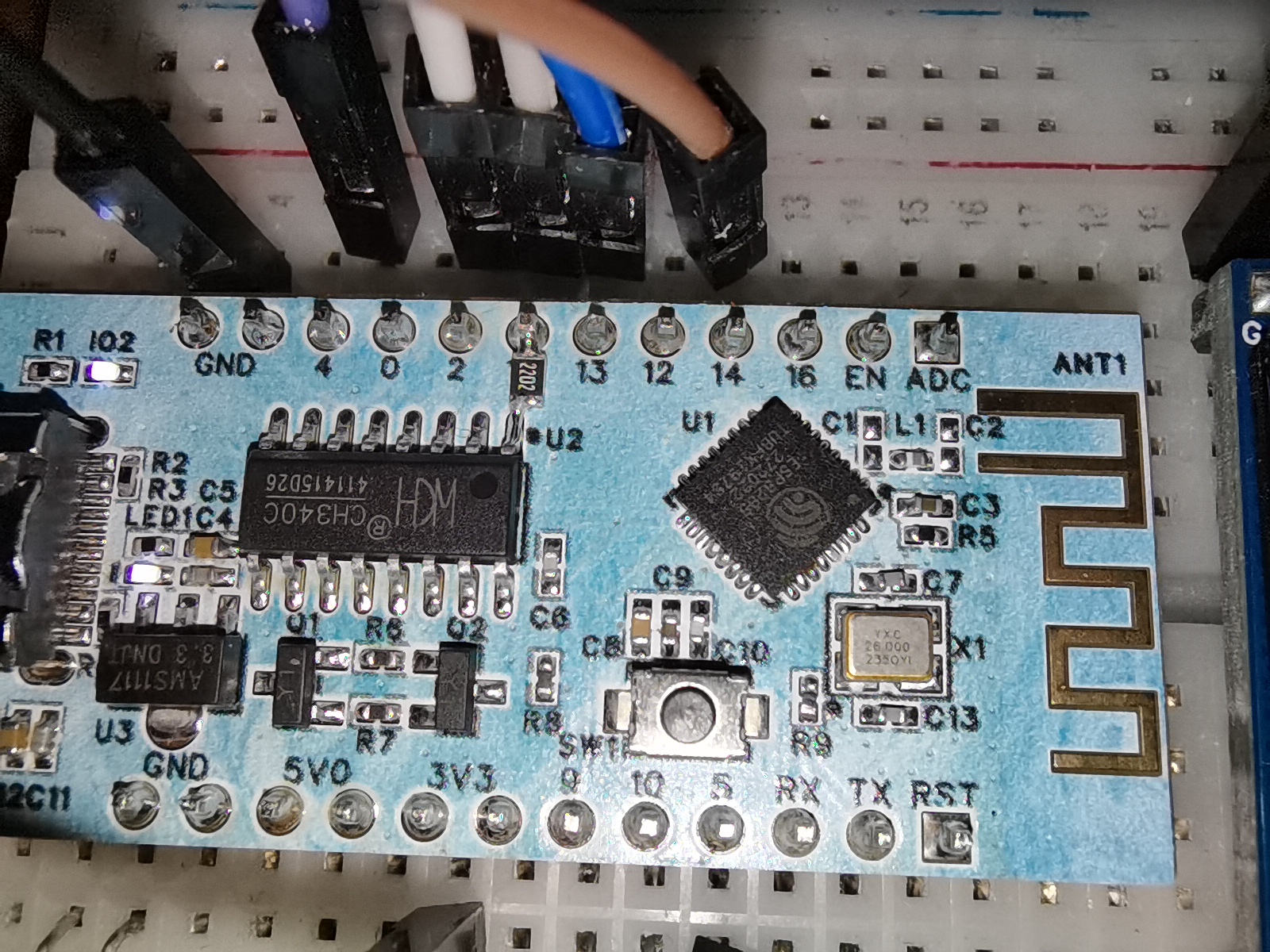

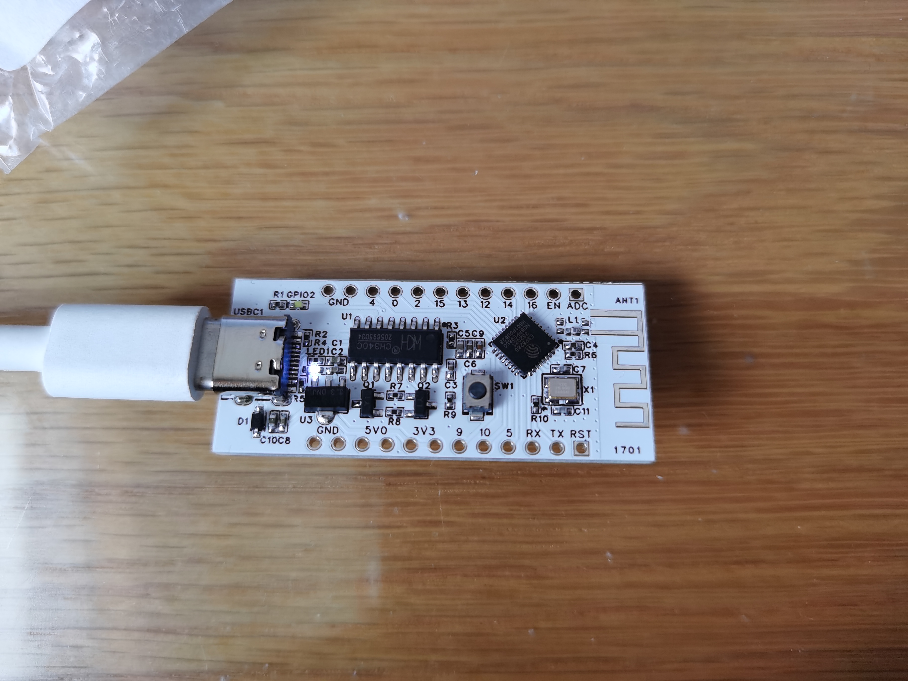

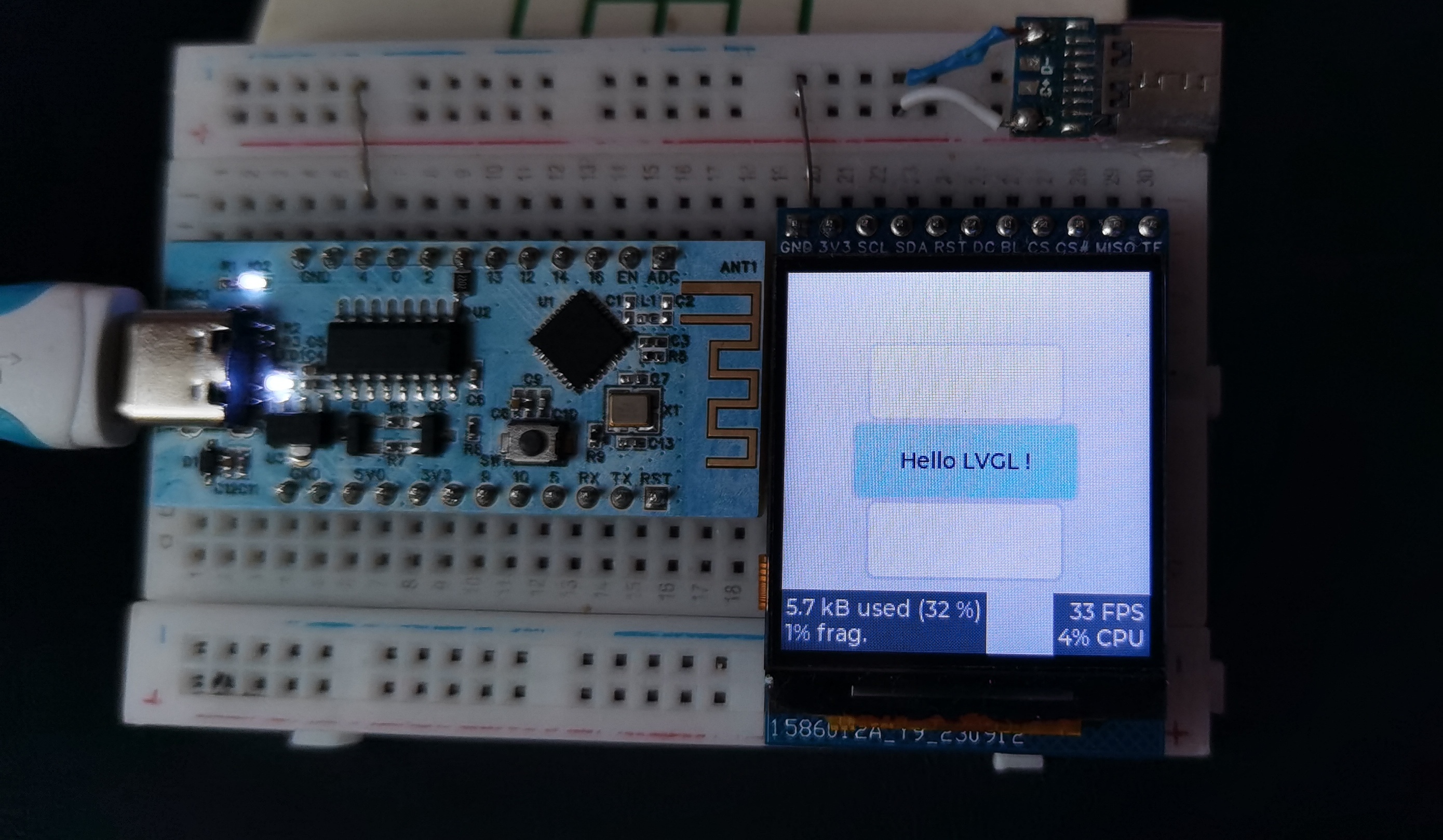

ESP8285 development board
The development board I made before has been sold, so I'll design a new one.
This time, I won't use a pre-built module to keep costs down.
The PCB antenna keeps reporting an error in the spacing within the package; could you optimize that?
Verification successful!
Due to some mysterious reason, the silkscreen markings on the board and the chip are reversed.
I forgot to draw the pull-down resistor for the GPIO15, but I've added it.
The capacitor for the antenna matching network seems to cause no signal after installation. I haven't learned RF yet, so I'll just use this as is for now.
