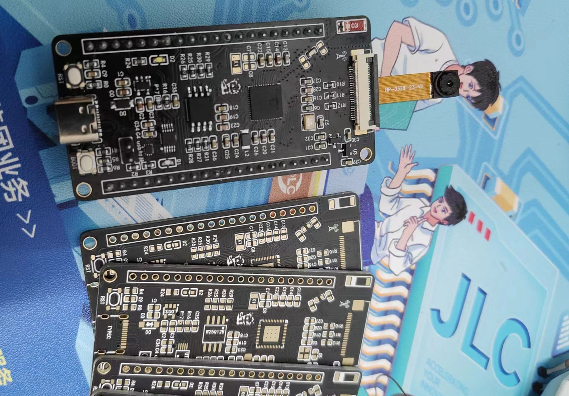

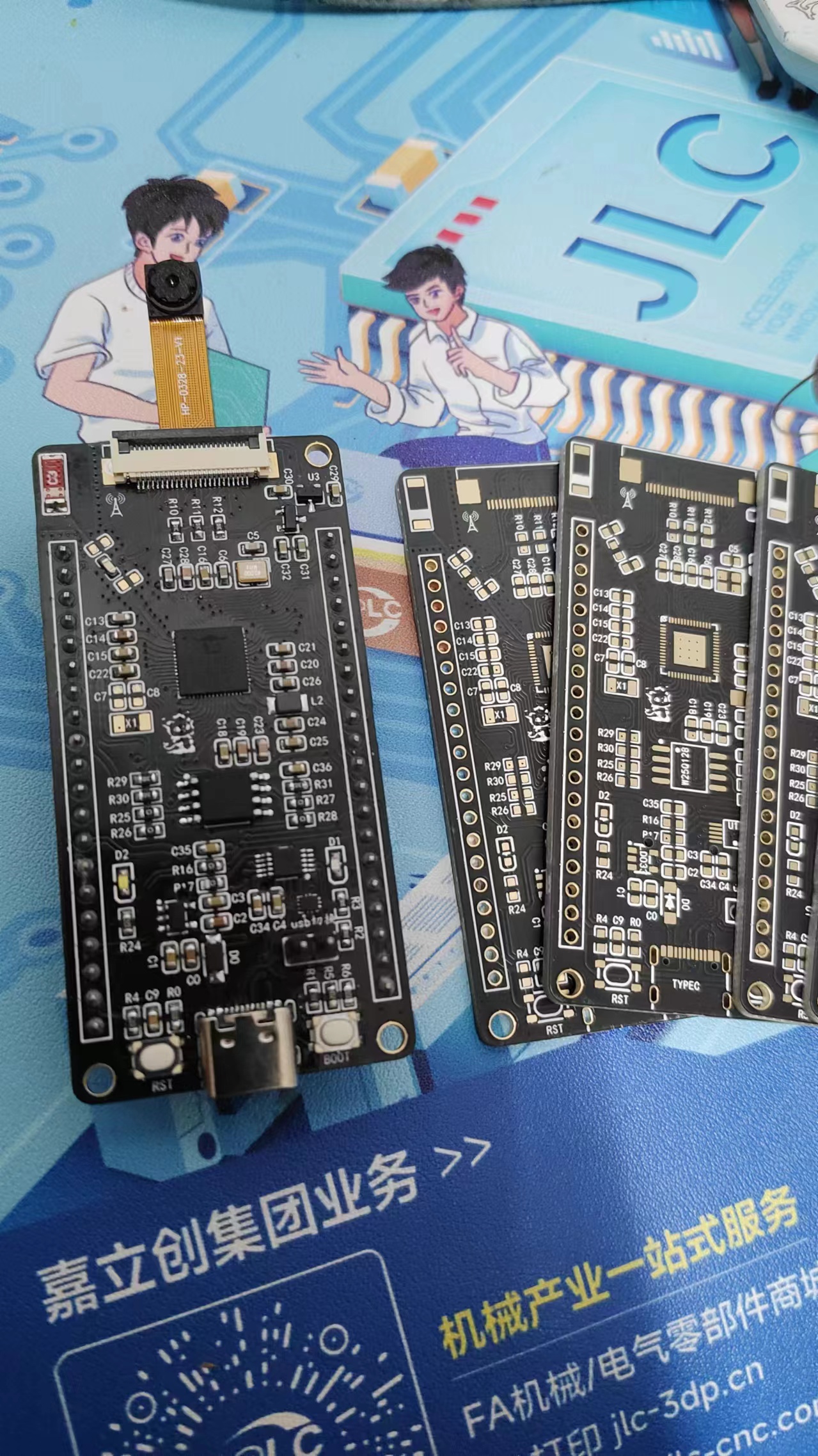

Front view, referencing designs from similar boards, uses a USB switching chip. You can select whether the TP-Link EMC port connects to a serial port or a USB port by plugging and unplugging jumpers. Because the camera mount takes up space, I chose a surface-mount antenna.

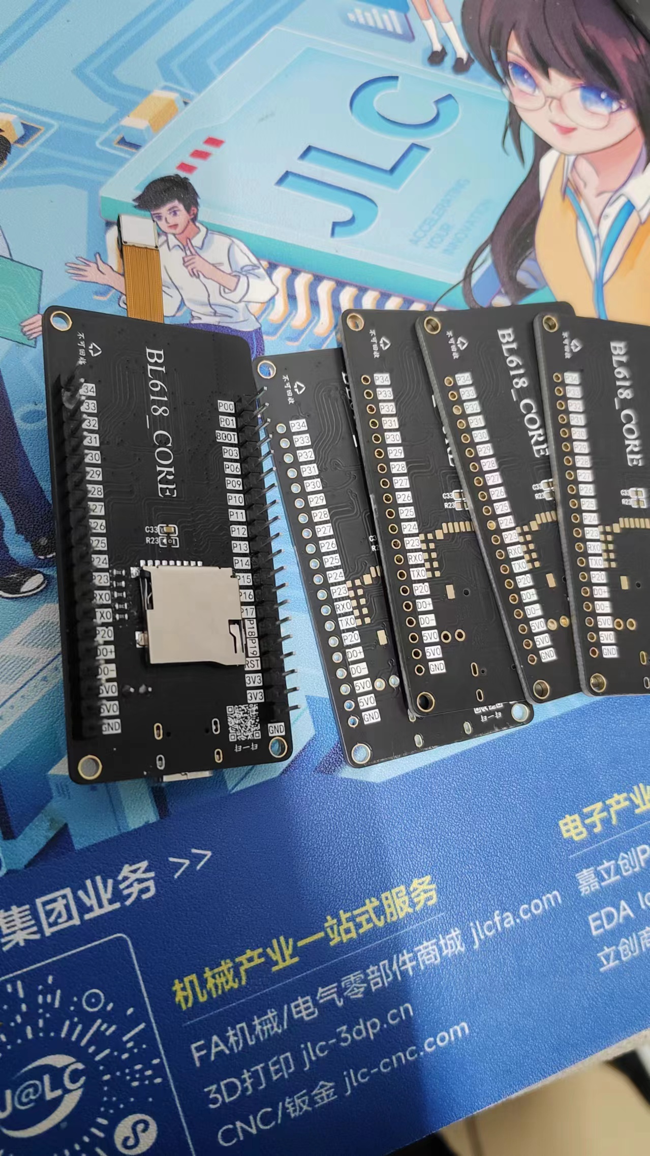

Back view, I tucked in a TF card slot. It looks a bit awkward, but it fits. That's about it. If you encounter any problems, you can post your questions on the Anxinke forum.
