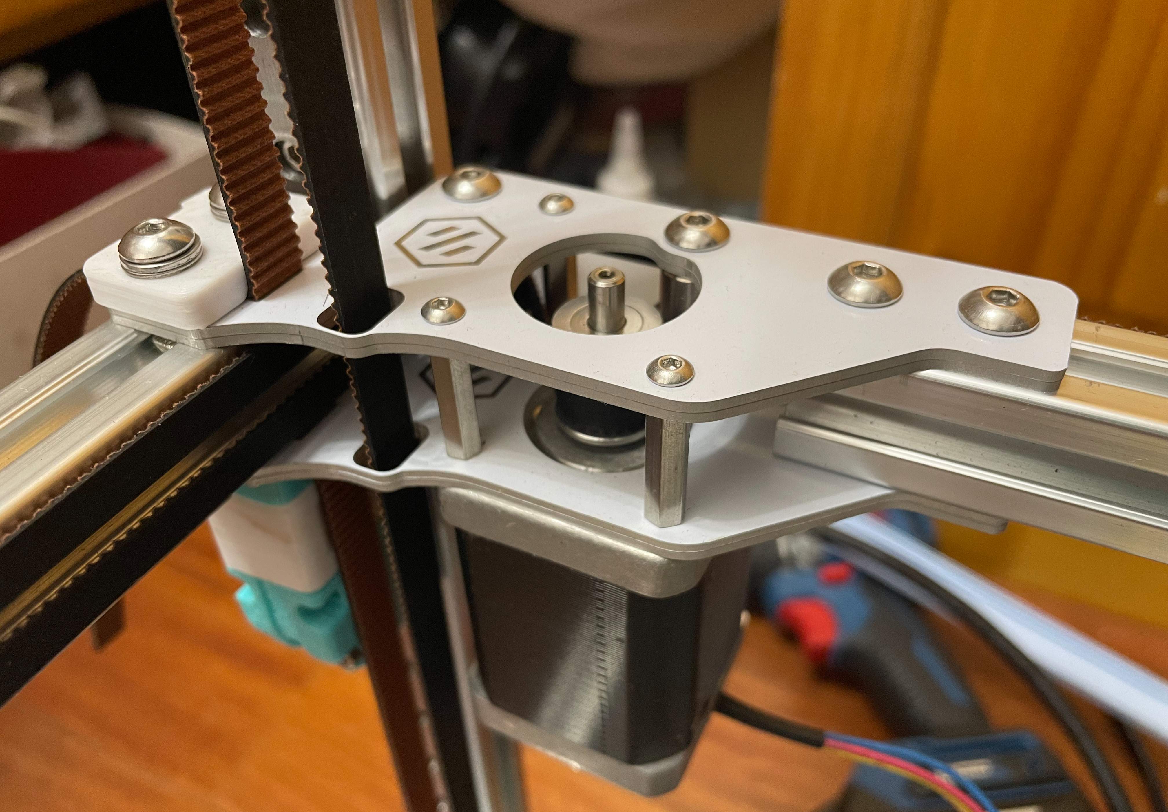

Voron2.4 motor mount
Remember to like and save if you're using this for free!! Don't be a freeloader!!
There's nothing LCSC can't do !
Unbeatable free AB reinforced motor mount, cost-effective thin mesh for certain CNC structural parts with extremely high tax content
(actually, it was designed to solve the problem of PETG structural parts being damaged by the motor).
Test machine configuration: 350 size 2.4, cost <2k, motor 12 yuan (disassembled Mingzhi 4260), driver 11 yuan (TMC2226), current 1.3A, no weight reduction.

V1 has been installed and tested, 2W acceleration, 300 speed printing, 500 speed idle running stably without step loss.
V2 has been installed and tested, performance is the same as V1.
To V1 version users: Updating to V2 is not necessary unless you need to fix the Z-chain, install the wire cover, or use the braid mod .
If you need to update, you only need to replace the A motor mount (right) (for perfectionists, it is recommended to replace everything).
I am very sorry for wasting your two prototyping opportunities, but I really don't know how to draw assembly diagrams.
V2 version does not need to be updated to V2.1. The new version is just to facilitate production.

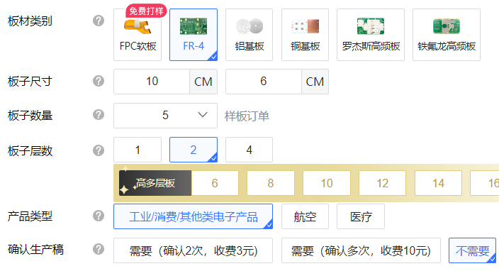

PCB manufacturing instructions:
Please export the Gerber file yourself, otherwise it may be considered a split order and you will not be able to get it for free.
Process: Open the editor in the upper right corner - Export (F10) - PCB manufacturing file (Gerber) - Export Gerber - No, continue exporting
in two orders: A-side_rotated_V2.1 and B-side_rotated_V2.1 (after rotation, the size is within 10x10, you can get it for free).
Select thickness 1.6, FR4 and aluminum substrate are both acceptable (FR4 recommended).
For FR4, please manually change the board layer count to double layer, default is not allowed. For single-sided boards, only green solder mask
boards with added markings are available. Please select according to this image
and then select the production draft if you are unsure.
Five boards are required at a time, with the top and bottom boards identical. Two boards can be stacked; no bonding is needed.
If you feel the strength is insufficient, you can stack more, but you need to calculate the screw length yourself (in actual testing, two boards are already quite sturdy).

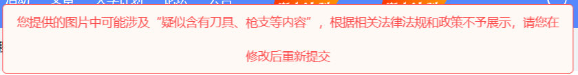

I uploaded a picture of the motor mount, and it was recognized as this?? This is a verification written by JEP??
(Fortunately, the four images weren't misidentified after being pieced together.)
