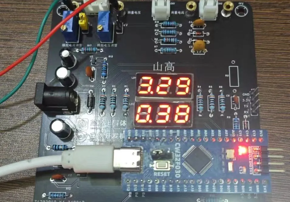

This project is a voltage and current meter based on the CW32 microcontroller. It 's part of the first phase of the Jiali Innovation training camp.
The design uses the CW32F030C8T6 development board and features three independent buttons: K1 to switch display modes, K2 to set parameter values ​​for the corresponding mode, and K3 to return to mode 0.
The project
defines five working modes. K1 switches between display modes, K2 sets the parameter values ​​for the corresponding mode and saves them to FLASH, and K3 returns to mode 0.
Mode 0: Displays normal voltage and current values ​​(the upper digital tube displays the voltage value in .V or .V automatically, the lower tube displays the current value in _.**A).
Mode 1: 5V voltage calibration setting. The upper digital tube displays 5.05. The lower tube displays the current voltage value in _.V or ._V. In this mode, the multimeter should be set to 5.00V. Pressing K2 calibrates the current value to 5V.
Mode 2: 15V Voltage Calibration Setting. The top row of the digital display shows 5.15. The bottom row shows the current voltage value in _V or ._V. In this mode, the multimeter should be set to 15.0V when measuring the measured bit. Pressing the K2 key will calibrate the current value to 15V.
Mode 3: 0.5A Current Calibration Setting. The top row of the digital display shows A.0.5. The bottom row shows the current current value in _.**A. Pressing the K2 key will calibrate the current value to 0.5A.
Mode 4: 1.5A Current Calibration Setting. The top row of the digital display shows A.1.5. The bottom row shows the current current value in *.**A. Pressing the K2 key will calibrate the current value to 1.5A.

Do not solder R0 before the end of the experiment.
