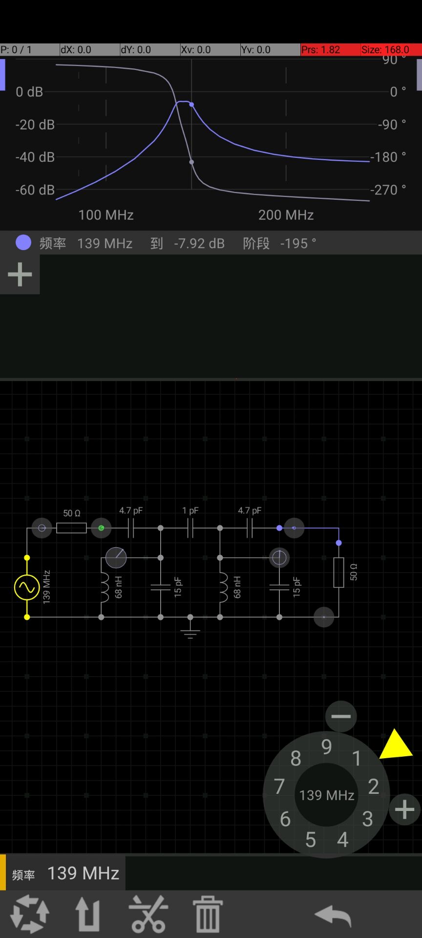

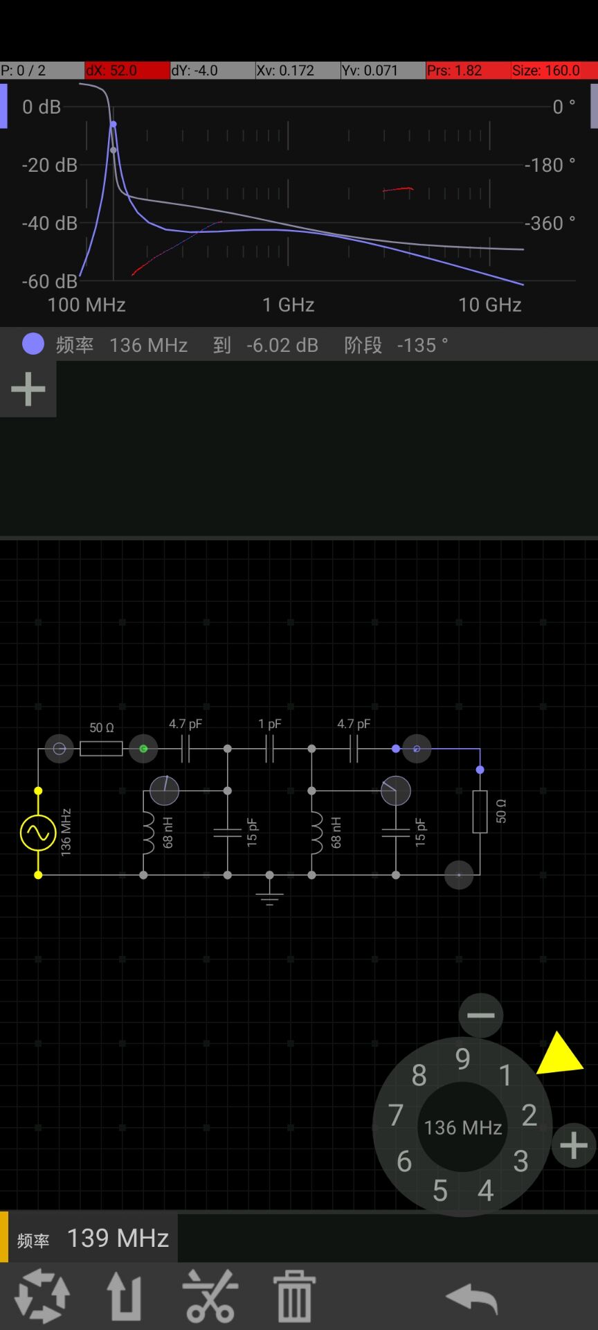

★ Simulation of the filter using simulation software:
Simulation results are:
loss = 0.2dB, center = 134.8MHz, bandwidth = 10MHz,
meeting expectations.

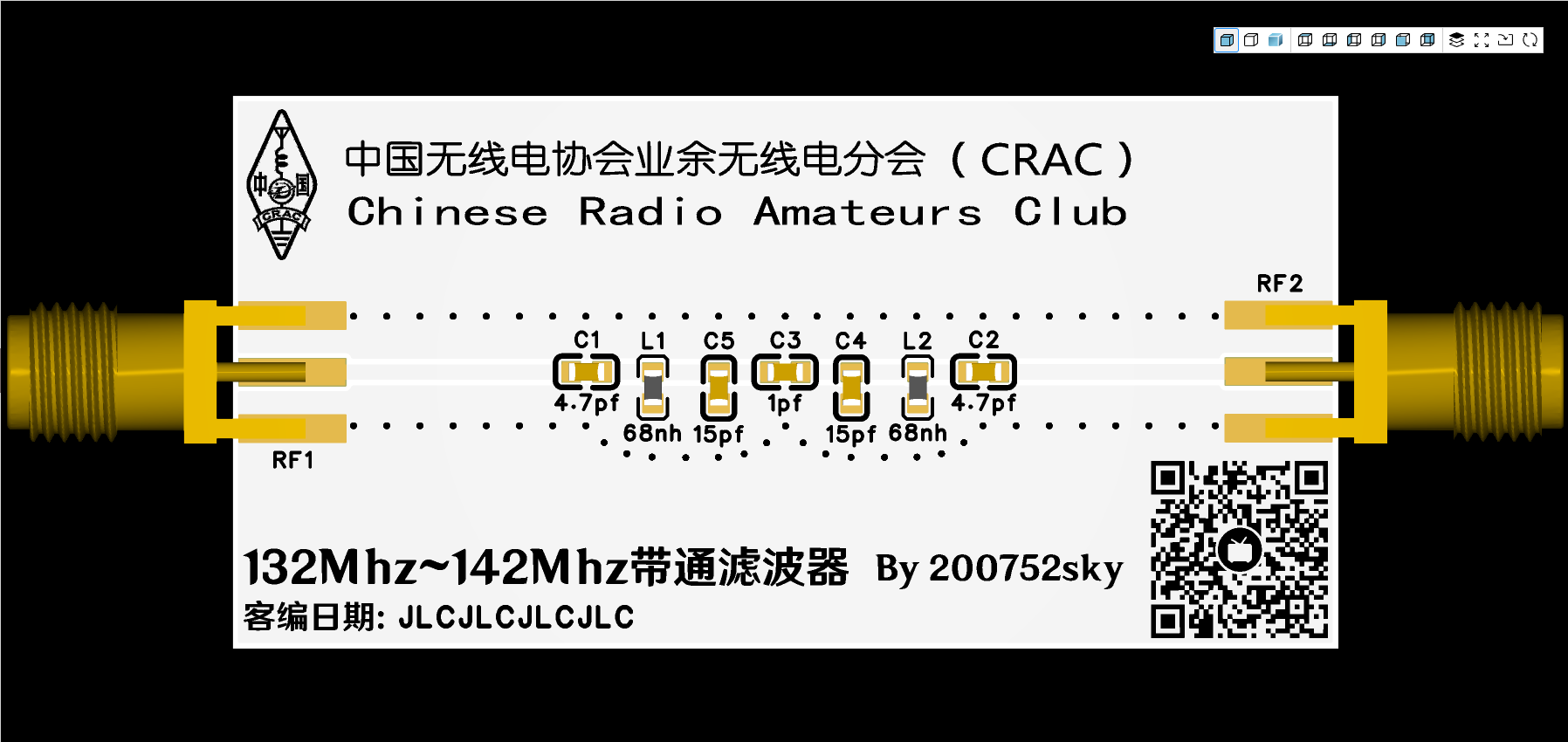

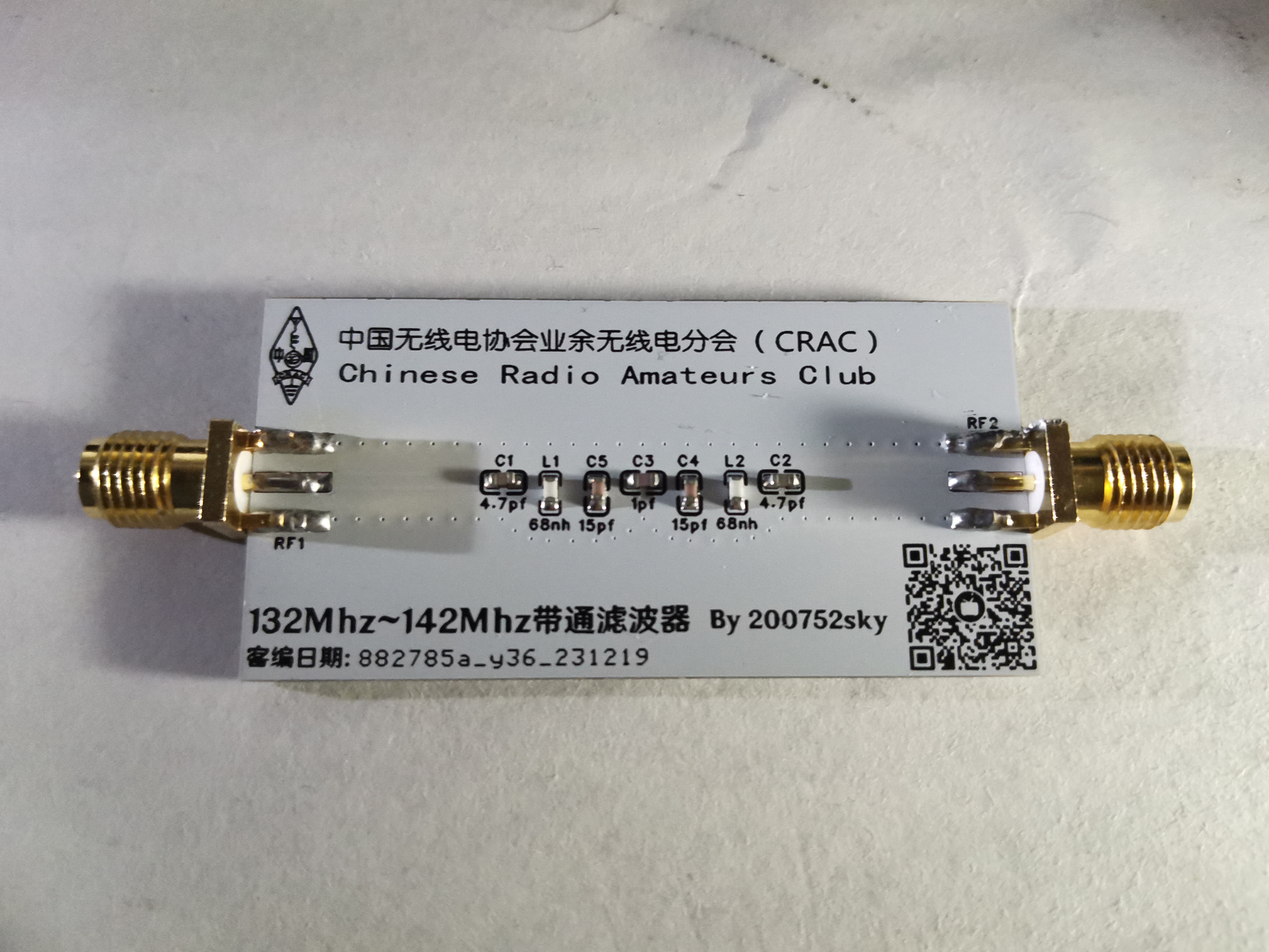

★ Rendering:

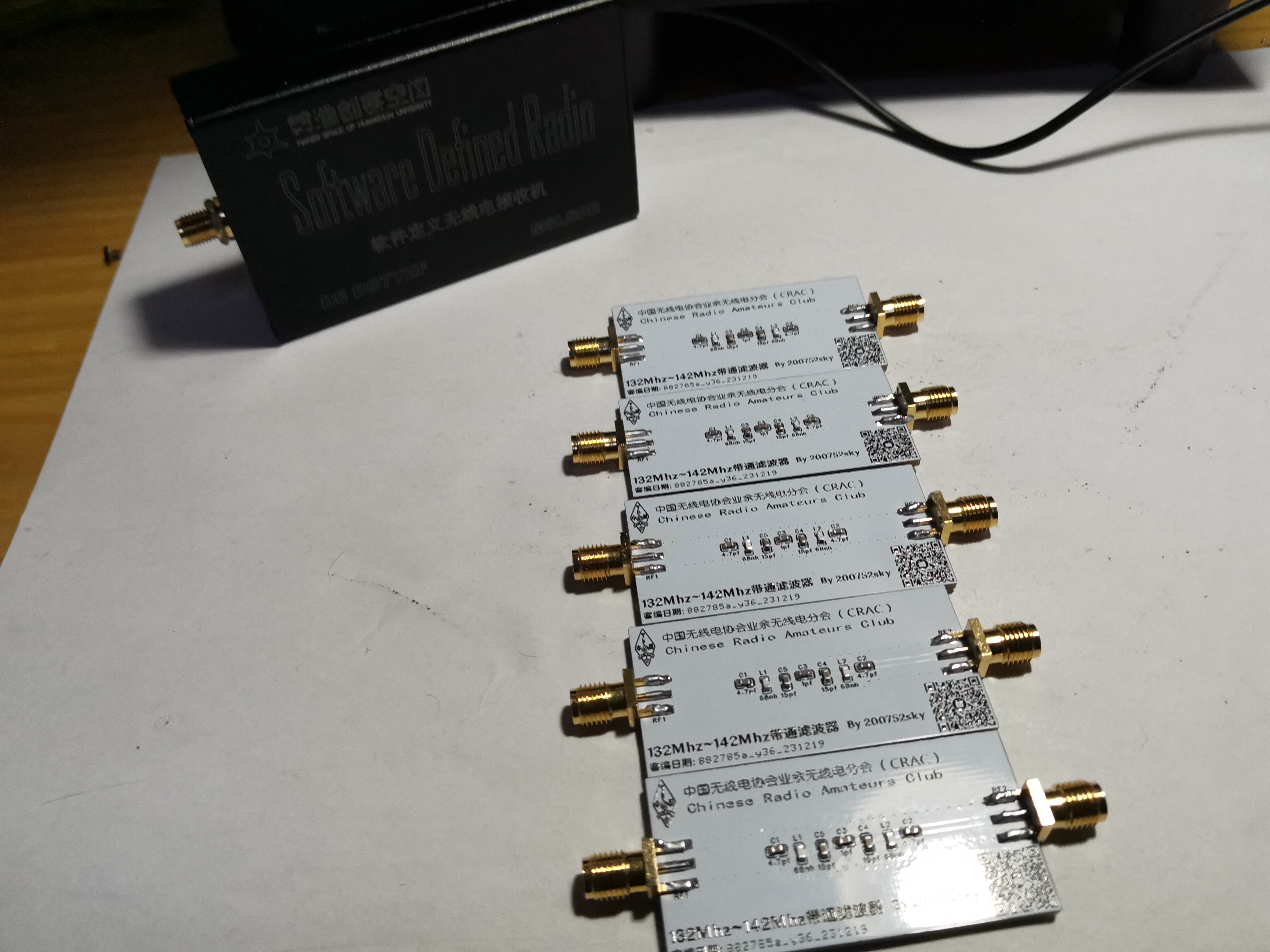

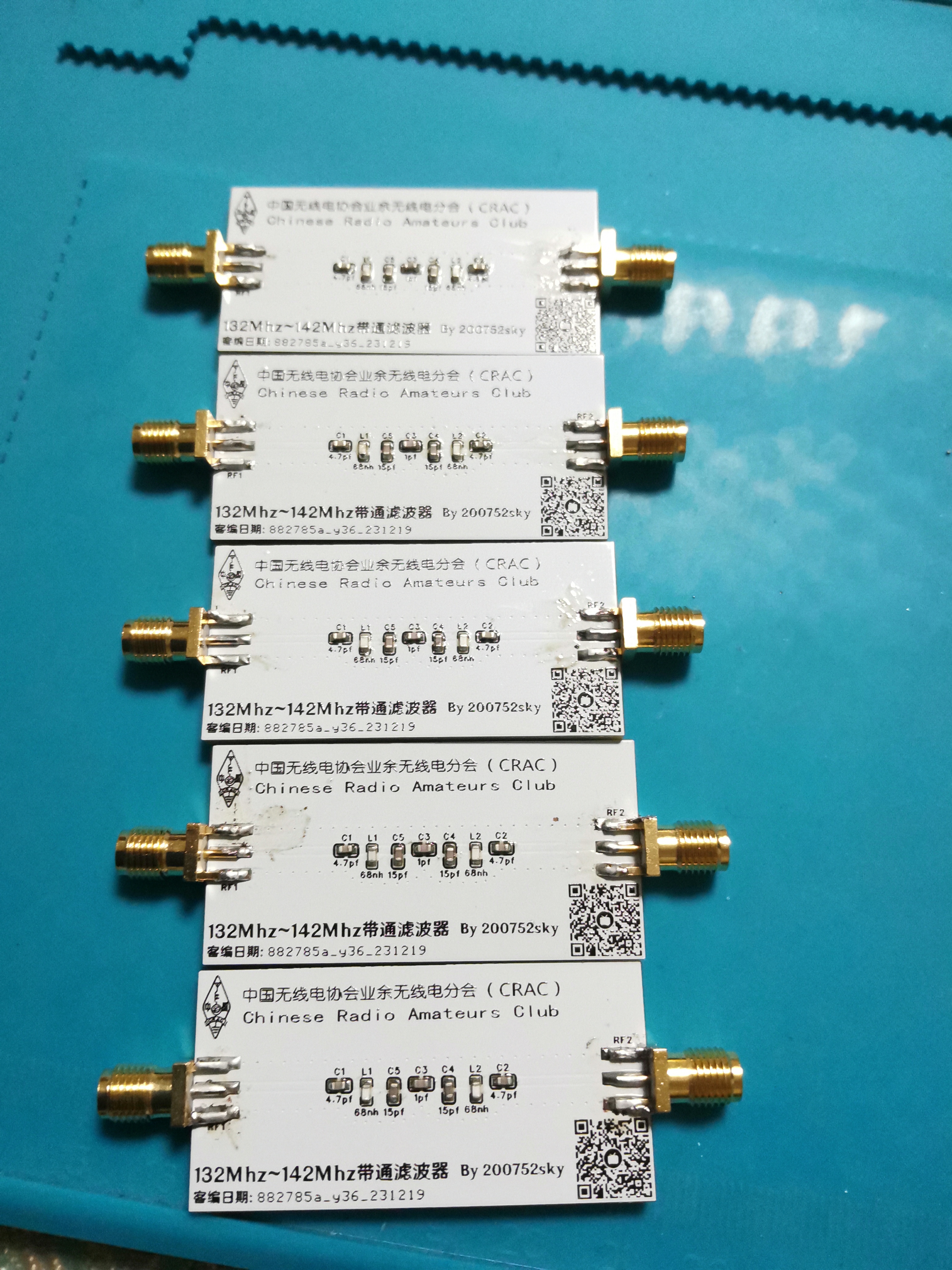

★ Physical image:

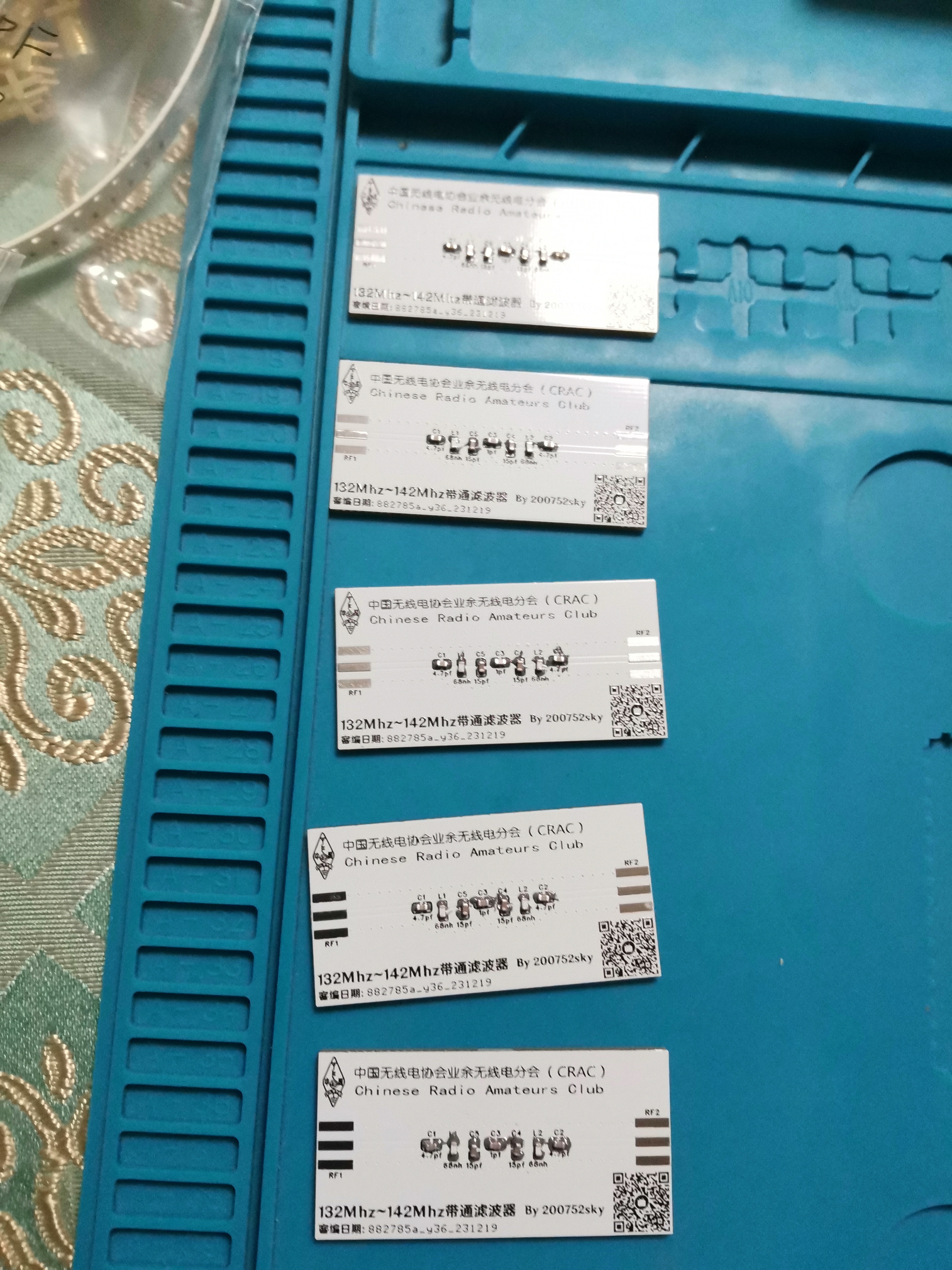

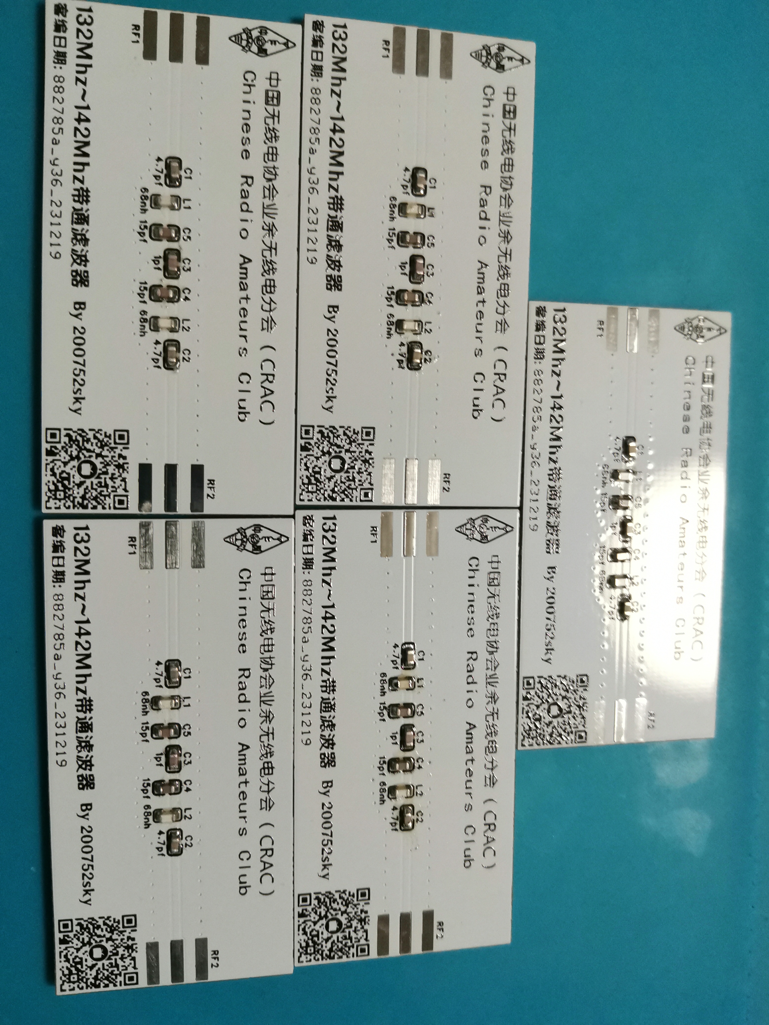

★ Production process:
1. Design board prototyping
2. Master-level hand-mounting
3. Manual reflow soldering
4. SMA connector soldering 5. Board cleaning solution
, clean and smell good (completed)
When making the board, remember to check the box for adding custom code at the specified location, board thickness 1.6mm, the rest are default, color is arbitrary.
