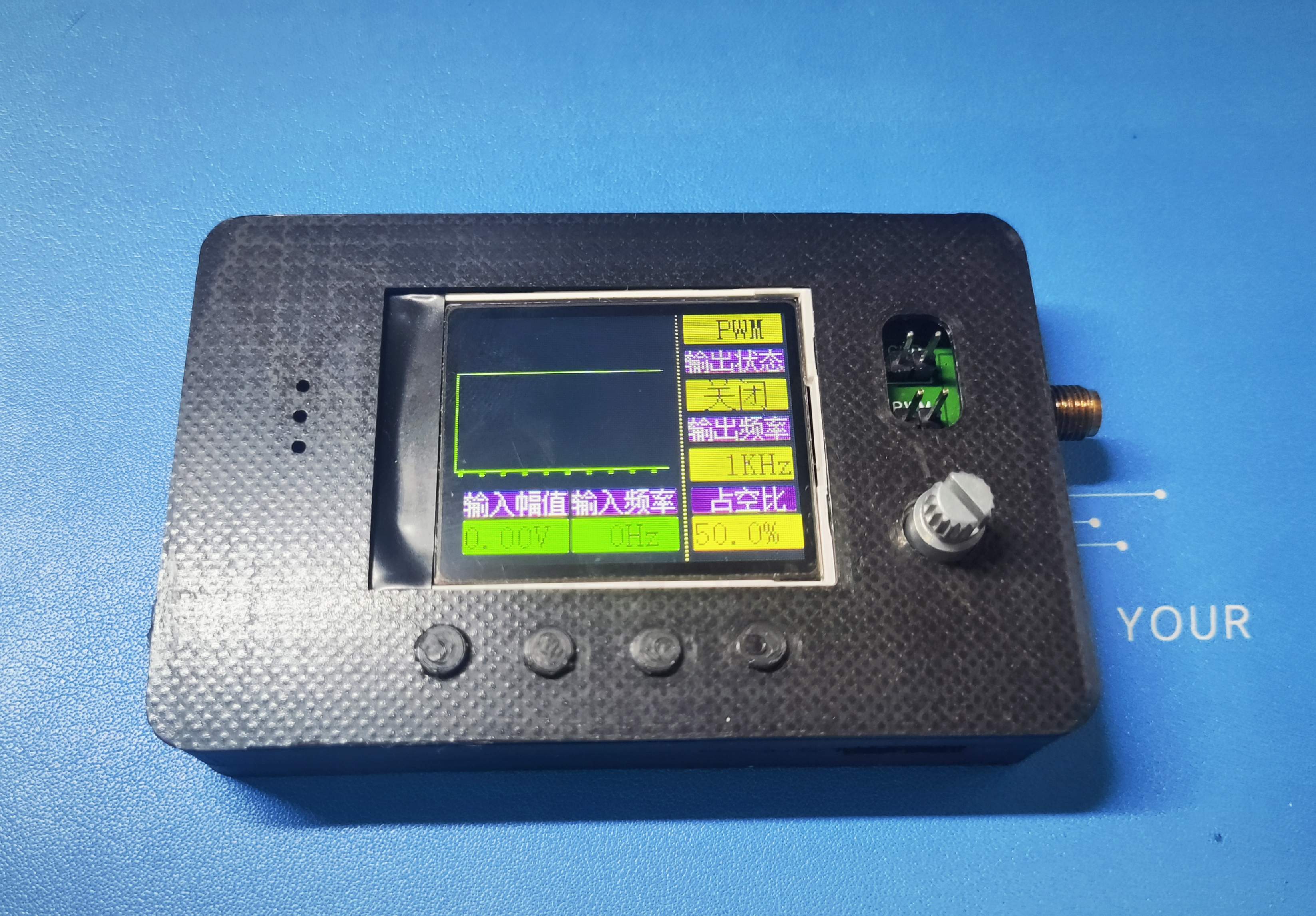

Two versions of the simplified digital oscilloscope
were developed: a development version and a bare-chip version.
The design largely references the official documentation – "Simple Digital Oscilloscope Project Documentation (yuque.com)" –
including pinout diagrams and charging
circuit design.
The charging chip uses the IP5306 power bank charging and discharging management chip, with 2.1A charging and 2.4A discharging, which is considered fast charging for the oscilloscope's small battery. The chip features output overcurrent, overvoltage, and short-circuit protection; input overvoltage, overcharge, over-discharge, and overcurrent discharge protection; and overall over-temperature protection. It supports simultaneous charging and discharging, one-button power on/off, and an LED power display.
The image above is the reference circuit design schematic from the official datasheet. Too many LED power indicators on the circuit board would be visually unappealing, so one indicator light is reserved for charging and discharging indication. A power detection circuit is designed to display the current power level on the screen. The
design references the single-LED reference circuit in the datasheet. Power detection uses two resistors to divide the battery voltage, and the microcontroller's ADC pin detects the voltage magnitude.
Voltage divider calculation formula: UBAT_v = R12 / (R8 + R12) * UBAT

code modification. Modify
the screen orientation
by modifying the macro definition in Hardware/tft_init.h:
#define USE_HORIZONTAL 2 // Set landscape or portrait display 0 or 1 for portrait, 2 or 3 for landscape.
Modify the screen pixel offset
by modifying the function TFT_Address_Set in Hardware/tft_init.c to offset x1, x2, y1, y2 by addition and subtraction.
        TFT_WR_REG(0x2a); // Column address setting TFT_WR_DATA(x1+1); TFT_WR_DATA(x2+1); TFT_WR_REG(0x2b); // Row address setting TFT_WR_DATA(y1+2); TFT_WR_DATA(y2+2); TFT_WR_REG(0x2c); // Write to memory. The waveform display area in
the full-screen waveform
source code is too small, making it difficult to observe waveforms with lower frequencies. Therefore,
the function drawCurve in Hardware/tft.c is modified to make the display width less than 160.

Modify the display UI
. After modifying the waveform display area, the original display UI will be disordered, so modify it
in Hardware/tft.c. Modify the static UI display function TFT_StaticUI and the display parameter function TFT_ShowUI to
/** Function content: Static UI * Function parameters: None * Return value: None */ void TFT_StaticUI(void){ uint16_t i=0,j=0; char showData[32]={0}; //TFT_ShowChinese(10,0,(uint8_t *)"Simple Oscilloscope",BLACK,GREEN,16,0); sprintf(showData," PWM "); TFT_ShowString(5,72,(uint8_t *)showData,BLACK,YELLOW,16,0); memset(showData,0,32); TFT_ShowChinese(55,56,(uint8_t *)"Output Status",WHITE,PURPLE,12,0); sprintf(showData," "); TFT_ShowString(55,72,(uint8_t *)showData,BLACK,YELLOW,16,0); memset(showData,0,32); TFT_ShowChinese(110,56,(uint8_t *)"Output frequency",WHITE,PURPLE,12,0); sprintf(showData," "); TFT_ShowString(110,72,(uint8_t *)showData,BLACK,YELLOW,16,0); memset(showData,0,32); sprintf(showData," "); TFT_ShowString(110,92,(uint8_t *)showData,WHITE,PURPLE,12,0); memset(showData,0,32); TFT_ShowChinese(118,92,(uint8_t *)"Duty Cycle",WHITE,PURPLE,12,0); sprintf(showData," "); TFT_ShowString(110,106,(uint8_t *)showData,BLACK,YELLOW,16,0); memset(showData,0,32); TFT_ShowChinese(5,92,(uint8_t *)"Input amplitude",WHITE,PURPLE,12,0); TFT_ShowChinese(55,92,(uint8_t *)"Input frequency",WHITE,PURPLE,12,0); for(i=0;i { TFT_DrawPoint(106,i,YELLOW); } for(i=0;i { TFT_DrawPoint(i,51,BorderColour); } for(i=0;i { TFT_DrawPoint(0,i,BorderColour); } for(i=0;i { TFT_DrawPoint((i*10)+2,52,BorderColour); TFT_DrawPoint((i*10)+3,52,BorderColour); } for(i=0;i { TFT_DrawPoint((i*10)+2,53,BorderColour); TFT_DrawPoint((i*10)+3,53,BorderColour); }}/** Function content: Display string * Function parameters: uint16_t vpp--peak-peak value * uint16_t freq-frequency * float DoBias--DC bias signal * Return value: None */void TFT_ShowUI(volatile const struct Oscilloscope *value){ char showData[32]={0}; sprintf(showData,"%1.2fV ",(*value).vpp); TFT_ShowString(5,106,(uint8_t *)showData,BLACK,GREEN,16,0); memset(showData,0,32); if((*value).gatherFreq>=1000) { sprintf(showData,"%2.0fKHz",(*value).gatherFreq/1000.0f); TFT_ShowString(55,106,(uint8_t *)showData,BLACK,GREEN,16,0); memset(showData,0,32); } else { sprintf(showData,"%3.0fHz ",(*value).gatherFreq); TFT_ShowString(55,106,(uint8_t *)showData,BLACK,GREEN,16,0); memset(showData,0,32); }
    if((*value).ouptputbit == 1) { TFT_ShowChinese(55,72,(uint8_t *)"Open",BLACK,YELLOW,16,0); } else { TFT_ShowChinese(55,72,(uint8_t *)"Close",BLACK,YELLOW,16,0); } if((*value).outputFreq>=1000) { sprintf(showData,"%3dKHz",(*value).outputFreq/1000); TFT_ShowString(110,72,(uint8_t *)showData,BLACK,YELLOW,16,0); memset(showData,0,32); } else { sprintf(showData," %3dHz",(*value).  outputFreq); TFT_ShowString(110,72,(uint8_t *)showData,BLACK,YELLOW,16,0); memset(showData,0,32); }
    sprintf(showData,"%3.1f%% ",(((*value).pwmOut)/((*value).timerPeriod+0.0f))*100); TFT_ShowString(110,106,(uint8_t *)showData,BLACK,YELLOW,16,0); memset(showData,0,32); }
Add pwm to enable indicator light
= Add the header file for the LED indicator light in Hardware/key.c, and modify
        case KEY2 in the key handling function Key_Handle: if((*value).ouptputbit == 0) { (*value).ouptputbit=1; timer_enable(TIMER14); Open_LED(1); } else { (*value).ouptputbit=0; timer_disable(TIMER14); CLose_LED(1); } break;
Finished product display
