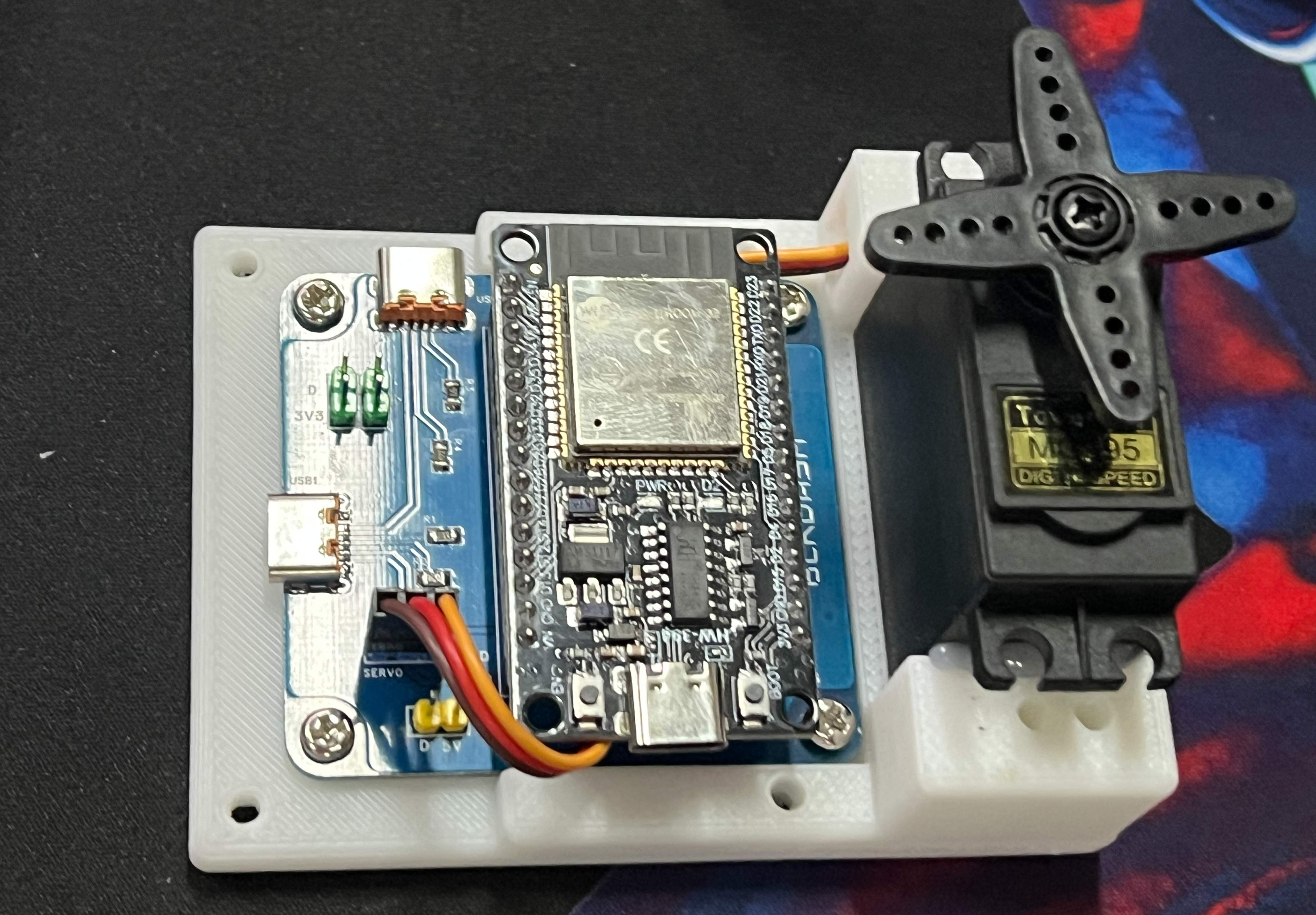

1-Simplified dormitory door lock
This simplified dormitory door lock
project uses an ESP32 microcontroller as the main control and communication module. It utilizes the Diandeng Technology IoT platform, employing Wi-Fi to remotely control a servo motor to pull the lock, achieving remote door opening.
The bill of materials includes:
4 0805 surface mount resistors (200-500Ω),
2 6-
pin USB-C ports, several header pins, an
ESP-32 development board, a WROOM development board
, and an MG995 servo motor (an SG90 can also be used, depending on the lock's resistance). The required environment includes a

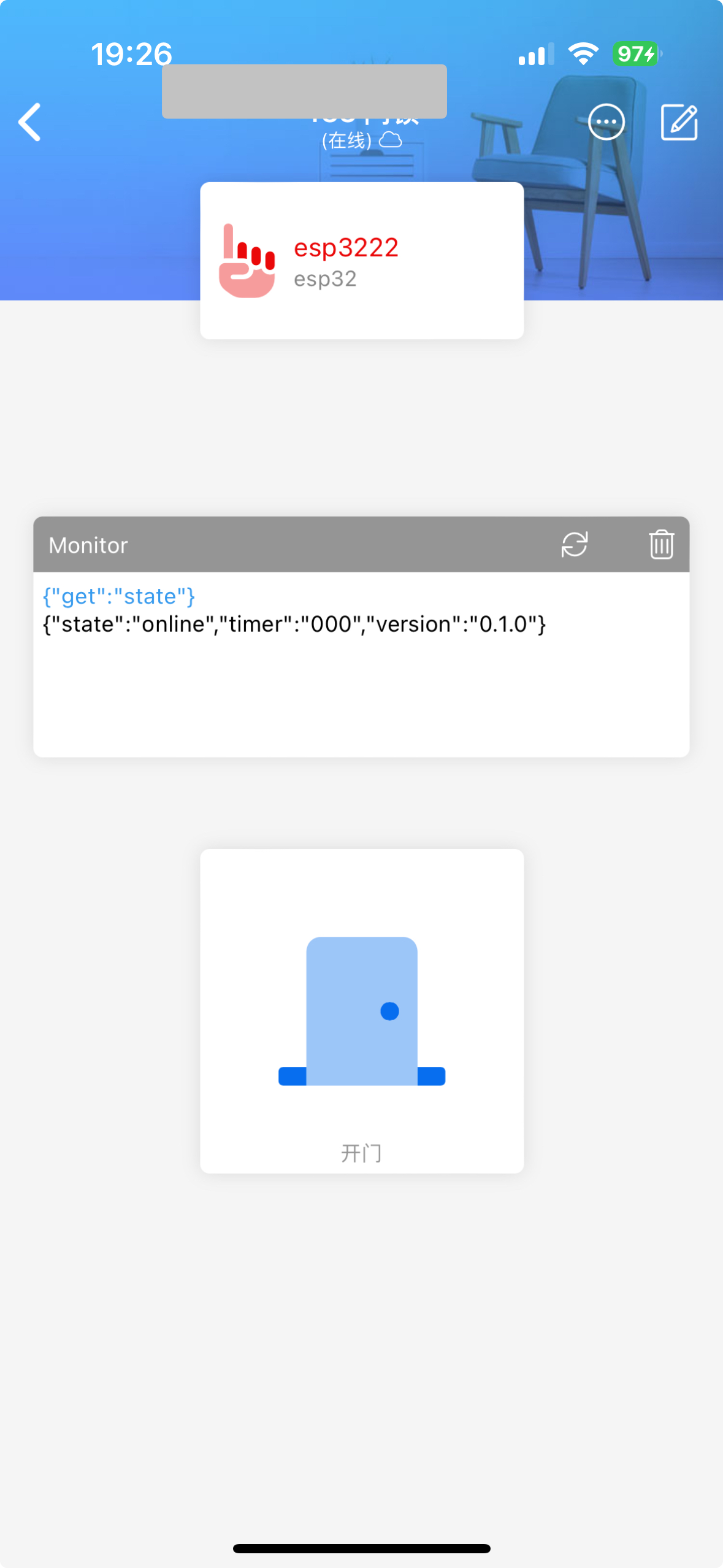

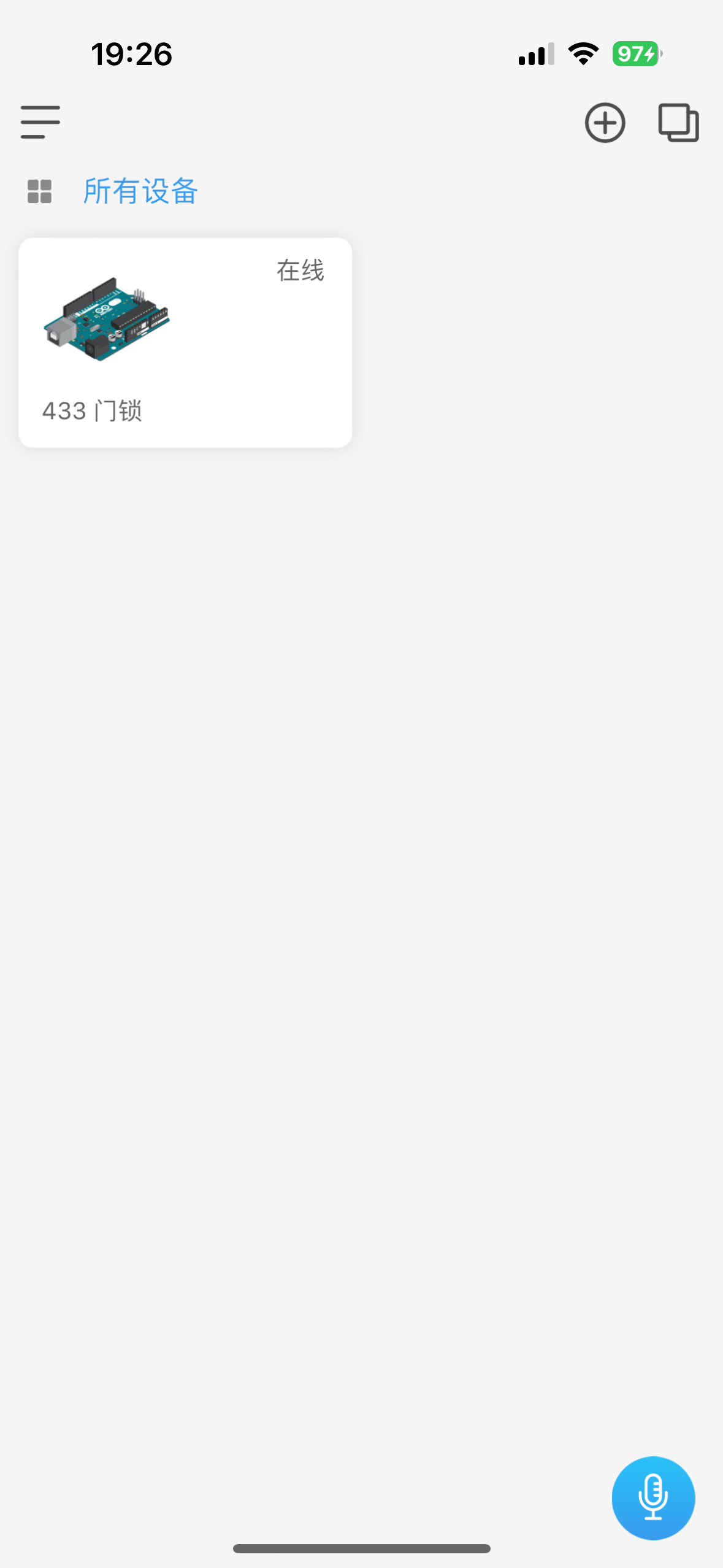

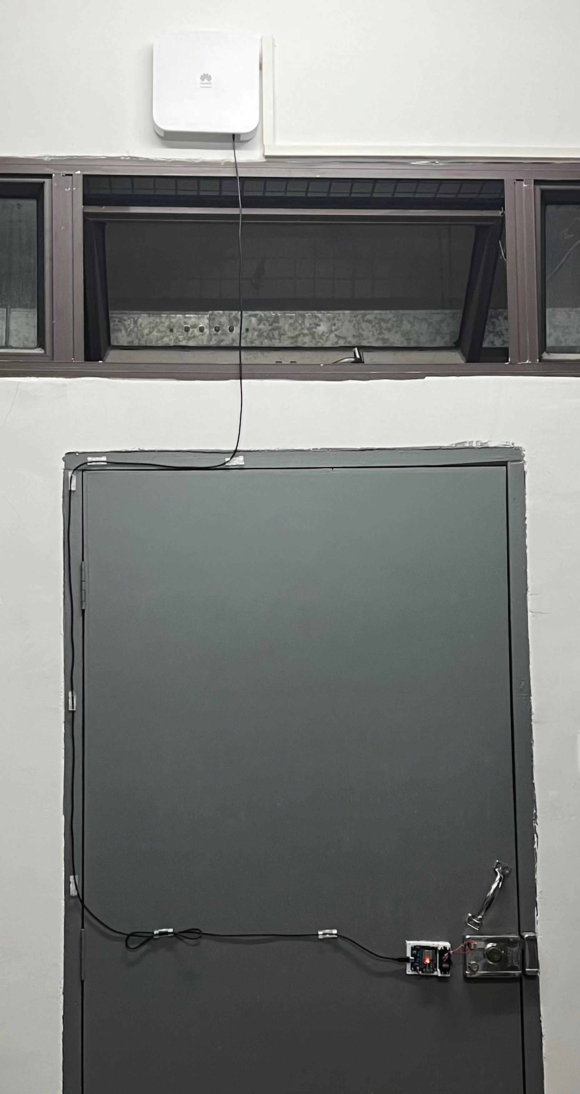

. On-site demonstration:
(Powered from the dormitory Wi-Fi's USB port, or powered by a charger (a cheap and stable 5V 1A charger will suffice)).
Diandeng Technology APP interface demonstration:
