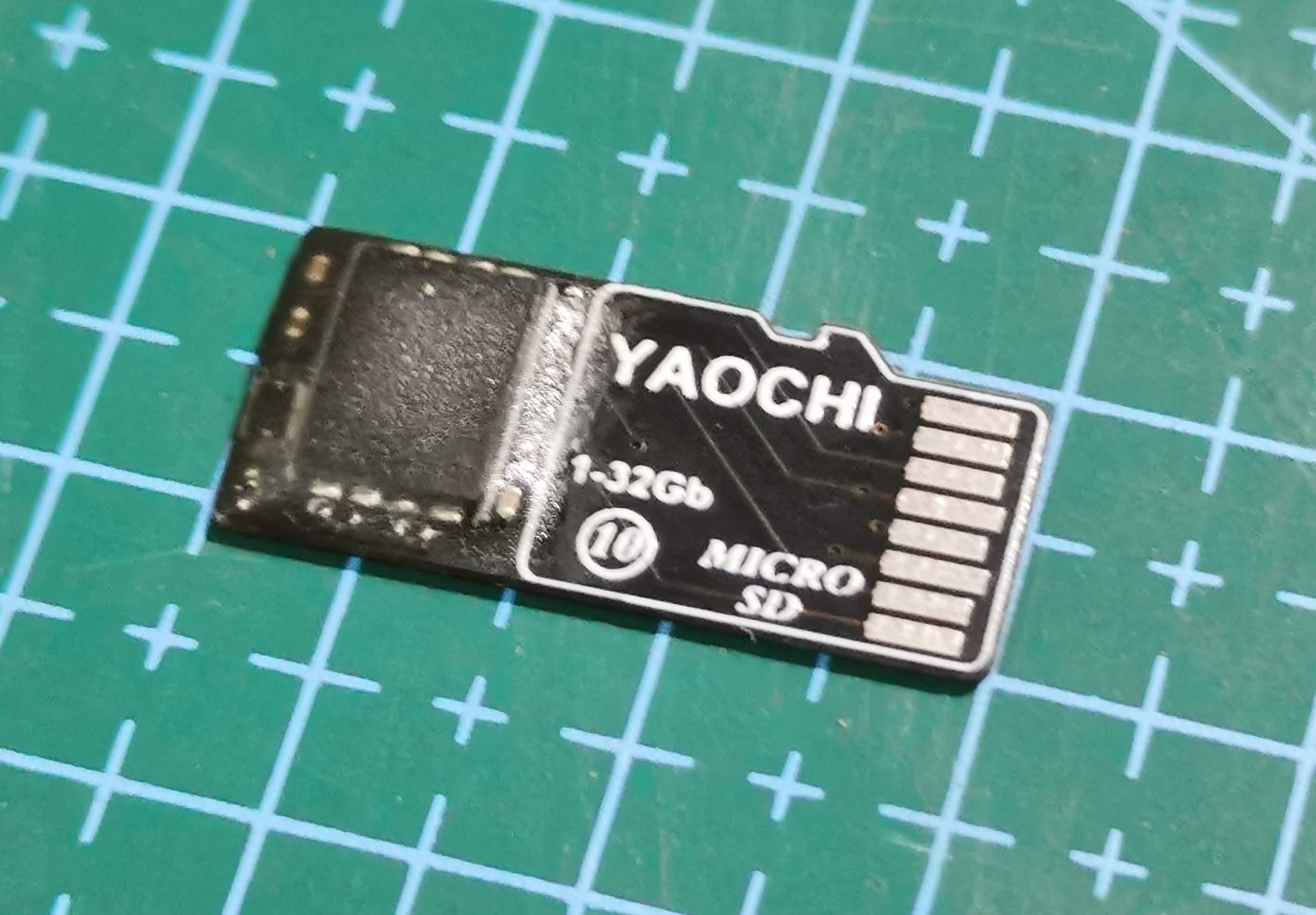

Using SD NAND with SLC particles on 3D printers instead of the traditional TF cards that use TLC or QLC particles solves the problem of frequent read and write errors and necrosis of TF cards on 3D printers.
SD NAND has built-in SLC wafer, built-in bad block management, 10W erase and write life, passed 10,000 random power-off tests, and has a speed of class 10.
Among them, the bidirectional tvs tube and capacitor can be left unsoldered (to increase robustness, maybe they should be left unsoldered?); the 33R resistor can be replaced with a 0-120R resistor or short-circuited directly. Ready to use after welding.
It is recommended to use UV glue to seal the components after testing the functionality.
SD NAND has optional 128MB-4GB capacity, which is enough to hold gcode files.
All components are on the front. The TVS tube is a SOT-323 package with a voltage of not less than 3.3V. The SD NAND is Genesis SD NAND. The RC package is 0402. The size is written on the back. You can buy it at Lichuangdu.

Be sure to choose 0.8mm thickness when making boards! ! !
