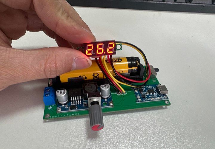

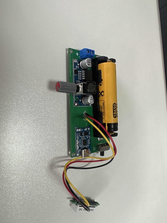

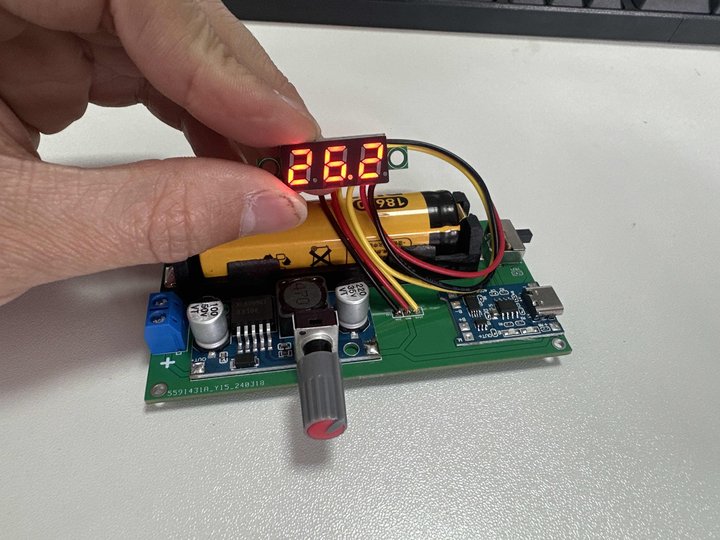

Voltage range: 3.7-38V.
I have several different versions! Choose according to your needs;

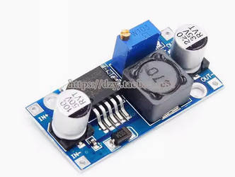

there's not much to say. The lifting module was a ready-made product bought from Taobao:
      I replaced the adjustment knob with a 0932 10K potentiometer.

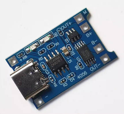

The charging module was also bought from Taobao: the battery is an 18650 battery. Note that the positive and negative terminals must not be reversed when installing the battery, otherwise the circuit board will be burned during charging!
Physical
semi-finished product display .
