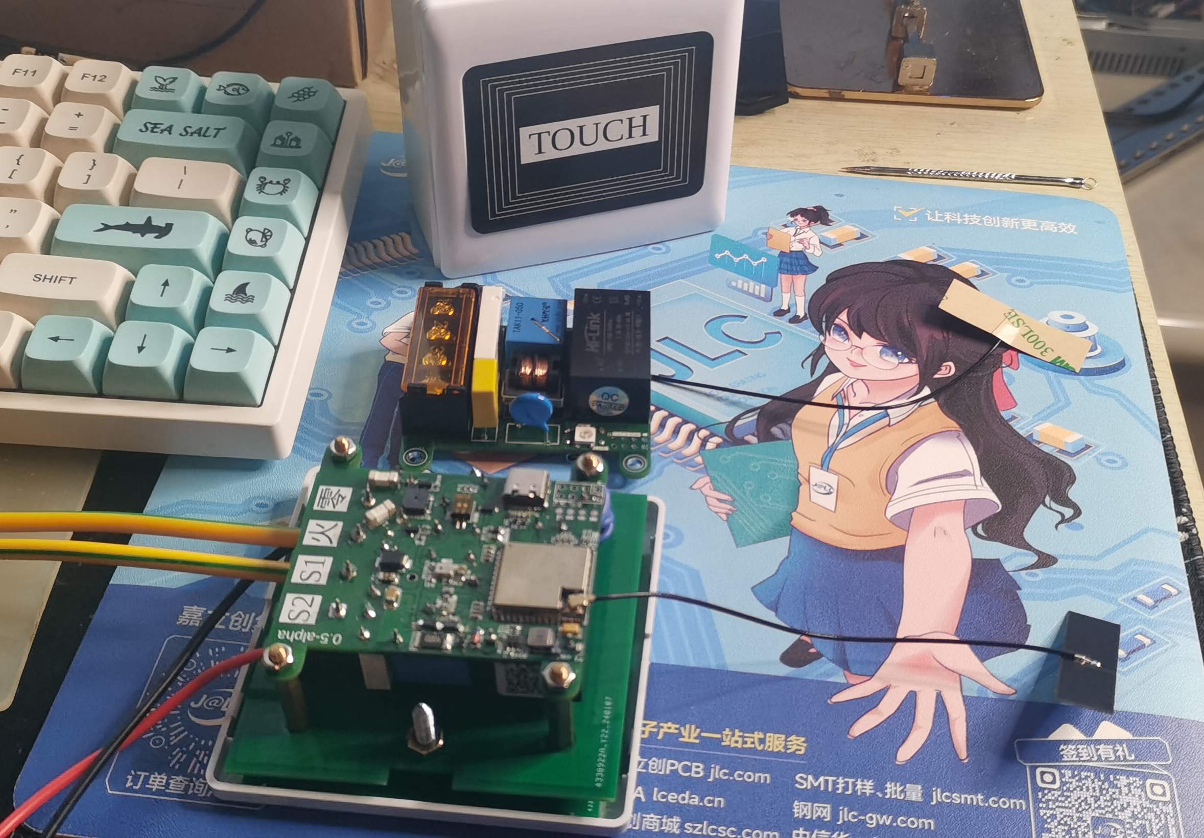

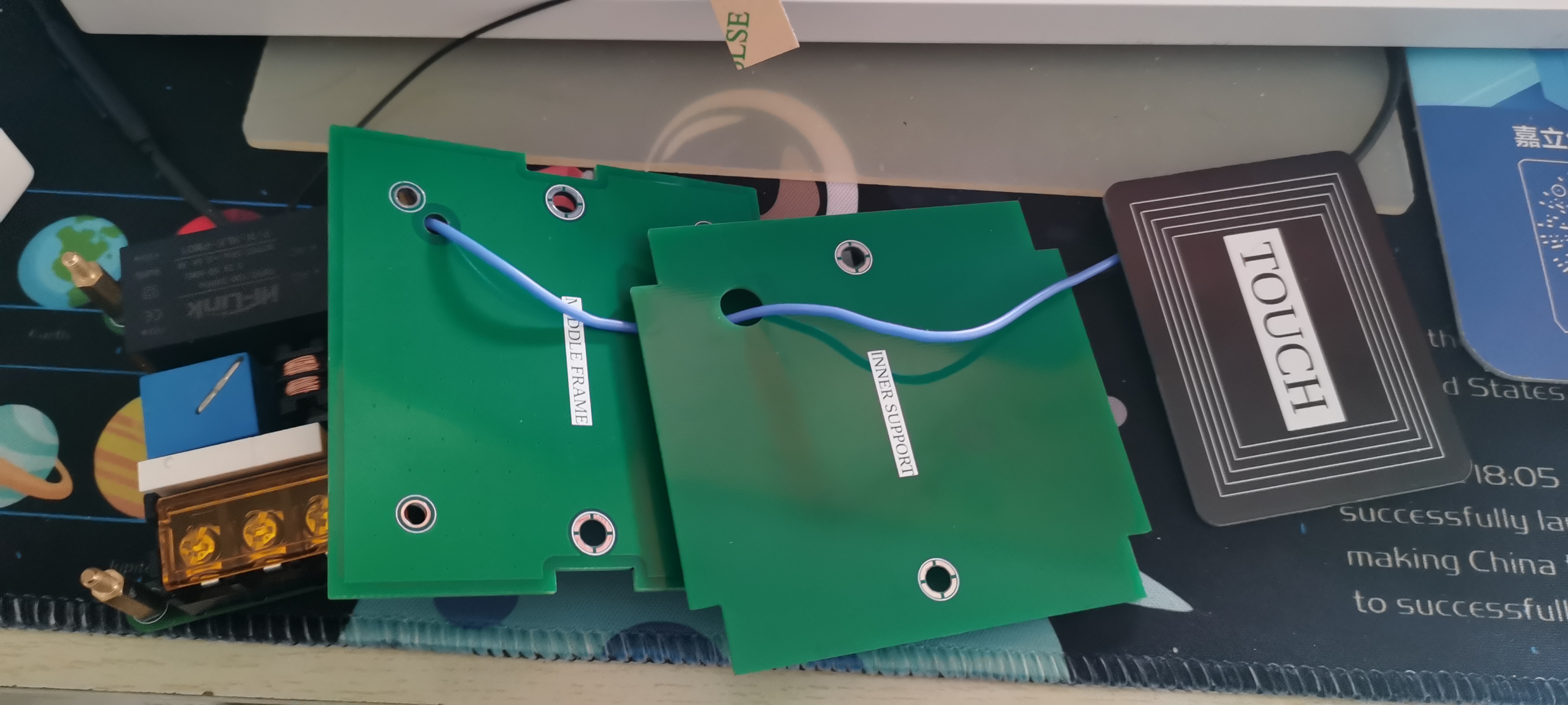

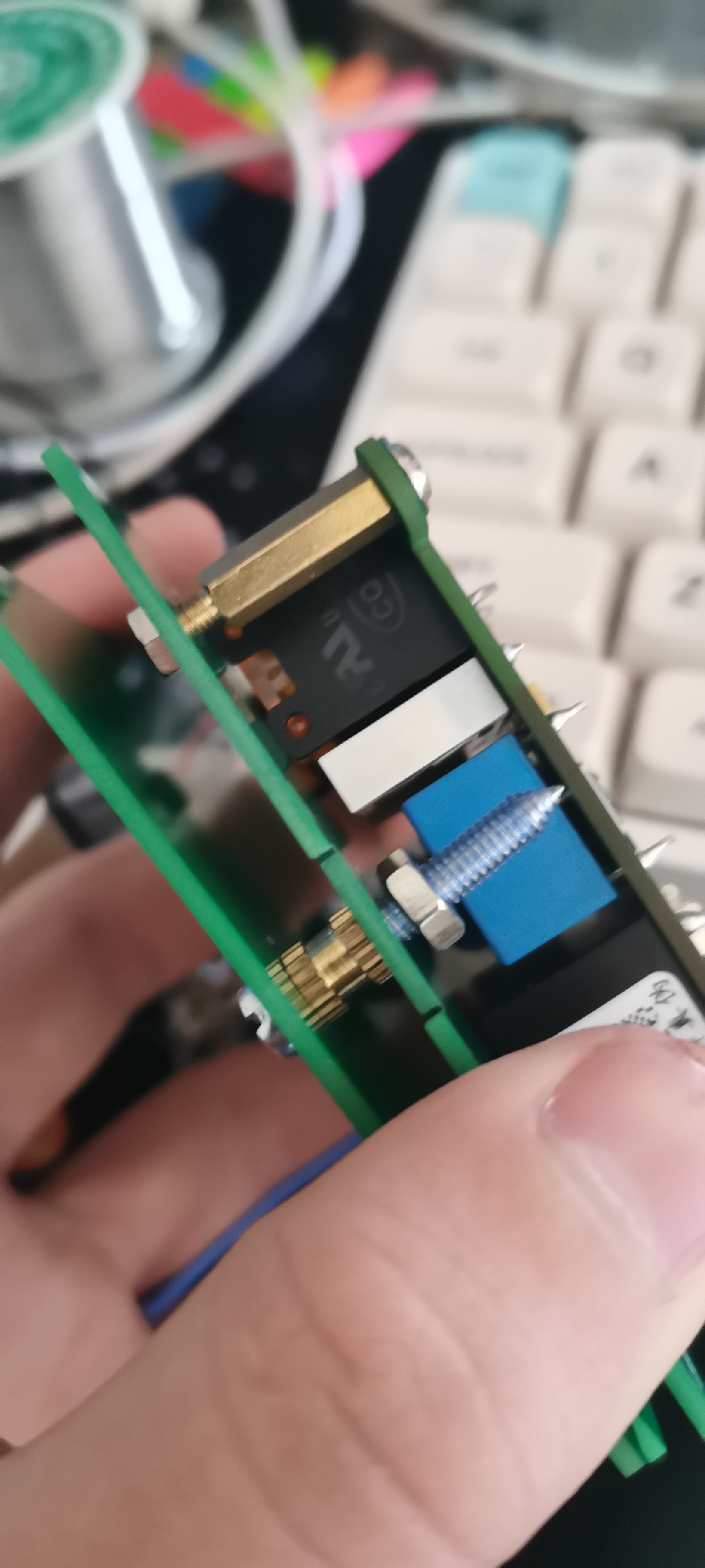

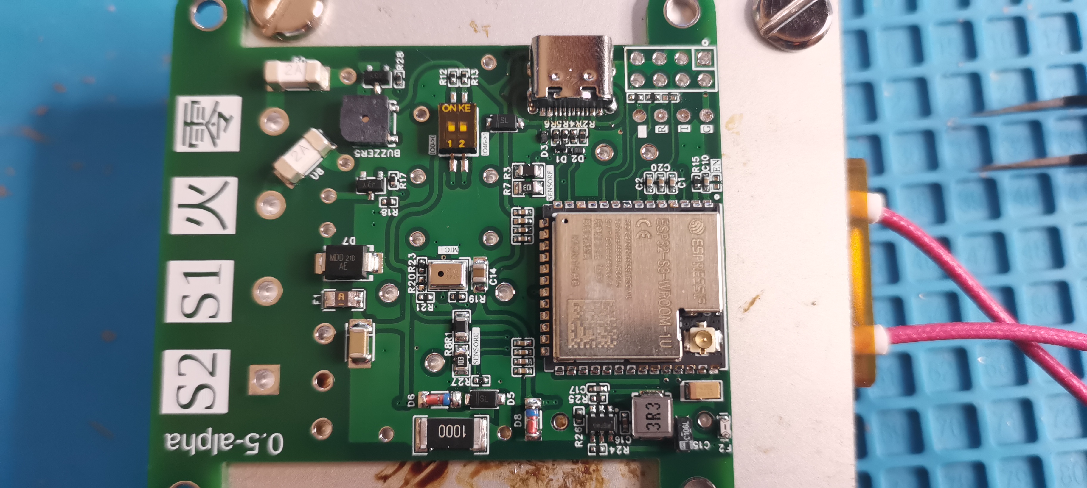

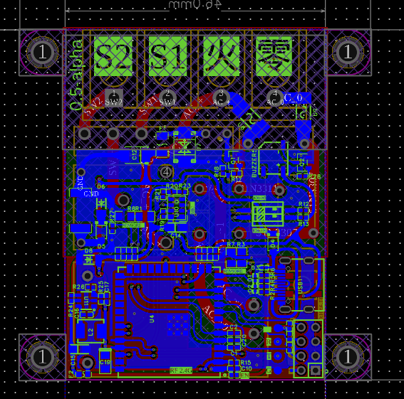

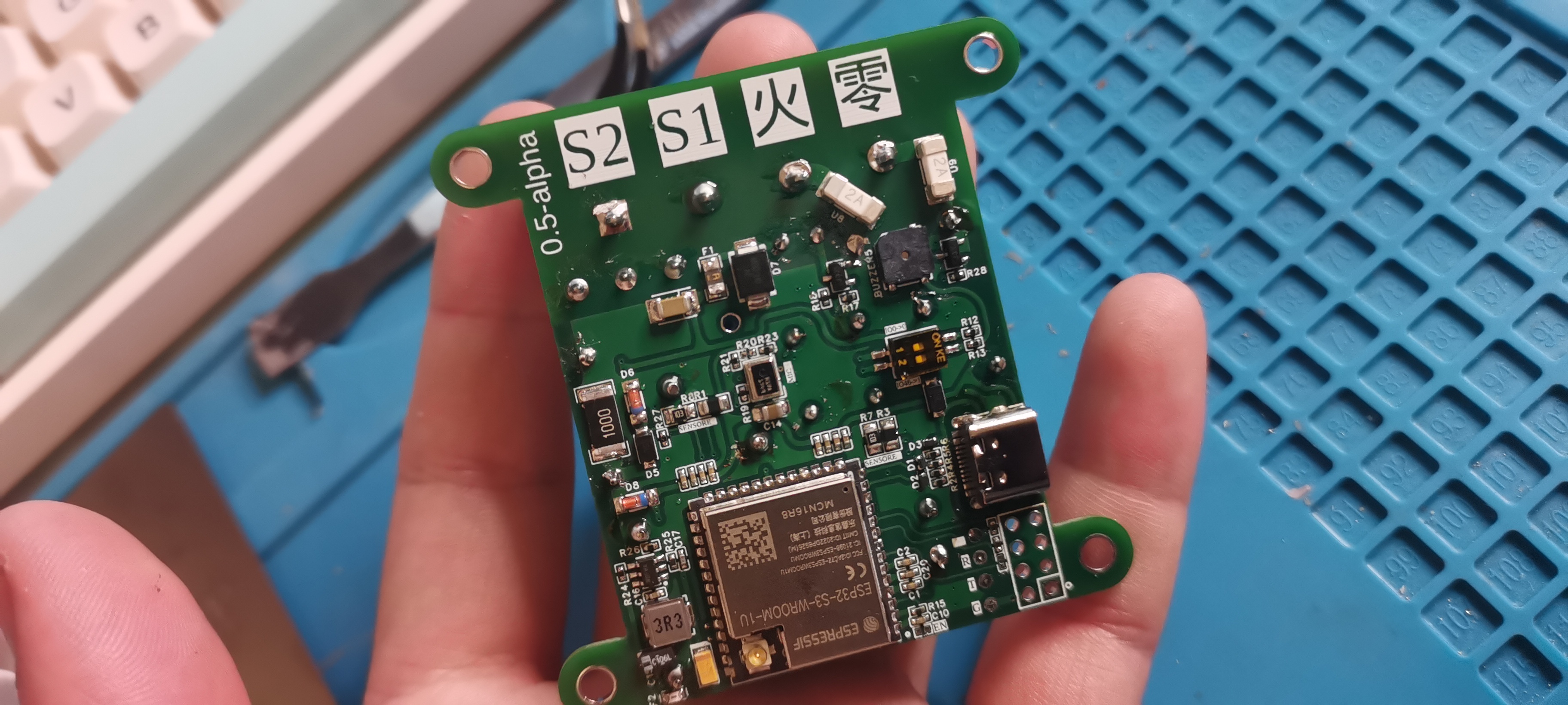

The "Type 86" IoT switch is a finished product demonstration project

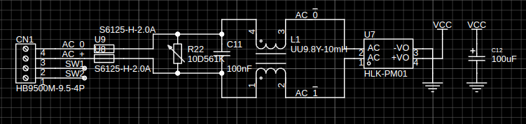

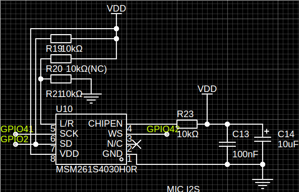

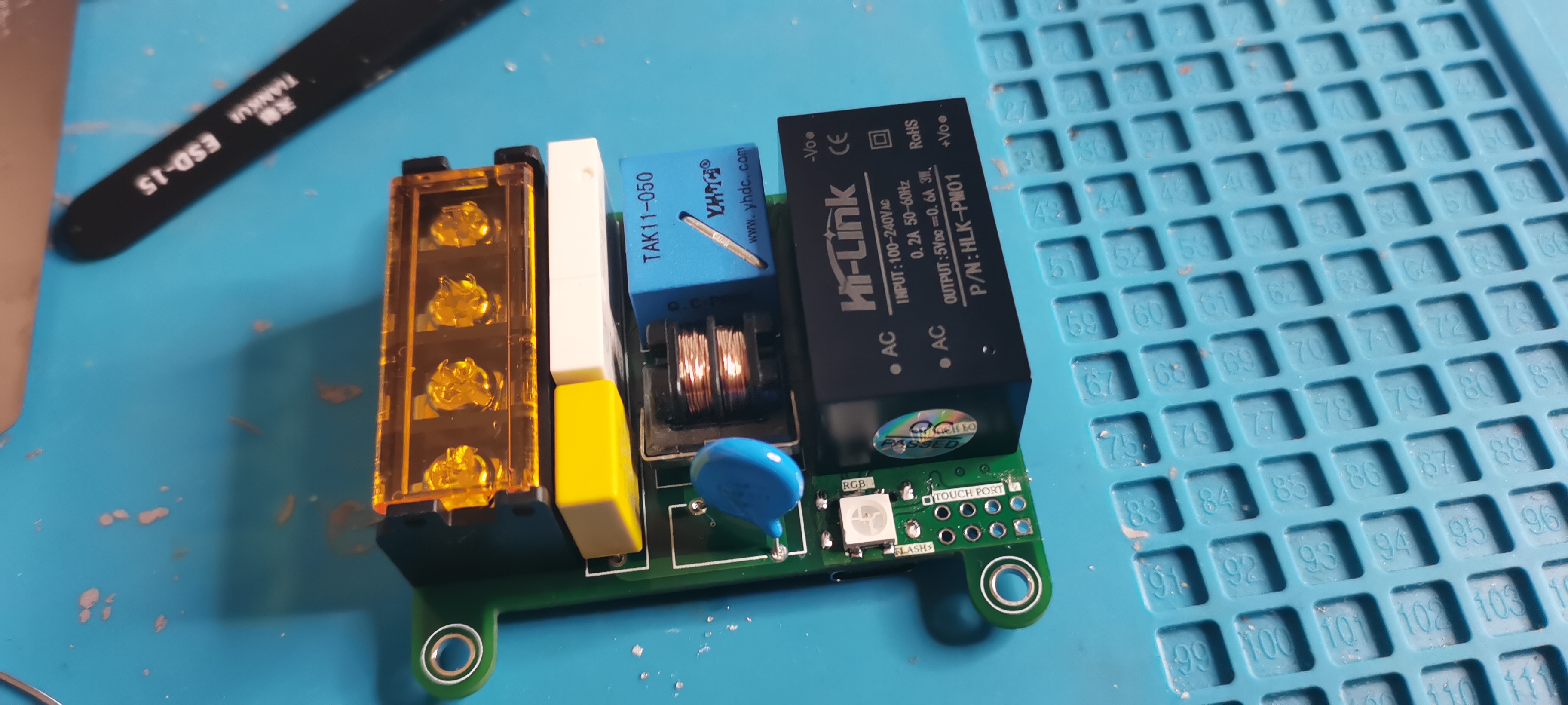

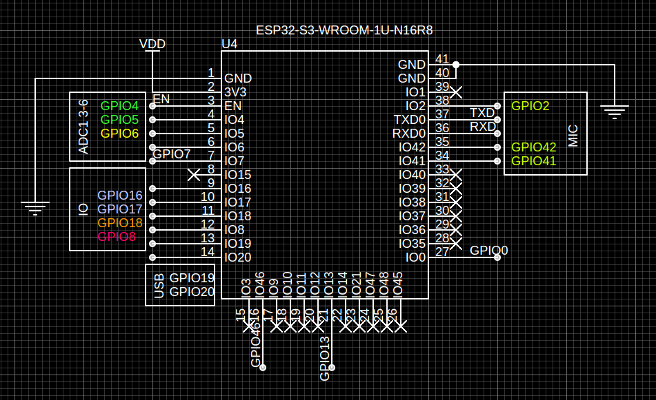

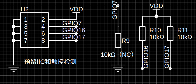

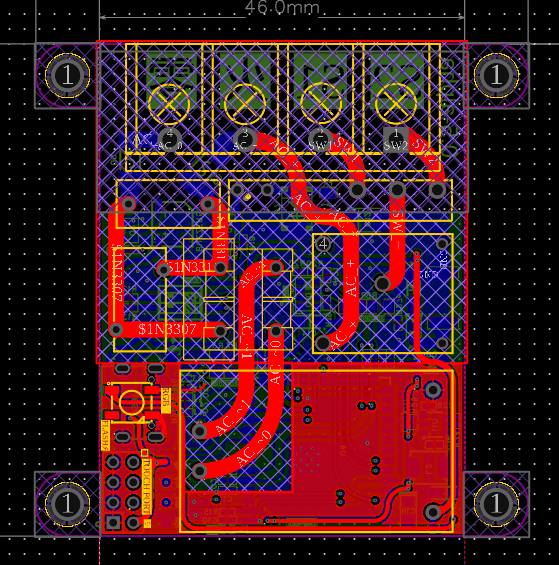

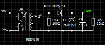

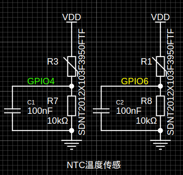

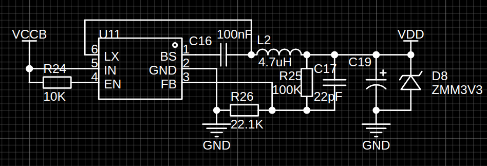

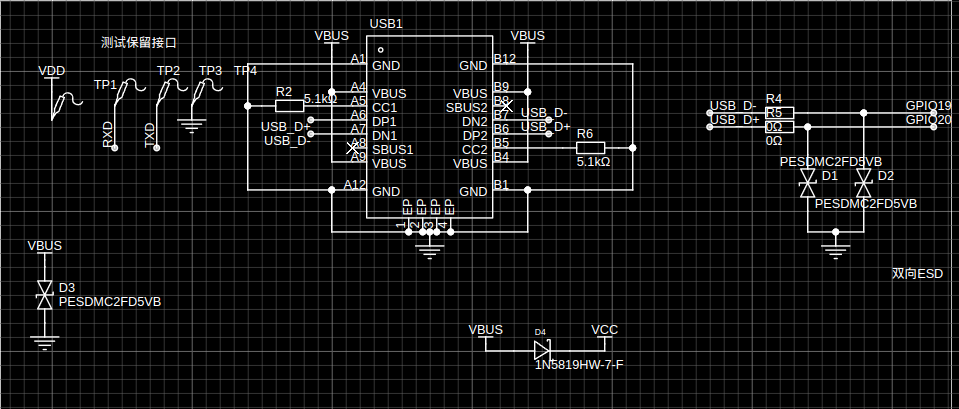

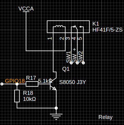

supporting QQ, WEB, touch, and voice control. The project consists of: switch hardware (IOTSwitch firmware based on ESP-IDF) , IoT Server (host computer based on Drogon, QtMqtt, Angular, and GoCqHttp) , switch hardware (back PCB, front PCB schematic design) , ESP32-S3 module, AC-DC isolated power supply module, DC-DC synchronous buck circuit , single-pole double-throw relay, USB-DEBUG circuit, current transformer output detection, I2S microphone circuit, NTC temperature sensor, touch interface, and BOOT. Optionally , the ESP32S3 module selected is the ESP32-S3-WROOM-1U-N16R8. The main control antenna of the ESP32-S3-WROOM-1U-N16R8 module uses an external interface and can be mounted on the back of the 86-type box. The AC-DC power supply uses a Hailingke HLK-PM01 as the isolated power supply, providing 220VAC->5VDC to power the relay. The DC-DC power supply uses a SY8120B1ABC synchronous step-down transformer, providing 3V AC from 5VAC to 3V AC to power the main control unit. A 4.7uH inductor is used. The 0420 package relay uses Hongfa's HF41F/5-ZS as the output control relay. The USB-DEBUG circuit omits a USB-TO-SERIAL circuit for DEBUG and program download output detection. This circuit is currently unavailable. A TAK11 current transformer is used due to PCB space constraints. Special thanks to Beijing Yaohua Dechang Electronics for shipping even when I ordered one or two; they were very helpful during my inquiry. The microphone uses an MSM261S4030H0R, referencing the ESP32-S3-EYE development board. Temperature sensing uses two thermistors to divide the voltage and measure the temperature, achieving high-temperature alarm touch detection . The ESP32-S3 uses GPIO7 as the default touch IO; the software allows setting the trigger threshold and protection time. The BOOT Option documentation is very detailed and will not be repeated here. // TODO Add Document link Other WS2812 MLT-5020 PCB design: The PCB uses a four-layer board: layer 1 for high voltage, layer 2 for internal power, and layers 3 and 4 for signals. Four-layer layout, one-layer layout, IO function overview. Hardware V0.5 Pin Target Announce P4 NTC_R3 ADC1_CH3 P5 CURR_SEN ADC1_CH4 P6 NTC_R1 ADC1_CH5 P7 TOUCH NAN P8 WS2812 NAN P13 BUZZER NAN P16 OUT_PORT NAN P17 OUT_PORT NAN P18 RELAY HIGH TO OPEN P2 MIC_SD NAN P41 MIC_SCK NAN P42 MIC_WS NAN IOTSwitch Function Overview MQTT Control Touchpad Control Voice Control Project Dependencies Component core support esp-idf >=5.0 espressif/esp-sr espressif/mdns espressif/esp-idf-cxx espressif/esp_mqtt_cxx espressif/led_strip bblanchon/arduinojson diam2023/ok_wifi If using espressif/esp-tflite-micro, refer to sheila_wake_up for details. See IOTSwitch/main/idf_component.yml for network configuration instructions. Refer to the OkWifi documentation (under development). MQTT instructions: Publish topic message format: devices/{SN}/status DeviceStatus {"status":bool} devices/{SN}/config DeviceConfig {"config...":"value..."}

"voltageSensor": {
"outputThreshold": 50,
"temperatureThreshold": 2000

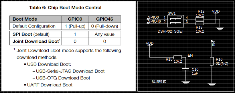

Main control module replacement instructions
refer to partitions.csv. Select capacity
# Name, Type, SubType, Offset, Size, Flags
# Note: if you have increased the bootloader size, make sure to update the offsets to avoid overlap
nvs, data, nvs, 0x009000, 24k,
phy_init, data, phy, 0x00f000, 4k,
factory, app, factory, 0x010000, 4032k,
model, data, spiffs, 0x400000, 4096k,
config, data, spiffs, 0x800000, 512k,
fr, data, , 0x880000, 128k,

If the serial port is not found or unstable during the first write, you can short-circuit IO0 to power on.

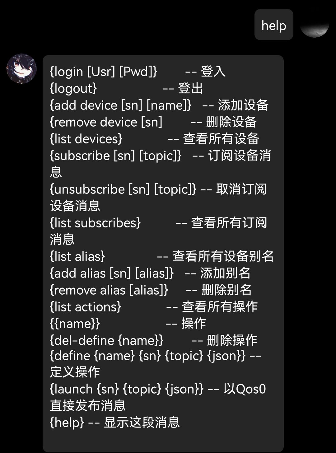

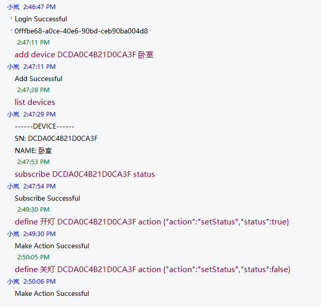

QQ Control
Help
Add Devices and Behaviors
with Custom Behavior Reference
Define Operation {Operation Name} {Device Name/Alias} {subtopic} {JSON Data}

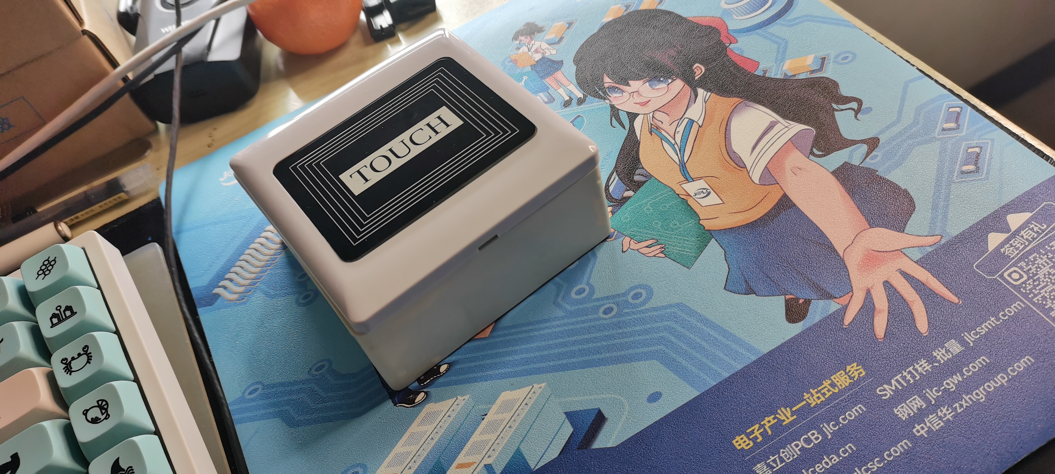

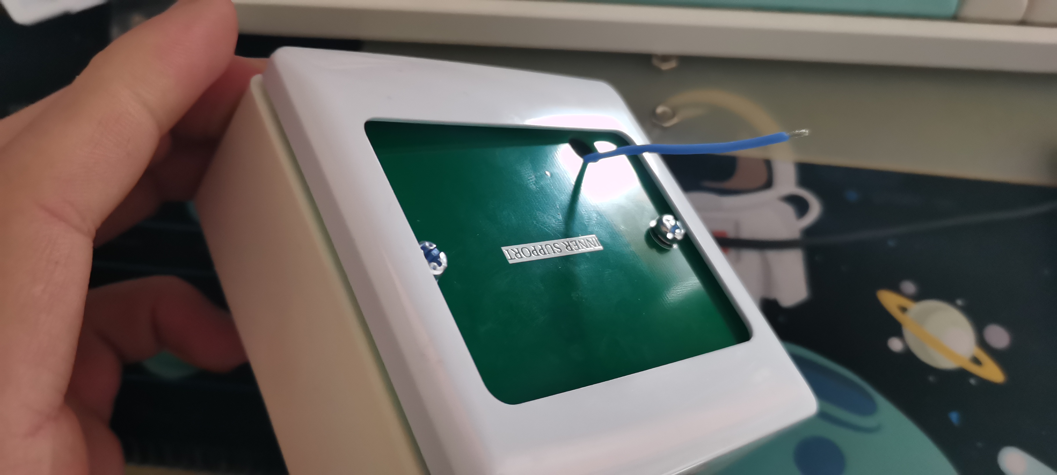

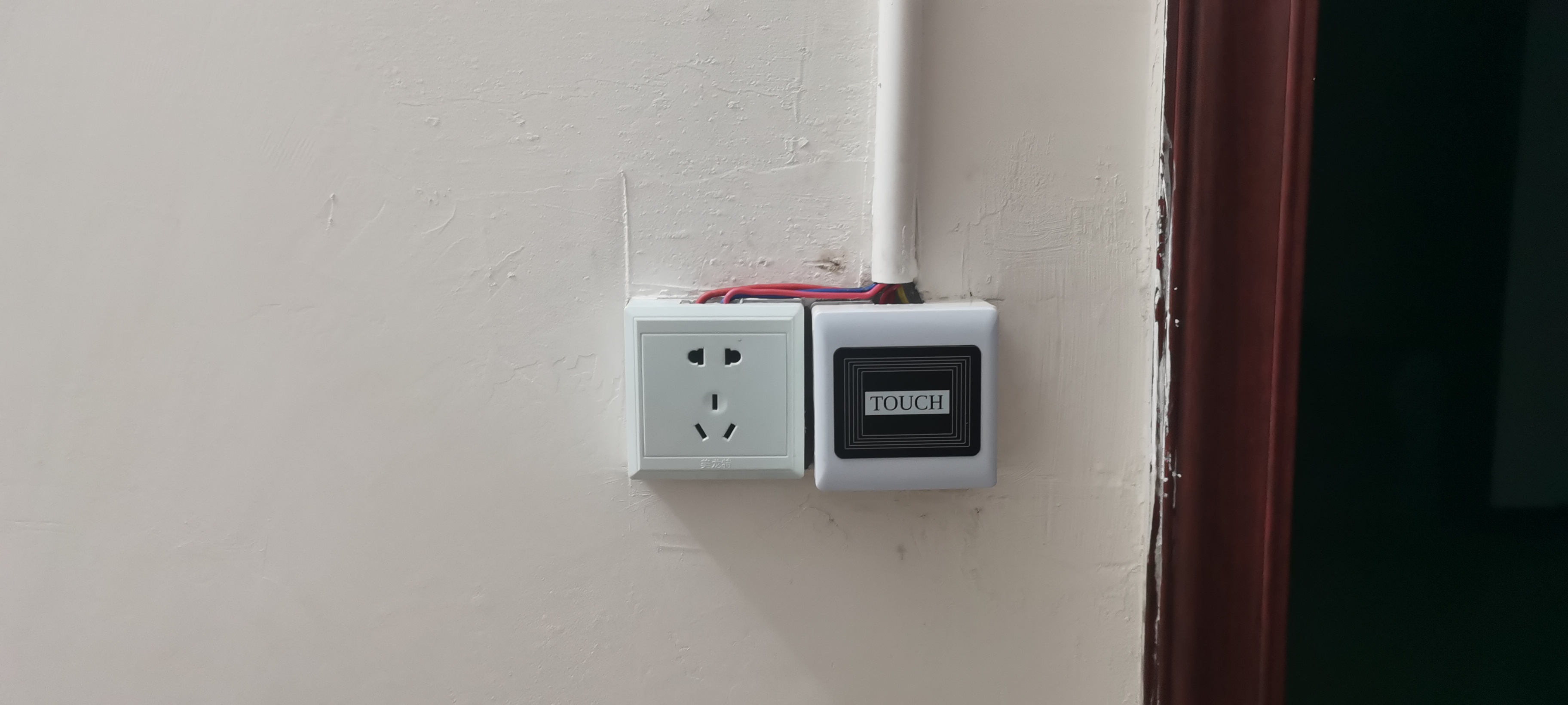

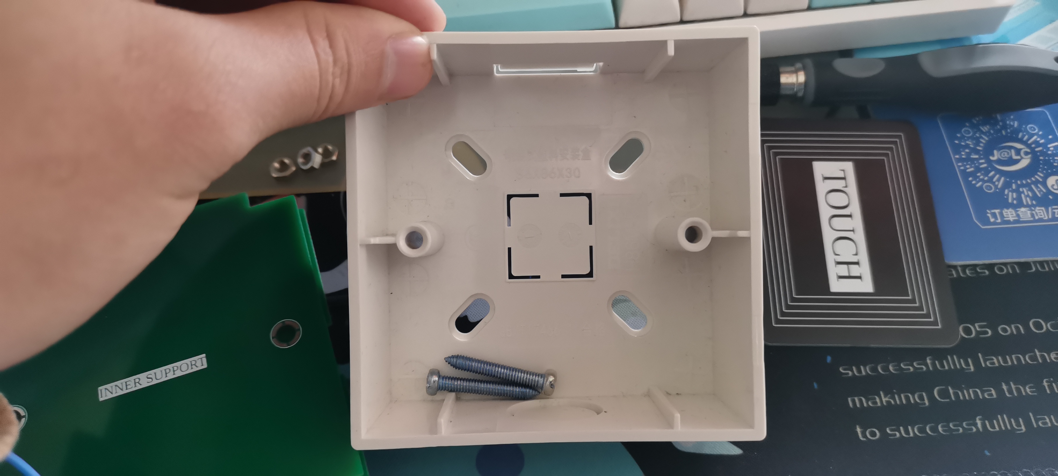

Assembly Instructions
Assembly Materials
M315+6 4
M466 Nuts*2
M4 Ordinary Nuts*2
PWM M35 4
2.4G Flexible Antenna IPEX
86 Blank Panel*1
86 Surface Mounted Box*1
Soldered Mainboard One
Middle Frame One
Outer Panel, One Inner Panel
Assembly Order
Mainboard Leave Touch Line
for Testing
Install Antenna
Pre-connect AC Line
Install M3 Copper Pillar
Install Middle Frame and Inner Panel
Place in 86 Box
Install Outer Panel

The reason for not making a single-wire system
is mainly due to the fear of problems (ghosting) when used on some lights.
